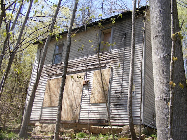

  Well, we bought some property in SE Ohio and knew it had an old house on it that I planned on tearing down. It was boarded up, dark and full of critters. After taking possession, we ripped the boards off the windows and started poking around. Low and behold it was a log home underneath! It goes up a story and a half but was added on with framing and clapboard somewhere before 1903 (found a newspaper under the wall paper). I did find the home on a map dated 1875! So this is now our new project. Under the clapboard are WIDE planks nailed to the beams. We're going to keep the outside as is for now but expose and chink the beams inside. New roof goes on first. Stay tuned!

  Here is the back room addition of the house that is a total loss. I'll be taking that part off.

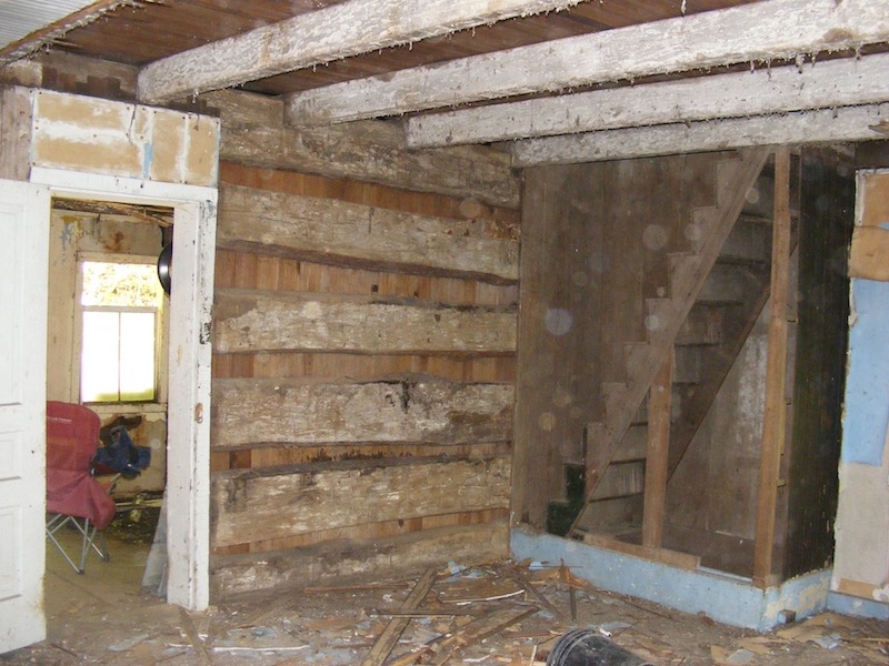

  Some progress this weekend. Going to mortar the front and back of the foundation. To do that the floor had to come up. I wasn't going to crawl under there with a bucket of cement! Tore the wood off two walls. Found the corner joints to be half-dove tail. Tells me it was not originally clapboarded but chinked at one time. Strange that I couldn't find any evidence of old chinking. [url=  ][/url]

# Posted: 28 May 2013 08:23pm
  After power washing the logs, I'm wondering if I should treat them on the inside with anything. They look great even after 150 years. ???

  I'm wondering now if even power washing is going to be adequate.
  In houses where people let their numerous dogs and cats pee all over the place, it soaks through the carpet and into the subfloor below. Only way to get rid of it is to cut up the subfloor and replace it, cause the urine is soaked in. Yuck.
  After your demolish all the ceiling and wall covering exposing the log structure, I wonder how many of the logs will be stinky even after you have washed away all the droppings and dirt.
  They sell amino acid solutions at pet stores that supposedly biodegrade animal waste in carpets and on wood. I have no idea how effective this is.
  Hope I didn't rain on your party.

 Quoting: bldginsp After your demolish all the ceiling and wall covering exposing the log structure, I wonder how many of the logs will be stinky even after you have washed away all the droppings and dirt.
  The top of the logs took much of the nastiness. The face of the logs look great, so the good news is that the chinking will cover the tops and show only the sides. The good news about the ceiling is that it is all coming down. I'm not too worried about that..I'm confident I can clean/cover all of that. But as far as preservation goes,...not sure if I should treat it with something or not.

  Smawgunner, in the first photo in your 27 May entry, I noticed vertical boards on the outside of the hewn beams/logs.  I believe that they are original, especially considering that you did not see any evidence of chinking and the existence of large gaps between most of those beams/logs.  The house in which I grew up was built in the 1840s (upstate NY) with large hewn beams at the foundation, midway between the foundation and the attic level and at the attic level.  Nailed to these beams at all three levels were vertical planks two inches thick over which were clapboards on the exterior surface, much like what I saw in your photographs.  The inside of the planking was covered with lath and plaster.  Space between adjacent vertical planks varied as it appears that no effort was made to cut the planks to a standard width.  The narrow width boards over the floor I suspect are a later upgrade.  The original floor was most likely wide boards.
