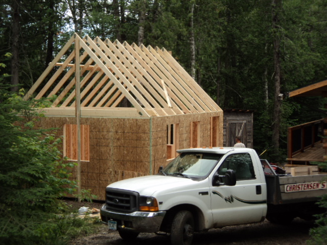

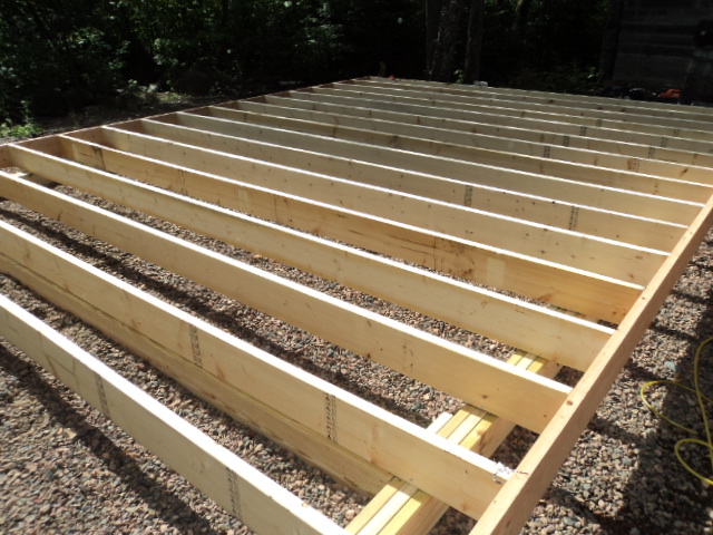

I'm building another cabin in the neatest area. Right in the heart of Boundary Waters and less than a mile from Canada in northern MN. As of this post I'm three days into it and I expect three or four more to go.
floor
floor
walls and rafters
walls and rafters
first day done
first day done

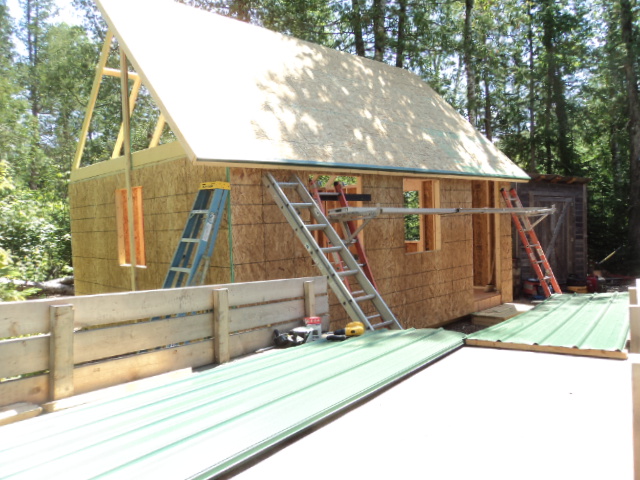

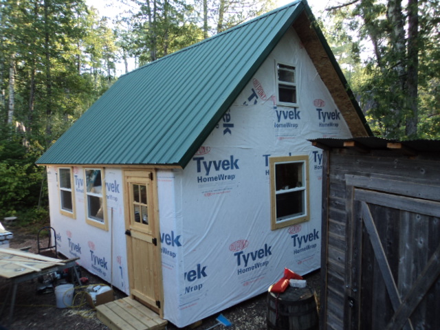

I forgot to take pictures, but all the windows and door are in, chimney and roof is done. We also Tyvek is on and the loft is in.
Here's pics. from the day before.
sheathing
sheathing
tin roof
tin roof

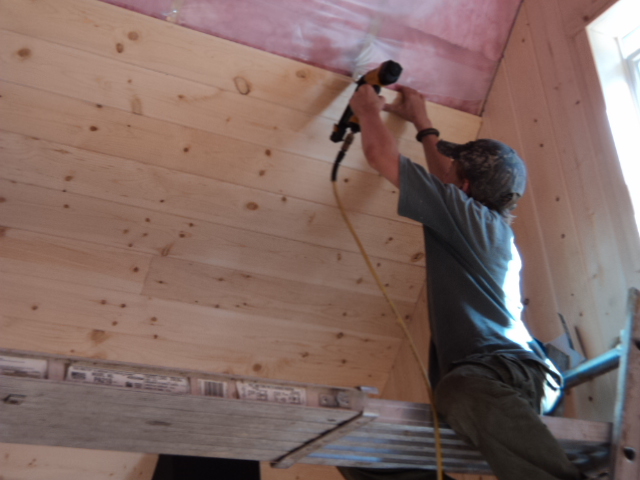

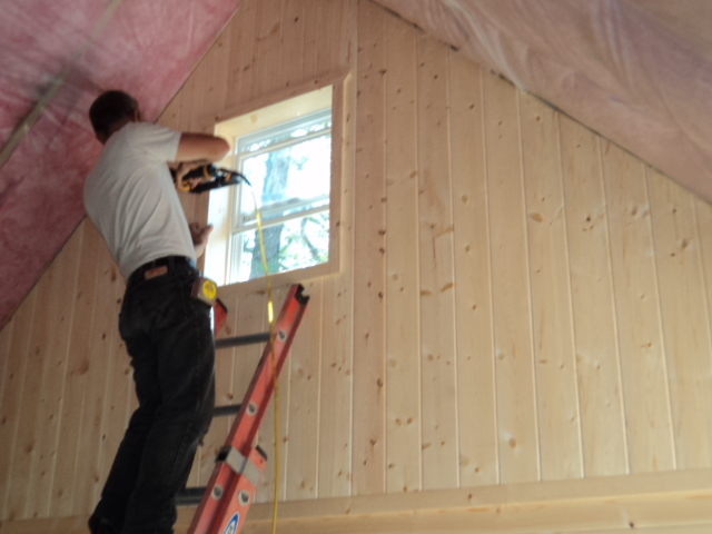

I just got back from another trip to the cabin site. I forgot the camera again. We did get it all insulated and all the lower walls paneled with knotty pine, as well as the loft ceiling. We hauled home some tools for today's job close to home a 12' x 12' sun room, along with a huge load of garbage. I think I still have three or four days left on the Arrowhead cabin. I will remember the camera next time.

Live from the job site. Pictures from yesterday and today. No fish though.
under loft
under loft

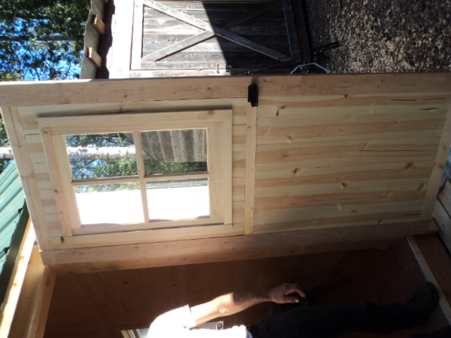

door
door
child labor
child labor
tyvek
tyvek

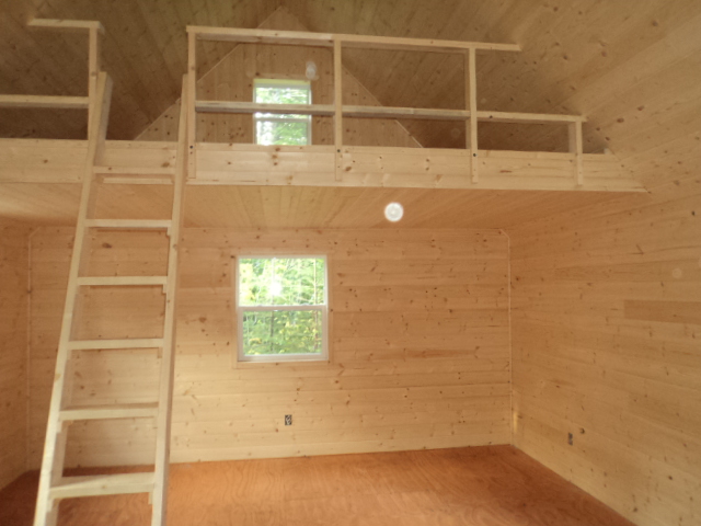

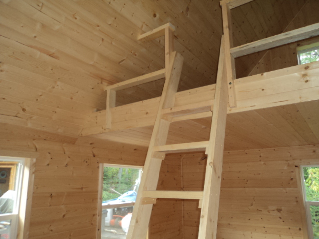

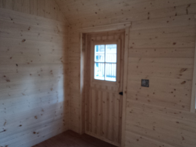

# Posted: 26 Aug 2013 08:46am
Ok. I just got in last night. Interior is done. Rough sawn siding will take another trip, maybe in a day or two.
stairs
stairs
in loft
in loft
interior
interior
inside home made door

# Posted: 26 Aug 2013 10:19pm
Thanks for sharing. Can you let me know how much headroom there is in the loft and how much on the 1st floor? Also, what pitch if you don't mind. I was thinking of the same idea and yours looks like plenty of headroom.
Scott
# Posted: 27 Aug 2013 07:53am
It's a 12/12 pitch or 45 degree, so it's a 16' wide building, 8' to the middle and 8' to the peak on the outside. The loft is 8' minus floor joist and diagonal rafter, so about 6'-9''. The height of the lower headroom is 7'-3-1/4''. The reason I don't use 8' is that I want the sheathing on the outside to reach from bottom of floor to top of plate. Then I use 7' studs cut from 14' 2x4s, because they are better wood than stud grade. 7' plus the three plates make 7'--4-1/2''. Then with the 3/4'' ceiling paneling brings it to that. Of course you can do it different, but this is reasonable and very little waste.
