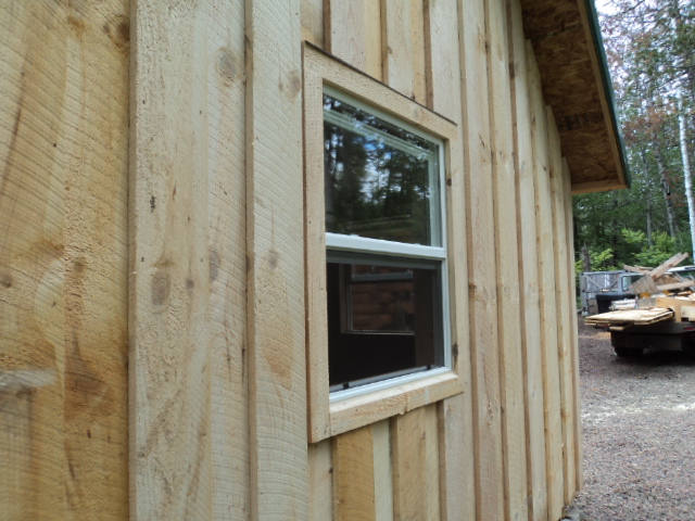

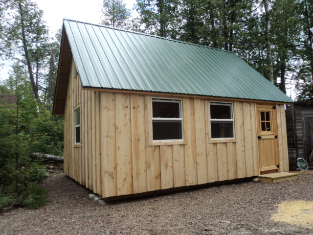

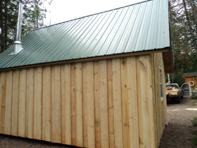

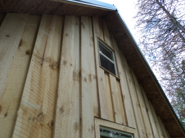

# Posted: 30 Aug 2013 07:01pm
Well it's now done, at least my part. The customer wanted a partition across under the loft, but when he heard I would charge $800 for it, he declined.
I have 120 man hours into it and six trips to the site. I'm happy with that since several days of vacation went into those trips.
O
front
front
back
back
window
window
gable
gable
