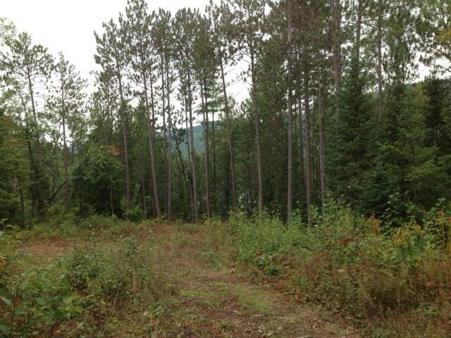

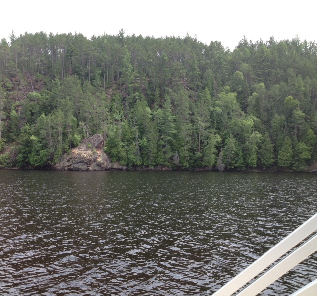

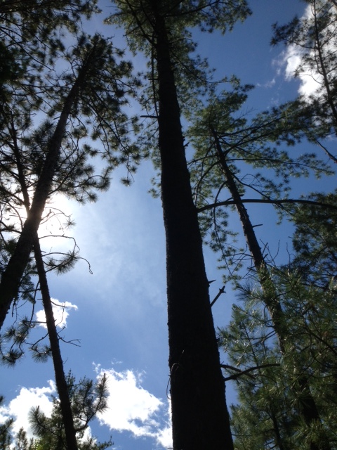

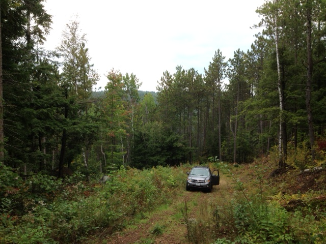

# Posted: 8 Apr 2014 14:13

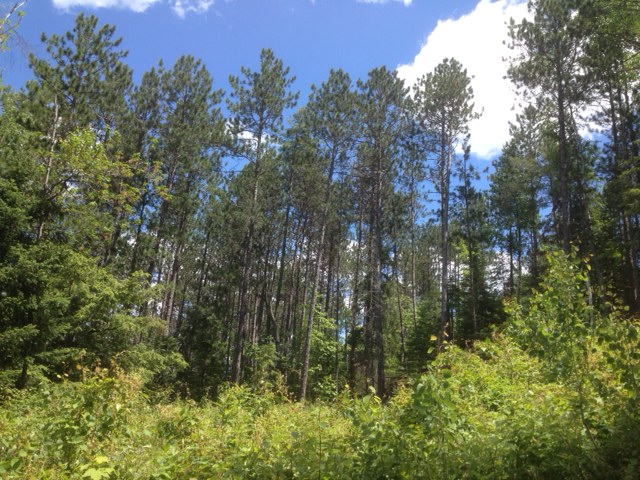

These are some pics from last summer, before I bought the place![Building site Building site](https://www.small-cabin.com/forum/shared_files/uploaded/3949/66256_1.jpg) Building site

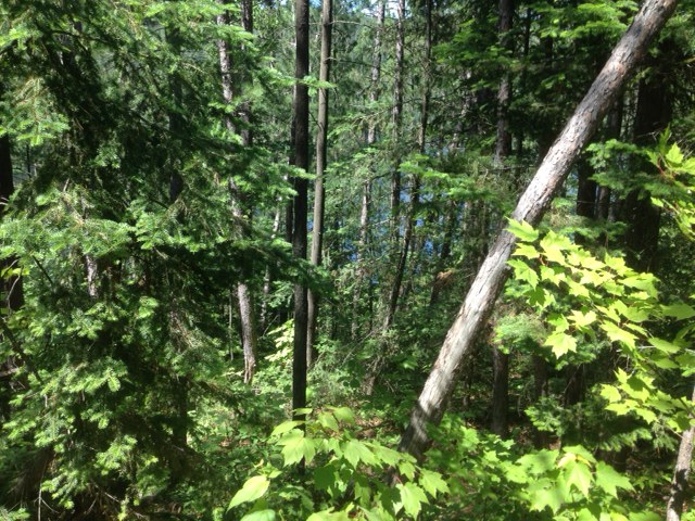

| ![My waterfront My waterfront](https://www.small-cabin.com/forum/shared_files/uploaded/3949/66256_2.jpg) My waterfront

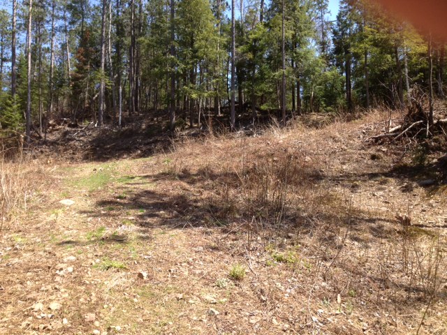

| ![Looking south, toward my lot line Looking south, toward my lot line](https://www.small-cabin.com/forum/shared_files/uploaded/3949/66256_3.jpg) Looking south, toward my lot line

# Posted: 8 Apr 2014 14:18
Correction: The pic on the far right is looking north up my road, to the slope that runs down to the water. You can just make out the north shore of the lake through the trees. Although technically it's the Mattawa River, it's wide enough at this point that it's considered a lake (Chant Plein Lake)

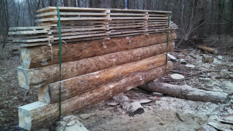

I live on 5 acres with a lot of mature red pines. When one dies I cut it down and mill it with my Alaskan mini-mill. It is work but I can clean up a tree in 4-5 hours. The pic is a tree I did last Saturday....it still amazes me how much wood you can get out of a tree! I have time so the mini-mill works good for me...plug along stacking up logs as time goes by. When I do get my "cabin land" I will have my cabin stickered and stacked ready to go![](http://www.small-cabin.com/forum/img/smilies/grin.gif) When I built my house 5 years ago I took out about 15-20 red pines where the house went. I was on a time schedule! I called in a guy down the road with a Wood Mizer and he milled everything in two days. I had everything cut, kiln dried and milled for about $2500. I put it all inside the house and did the outside in "low maintenance". I will second Robert Chambers book. If you are wanting to do a handscribed log cabin he is a wealth of knowledge. You will need some big equipment to move logs if you go that route.

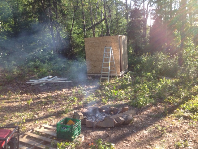

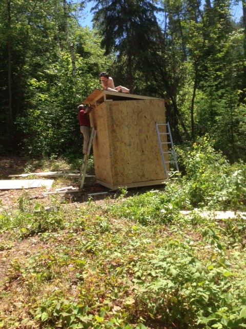

I'm finally under way. A buddy and his son came up north with me and we managed to put up a shed - which is a huge first step, since lugging all the tools and equipment was difficult and time-consuming.
No blackflies - but lots of other flying critters (the horseflies up there are the size of sparrows. One other surprise. When I was u pin May I expected I'd have to clear away a lot of overgrowth but it was pretty much clear. Not last weekend. Here's the difference between my property in May and my property 5 weeks later:

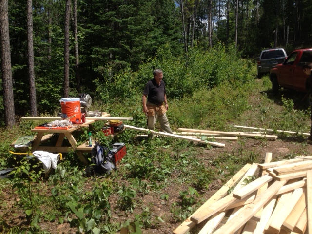

It's about a four hour drive from where I live (Toronto) to the land, so I go up on Saturday morning and take the Monday off work. The first stop was picking up the lumber for the shed at the lumber yard in Mattawa, which I ordered on Thursday. My buddy Chris has a pick-up which was essential - I never could have gotten all that lumber in my Escape.
duster
# Posted: 24 Jun 2014 15:07
By the end of Saturday (about four hours work at the site) this is where we stood. We cooked steaks and baked potatoes on the campfire (along with a beer or two) then headed back to the motel.

By the end of Sunday, it was more or less finished. (Those gaps you see had been covered with OSB) and the roof was shingled except for the last row and a half.
