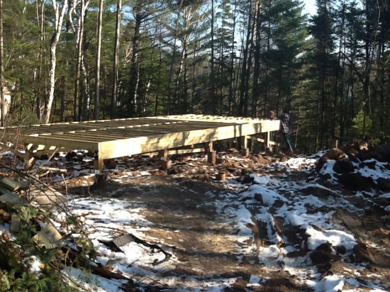

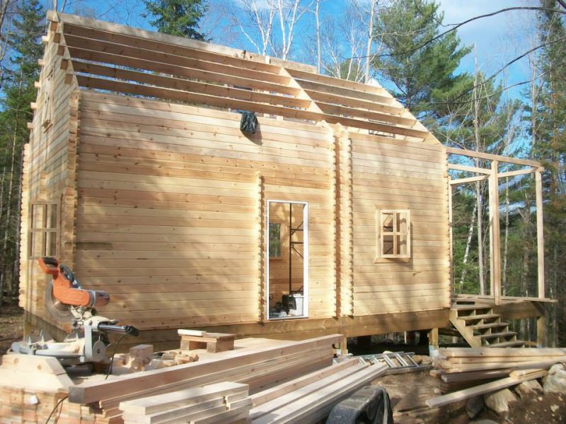

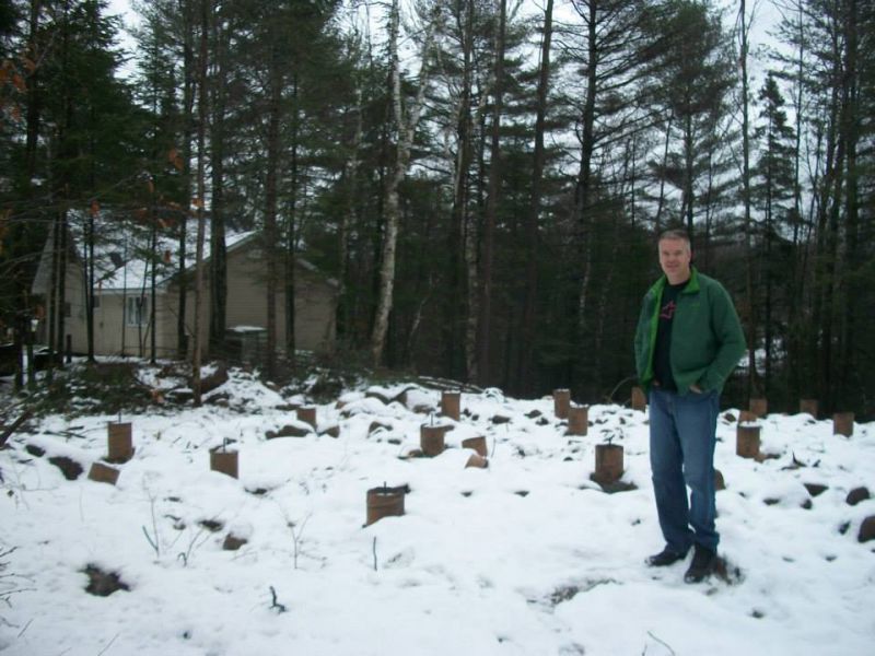

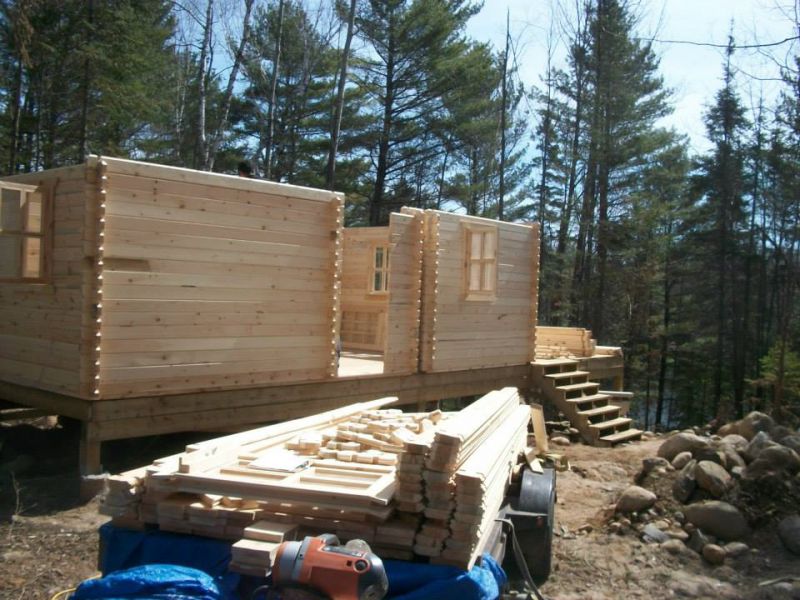

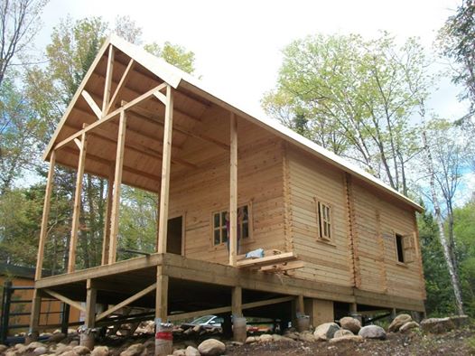

Here are some pictures from the fall of 2013 and spring of 2014.![PT Foundation Frame PT Foundation Frame](https://www.small-cabin.com/forum/shared_files/uploaded/4565/67564_1.jpg) PT Foundation Frame
| ![The cement piers The cement piers](https://www.small-cabin.com/forum/shared_files/uploaded/4565/67564_2.jpg) The cement piers
| ![Day 2 of build Day 2 of build](https://www.small-cabin.com/forum/shared_files/uploaded/4565/67564_3.jpg) Day 2 of build
| ![Day 4 of build Day 4 of build](https://www.small-cabin.com/forum/shared_files/uploaded/4565/67564_4.jpg) Day 4 of build

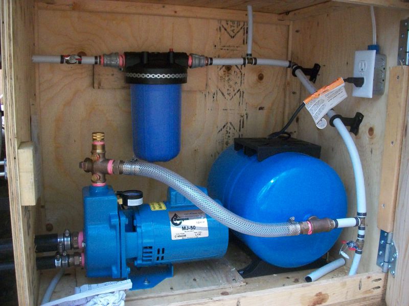

For the pump house that will contain my water pump I looked across the net for designs. Then it dawned on me that I had build a rough base cabinet to see how easy it would be to build my kitchen cabinets. I had used builder 3/4 plywood and it was a perfect box and it would fit pump and pressure tank. I bought myself some Thomson Water Seal, hinges, a good lock, and a drain for the floor and there you have it. All for under $60.
For the purification system I have not yet decided on what to get. The water will simply be for dishes and showers. I brought a water sample into Boone Plumbing in Ottawa (they will supply the water bottle) and they did a water test for $10. I have yet to talk to them about a system but based on the result they can match me to the system I need. I know for sure I will need two filters for sediment and micron filtration but I am not sold on the UV. Seems like a bit of overkill considering I don't plan on drinking the water and I can safely swim in the lake without getting sick. I want to make sure though before I consider any system that the replacement filters are easy to find and don't cost a mint.

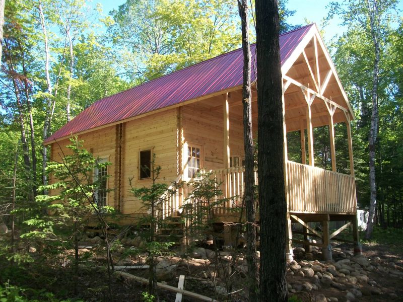

Some updates from the build this past week.
Some updates on the plumbing ... I spoke to Boone and they reported back that the water is low iron, soft, and well water like. They did provide more specifics than that but essentially since I am not drinking it they recommended the "Big Blue" and a 5 micron filter. They first quoted me a reasonable price but I wanted to do some price comparing so looked at the big box stores and then decided that Boone is by far the best price. All in I got the Big Blue, Filter, and brass fittings to connect to my PEX for just a few dollars over $120. The UV would have been overkill for me... I have since been looking on Kijiji for water coolers which are abundant and available for under $75 compared to $3-400 for a UV system.
Plumber started this past weekend and was able to get most of the ABS installed and grey/sewage pipe positioned for the guys from Blue Heron that are installing Septic this week. There is not much plumbing to do except for install of jet pump and prime, two outside faucets, kitchen sink, bathroom sink, toilet, and a full tub shower. I opted for the tub as I thought that when my kids have theirs someday they will need a spot to wash the babes. Plus when I renovated my bathroom myself at home a few years ago a tub I concluded is much less likely to leak/crack than a shower base.

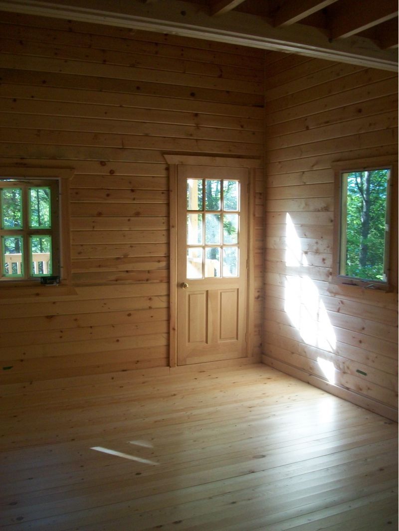

The floors have all been sanded with the help of the kids. I put three coats of Sure Shine that I purchased from Canadian log home supply.

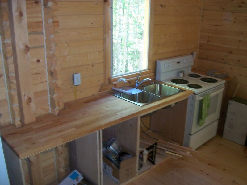

My kitchen cabinets have been installed and now I am at the point of the fine detail work. I got the IKEA butcher block counter top installed 2 weeks ago and it looks great. I have done some research on finishing the top and mineral oil seems to be the easiest way to go so that will be this weekend. Picked up two bottles for $6 at Loblaws and according to what I have read I will simply put it on at night with a rag and wipe the excess up in the morning. I'll do this for a few nights and apparently keep doing a day or two each month afterwards to keep it from drying and cracking. Because I custom made my cabinets it has not been so easy to find cabinet doors so I made the decision to use the Purebond birch plywood. I'll be using the miniwax pickling stain to give it a white washed look but also bring out the grain. For the drawers that I put in this past weekend too I used Metabox with half inch russian birch for the bottom and backs. The instructions were for in mm and I would like to say it was easy but I found it quite time consuming to do. Worth it in the end though as they will last forever.

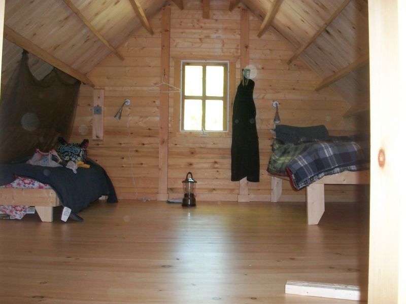

For the loft and bedroom I built some Hailey bed frames that I found off of the anawhite.com site. For the double it cost all of $58 and honestly it blends well with the pine.

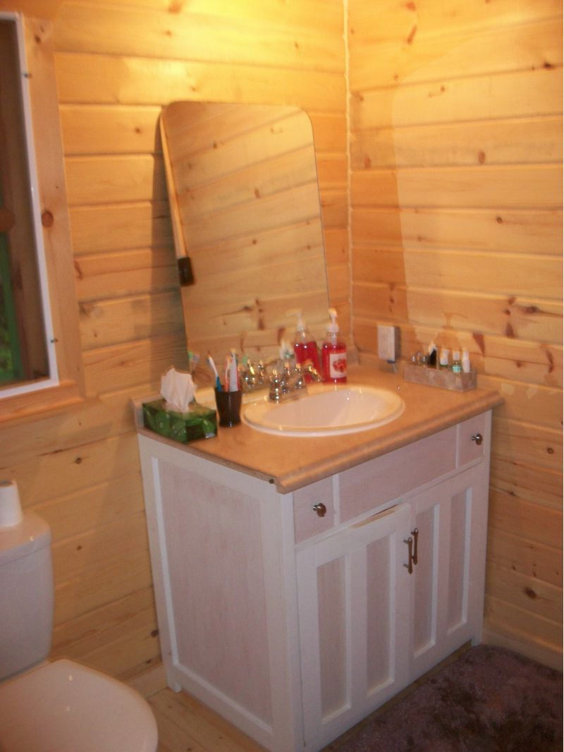

Anyway I am back up there this weekend to tackle the side of the building. Here are a few pictures of my progress.![Cabin front Cabin front](https://www.small-cabin.com/forum/shared_files/uploaded/4565/69537_1.jpg) Cabin front
| ![My bathroom vanity My bathroom vanity](https://www.small-cabin.com/forum/shared_files/uploaded/4565/69537_2.jpg) My bathroom vanity
| ![Bathroom Bathroom](https://www.small-cabin.com/forum/shared_files/uploaded/4565/69537_3.jpg) Bathroom

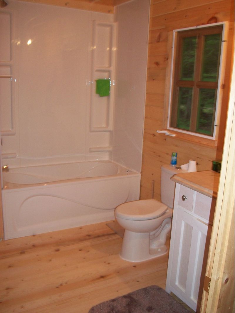

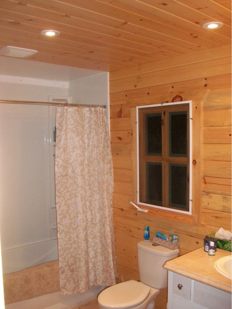

I am posting a few pictures today of the finished bathroom with the pre-finished T&G pine. I borrowed a friends air nailer to install and it was so easy. I used by mitre saw for the length cuts and my jig saw for cuts around the shower ceiling and exhaust vent. I am very happy with the end result. Under the finished ceiling is a 6mil vapour barrier that I applied. I tried using vapour caulking around the perimeter but it was a mess to work with so resorted to red tuck tape and my staple gun.
I spent hours surfing the net looking at ideas for a pump house and how to configure the pump, pressure tank, and 5 micron water filter and have posted a picture that hopefully will help others. As I said in a previous post I used the 36" Base cabinet plan from the ana-white.com site with 3/4 inch ply and some Thompson water seal all in at about $40.... equipment extra of course.
For the stain I purchased this from Canadian Log Home Supply in Eganville and went with an almond tint (in Ottawa there is a distributor so if you want the name let me know). I decided to pre-treat the wood with their Shell Guard product which when diluted with water was like liquid honey. I tried to spray on which was recommended but it just clogged up the sprayer. If I did it again I would skip this as it was a pain to apply and it set me back 10 days as I had to wait for what was applied to dry. For the stain I used the Ultra-7 and Lifeline Advance clear coat and a good $9 stain brush from HD. I did try using cheaper brushes but it made a huge difference in both time and appearance paying a little but more for a quality brush. Prior to applying the stain coat I caulked the seams at all the log ends with DAP Window/Door caulking - Arie did supply me with three boxes but I had to buy three more. A day before staining I pressure washed the wall using the soap nozzle to apply their Log Wash product. To rinse I just used the hose with a spray nozzle on the end and not the pressure washer to avoid interior leaks. I did use the pressure washer once for the front and the water was even being pushed in through the knots in the wood and we had to lay out towels to catch all the leaks. I would recommend a rinse using a simple spray from the hose.
For the bathroom walls to protect and seal against water stains from the shower steam and potential mold issues I applied three coats of their Acrylic Satin clear coat diluted with their stay clean product which was recommended by CLHS. Prior to applying I diluted log wash in a bucket of water and using towels soaked in the liquid I washed and rinsed the walls. I have to admit that it made a huge difference in taking the sheen off the wood and cleaning them. The same principle really as using TSP prior to painting.

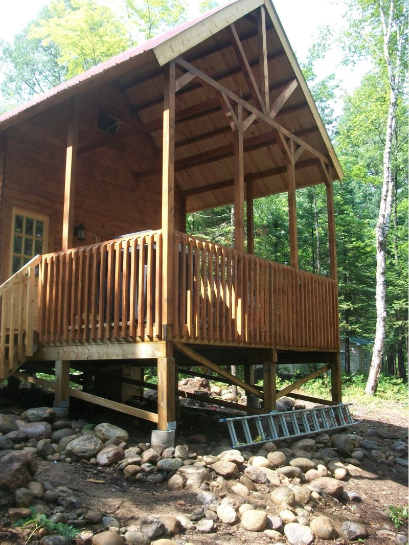

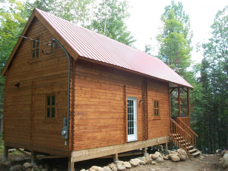

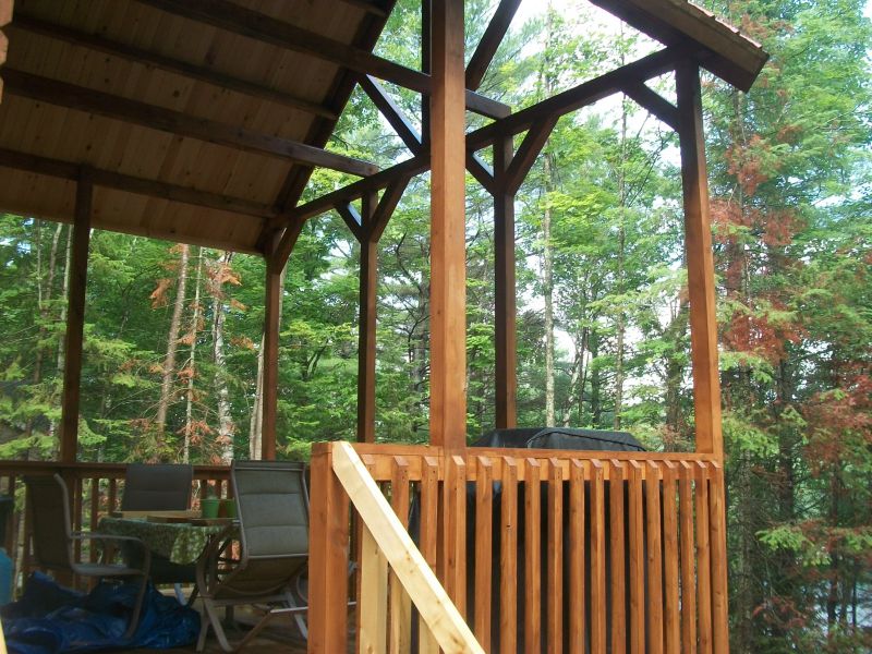

Steve![Simple pump house Simple pump house](https://www.small-cabin.com/forum/shared_files/uploaded/4565/70545_1.jpg) Simple pump house
| ![Stained cabin Stained cabin](https://www.small-cabin.com/forum/shared_files/uploaded/4565/70545_2.jpg) Stained cabin
| ![Deck overhang Deck overhang](https://www.small-cabin.com/forum/shared_files/uploaded/4565/70545_3.jpg) Deck overhang
| ![Finished bathroom with T&G ceiling Finished bathroom with T&G ceiling](https://www.small-cabin.com/forum/shared_files/uploaded/4565/70545_4.jpg) Finished bathroom with T&G ceiling
