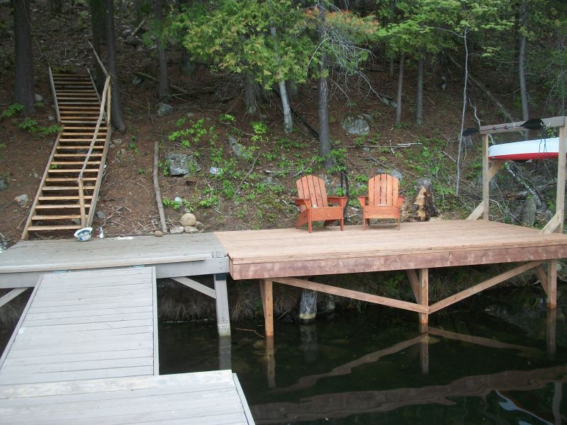

Built myself an addition to my original deck down at the lake this summer too. Was my only big project this past summer with smaller side projects of course. This summer was more about relaxing and having fun! Started the deck at 6AM and finished at 6PM with a buddy's help - his payoff is that he and his family got to enjoy the cottage on their own in the summer for a week. Actually he offered to come help as I told him last year that they can come every year for free so his labour is the payoff .
10x16 deck
10x16 deck

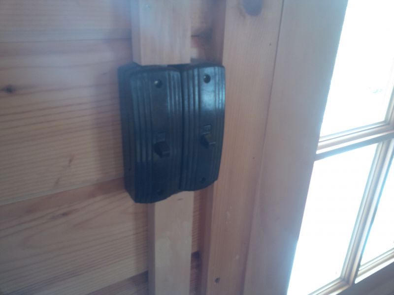

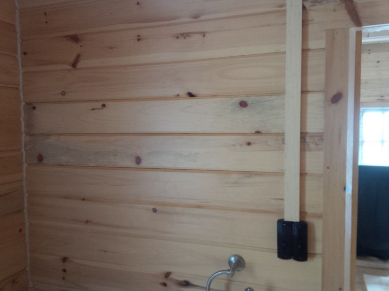

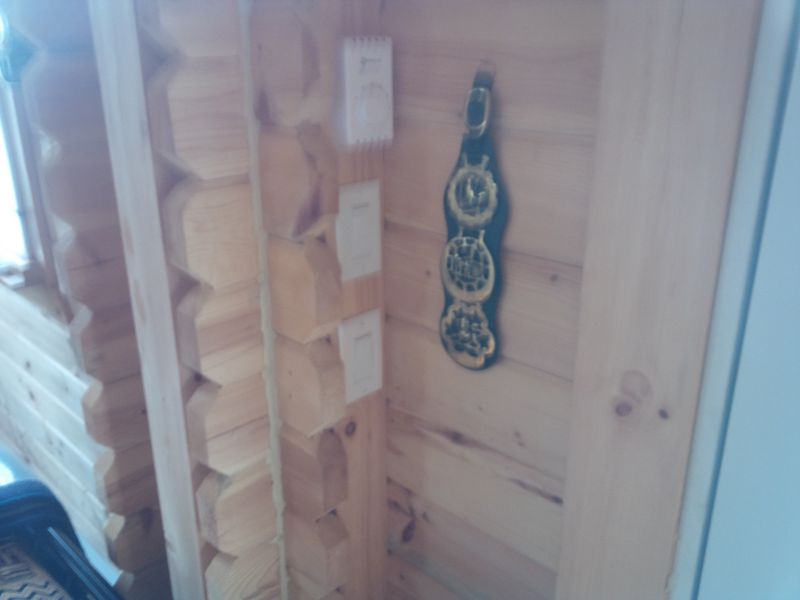

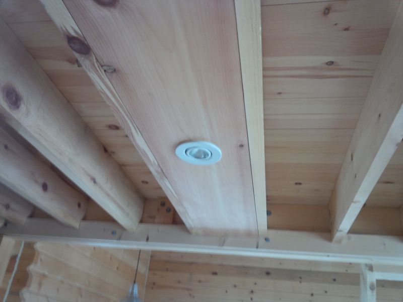

Very nice! First time I see 2x6 T&G used for exterior walls. Do you have any wiring? All I see are the lights in the bathroom ceiling.
Any plug receptacles? Just wondering because I've run into this with log cabins and have seen the receptacles in the floor along the walls on some.
Oh wait! I see the ones in the kitchen now.
SteveF
# Posted: 22 Nov 2015 09:02am
When I had the electrical done the Electricians were really good about this and hid wiring for wall switches/outlets behind a 1x2 that had a routered out channel on one side. Also had ceiling fans put in the main room and bedroom and again the wiring was hidden along the rafters and 1x2 were used. There was no need for wall switch for the ceiling fans since they had a remote. GFCI plugs were the regular style for outside, kitchen and bathroom. Wall switches and plugs were self-contained and did not require a box for wiring. I have googled for an image but can't find the style so next time up will snap a picture. The wall plugs were just above the 1x4 baseboard which again had a 1/2" channel in behind so no wiring to be seen. When all was done there are no wires to see anywhere as all exposed are hidden behind 1x2 channels which these guys said they usually did when wiring in log homes.

Here are a few pics of the electrical to give you an idea of how the wiring fits in.

Nice build and good info. Do you leave your docks in in the winter? If not how do you remove them? I like the deck you built by the water, but I fear the ice would rip it out on our lake.
thanks
SteveF
# Posted: 12 Jan 2016 10:56pm
I do leave the docks in over the winter but I disconnect the ramp from the dock and the permanent land structure and then rope the floating dock loosely to the shore so if the ice wants to move it around a bit it can. As for the permanent deck with the legs in the water, they are in about 12-18 inches of water so not a whole lot of movement. I am also in a protected bay so not as prone to the violent ice shifts and wind on the rest of the lake.

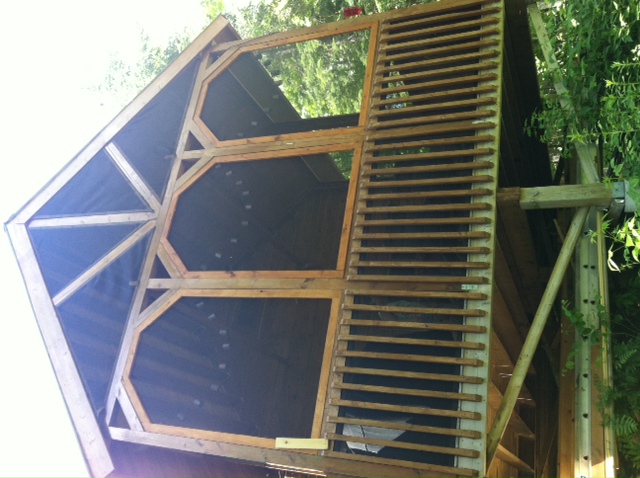

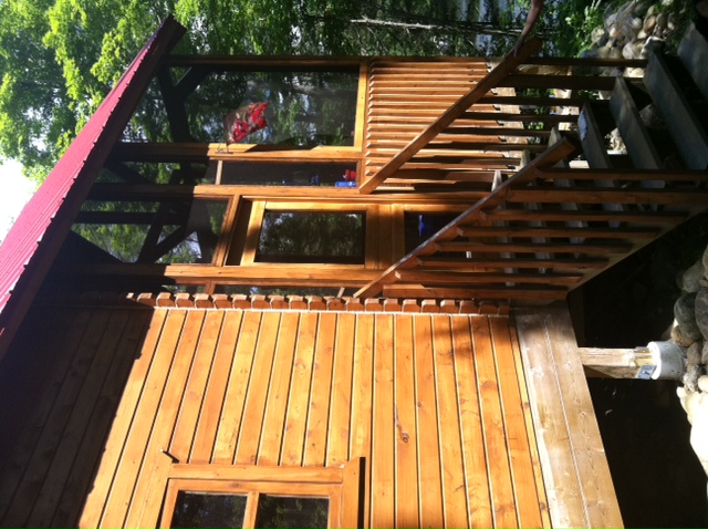

I screened in the deck in 2017 which was a larger project than I anticipated. I framed the screens to be removable and used white cedar from the local lumber mill that I sanded and finished myself. Screens I special ordered from HomeDepot. I had a couple of friends come up to help get things started in June and then finished the project off by August long weekend and then just relaxed the rest of the summer. Here are some pictures.
SteveF
# Posted: 24 Feb 2018 01:09pm - Edited by: SteveF
Some Pics - site is flipping them for some reason.
