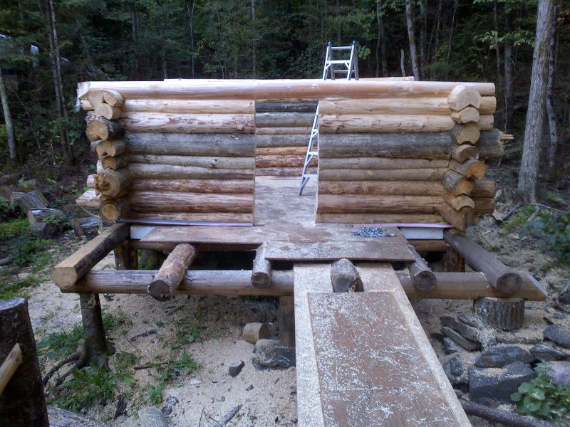

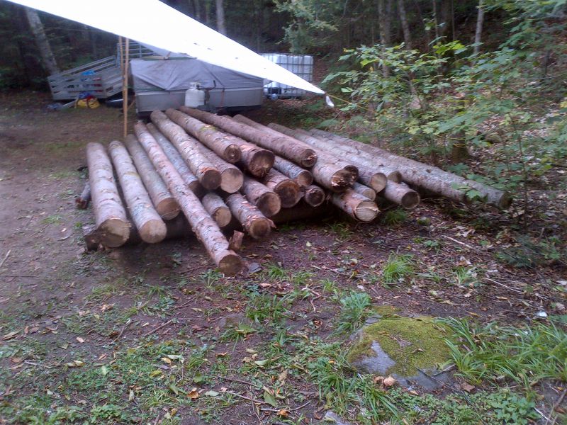

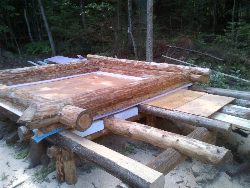

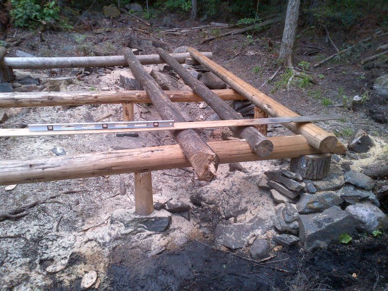

First off I had to cut down some trees and clear the area where I would be building. The area is very rocky and full of tree roots so I knew digging by hand would not be an option. I decided that I would incorporate a couple of tree stumps for the base and move rocks into place and essentially make it a floating structure as I knew it was not going to be large. Once I got the trees down I moved large rocks in place with a block and tackle and lots of sweat. I then began building a base with the logs and then floor joists with the logs.

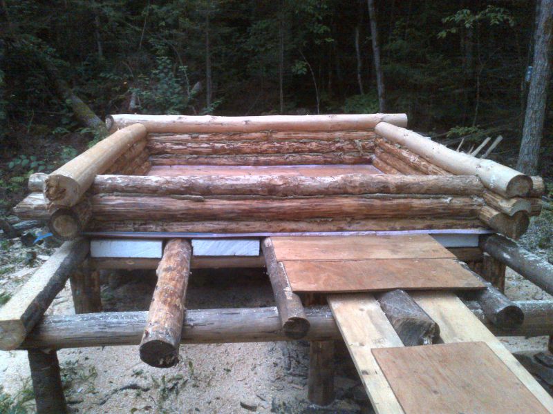

Once the base was complete, I put OSB on the underside to protect the insulation. I then found 5" thick Styrofoam on Kijiji to insulate the floor. This was covered with vapour barrier and plywood. I then began building with the logs. I wanted to do a scribe fit so the logs fit tight and required no chinking. Once a log was in place, it was scribed and then cut free hand with a chainsaw. The long scribes and notches were filled with insulation, repositioned and spiked into place with 12" galvanized spikes.

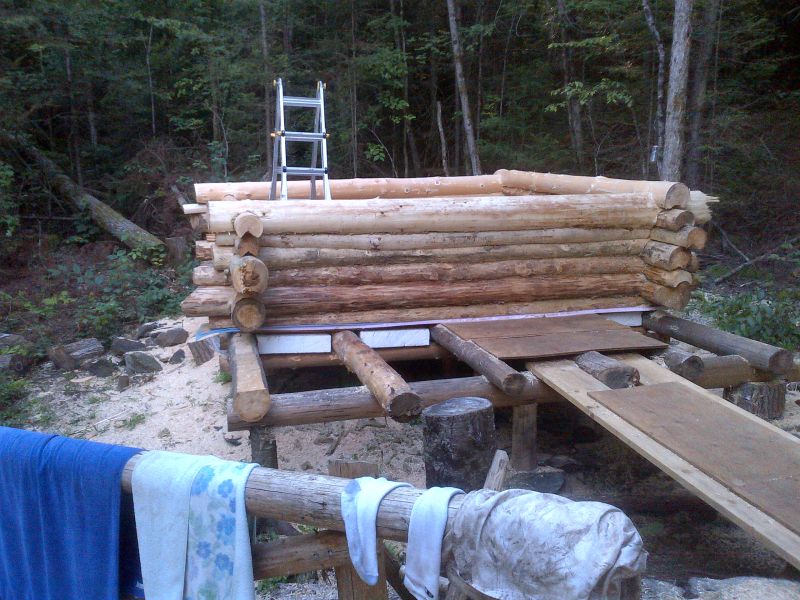

I have 10 rows completed now and anticipate requiring 12 rows to get the height I desire. The structure is 8x10 on the inside and will have a 4'6" porch on the front that will be covered by the roof. The roof will also have an overhang on the back and front to keep the logs dry. When completed I plan to make a log railing around the porch and build a small bridge from the porch to ground level at the front of our cabin. The railing will use logs and then smaller saplings for the rails that will be fitted with tenons. I plan to cover the porch floor with cedar planks as well as the bridge. The roof will use logs for rafters then covered with pine boards, insulation and then steel. I have green steel already which will match the cabin. I have a small woodstove already to use as my heat source. The stove has a flat top that I will fit a steel tray and put rocks in and then I can splash water on to generate steam.

base
base
place to peel logs
place to peel logs

taking shape
taking shape
slowly but surely
slowly but surely

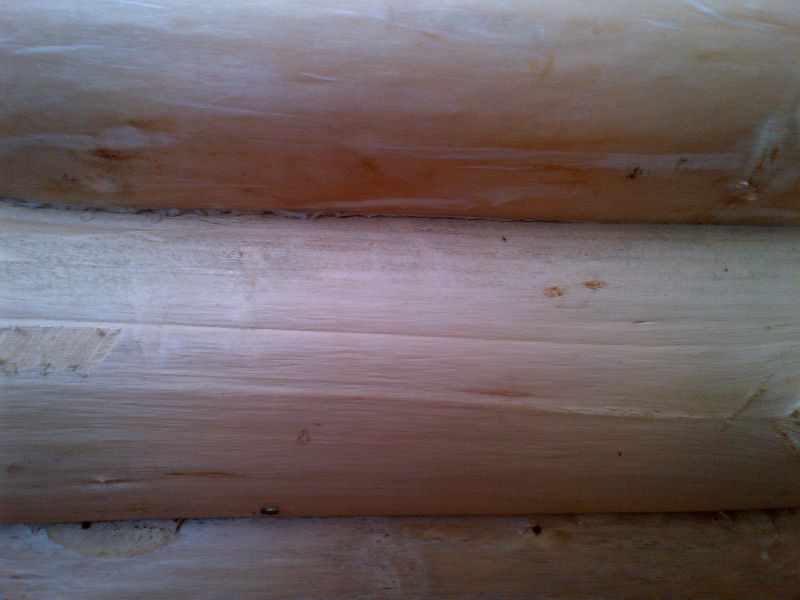

tight scribes
tight scribes

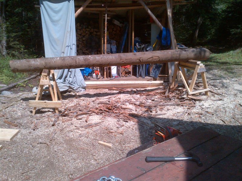

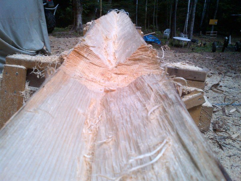

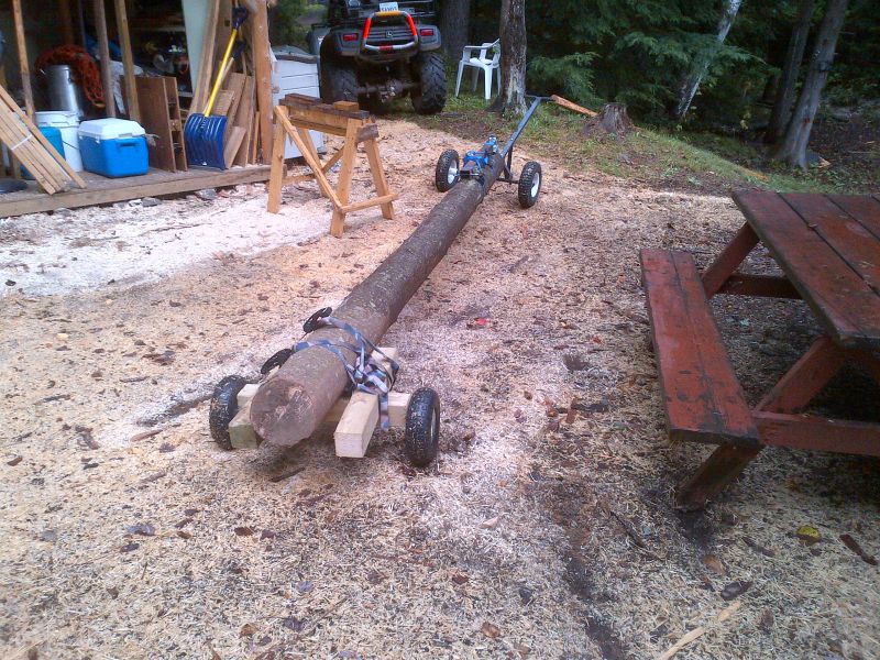

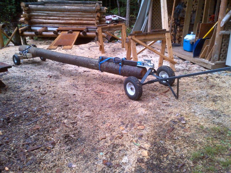

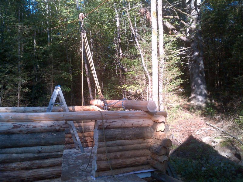

The log I made used an axle with two wheels fastened to 4x4 blocks. I place the log on this and strap it to that. The front is a 2.5" steel bar attached to a trailer coupler. I then use the trailer dolly with a 2" ball attached to the coupler and I wheel the logs from my storage location to the build site. I have to go down a long path, down a hill and I can easily maneuver the logs on my own. It works better than anticipated.
homemade log dolly
homemade log dolly
log dolly
log dolly
log after cutting
log after cutting

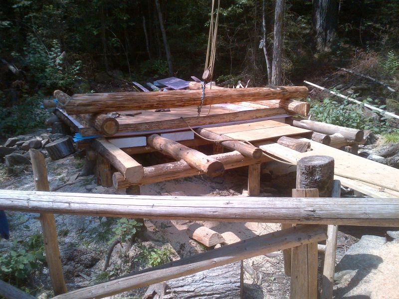

The bridge you see in the pictures is just a temporary construction bridge for ease of building. I have also placed extra posts under the beams on rocks to make it solid.
walls so far
walls so far

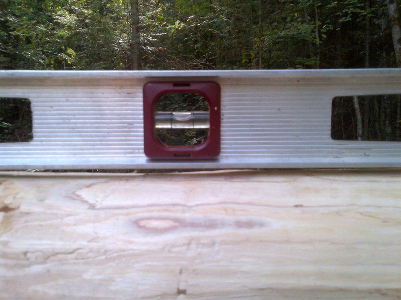

its actually level
its actually level
view of block and tackle on cable

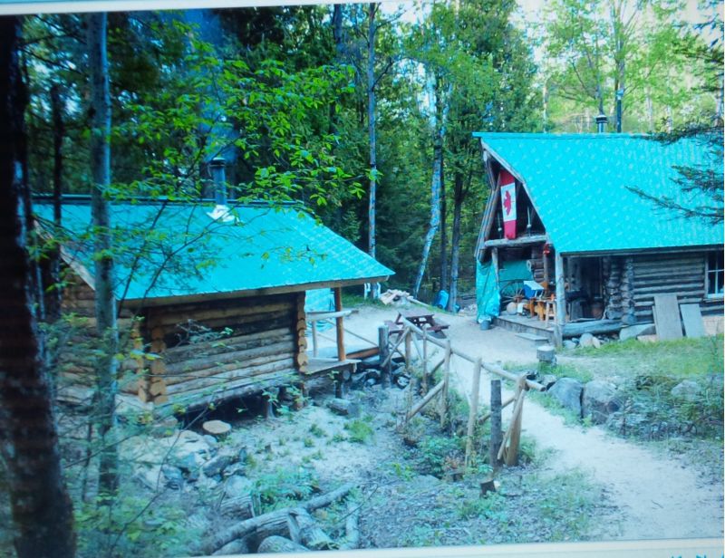

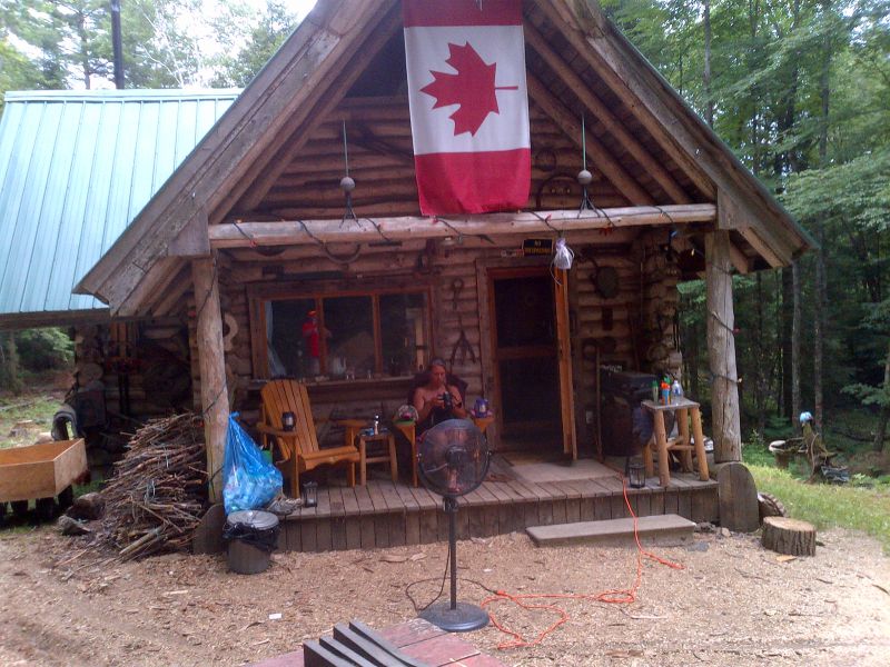

our log cabin and what the sauna will look like

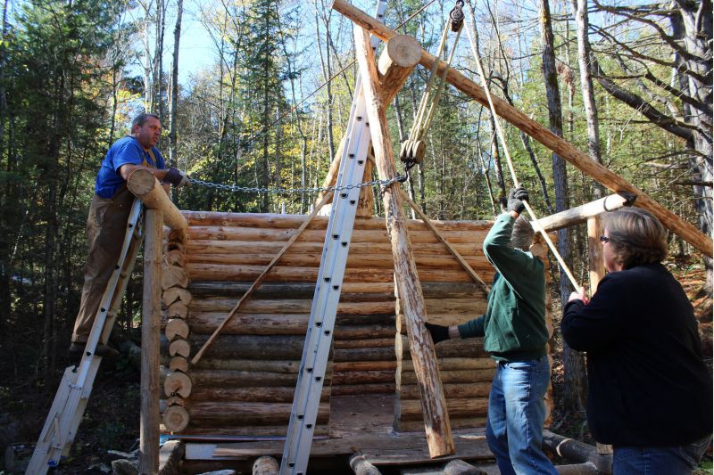

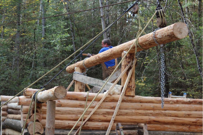

On Thanksgiving I have a big group of family members coming up to celebrate and help out. The help will be appreciated when it comes to installing a ridge beam that will be 18' long.

1. insulation between logs is fiberglass? it will get wet and stay wet.

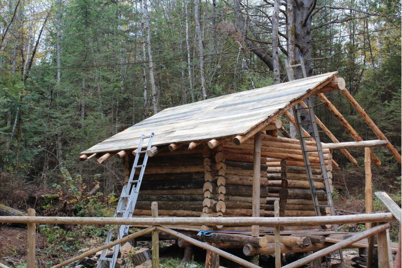

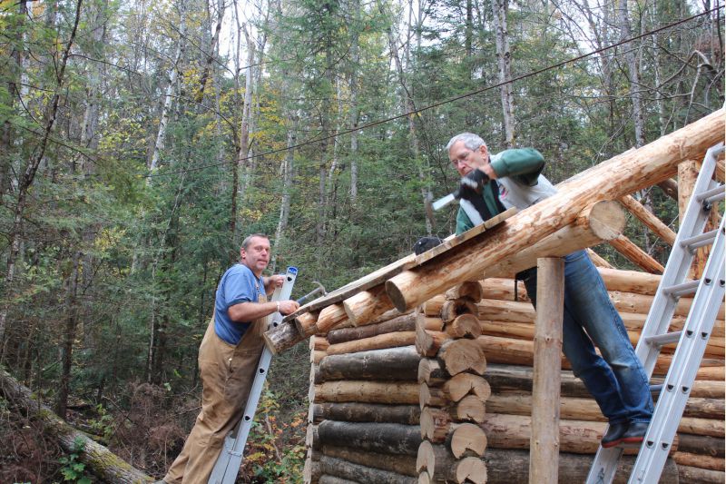

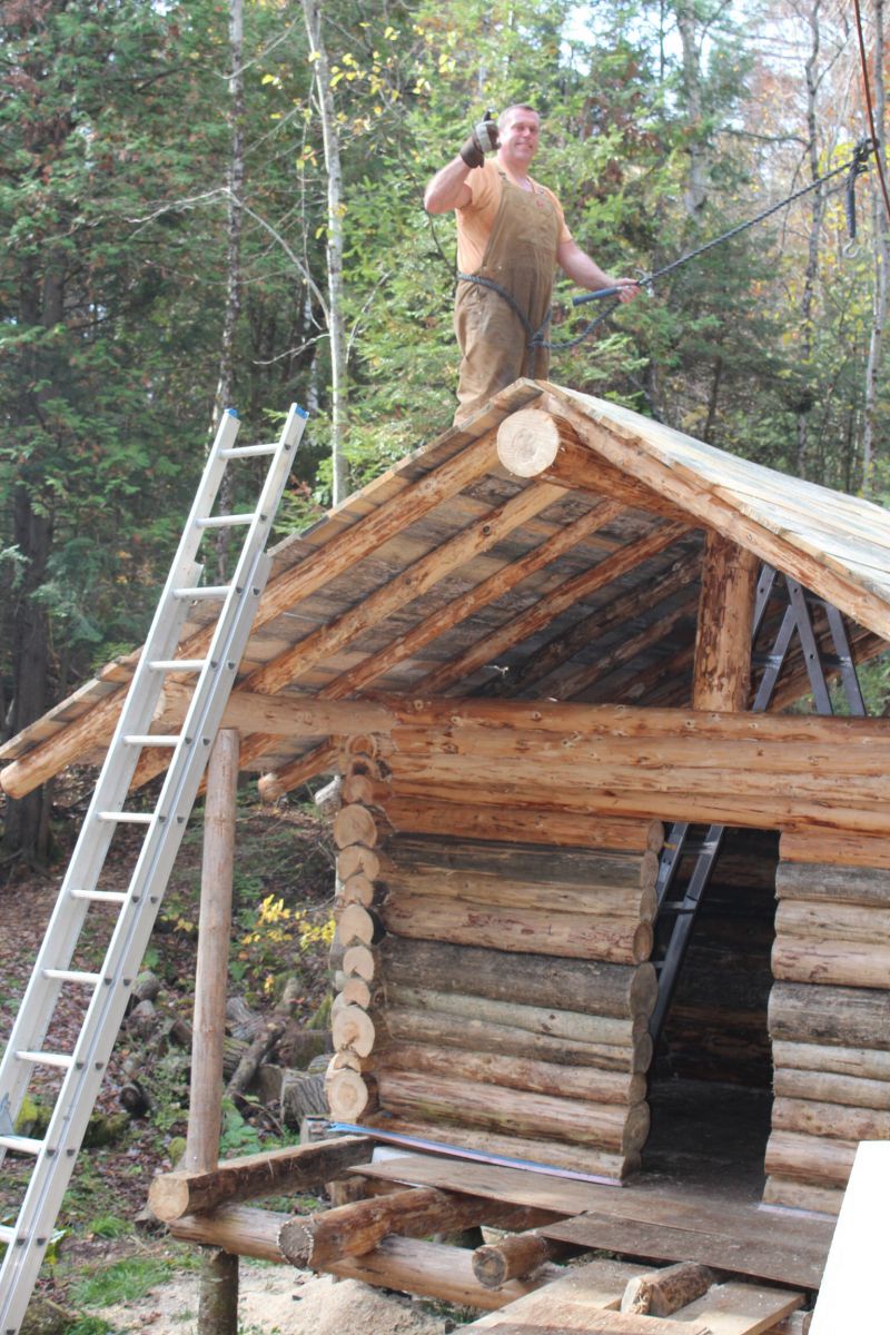

Well I just got back from the cabin and I got lots of work done on my project with the help of family. The roof is up and covered with sheathing and it is tarped for the winter. I will not be framing a door or windows until next year after it settles more. In fact I probably will not do anymore work on it till next spring. At that time I will insulate the roof and cover it with steel. I have the winter to also think about what I want to do inside.
Ridge beam getting prepared
Ridge beam up
Ridge beam up
Rafters starting
Rafters starting
skootamattaschmidty
# Posted: 16 Oct 2014 02:52pm

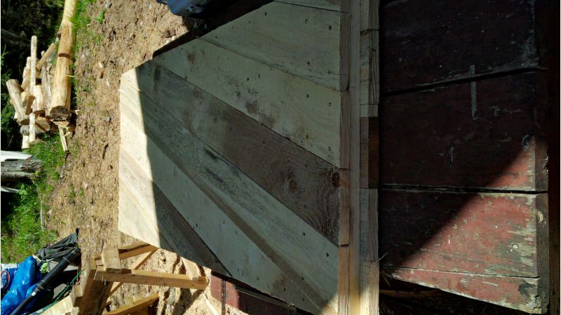

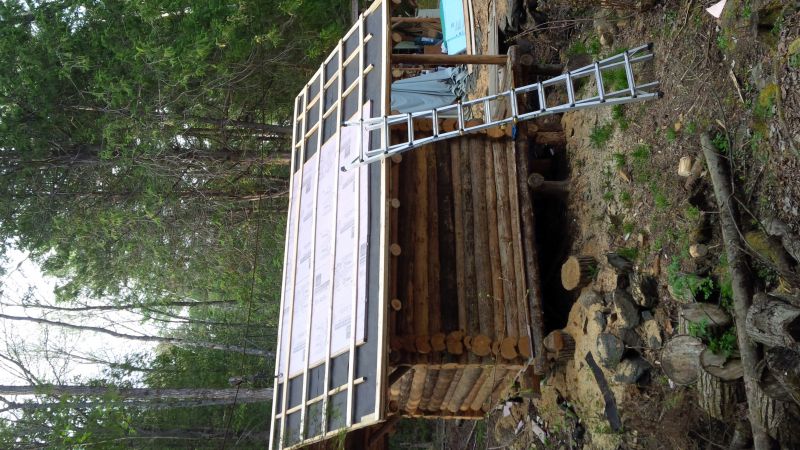

My Uncle was a huge help for the roof. He built the original cabin 38 years ago. The sheathing is 1x6 rough spruce purchased from a local saw mill. I had enough of the spruce to cover the porch with it. I left the last couple rows off so that I can incorporate my bridge in the spring. The two vertical posts at the corners are temporary to allow for some settling. I will be replacing them with bigger ones in the spring. The porch will have a railing all around it and the bridge will have a railing. I am happy with where I am at with this.
Starting the sheathing
One side done
One side done
Both sides done
Both sides done
Covered porch
Covered porch

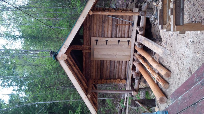

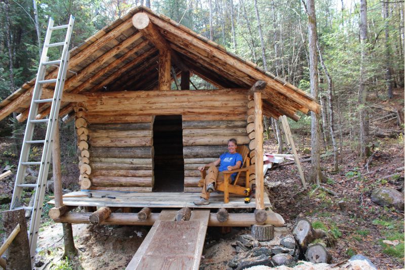

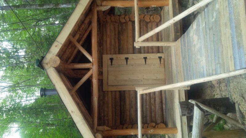

Well I just spent a week and a half at the cabin. My goal was to finish the sauna/bunkie off, aside from the inside. I had some great weather and was able to accomplish my goal. I started off by doing the roof and chimney. I used green metal to match the cabin. Once I got the roof on I placed two more rows of logs on the gable ends. I then screened the remaining gap for the summer. I will install windows in the fall. I gathered stone from the property and made a hearth for the woodstove. I also finished off the fascia board. I cut the door opening bigger, framed it with 2" rough spruce, then made a door out of rough spruce. I then made a bridge, and finished off the front deck. I covered the bridge with cedar boards. The railing was installed and I added the logs to the front as a finishing touch. My next trip up I will make benches inside and install a proper heat shield for the stove. We did have a test fire and it gets good and hot and water on the rocks generates some nice steam!

Here are a few pics.
Roof
Roof

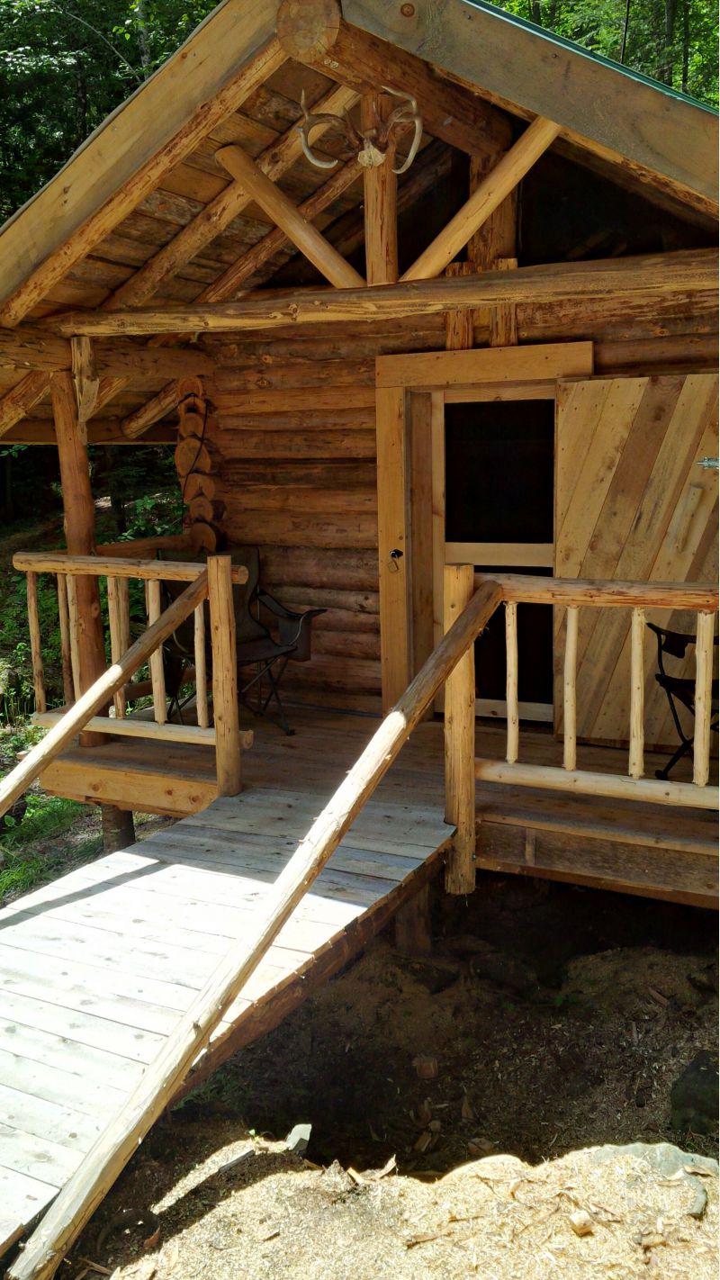

Door
Door
Gable ends screened for summer
Working on bridge
Working on bridge
skootamattaschmidty
# Posted: 19 May 2015 07:43pm
A couple more

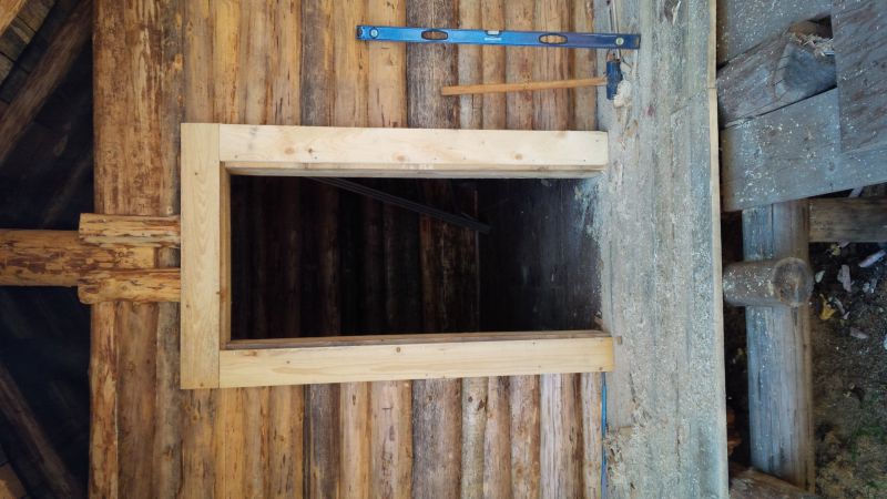

Door frame
Door frame
Railing and bridge
Railing and bridge
Finishing touches
Finishing touches

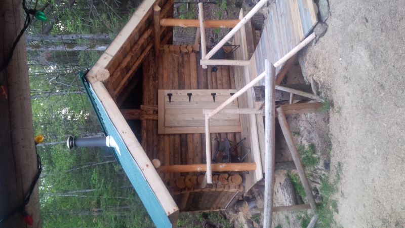

Stove
Stove
skootamattaschmidty
# Posted: 19 May 2015 07:44pm
Not sure why my pics are sideways.

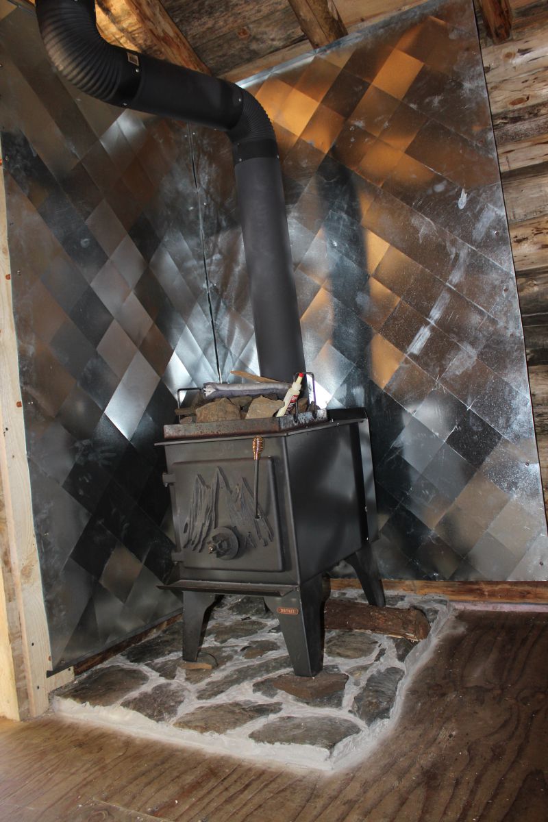

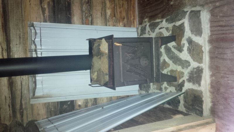

The stove looks a bit small for a sauna.

The stove is a Drolet Nordic. It's actually good for 1000 square feet and the inside is only 80 square feet so it's plenty big for the sauna. In the test burns I did, it got it nice and warm inside in no time and that was with the gable ends just being screened in. When I close them with actual windows that will hold even more heat and steam. You have me intrigued with the vihta? I have no idea what this...can you fill me in? As far as the inside goes, it is just bare walls at this point. Next trip up I plan to build benches, upper and lower and do a proper heat shield behind the stove.

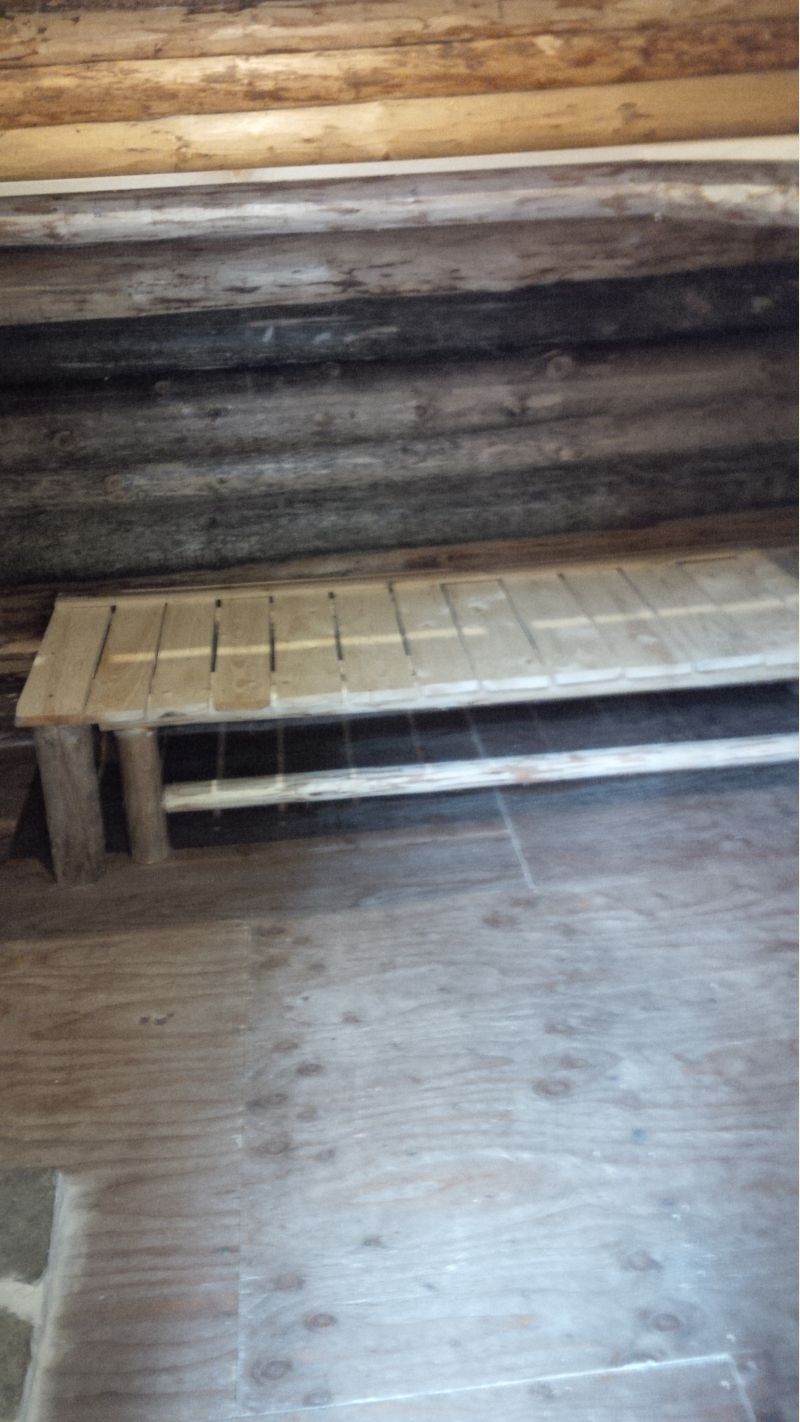

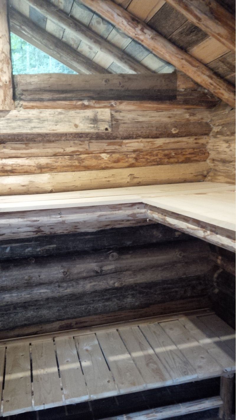

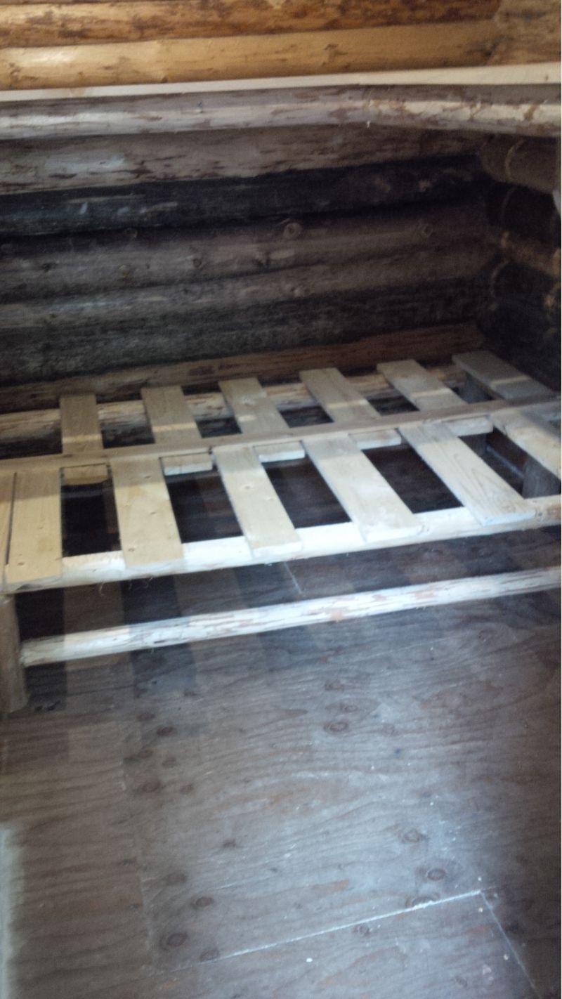

Well after a trip to the cabin in July and a month up there in August, the sauna/Bunkie is completed. I am very happy with the results. It fits in perfectly in the spot I chose to put it and does not look out of place at all. The covered porch was fantastic on rainy days when I had guests up as it gave an extra place to sit out of the rain. As far as being used as a Bunkie, I made railings that lift out when the upper benches are being used as beds. My nieces slept up top for a week and my sister slept down below on the double pull out bench and they loved it. When we were not using it as a Bunkie, we did make use of the sauna. It performed very well and got super hot without the gable ends closed off. (They are still screened for the summer.) This fall I will be closing the gable ends in with windows which will help trap the steam/heat in the sauna even better. We really enjoyed relaxing in a hot sauna this summer and are really looking forward to it when the weather turns cold. Here are some pictures of the project.

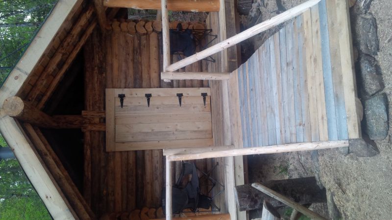

lower bench closed
lower bench closed
upper benches
upper benches
lower bench opened for a double bed

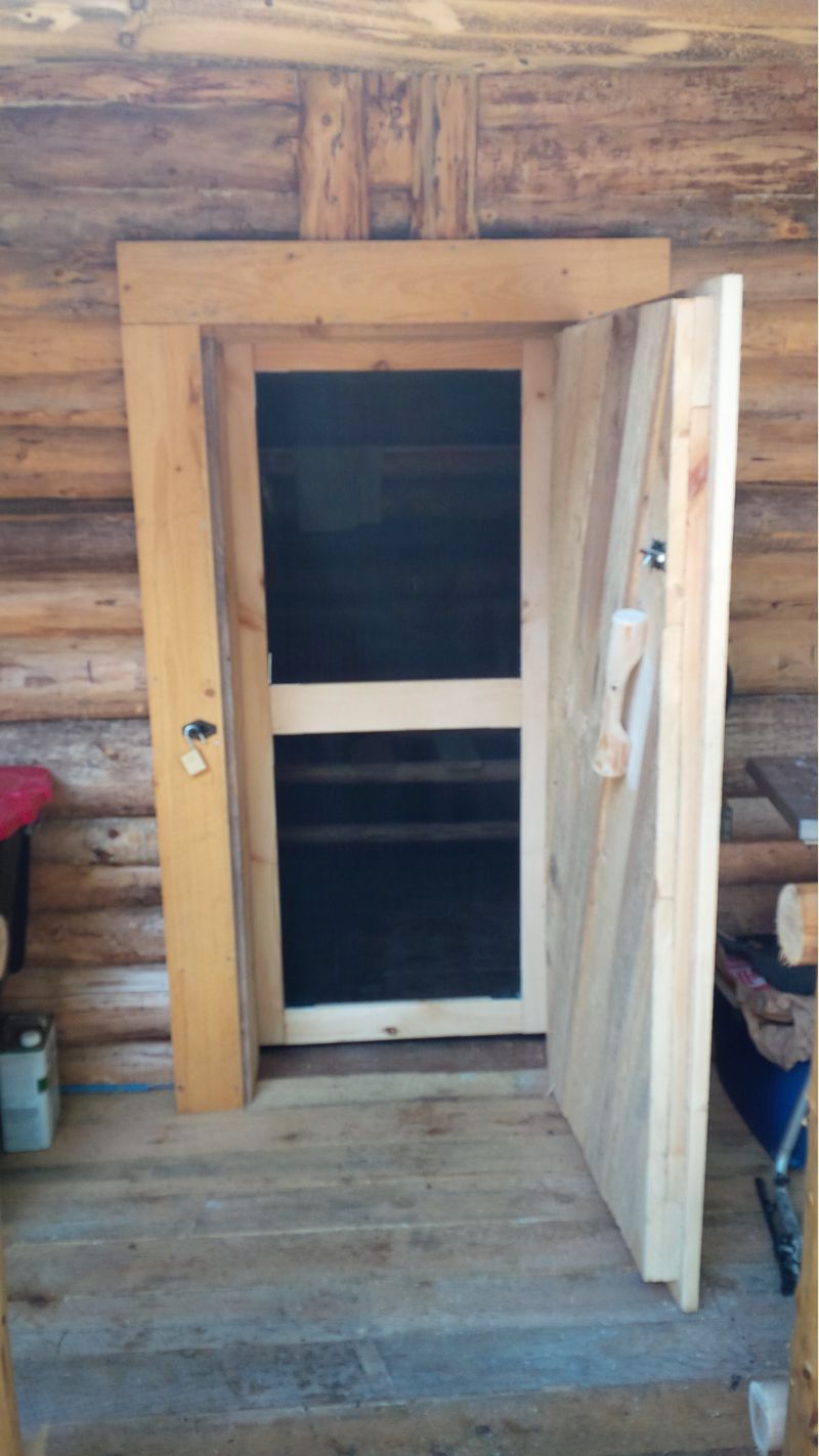

screen door
screen door
skootamattaschmidty
# Posted: 30 Aug 2015 07:38pm

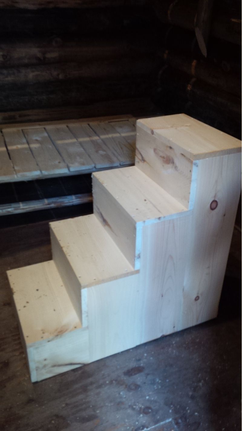

More pics
freestanding step stool/stairs

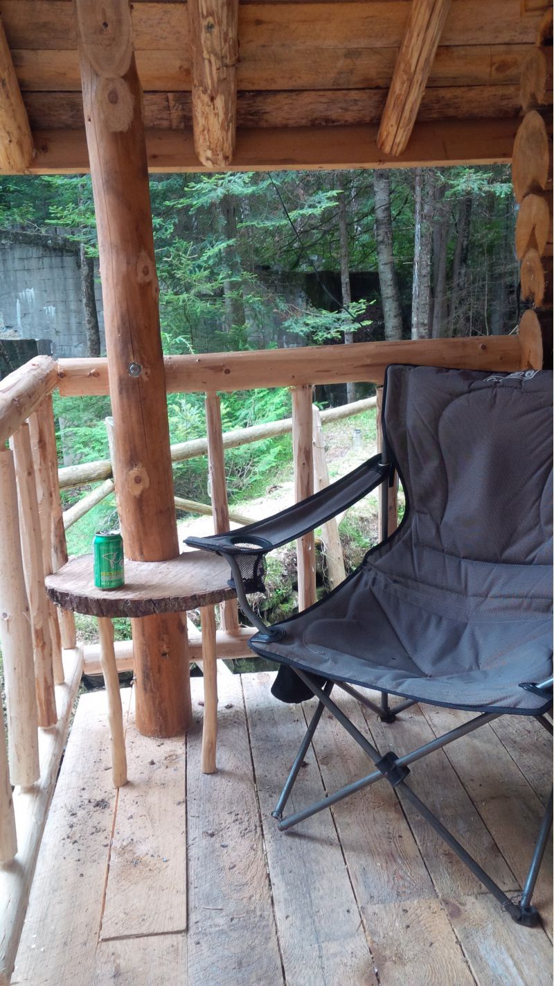

side table
side table

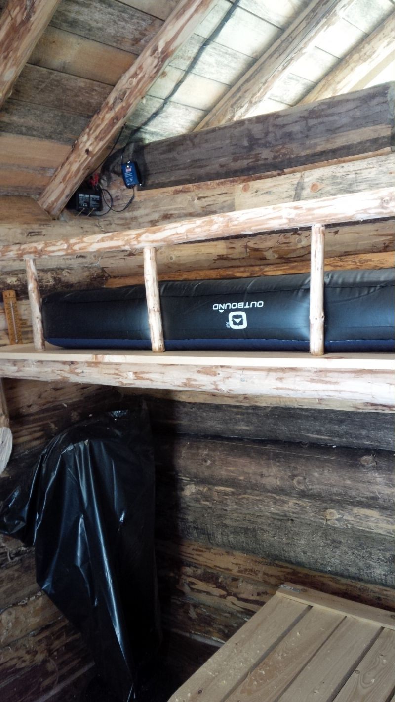

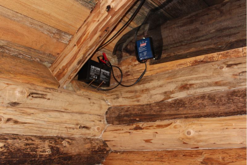

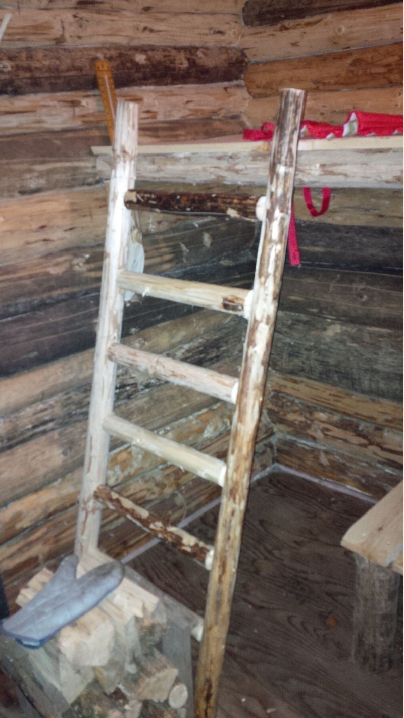

I used a jig on my router to make the tenons for the railings. Worked quite well and made it quick and easy. I also installed LED lighting inside, on the porch and some under lighting rope lights. They all run off a 12v 7ah small battery that is connected to a 40 watt solar panel.
ladder
ladder

battery
battery

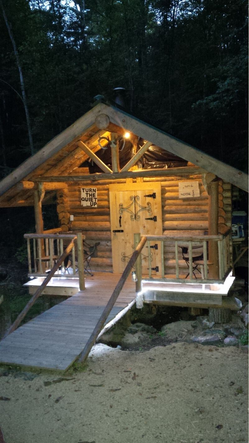

One final pic of the sauna and cabin together
cabin and sauna
cabin and sauna
