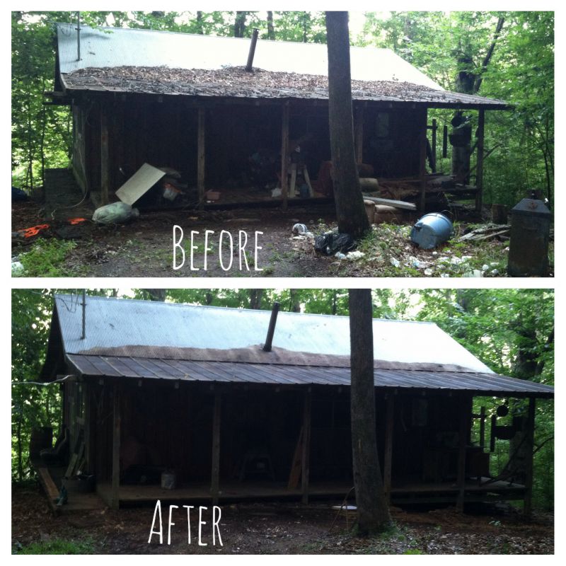

Just joined to share our new cabin. It's a 16x30 we recently bought on 8 acres. It was built in the late 90's from rough cut cedar and has been vacant for about 5 years.
We bought it from an old couple who are extreme hoarders. Needless to say the place was a mess! I'm not much on talking so I'll just post pics.
If anyone has questions feel free to ask.
A before and after cleaning up pic

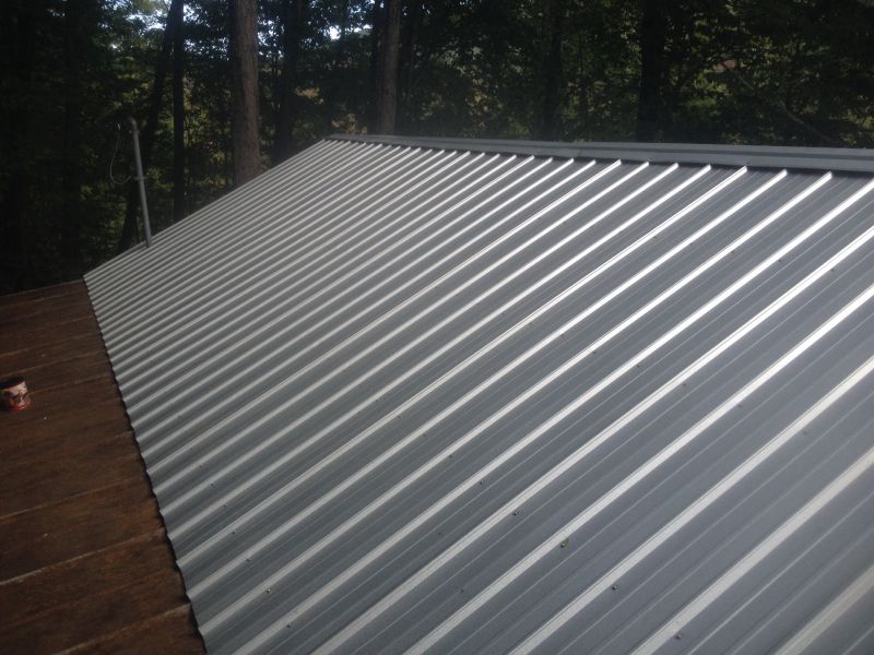

New roof! DIY by my wife and I

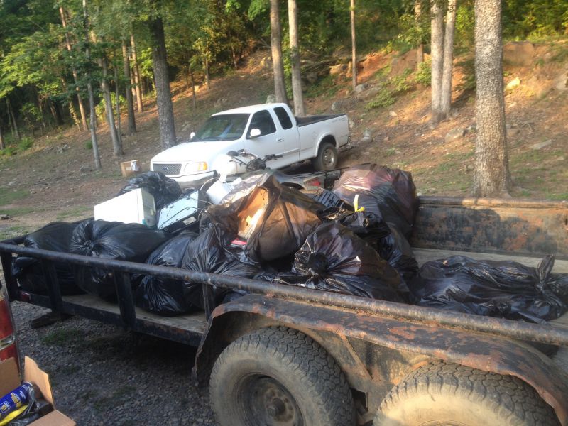

1 of 4 trailers of trash we hauled off!

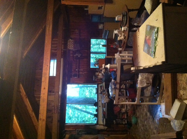

Pic from the first time I saw it

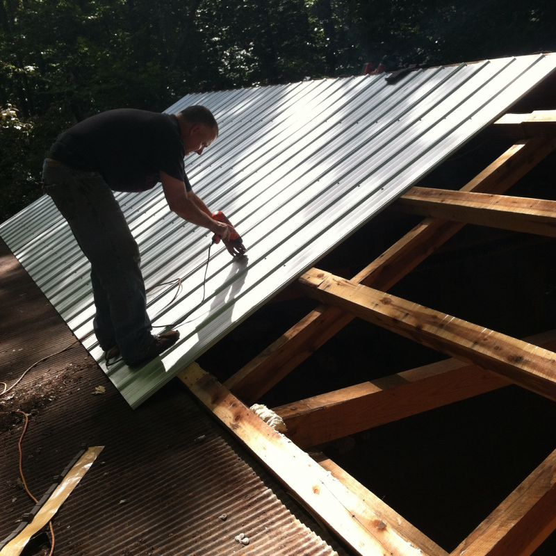

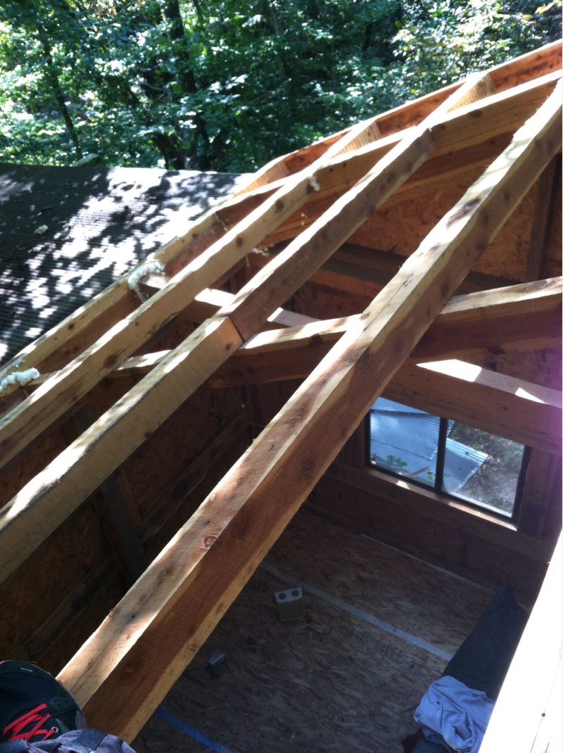

More photos. Notice the rough cut cedar 4x4 purloins and 4x6 beams!
Me installing roof panels

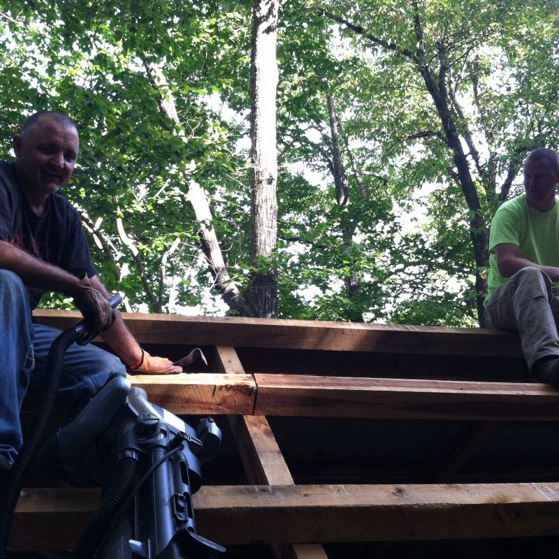

Me and my friend taking a break

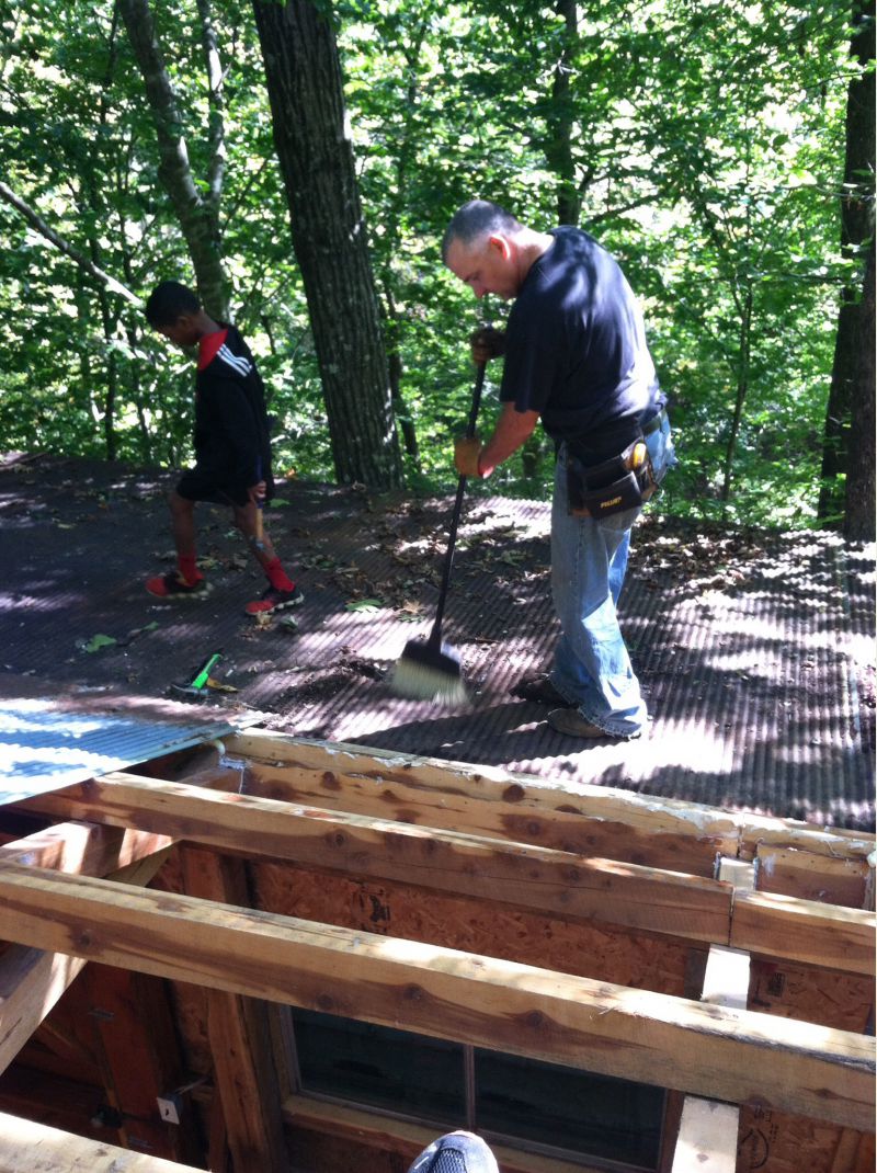

Me and my son sweeping porch and picking up nails
A shot down from the peak

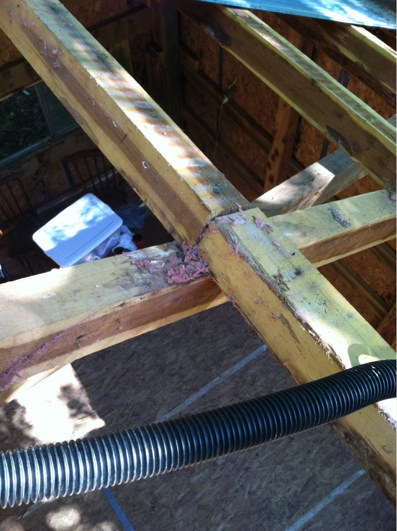

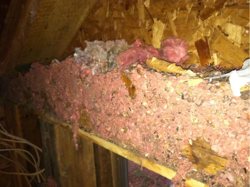

Here's why my wife used the vacuum on all the exposed purloins before the new roof went on

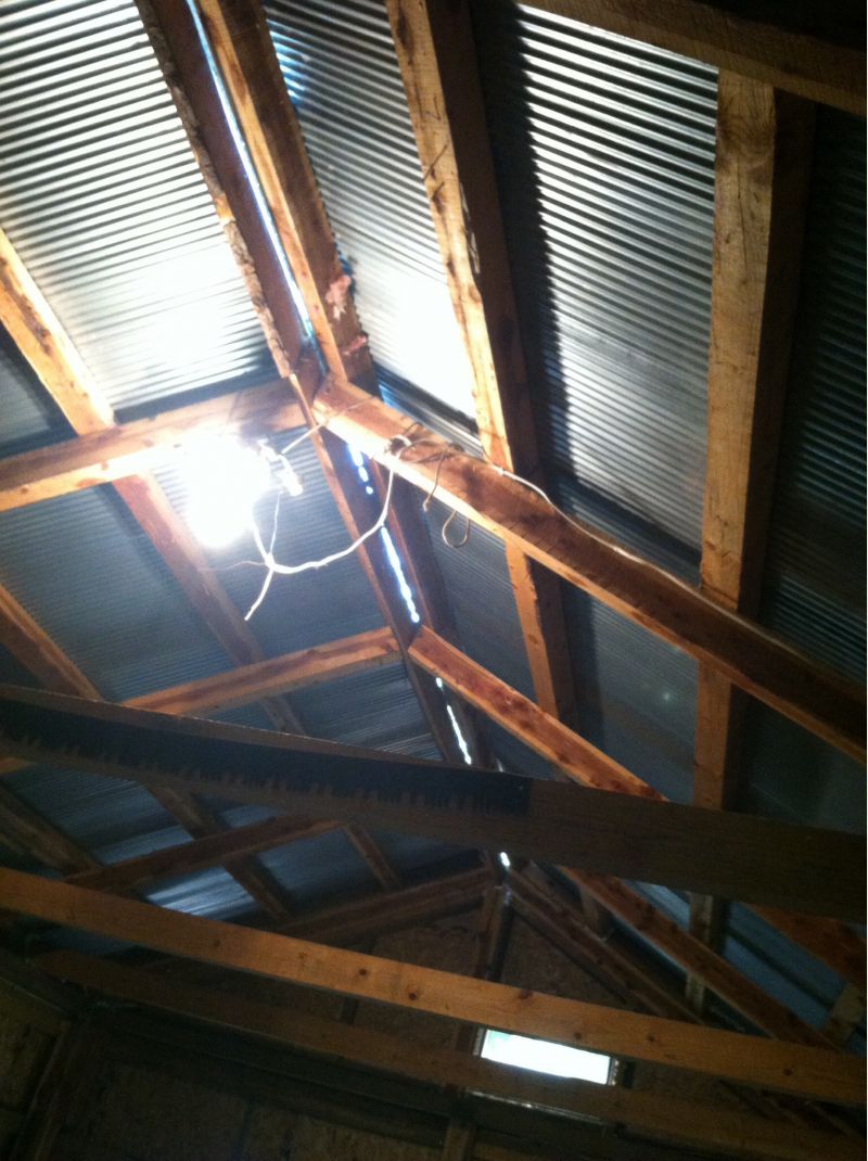

Shot of the old roof from the inside

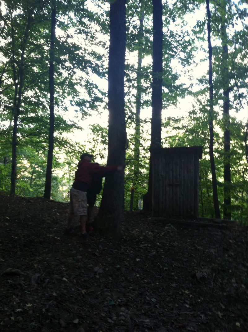

Tearing down a previous owners sign and our outhouse

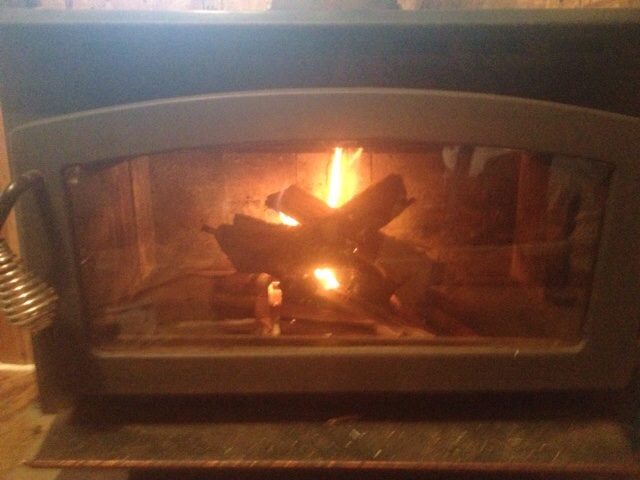

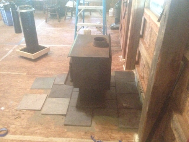

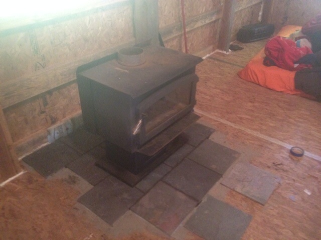

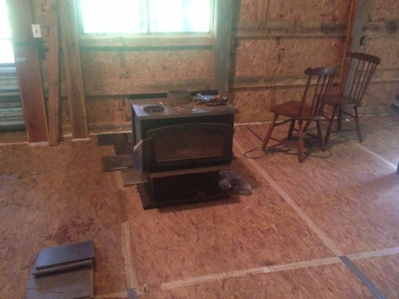

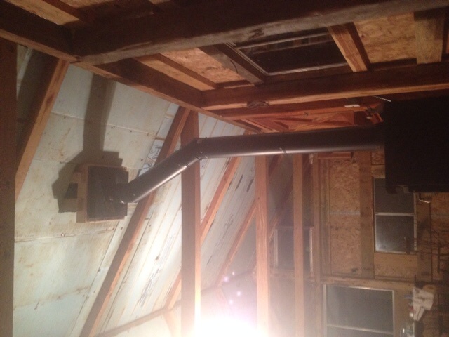

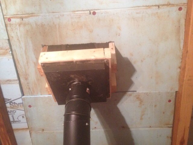

Update- We got a 3 day weekend so we headed up to the "Rat's Nest" after work on Thursday and stayed until Today (Sunday). We made a lot of progress. We got the stove set, stovepipe ran, and chimney placed. Stovepipe is single wall to the box and then triple wall thru the roof.

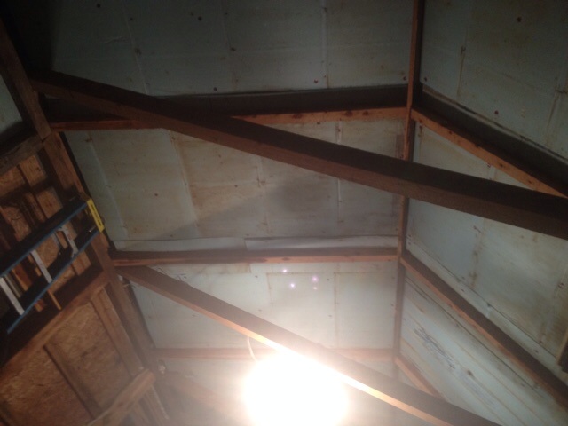

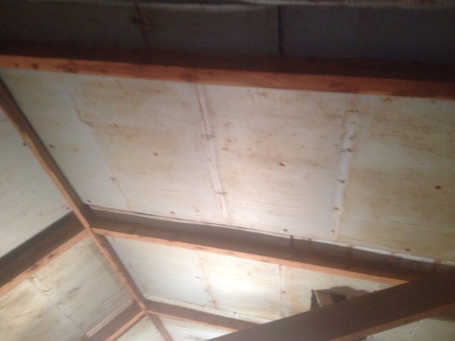

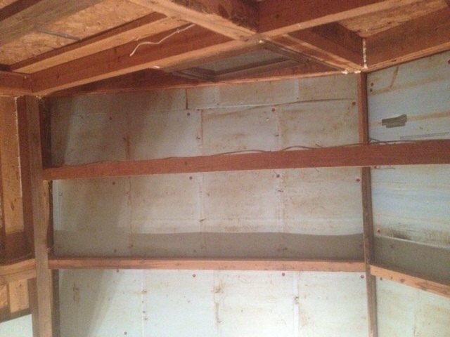

Then we insulated the ceiling. Winters here are mild, rarely below 20 degrees, so we are using blue board that was removed from poultry houses. It has an R factor of 7.5. That isn't much but our stove is rated for 2000 sq ft and our cabin is only 480 sq ft. I think we'll be fine.

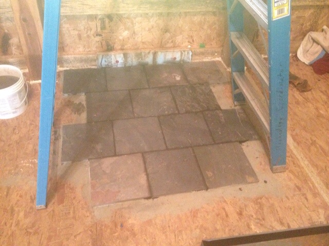

The slate is mortared directly to the blandex. I know I prolly should have used concrete board under it but I didn't have any with me and didn't wanna waste the time going back for it. I'm going to put a boarder around it. I'm sure it'll crack but since it won't be walked on I hope not much. If it does I'll just F-26 it back into place.
Anyway, on to the pics
Slate tile
Slate tile
Stove set in place
Stove set in place
Another stove shot
Another stove shot

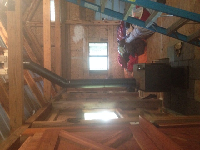

Stove pipe run
Stove pipe run

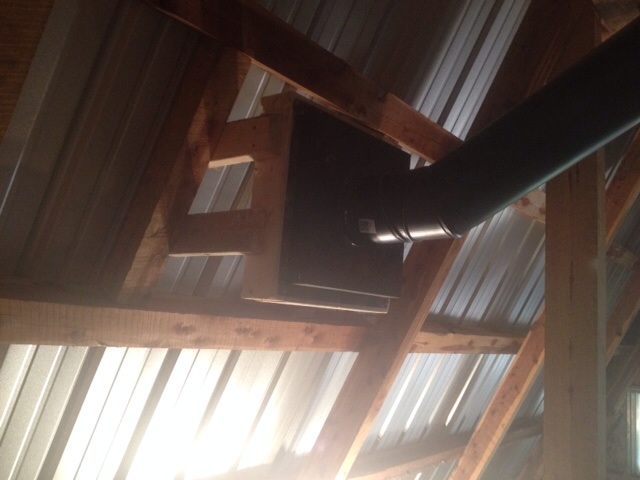

Cisco
# Posted: 26 Oct 2014 04:58pm
I'm not understanding why some of my pics come out sideways? Nor do I know how to fix it?
Support box for triple wall

Blue board insulation
Blue board and support box

More ceiling insulation

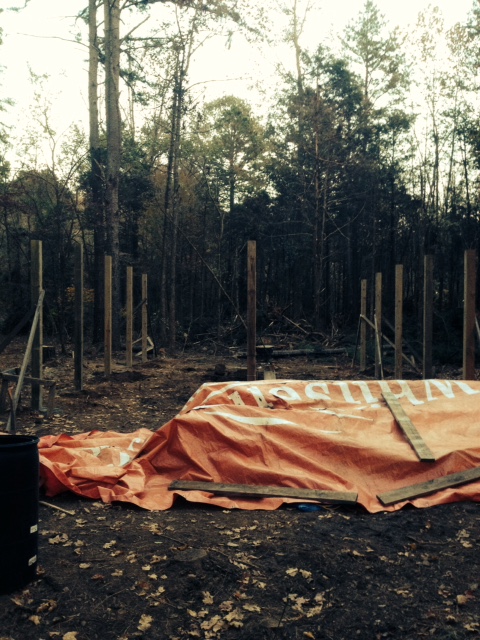

The land we bought was originally 8 acres. Our best friends ( in the pics above helping put on our new roof) split it with us. They got 4 acres and we got 4 acres and the existing structure. A creek divides the property almost exactly in half.
My friend is building his cabin across the creek and down the bluff from us.
Im not going to post many pics of his build but I will tag a few periodically.
Saturday and Sunday we hand dug 15 post holes 40 inches deep. Unfortunately we are digging in the old creek bed so the auger was useless. Needless to say I am extremely tired and sore from the post hole diggers and rock bar!
He is building his cabin 8 feet up in the air because flooding is a real possibility.

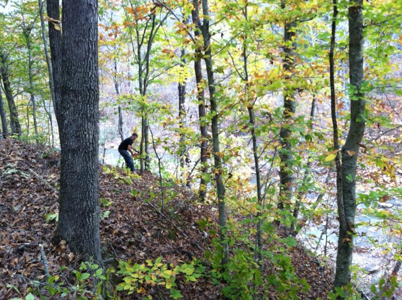

I am also including a pic of me cutting/trimming brush on the bluff my cabin sits on. You can see the creek in the background. My wife is taking the pic from our back deck.
Since I helped him all weekend this is my only update. Next weekend I plan to frame up my new interior walls.
Posts for My friends cabin.  We're about half done at end of day 1 here
Me cutting brush above the creek, back of my cabin

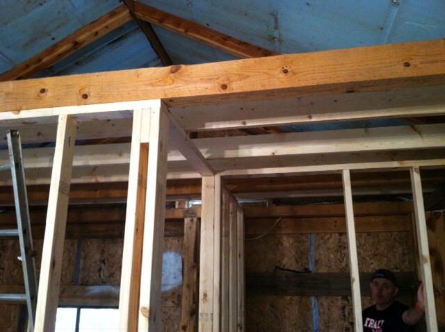

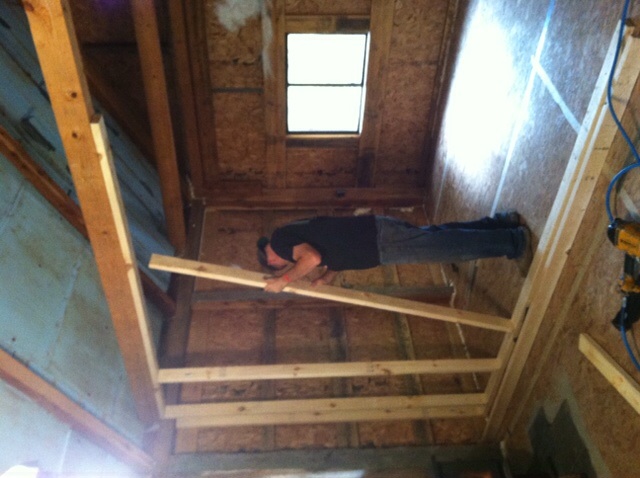

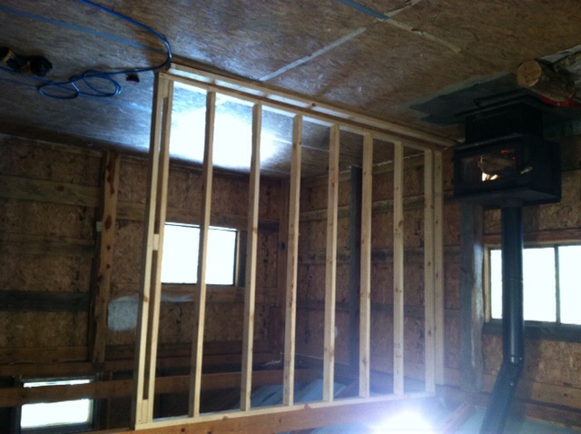

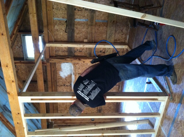

Update

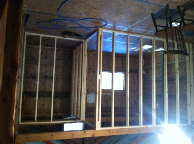

Went up today and got to work. Managed to get the stud walls built for the bedroom and bathroom. Also got the joists and Blandex in place for the loft.
Nothing in my cabin is square as the previous owner built the whole structure with a chainsaw!
So I built the walls in place rather than trying to build them and then stand them up. It could not have gone more smooth. To the pics...
Edit- all the pics are upside down or sideways. Sure wish I could fix that! Ideas?
Let the framing begin
Bedroom wall
Bedroom wall
Bedroom wall #2
Bedroom wall #2
Bathroom wall
Bathroom wall

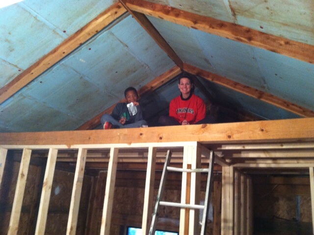

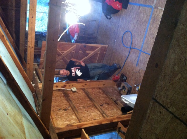

More upside down progress!
2x6 joists
2x6 joists

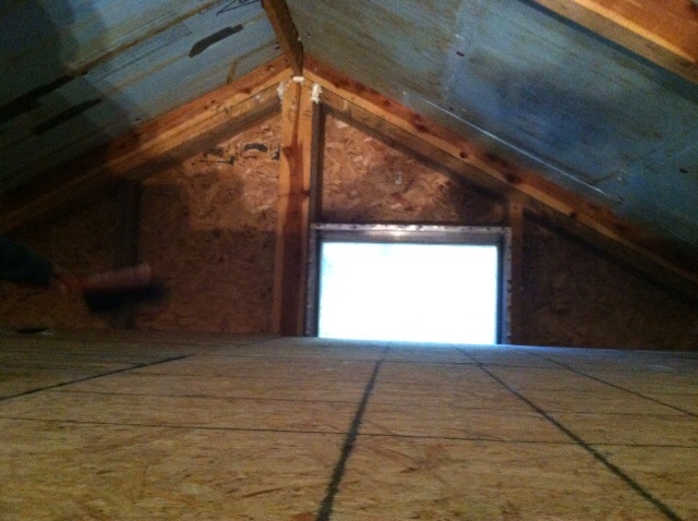

Loft/deck
Loft/deck
Wife and son enjoying his new "clubhouse"

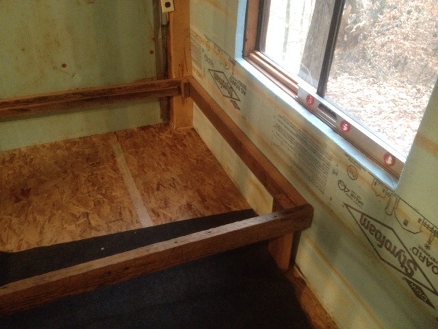

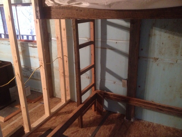

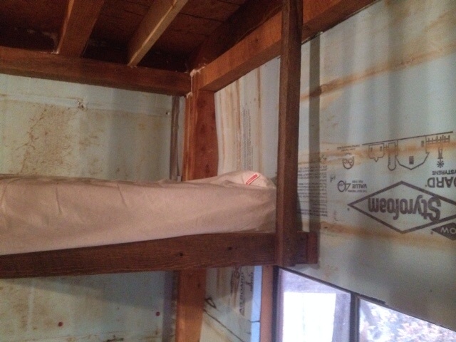

Been awhile since I've updated. Deer season has slowed progress but I did take a 7 point

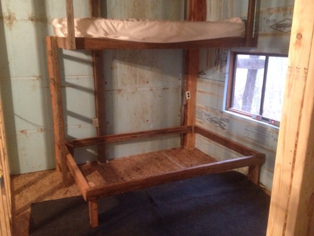

In the pics you can see I made bunk beds. They are made from some reclaimed oak slabs I found laying on the property. I ripped them on my table saw. Not the prettiest but functional.
Also you can see I got the blueboard insulation on the walls. I'm waiting to do anything else until I decide if I need another layer of board.
Made bunk beds
Made bunk beds
Top is a twin hanging from the ceiling
Bottom is a full
Bottom is a full
And my ladder.
And my ladder.

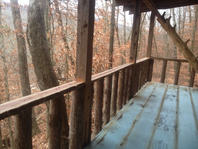

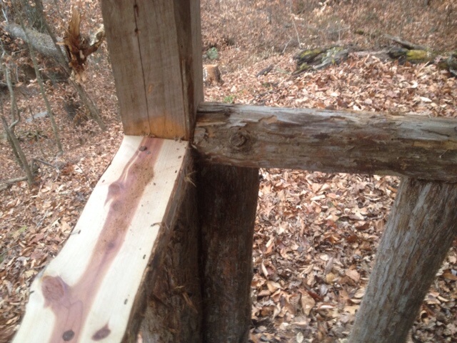

Also worked on my deck rail
I also ripped the deck rail so a drink will sit on it
Before on the right, after on the left

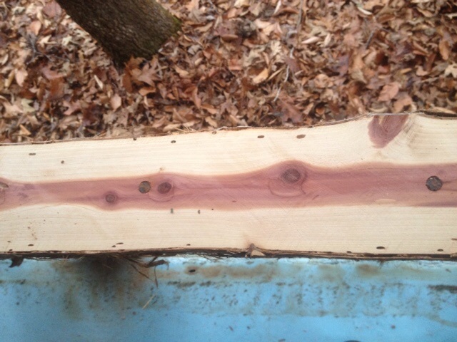

Cedar is so pretty
Cedar is so pretty

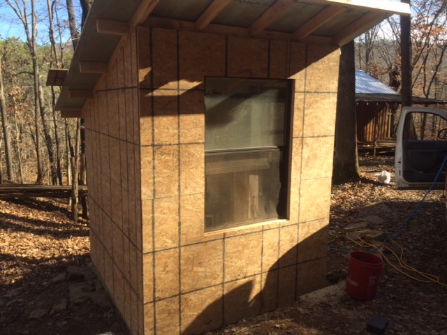

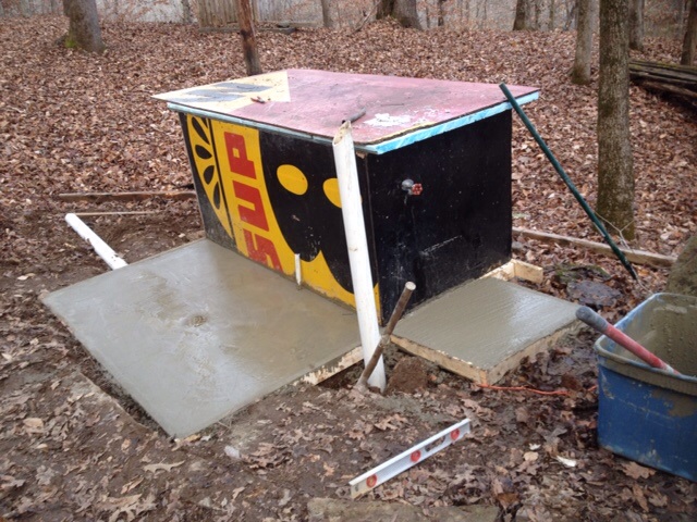

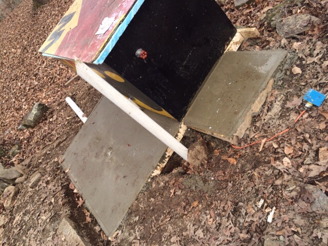

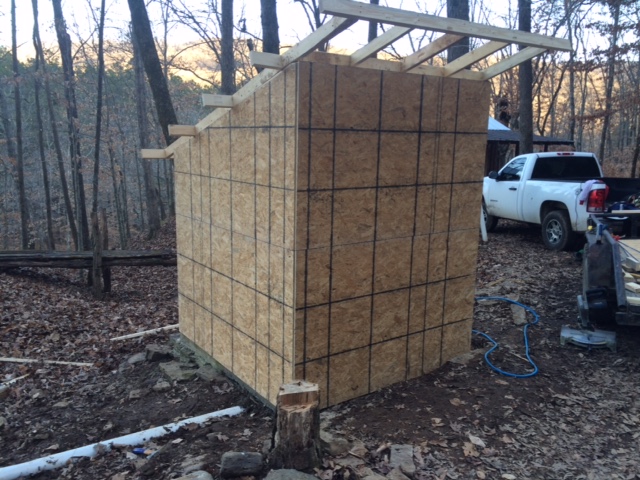

My well house is a sad affair. The previous owner built it from a reclaimed super 8 motel sign. just not my style.
So a rebuild is in order. I have an older friend who has a cabin and he was adamant that I build the wellhouse big enough to get inside it. He said when it's 10 degrees and I have a pipe burst (hopefully not) I'll be thankful I get to work in a enclosed area.
Sounded like smart advice to me! I also installed a drain so I can hang and process a deer inside it too! and I'm going to wire up 2-3 outlets and of course a light.
This weekend my wife and I mixed up and poured the pad extension. Took 14 bags of quickrete and we mixed it in plastic totes. Turned out well for never having done any concrete before.
I have to stop a minute and give credit to my wife. She works right along beside me doing at least 50% of the work. She is a small girl but she works harder and better than most men I know! We've been married 15 years and I couldn't be more in love and blessed!
But I digress.... The next pic is a huge rat I killed. It has been eating the deck wood and cabin siding like it was trying to get inside. For perspective that trap is one of the big 10 inchers!

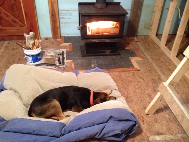

Lastly my big girl, Emmy, she's our rescue dog we got at 6 months. She 6 years old now and her hips are about shot. She loves a comfy bed and warm fire!
Poured and still very wet

And my big girl enjoying a big fire!

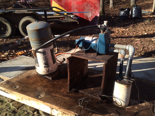

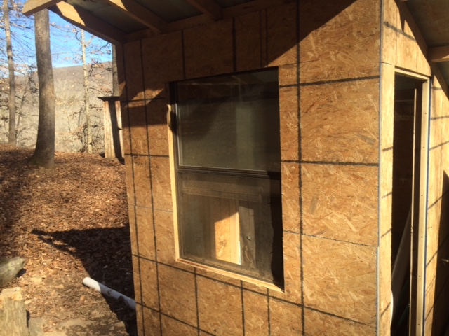

Made it back up this weekend and I got the well house 90% finished
window and door
window and door
pre window
pre window
front view
front view
pump/pressure tank
pump/pressure tank

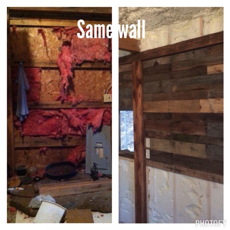

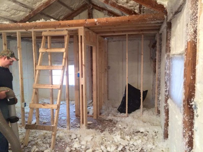

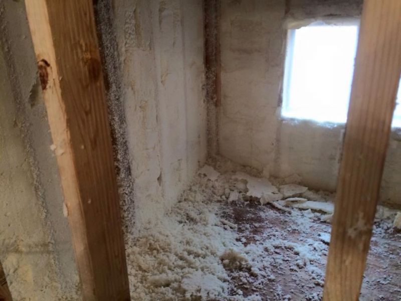

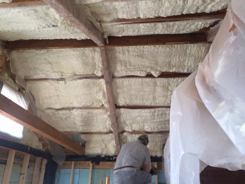

Update. So the blueboard just wasn't cutting it. So I went ahead and put studs in between the posts and had the whole place spray foamed. $1.26 a sq ft. So it wasn't awful. But with our mice problem history I felt it was the best option.
Spray foam bedroom
Spray foam bedroom

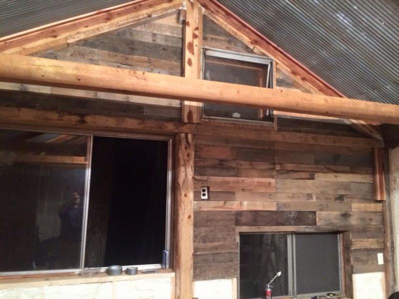

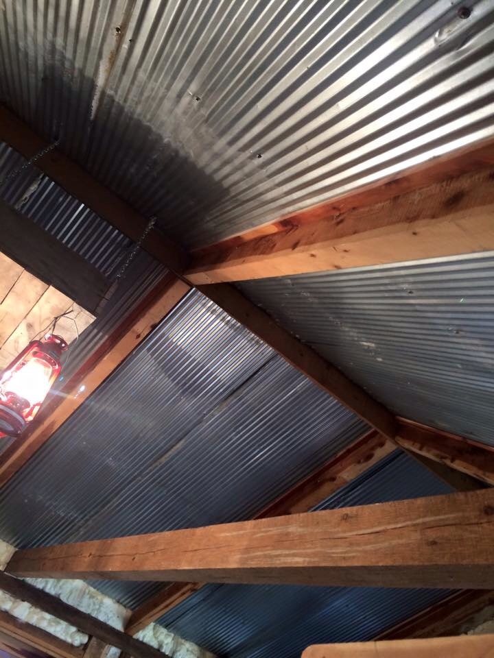

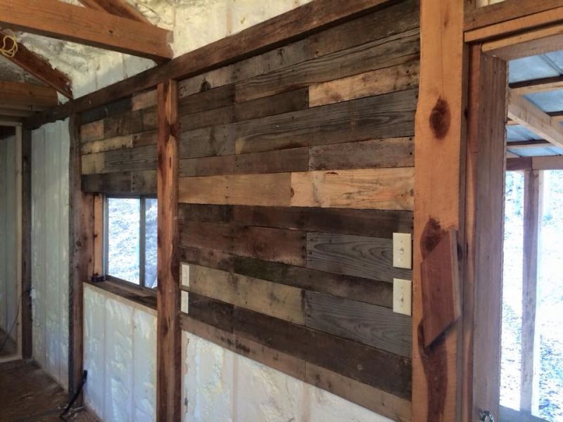

Started putting up my wall coverings. We have been collecting and taking apart pallets. I also put the old roof metal on the ceiling
Ceiling metal
Ceiling metal
Pallet boards on Gable wall
Pallet boards on wall
Before/after of the same wall

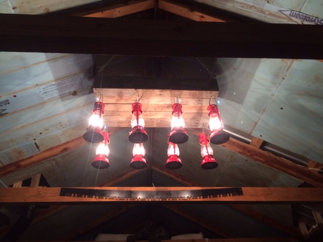

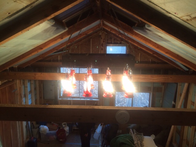

A light fixture I made out of pallet boards and lanterns. Machined out the lantern guts and replaced with light sockets
Side view
Side view
Underneath view
Underneath view
