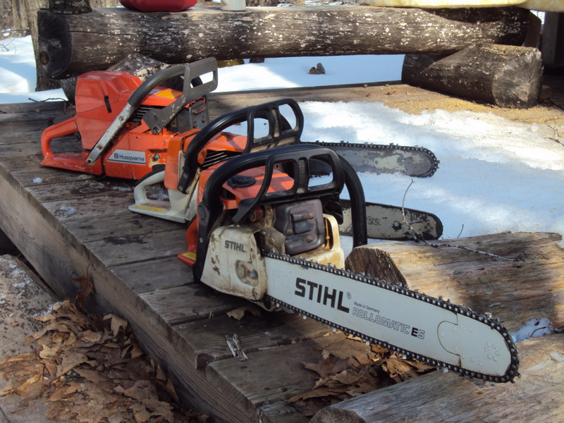

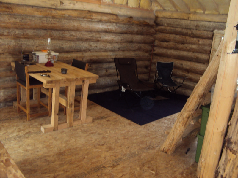

Excellent weekend at the Stump Ranch. Getting the chainsaws ready for spring.
|  Organizing the cabin, a little.
|  Fired up the Oliver 880.
|  The 4-dog stove kept things quite warm.

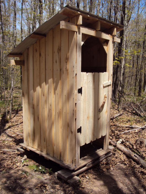

Weather is great. Bugs are bad. And, of course the wood ticks are out in force. But it sure beats 20 below zero. Cutting Some Trees.
|  Turning trees into beams.
|  Finished siding the outhouse.

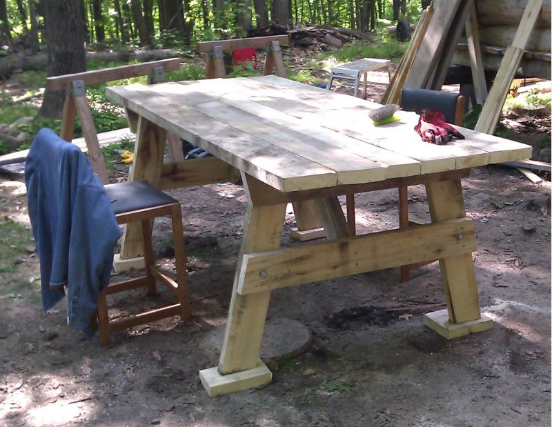

Spent a few days at the Stump Ranch working on some minor projects. Adding some window and door trim
|  Needed a place to sit outside
|  Getting organized
|  Made a new jig to deal with sawmill slabs

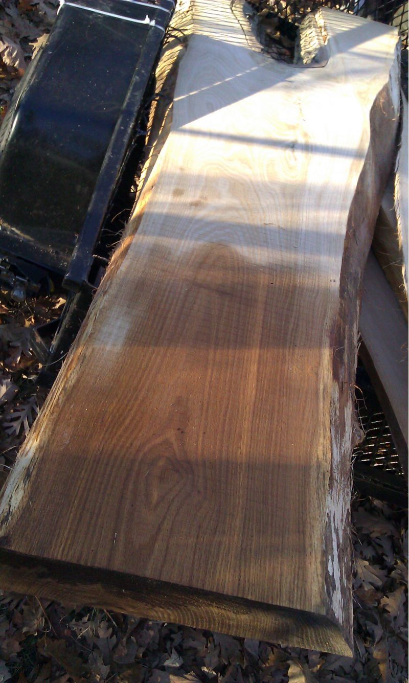

This week we were able to spend a day at the Stump Ranch; I fired up the TimberKing and cut a number of Red Oak slabs for winter projects. Afternoon Sun
|  New Wind Chime
|  TimberKing 1220
|  Red Oak Slab

fpw What kind of projects do you do with the red oak?
fpw

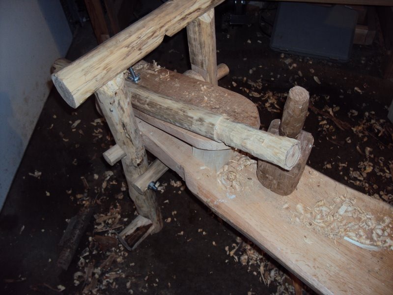

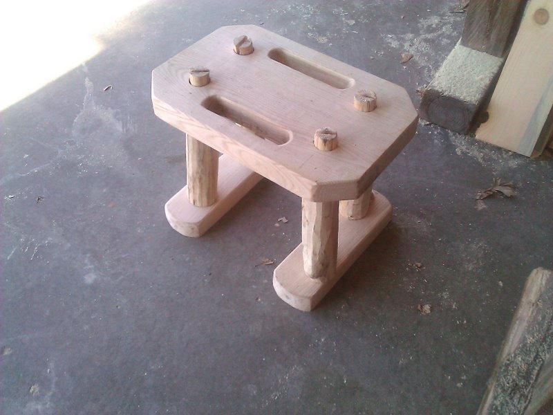

# Posted: 17 Nov 2012 10:16pm
Neb,
I cut this log into 2 and 3 inch slabs that I will use for a tabletop (I need a coffee table at the cabin). Then, using a shaving horse I will make up some legs. Shaving Horse
|  Stool
|  Working on a foot stool

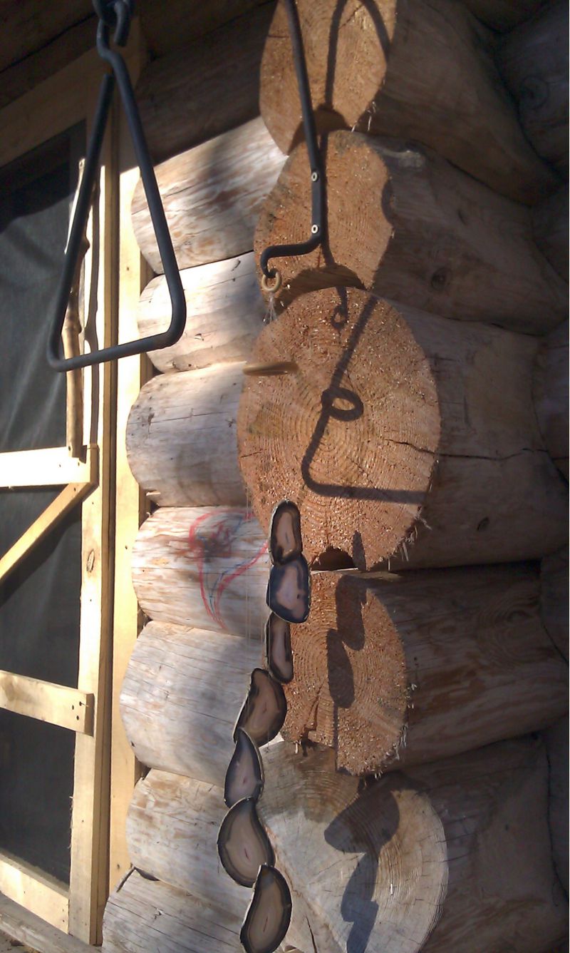

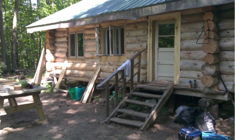

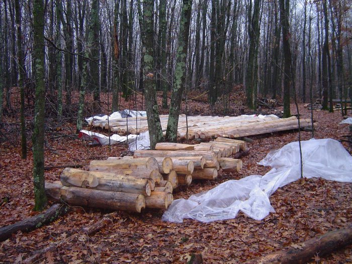

I cut the wall logs for the walls in a field near my house on weekends. It took about a year. Then, I marked the walls so you could put them back together, disassembled the walls and hauled them north to our property. I had to haul them in to the site one at a time with ATV and log arches. I hauled them in late fall so the logs sat covered in snow till spring when I assembled them.
There are many ways to do a foundation for logs, this one worked. Since I have no power at my site and everything has to be done by hand, I elected this route.

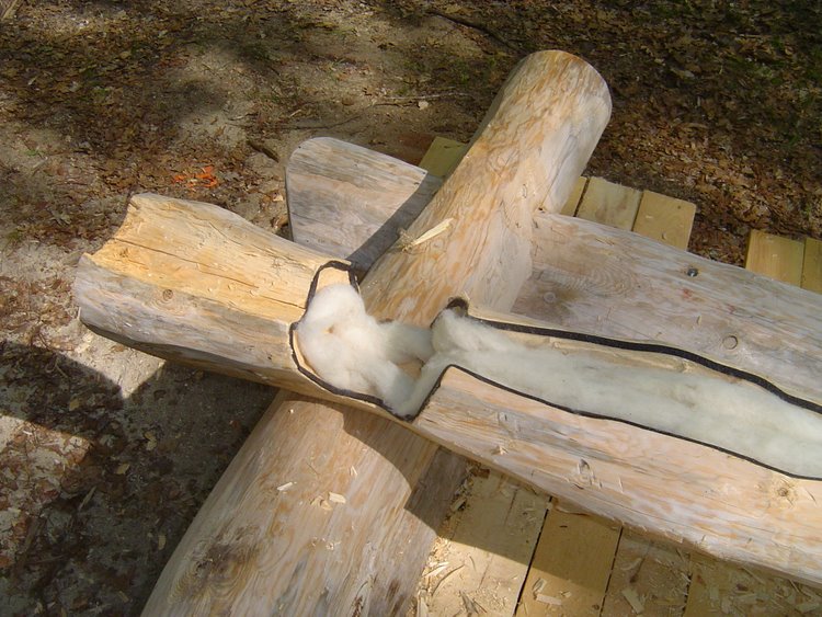

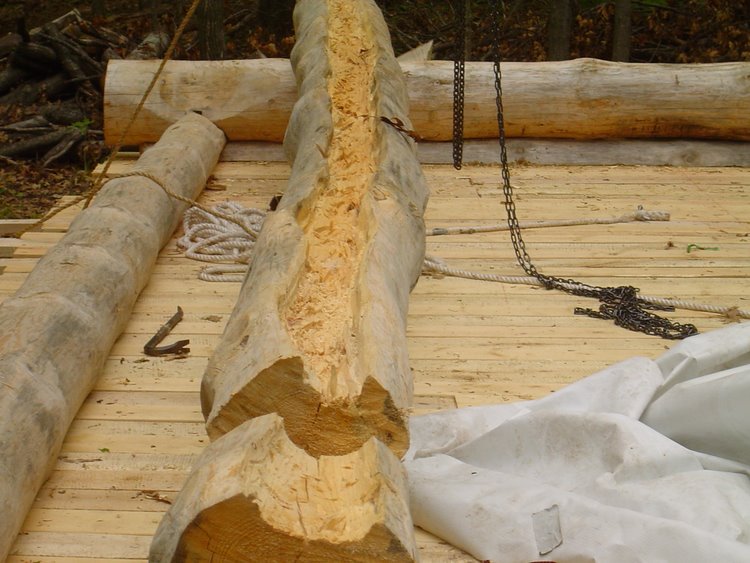

leonk
# Posted: 21 Apr 2013 11:09am
Thanks. What kind of wood is that? Did you use anything as insulation between the logs? Did you overscribe the lateral grooves?
Thanks
fpw
# Posted: 21 Apr 2013 11:59am
The walls are Red Pine. The roofing system is Aspen. I used Aspen as that is what is available on my property.
Insulation = EM seal (tar foam strip) and wool rope in the lateral groove and notches.
Lateral grooves are overscribed. A little more on the bottom half of the building a little less on the top 1/2. DSC02574.JPG

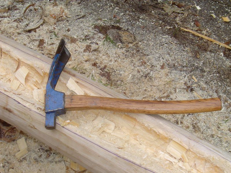

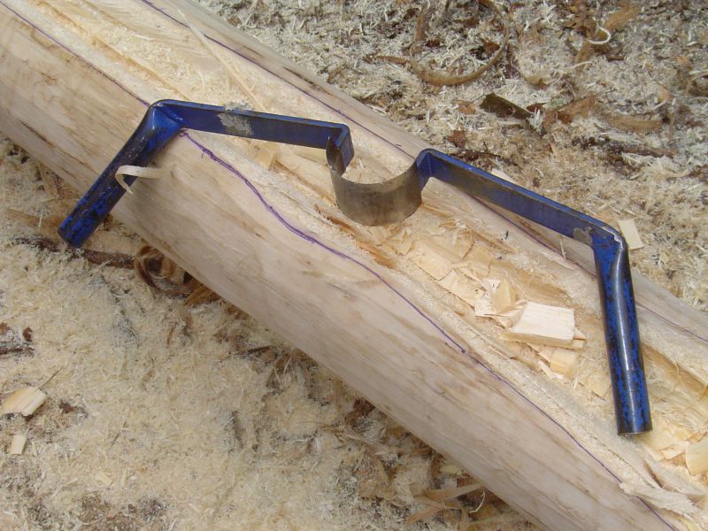

exsailor
# Posted: 22 Apr 2013 08:22am
Interesting tool you have to cut grooves for the insulation in your logs. I have never seen a draw gouge before. Looks like it would be a bear to get the groove started with that much cutting offset.
fpw
# Posted: 22 Apr 2013 01:02pm
Exsailor,
You are correct no way you would cut the groove with the handlebar gouge.
I cut the lateral groove with a chainsaw (about 1/4 from scribe line). Whack out the wood with an adze or axe. The handlebar gouge is used to cut the last bit of wood to the scribe line.

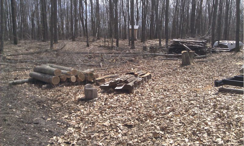

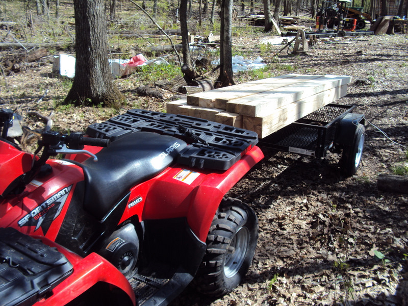

# Posted: 6 May 2013 09:13pm
Finally made it north this weekend, after shoveling out from 18" of snow in Red Wing, MN last Thursday.
I've been fighting the sawmill for a couple of years now, so I finally decided to clear our some space for storing logs, drying lumber, and providing enough space to move the tractor around.
It will take a another weekend, but once I finish up, I will be quite a bit more efficient running the mill. And, with all the project I have in the works, this will save me a butt-ton of frustration. IMAG0739.jpg
