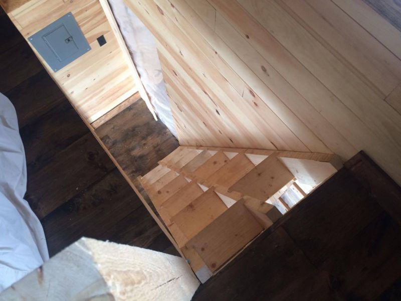

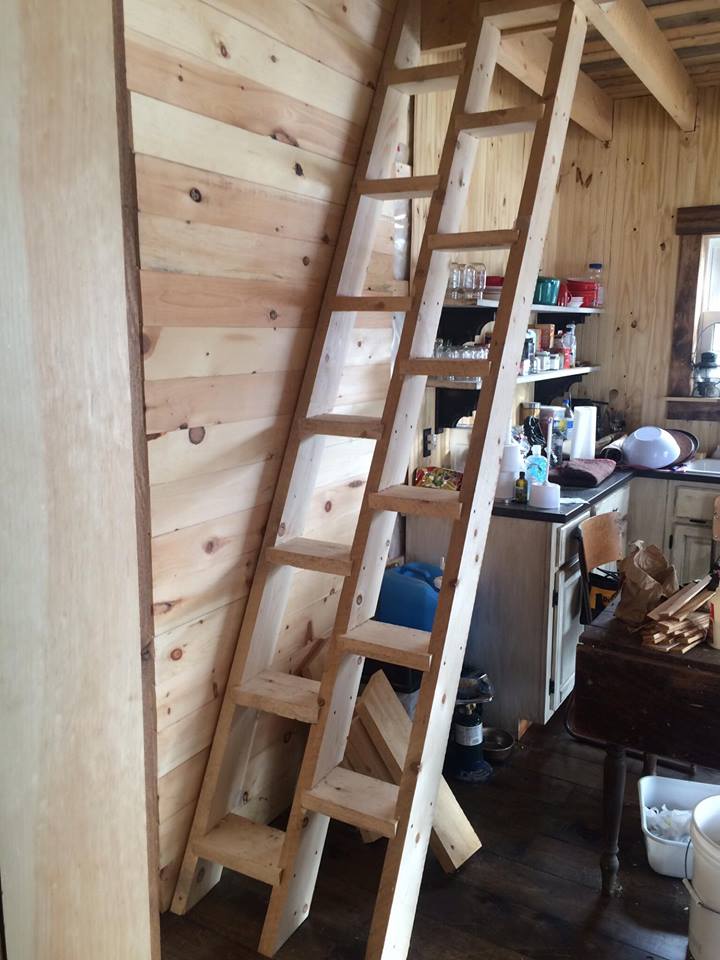

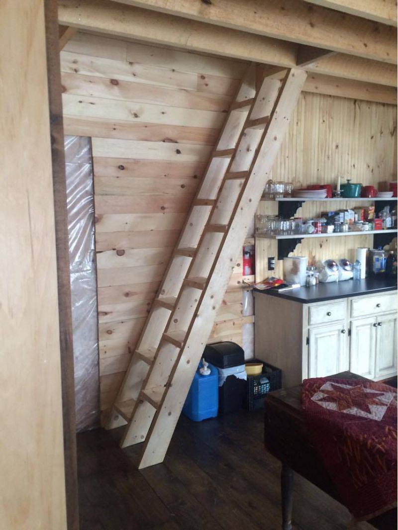

I would love to see some different pictures of the staircase. I am interested in seeing how it looks in the room, how much space it takes up, and how it connects to the loft. Thanks!
Scott G
# Posted: 8 Jul 2016 09:57
Here's some pics. Doesn't take up much space. It's steep but it climbs and descends well - took a bit of getting used to.![stair01.jpg stair01.jpg](https://www.small-cabin.com/forum/shared_files/uploaded/5152/100280_1.jpg) stair01.jpg
| ![stair2.jpg stair2.jpg](https://www.small-cabin.com/forum/shared_files/uploaded/5152/100280_2.jpg) stair2.jpg
| ![stair3.jpg stair3.jpg](https://www.small-cabin.com/forum/shared_files/uploaded/5152/100280_3.jpg) stair3.jpg
