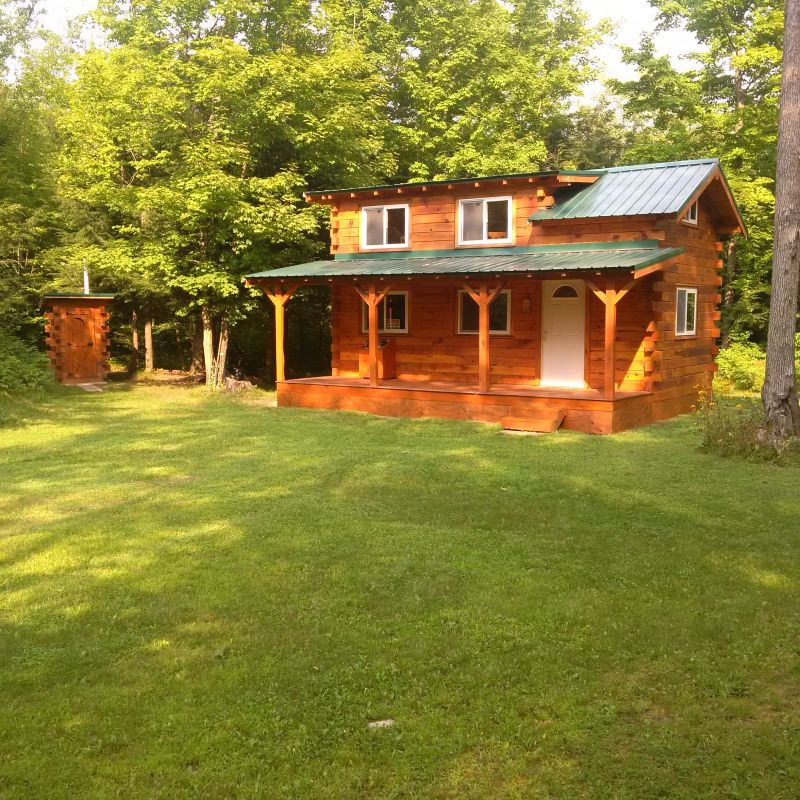

Finally finished, insulated the underside of the cabin with foil faced sheet styrofoam and skirted it with treated plywood and then stained to match the cabin. Got a new Lopi woodstove to replace the simple cast iron stove, and will get it installed by this fall and the start of deer hunting season.

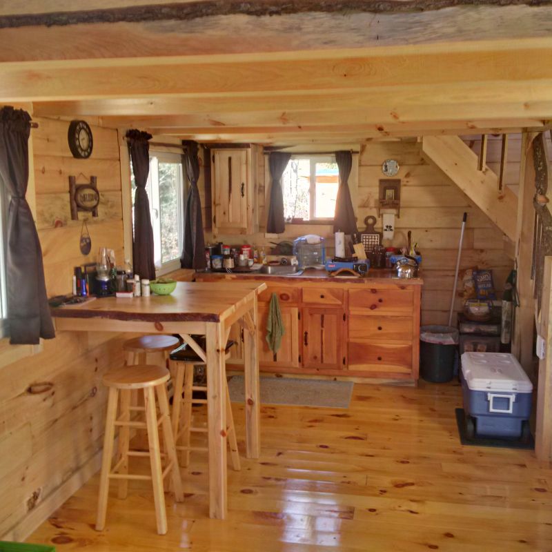

I'm sure it could have. Up here and to be above board code wise it would have to be 2x6 construction to get the added r-value the thicker walls provide with the correct insulation. At least that is the way it is for new homes, I assume a building permit for a cabin if used year round would be the same. I like the idea of a metal roof, over shingles for ice, snow and in the summer shingles start to get moss covered on cabins in the woods. My cabin is really solid, but it takes awhile to get all that wood mass warmed up in the winter. But once warmed up, it really retains the heat. For me, it is more of a 3 season cabin. After New Years and hunting season is over, I might not get out there until early spring again. A stick built may have been more around $10K? I recently installed a table in my cabin which I mounted to the wall......Amish built with the tree bark live edges, and 3 stools.

The floors came varnished. My interior walls are natural with no finish.

Looks great! You may want to consider adding some type of vents or screens in the plywood skirting if you haven't already done so to cut down on moisture building up underneath.
KeithC
# Posted: 31 May 2019 07:18am
Thanks! Yes, I have some small vents in the back of the cabin to help get some air through the crawl space underneath.
