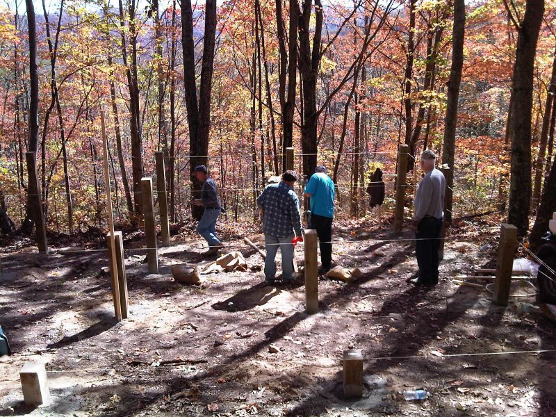

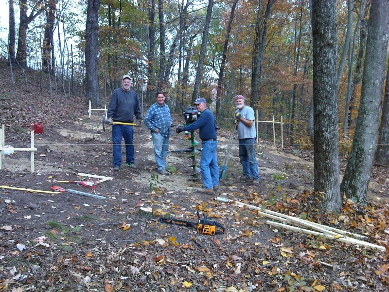

Here are pics of the initial "ground breaking". I was able to get the posts set with the help of my Dad, Uncles and my cousin's husband (who lives on another part of the farm).
Cabin Site before work started
Locating holes for foundation posts
You can see the change in grade here
Posts finally squared and set

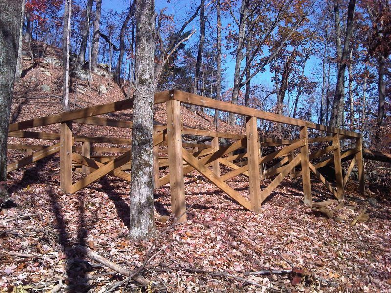

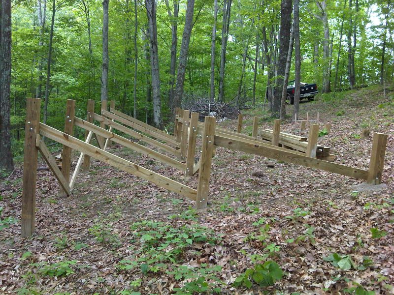

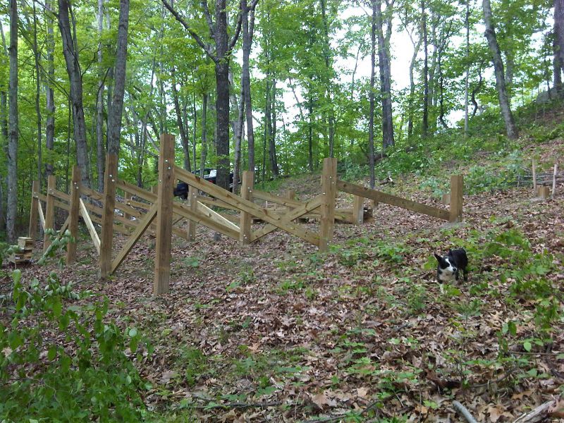

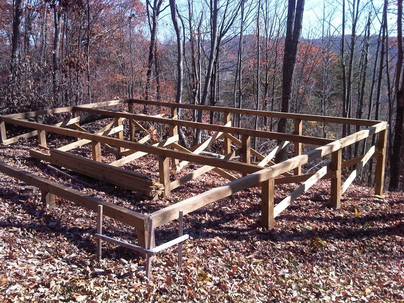

My second trip to work on the project was to install 2X8 cross bracing on all of the posts. When I left town after the posts were originally set, I temporarily cross braced them with a bunch of tobacco stakes that we had on the farm so that deer wouldn't knock them out of line until I got back to do the bracing.
After I got finished with the bracing in the pics, my cousin's husband said that it looked like I was building a train trestle! I always feel that something worth doing is worth over-doing!!
My uncles were kind enough to come back after I left to head back home to Texas and add the 4x6 runners across the top for me.

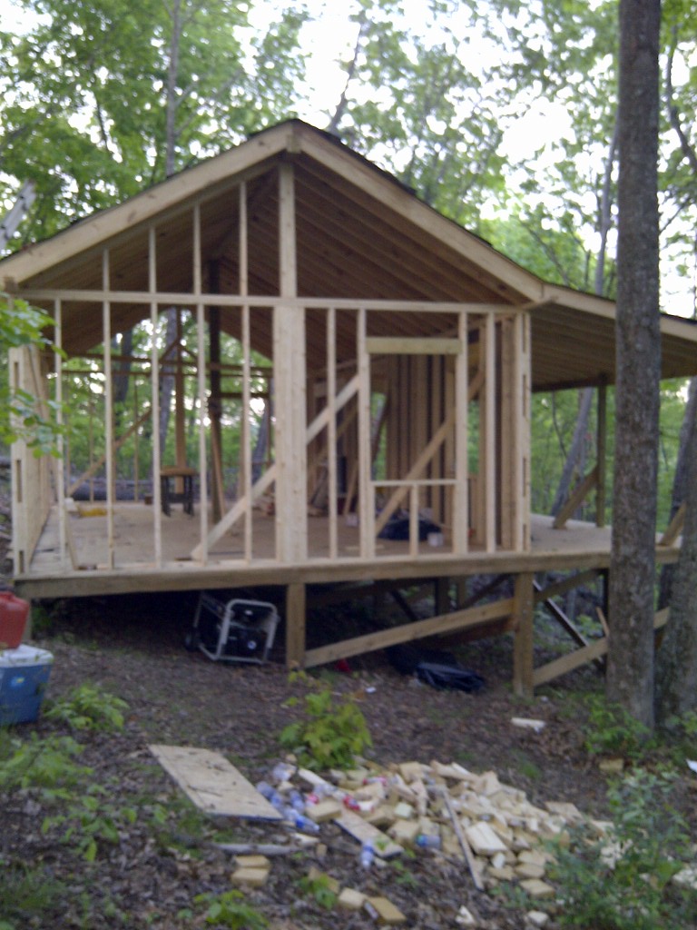

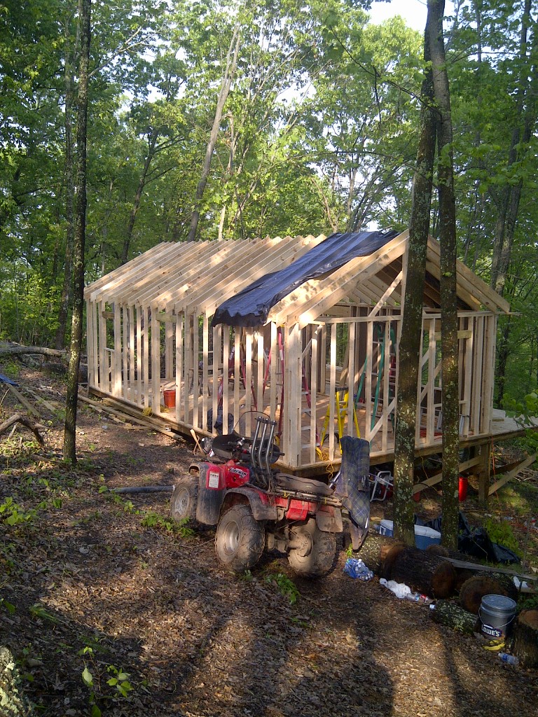

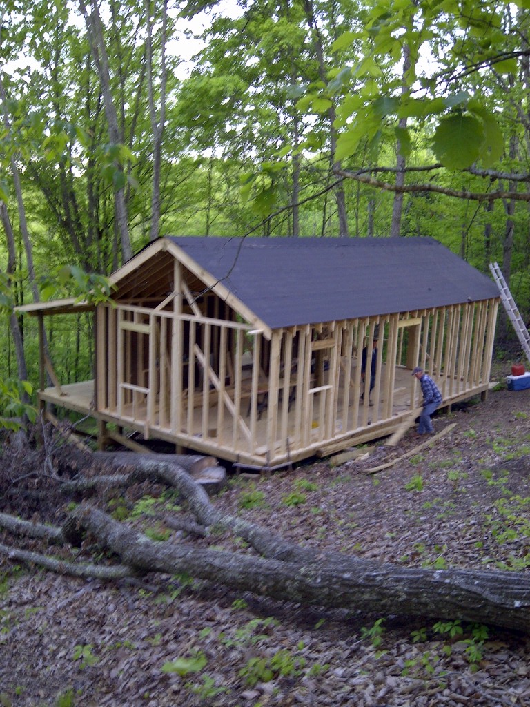

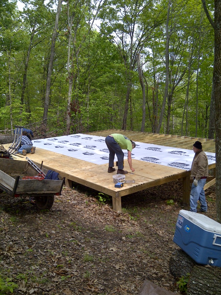

Once I had the foundation prepped, it was time to get serious! My next trip was going to require taking the cabin from foundation to "under roof" in basically a week. We were able to get it done in spite of losing one day to rain.
It was a lot of work but the hardest part was getting the 32' laminated beam set up on the main posts. It was touch and go when we got it toward the top and I think we only managed to force it up because we realized that we going to end up in the hospital if it slipped before we got it set on the posts!
The only real mistake that we made during the construction process was to start the stud location on the back wall from the opposite side as the front. Rookie mistake....but I chalk it up to doing too much too fast. We got it corrected though, and basically the back wall just has quite a few more studs that it would have originally. Like they say, "if that's the worst thing that happens, we're in pretty good shape".

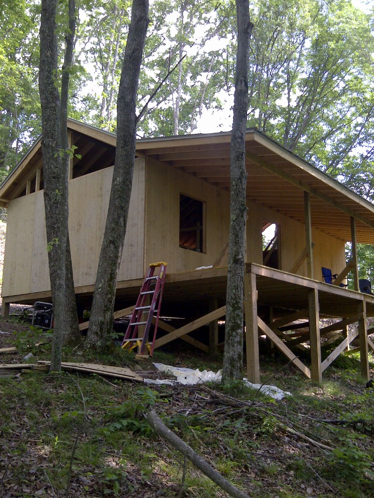

Here are some other pics from the original framing process...
It was hard to walk away from it at this point, and head back to Texas but we were all exhausted from a busy week. We had plenty of laughs and fun doing the build, but we were tired to say the least!
My uncles and my cousin's brother, came through for me again and put the metal on the roof after I had left. I had planned to get that done before I left but the rain, had other plans. The Man above smiled on us all week and gave us the time to get it under roof so I considered myself blessed to get so much done in such a short window of time!

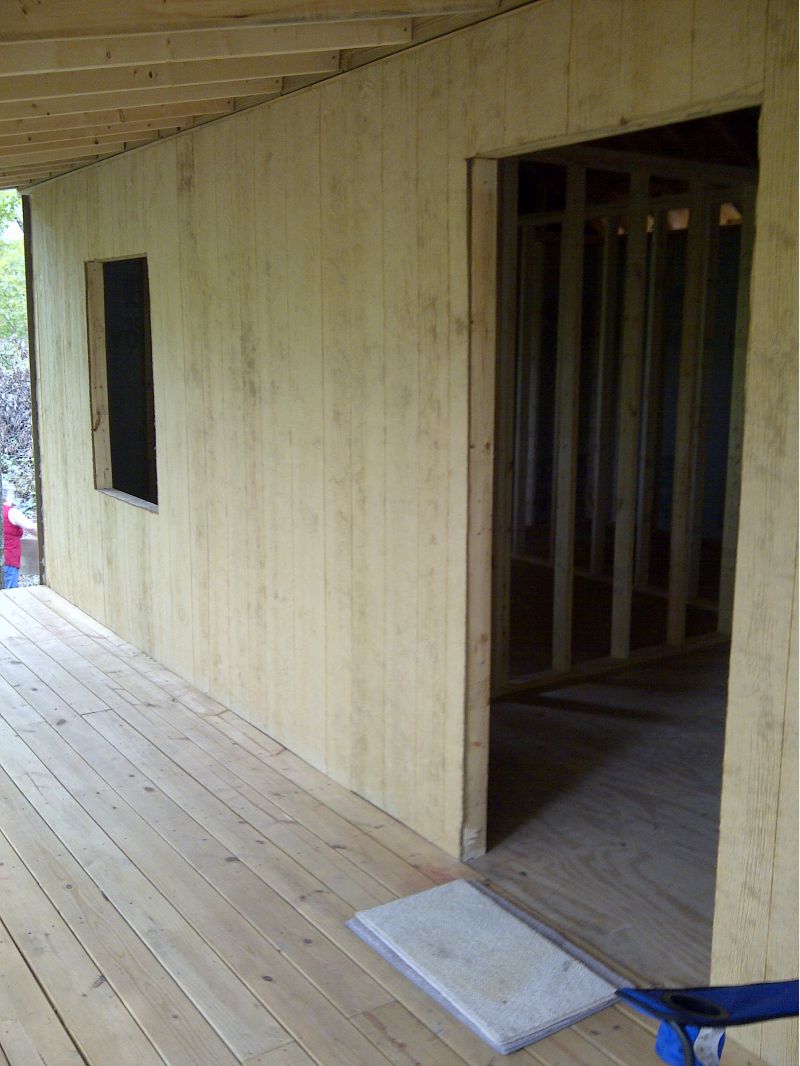

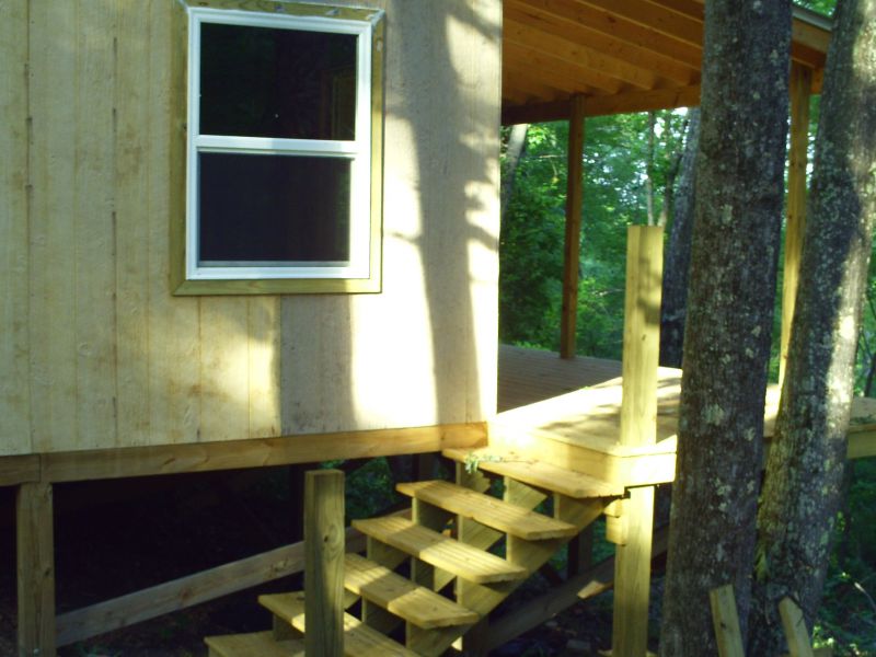

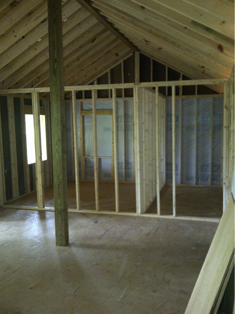

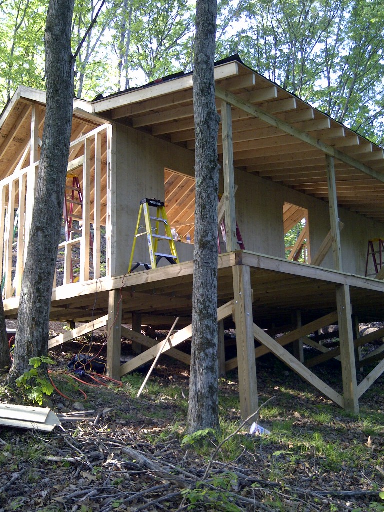

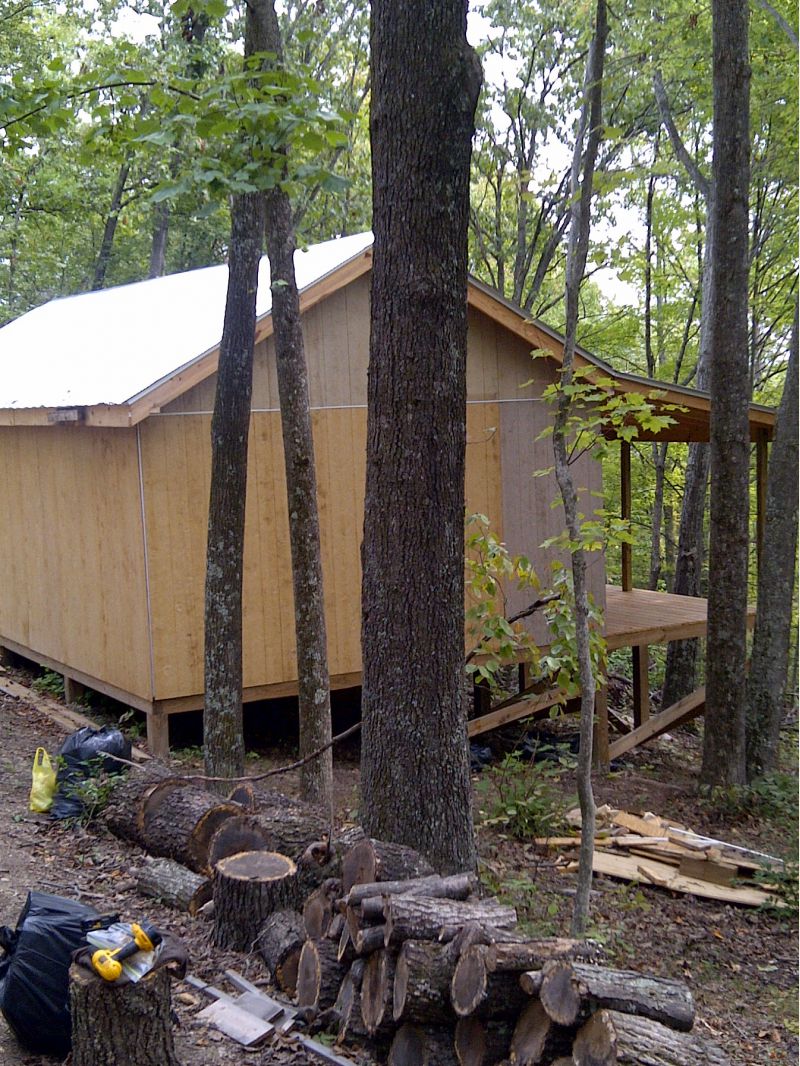

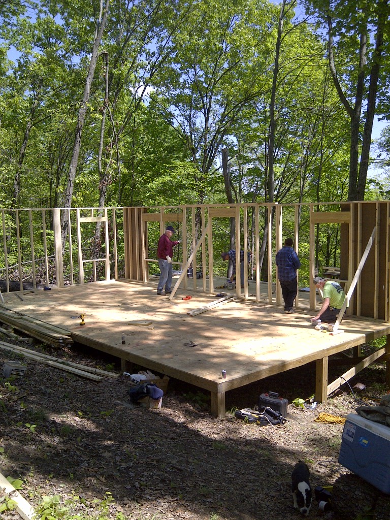

The next trip that I made, we got the gable ends closed up and the interior walls put up. The cabin will have a bedroom and bathroom, with stairs going up to a loft.
I also built stairs going up to a landing at the end of the porch. It was getting old having to use a ladder to get in the cabin every time since the porch is six feet off of the ground.
This was taken after I got the windows in later

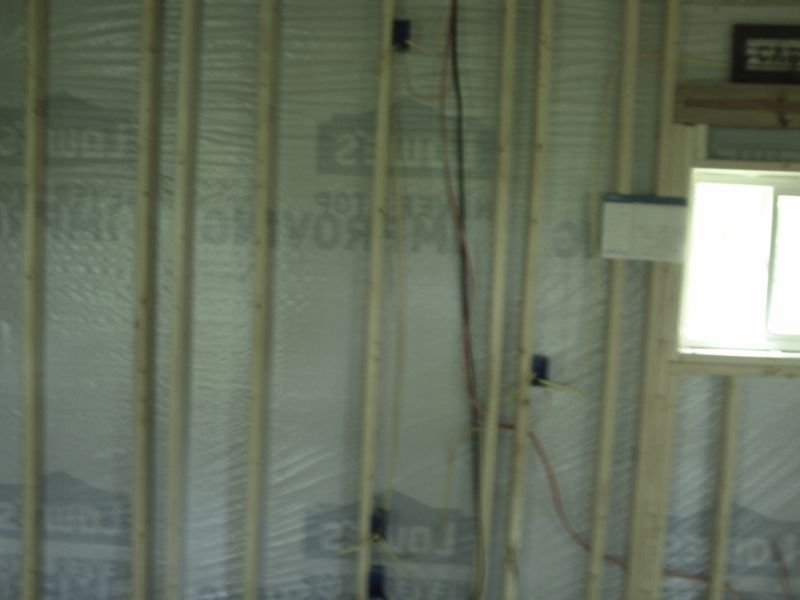

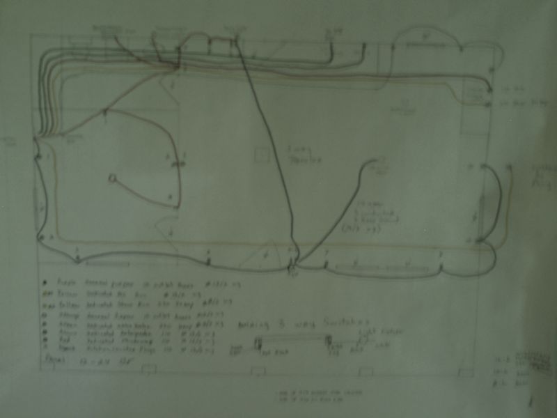

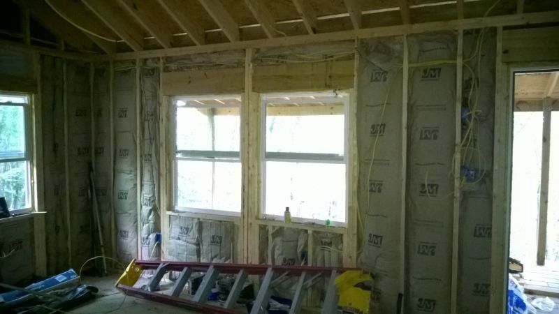

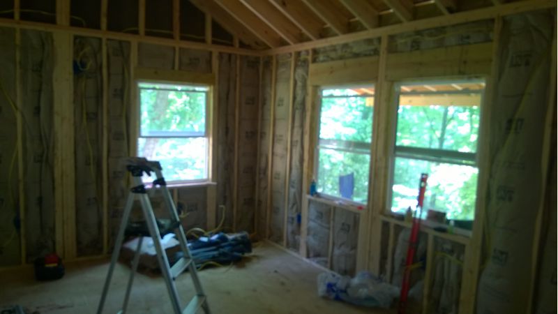

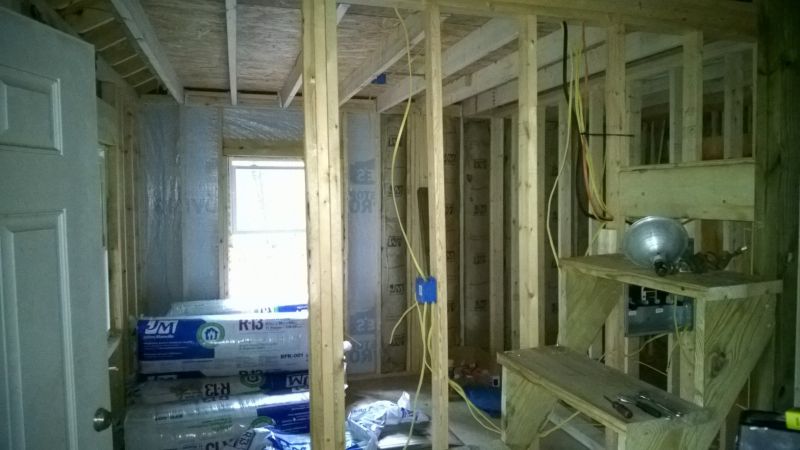

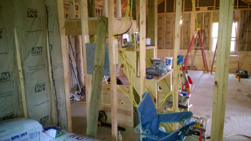

Almost a year had passed before I was able to carve out another full week to get back to WV and make a lot of progress but we made the most of the time.

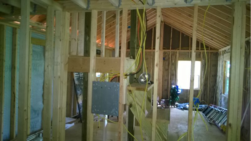

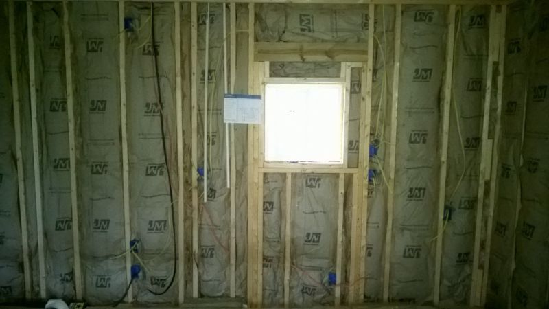

My boys were able to get back to WV with me this trip and they were a big help with running the electrical.
During this trip, we were able to install the electrical; and windows; built a furdown for the mechanical stuff; roughed in the plumbing; and decked the loft.

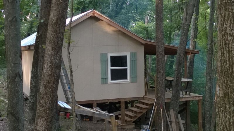

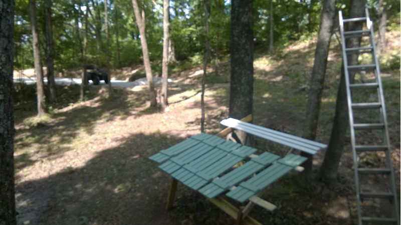

We made a lot of progress during my most recent trip. My brother was able to make the trip for a few days. My uncles and parents were there to help me again and it was nice to have so much of the family together on the old farm.
During that week we were able to paint the exterior; install some of the insulation; build the loft stairs; frame the loft rails and loft storage; put on shutters; and get gravel put down on the driveway.

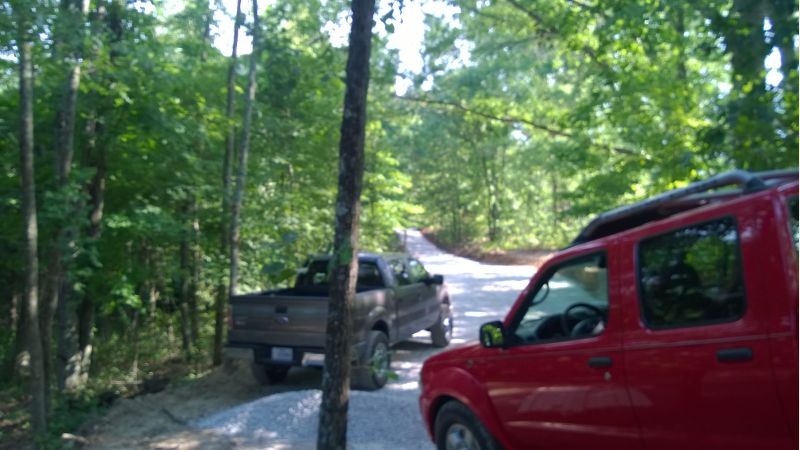

My Dad found someone to grade the driveway for me, and then he called in some favors to have guys drive dump trucks all the way up the hill and put gravel on the driveway. It made a huge difference in the way the place looks, and it the difference is night and day when you drive up there to do work!

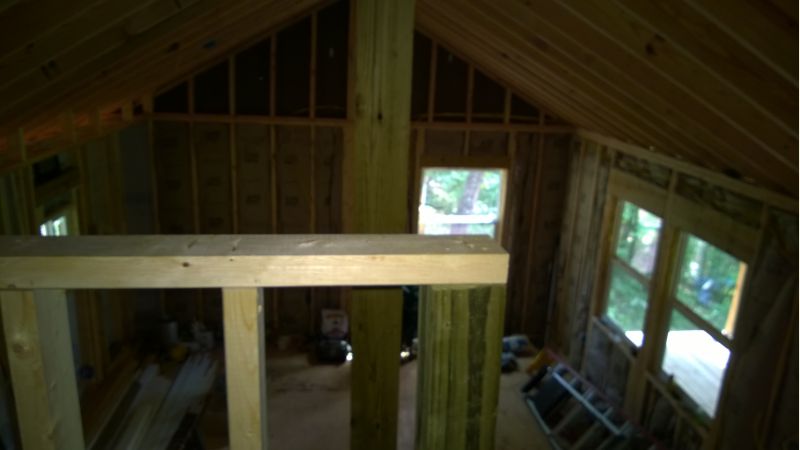

Some other pictures from the same trip.....
A visitor to my cabin early one morning before work started
View from the loft
View from the loft

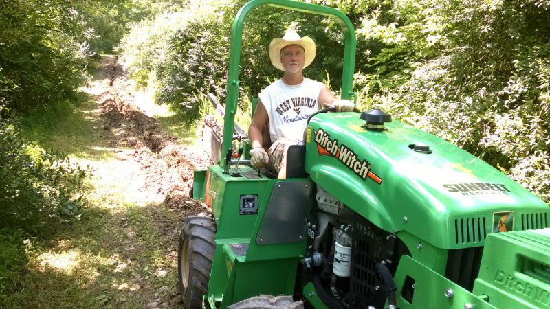

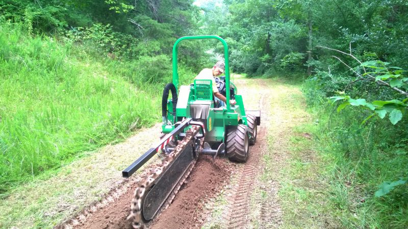

# Posted: 9 Sep 2015 06:43pm
My cabin sits at the top of the hill and it is 1/4 mile from the old farm house at the bottom of the hill. Since I had to dig a trench for 1/4 mile, and since I knew that I was going to be dealing with rock, I got the biggest trencher that Sunbelt had available. That trencher was a tank, and I was able to get the whole trench dug in one day!
My uncle who took turns on the tractor

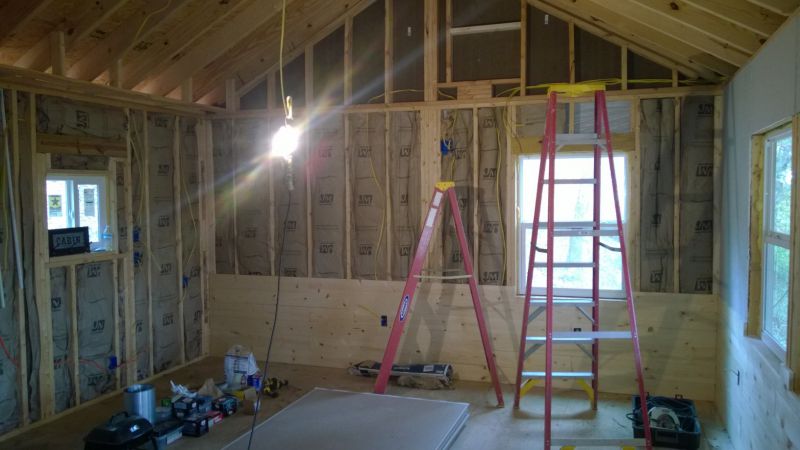

# Posted: 9 Sep 2015 06:49pm

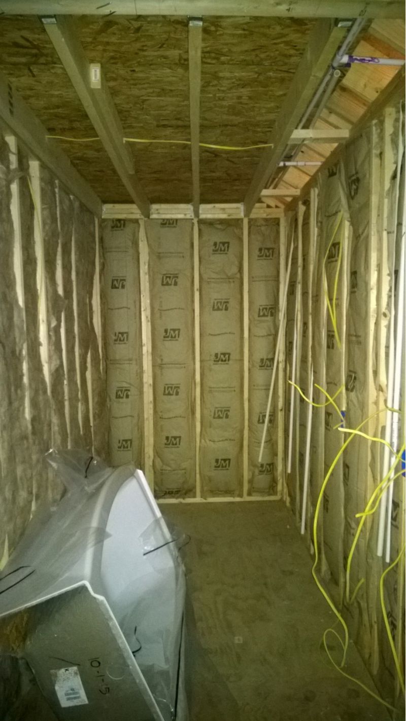

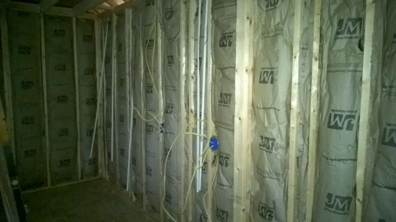

It rained off and on the whole time that I was there after the trench was dug so I ended up doing some insulation work inside for a while. Everything is ready for sheetrock or paneling except for the ceiling.

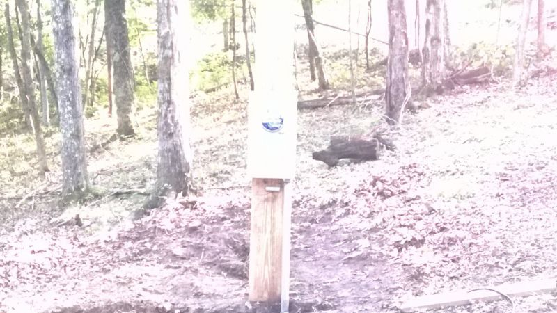

# Posted: 9 Sep 2015 06:53pm

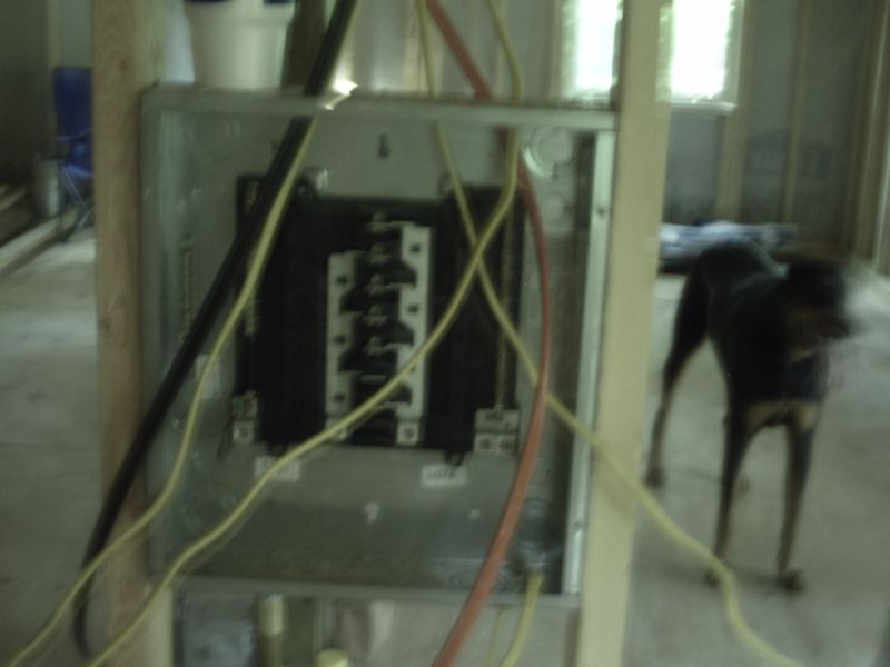

The other main thing that I needed to get done was to run the wiring from the meter pole to the breaker box inside. I decided that I wanted to run it underground so that I wouldn't have the wires connected to the cabin, especially since it would be running to the side where you entered the cabin. I thought that it would look rough that way, so I decided to go under ground.
Mountaineer Mark
# Posted: 9 Sep 2015 06:59pm
I found out that WV code requires three 000 gauge wires for the hot and neutral wires, and a 0 gauge wire for the ground. That was probably 100 lbs of copper wire and getting it run through 2" conduit with 45's and 90's was not fun!! It was definitely a relief to see the conduit tied in to the meter box at the end of the day. Now I just need to get an inspector to come out and bless it so that I can get the light poles run. Hopefully I won't have to use a generator in the near future!

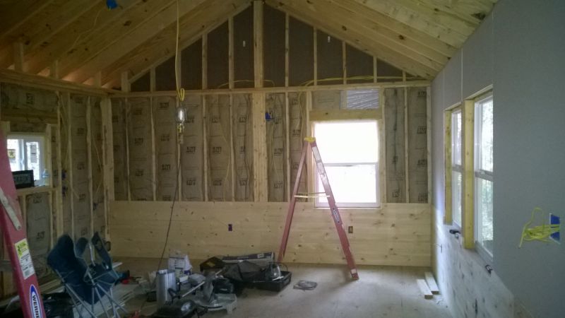

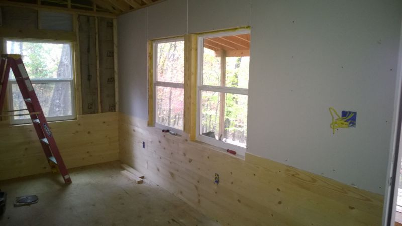

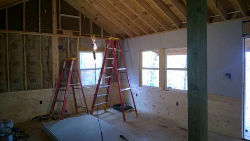

I made it back to the cabin again two weeks ago to do some work and the trees were really getting pretty in the WV hills. The current status is that I have now have the water line run all the way to the cabin but it is not connected to the house yet. I had an electrical inspector come out and inspect my meter pole and he told me that I was supposed to use 3" conduit instead of 2", so now I am debating on whether I should try to get the power company to accept the 2" or I will need to change my plans and go with overhead service. That is not what I wanted to hear!
Mountaineer Mark

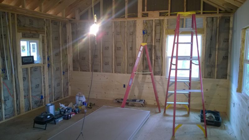

# Posted: 9 Nov 2015 04:38pm

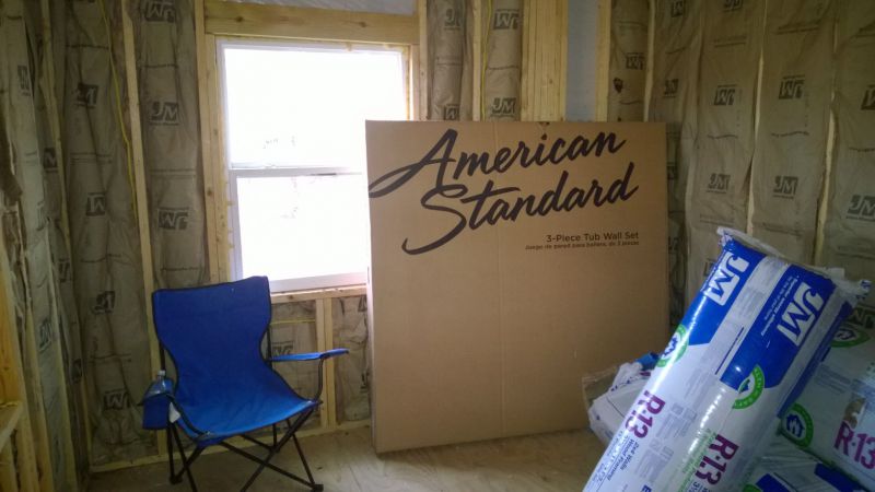

I ordered wall boards and sheetrock to start finishing out the inside of the house. I also got a bathtub, surround and faucet and I was hoping to get that tied in as well during my visit but I ran out of time dealing with all the mechanical issues. The feel of the cabin really started to change once we started putting up sheetrock and wall boards! It was great to see the place start to look like a home and I didn't want to stop working on it but I had to leave and go back home.
