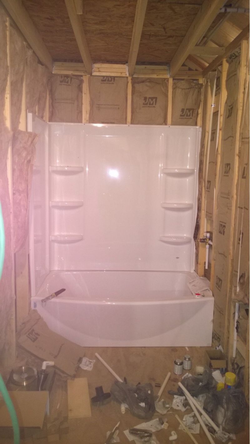

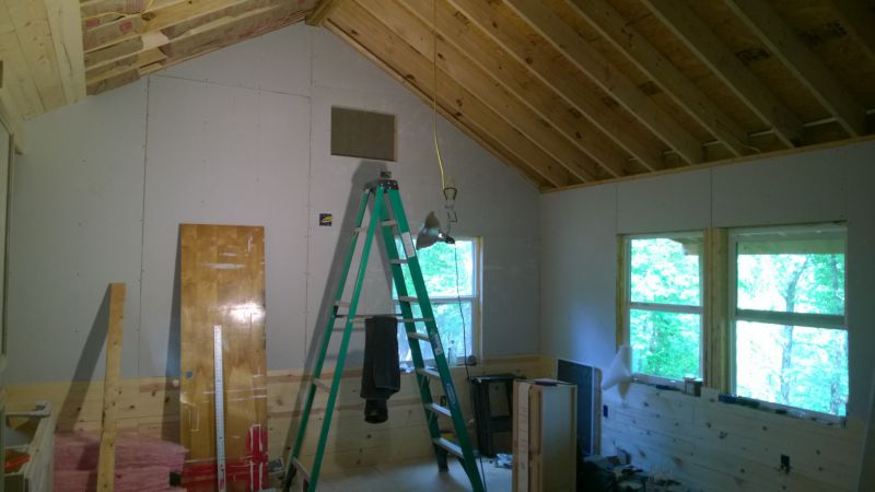

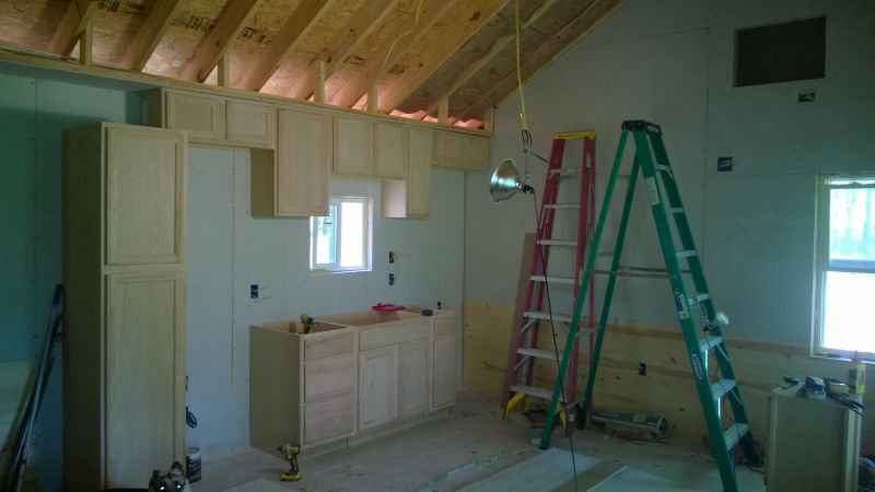

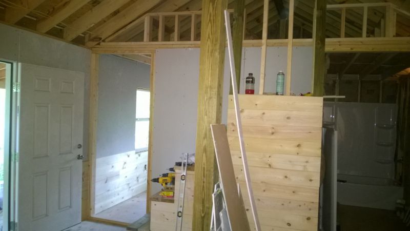

I got back home after a week of working at the cabin and it is great to see it really coming together. Putting in sheetrock, cabinets and the bathtub make it look like home and it means that I've rounded the curve where I can see light at the end of the tunnel!

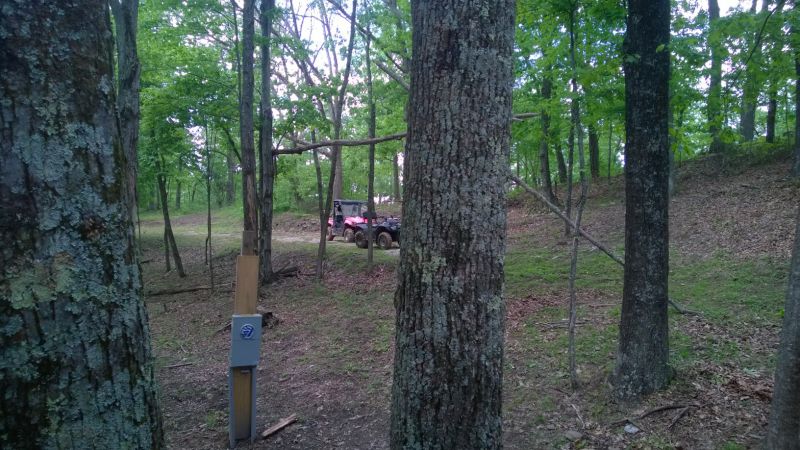

# Posted: 17 May 2016 02:46pm
I will post a few more random pics of the location so that you can see how it is set at the top of the mountain, and to give you a view of the great rock outcropping behind the cabin.
Rock face on right side (back) of the cabin
Downhill on right side (front) of the cabin

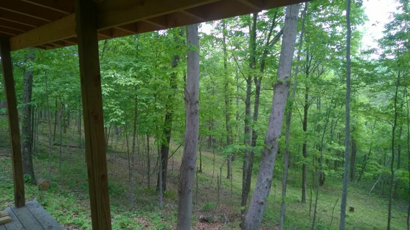

Mountaineer Mark
# Posted: 17 May 2016 02:51pm
I hope to spend several days in the near future just working on clearing out a lot of the saplings in front of the cabin that are blocking the view of the hilltops. These are all crowded, immature trees that will never have a chance to branch out so I don't mind taking them out. I want to be sure and leave one tree every 20 feet or so, to ensure that the ground will not slip over time. All of the mature trees will definitely stay.
Left side of the cabin (back)
Left side of the cabin (front)

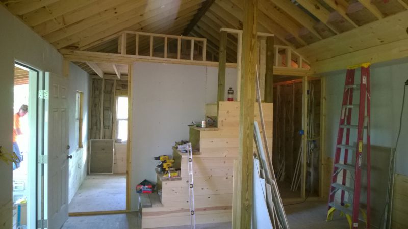

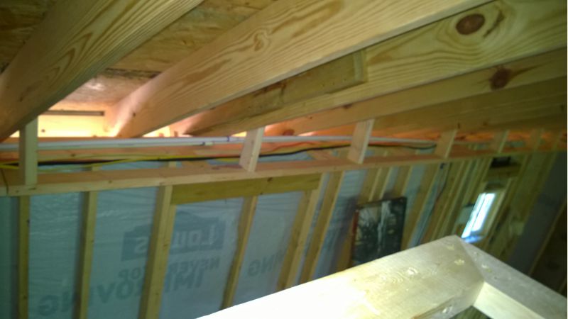

I appreciate you bringing this up as a concern so that you don't let a fellow cabin builder go down a road that could lead to bowed roof lines or rotted decking! Construction is too much of a pain to have to do it over a second time! Yes, I am going with Durovent channels behind the insulation so that the air flow can go continuous from the soffit to the roof vent. This should prevent hot roof issues, but I am honestly just as concerned with moisture evacuation as a hot roof. I am a rookie at cathedral ceiling insulation so I had to do quite a bit of research online to find out what to do, and I had to sort through all of the differing opinions and available options.
The only thing that I need to do related to the soffit is to put a baffle over the insulation where it meets the top plate. This should route the air over the insulation and up the channel to the ridge vent. Once I enclose the whole soffit, the 4x10 vents spaced every six feet should let the soffit inhale and then exhale out the ridge vent through the durovent channels. I attached a picture that I had not previously posted to give you an idea of what the rafter / top plate set up looks like. You may be able to picture how the durovent and insulation would work in there. I have about 12" of overhang on the back of the cabin that I will be enclosing for the soffit, and putting in 4x10 vents.
Mountaineer Mark
# Posted: 18 May 2016 06:10pm
I think I just realized what you were indicating related to the front wall since the picture shows that the space is enclosed where the rafters end! There is an air space between the board across the front rafters and the porch decking. I may have to increase it in some places but it should generally be enough room to get airflow from under the porch and up through the durovent channel. I will probably just put some small screen or something over that opening to keep bugs out.

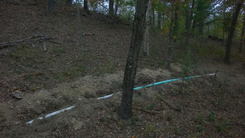

I just got a couple of pictures from my last trip since I spent the whole time working on water and septic, but I'll get them posted.
Mountaineer Mark

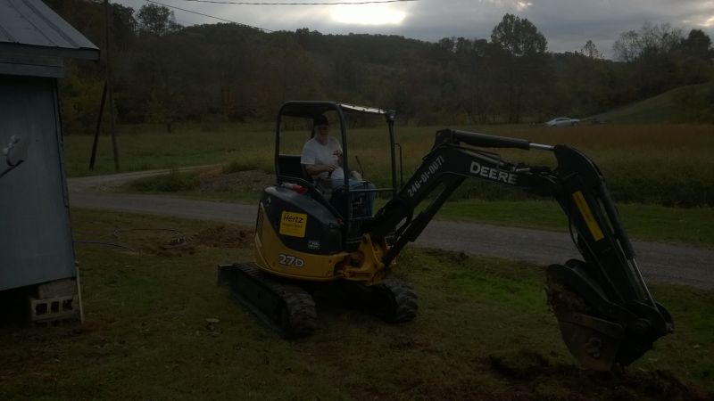

# Posted: 10 Jan 2017 12:54pm
I rented a mini-excavator while I was in town since I had to dig down to the meter connection by our old farm house to tie in my water line, and I also needed it at the top of the mountain by my cabin in order to dig the septic field lines. It worked like a champ, and I even got my Dad to operate it for a few minutes since it is something that he has always wanted to try!
Dad on the backhoe
Dad on the backhoe
Septic line finally in!
