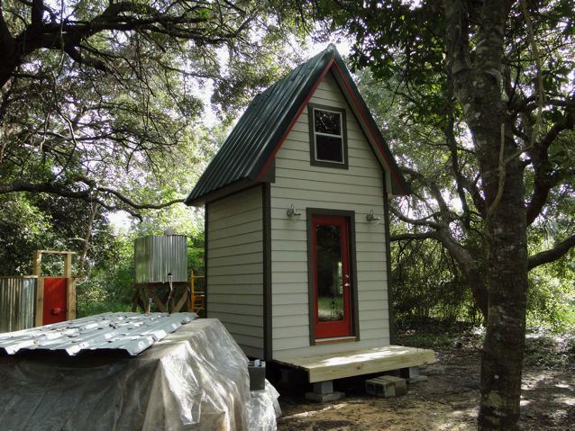

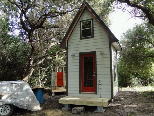

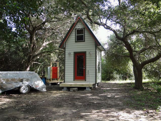

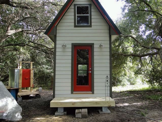

After watching this site for many months and using your collective wisdom, we built our little hide away in the woods. It's very small, 8X8 with a loft. We also have a cistern and outdoor shower.

Really cool!! Any interior pics?
mikec
# Posted: 22 Sep 2010 09:06am
Thanks Tony, no interior pictures yet, just insulation and OSB. We will begin on the interior this week and will post the progress as it occurs. We have 12 volt lighting system with two 110 outlets for a very small window unit in the loft (we are on the Texas Gulf Coast) and need relief from 100 degree, 100% humidity weather. Plan to catch rain water in the cistern and have an RV pump (12 volt) and accumulator which moves the water perfectly. 45 watt solar charger for now but hope to add another 45 soon. Composting toilet soon. That's about it, simple and hopefully functional. We enjoy the heck out of it.

Very cool and a very nice construction job
What are you planning to use to power that air conditioner? even 90 watts of solar really isn't going to cut it.
# Posted: 23 Sep 2010 09:15pm
Yery nice construction.
Your own plans?
mikec
# Posted: 24 Sep 2010 04:53pm
Generator to power AC unit, we are too old to fight heat and mosquitos. The house actually belonged to a friend who was going to burn it to get rid of it, we moved it to our place, pulled the roof off, added a second floor, pony wall and the loft. I'll try to post what we started with and thank you for your very kind words.

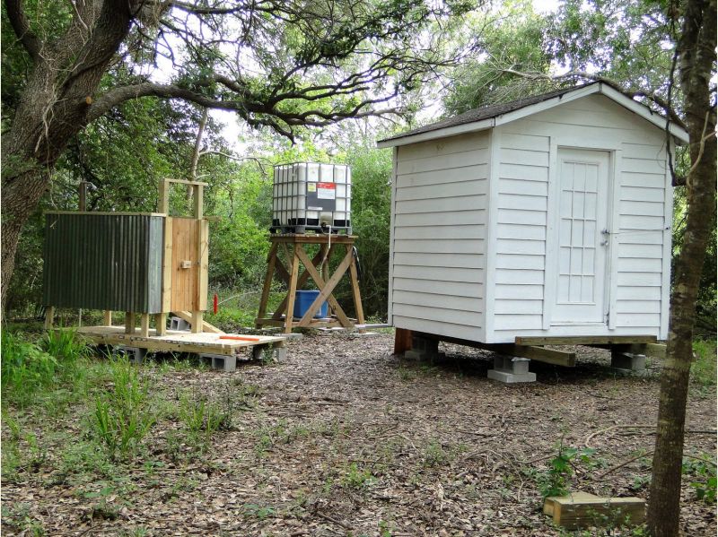

This is a picture of the little shed as we got it. 8 by 8, moved in on a trailer.
We removed the roof and went from there, no plans other than a loft to sleep in. I have spent two nights in the shed, lots better than I expected but still needs work.

That is one nice little homestead.

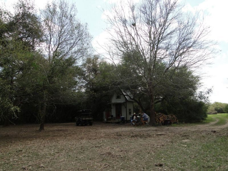

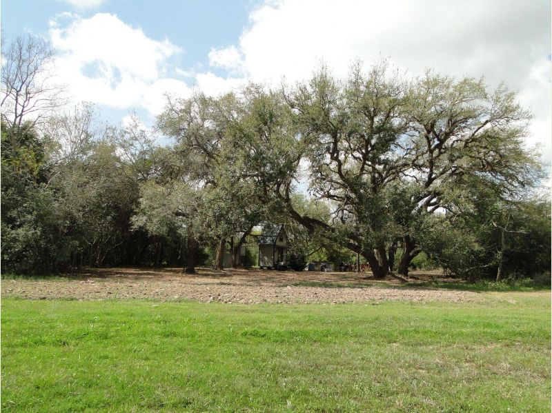

Our property is 50 acres on the Texas Gulf Coast. We are about 12 miles from the water in a very agricultural area. Our place is very dense with vegetation, some 200 year old live oaks which we love and lots of wildlife. The little shack is simply a dry cool/warm place to spend the night on the weekend. We live 85 miles from the property and having a place to spend the night saves us a 3 hour drive there and back so more can get done faster.

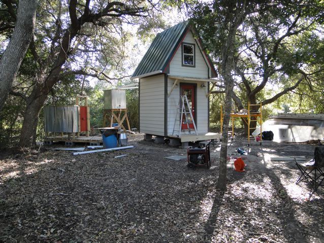

Recent pic. with porch overhang, gutters to cistern and shower.

Your water system/design looks great. My construction skills are such that if I can get the eaves trough up so water flows to the down spout there is much rejoicing.
Are your treating your cistern water to keep down the algae/bacteria etc?

Sorry Bugs, yes we will dump a little bit of bleach in the tank occasionally if needed. We had a similar house (but bigger) on a bay here for 20 years that was, as they say now, "off grid". We caught rain water in a white plastic tank, big mistake, that thing was always needing bleach. The current system is a 275 gallon tote, wrapped in metal, with a wooden top, so far we have not added bleach. The sunlight is the key, cisterns have been used here for over a hundred years with out treatment. We don't drink the water we catch but you could filter it with sand, charcoal and shell to make it drinkable. We average 45 inches of rain annually, so with our roof size should catch about 3000 gals. per year. We do need a level indicator on the tank, but started with about 50 gals. when it put up and it's now full. The new black water tanks I've seen advertised should all but eliminate the algae problem, but the totes were free.
