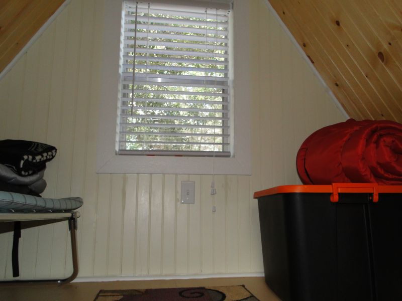

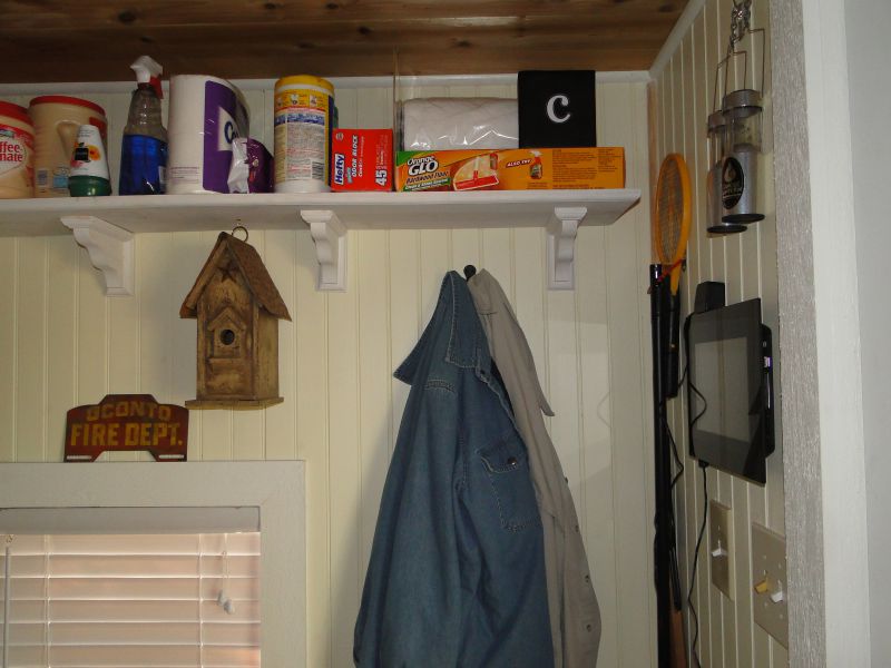

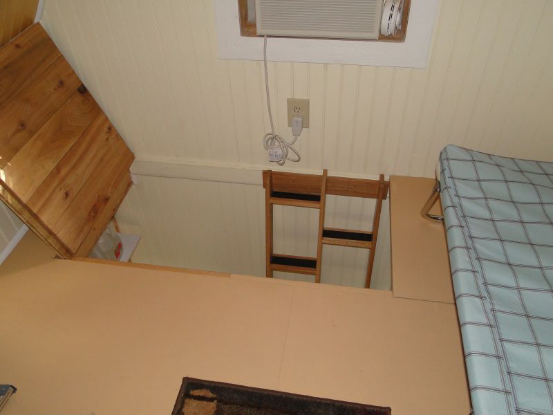

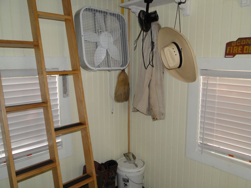

# Posted: 15 Oct 2011 11:29pm
Reply Quote
I love the inside pictures. Great work!!

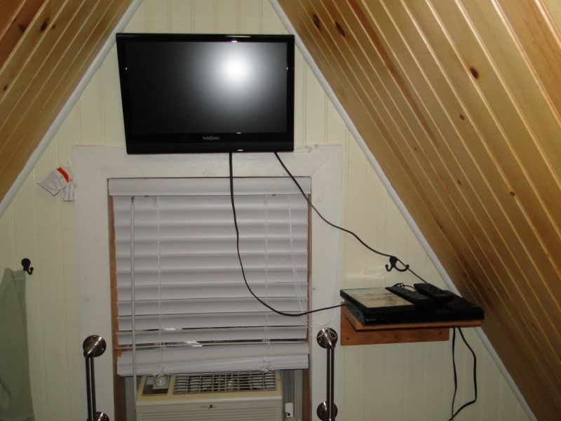

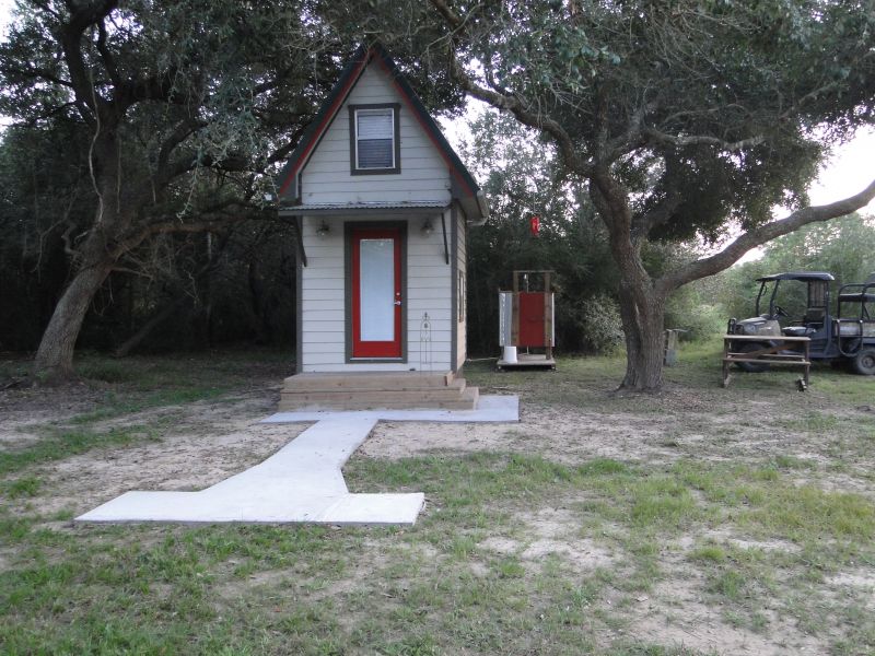

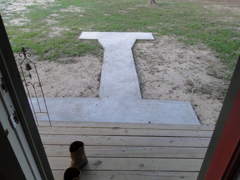

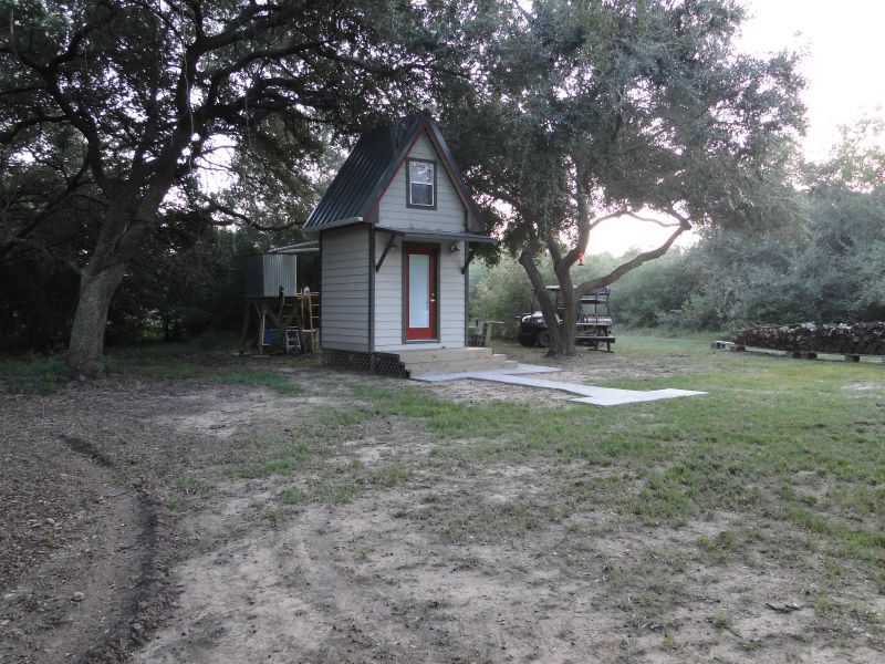

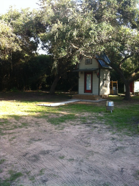

Walkway finished, next is picket fence and gate. We added a TV and DVD player so the grand children can watch Dora, Boots and Diego before their naps. DSC00801.JPG
# Posted: 15 Oct 2012 10:06pm
Reply Quote
Man, like I said before that is one nice cabin!!!! Great job!!!!!

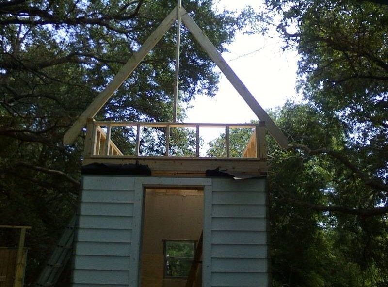

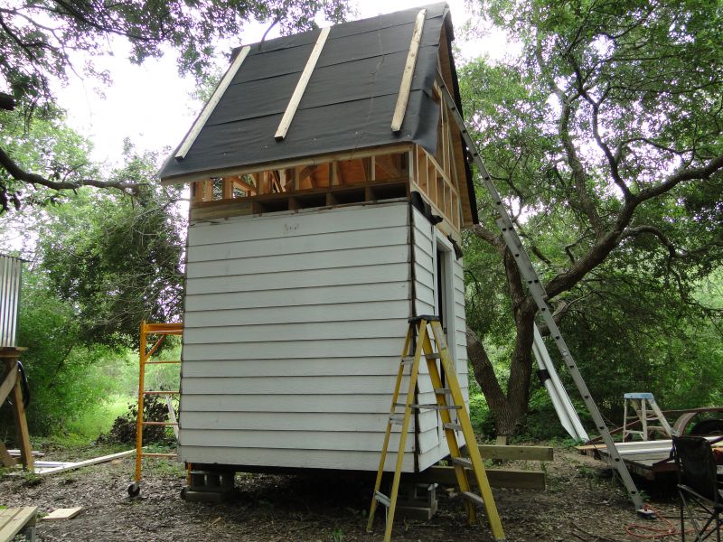

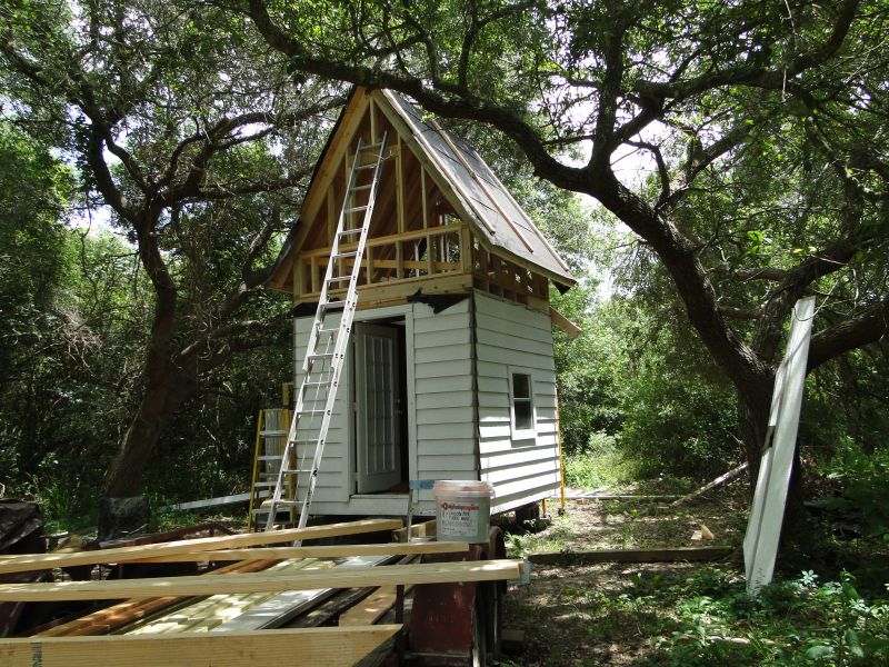

mgc - really like the small cabin, I'm going to be building a similar size this spring. I was curious what size roof rafters you used? I would like to use 2x4's but not sure if I can get away with this
mgc
# Posted: 18 Oct 2012 05:45am
Reply Quote

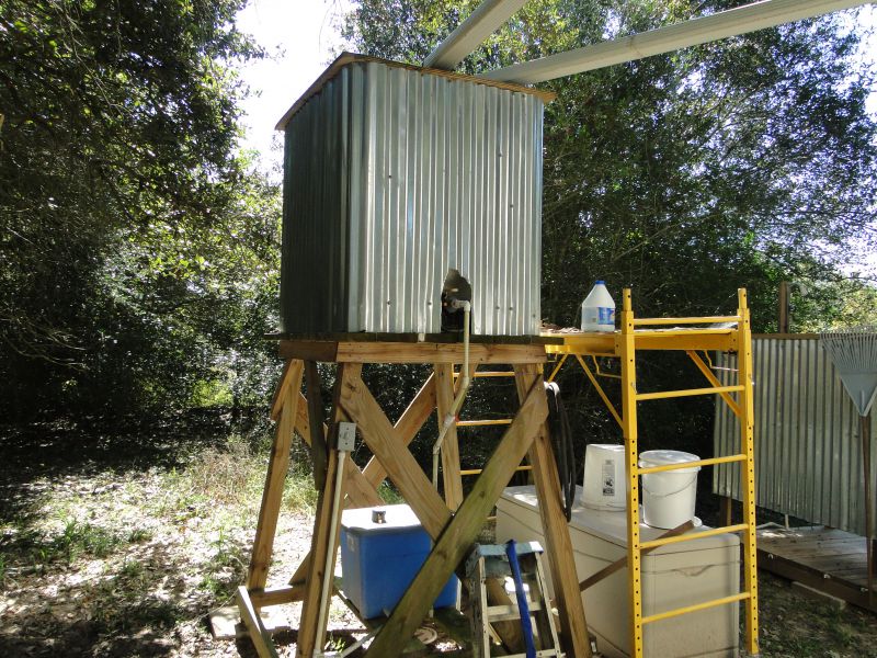

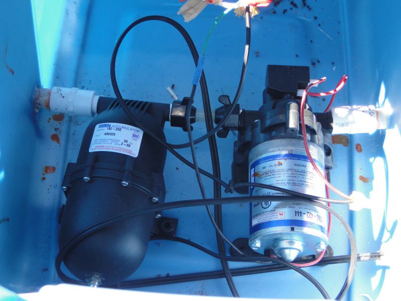

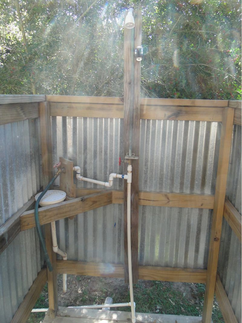

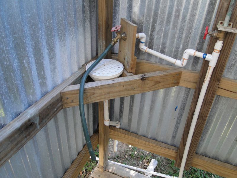

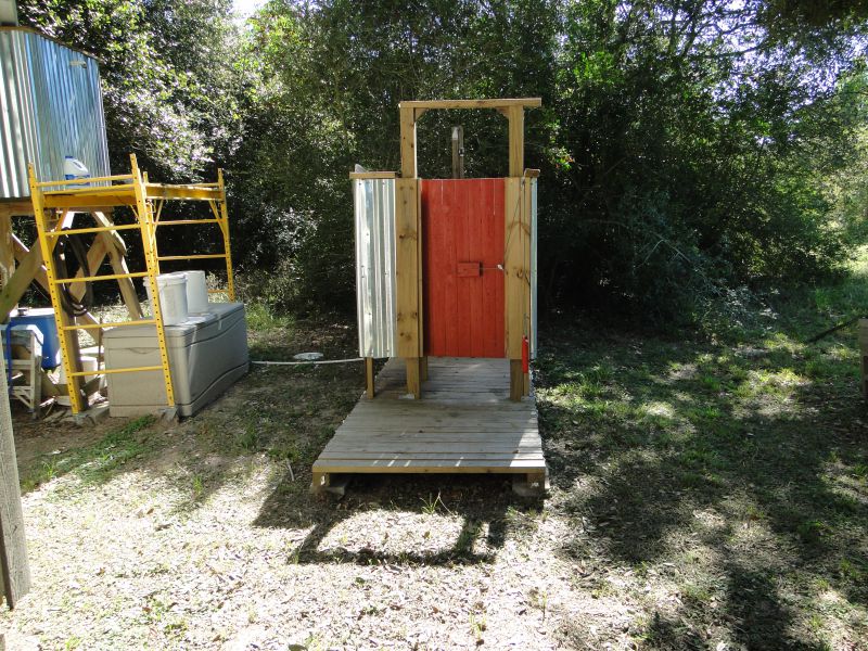

Adakseabee, these are what I have. The first three are of the shower, nothing special, gets water from the pump below the cistern. In the shower, we have a hose outlet for to wash our hands or to hook up to a hose that goes to our hot water heater for a hot shower. It's one of those on demand cheap heaters. Works really good! The last shot is of the cistern, catches water from roof, water is then fed to a 12 volt pump and accumulator, then to shower. Nothing fancy here either, pump is energized by batteries, which are charged by cheap solar panels (Harbor Freight, $150). DSC00815.JPG

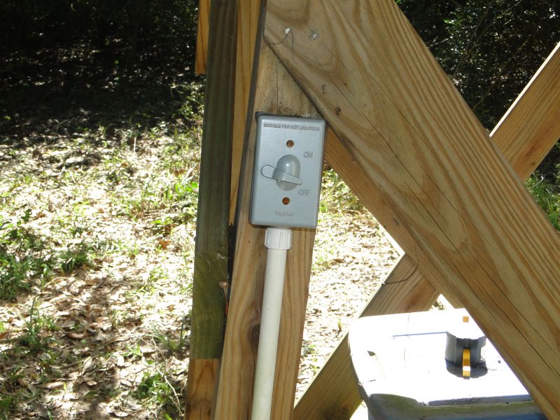

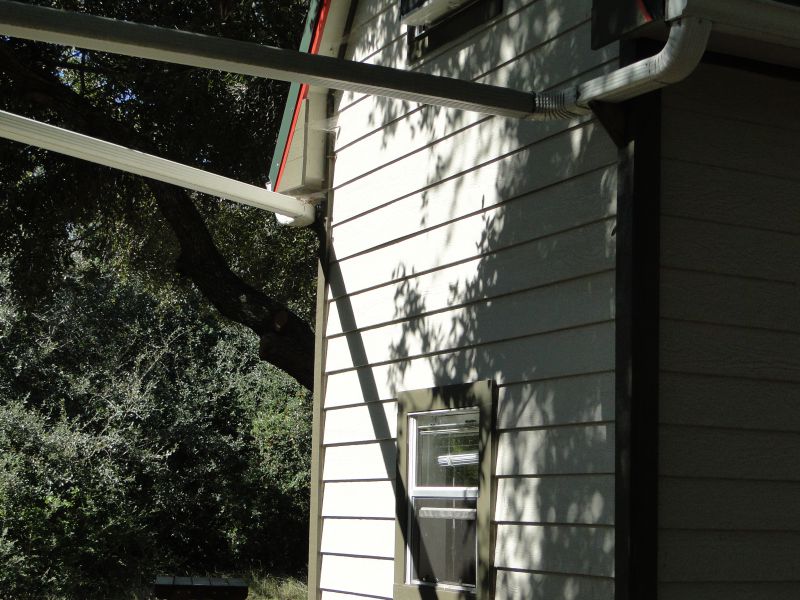

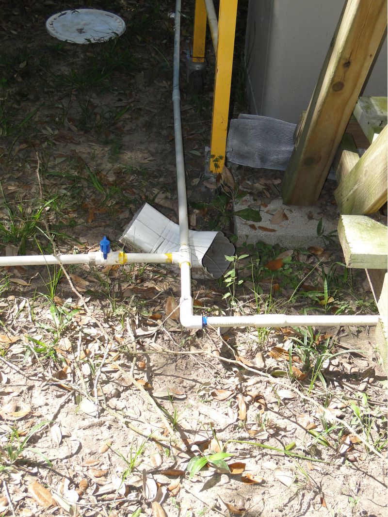

Switch to turn on pump, pump and accumulator, piping and gutter to cistern. DSC00820.JPG
adakseabee
# Posted: 29 Oct 2012 06:12pm
Reply Quote
Mike, thanks for the photos. I noticed the cross-bracing to prevent the cistern support structure from racking left and right, but minimal bracing against racking forward and back. I recommend that you strengthen the structure by adding similar cross-bracing on the two sides without it. I intend to build something similar next summer at my 10x14 cabin with a full loft under a 14/12 pitch roof. Again, thanks for the inspiration. Adakseabee

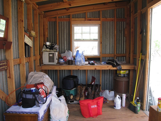

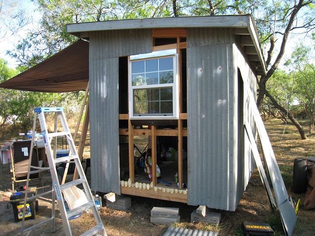

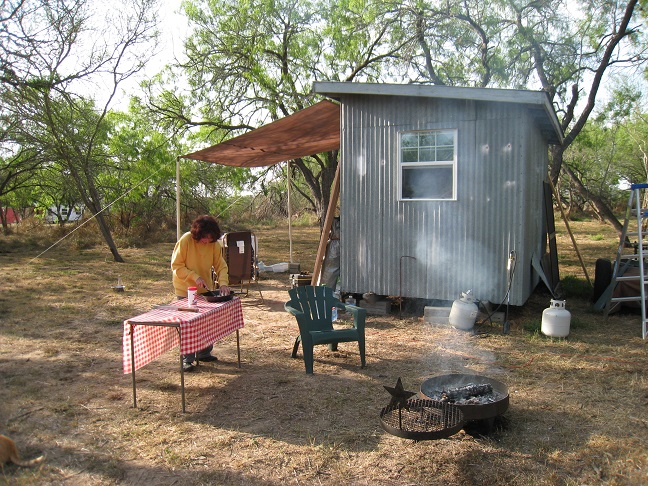

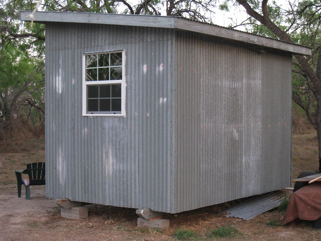

Thanks Mike, here are some photos. I built this 8 x 12 storage shed 25 years ago to hold my possessions while doing mission work in South Africa. We moved it from our home place in Cuero out to my grandpa's 2 acres at Clinton (near Cuero) a year ago. We are in the process of gradually renovating it to make it livable. We love what you did to the inside of your cabin and have been looking at different opportunities/designs. We have a lot of old wood, but it would take longer to install it than the beaded paneling. installing window in my storage shed
|  windows installed
|  fixing breakfast on outdoor wood fire
|  eating breakfast outdoors

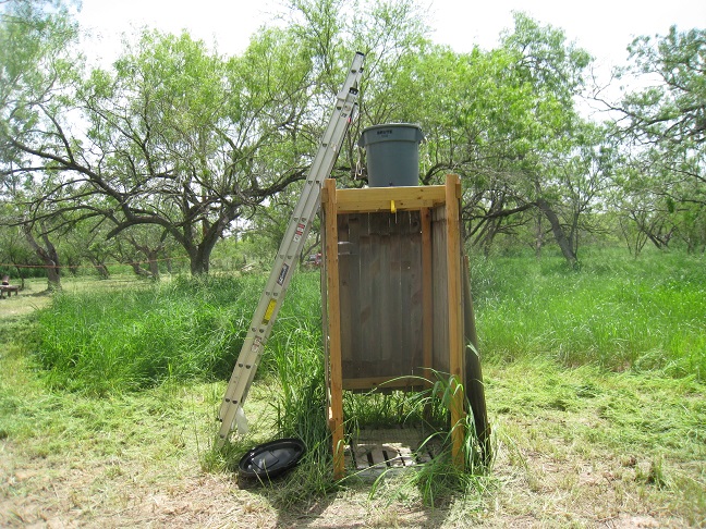

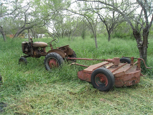

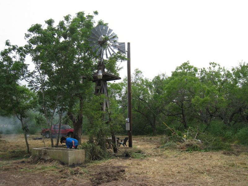

Here are some more pics of our cabin and land at Clinton. We only started clearing brush and mowing about a year ago. The property has been setting idle for about 15 years (so was the tractor) since Dad died in 1998. My grandpa bought it in 1927 and my mom was born here (I lived the first 3 yrs of my life here also). Old house was torn down by Dad and used to build onto our house in Cuero back in the 1950's. It's good communicating with you since we have lots in common re: small cabins and Texas land. property a year ago when we jsut started clearing brush and mowing
|  Dad's old 1946 Farmal A with drag shredder
|  inside our cabin
|  shower similar to yours using bucket system
mgc
# Posted: 11 Jul 2013 05:39am
Reply Quote
Great place Richard! Love mesquite trees, but a little hard to deal with the thorns. Your cabin and shower are perfect. That windmill and tractor are priceless, i could stare at both for hours. Great place!

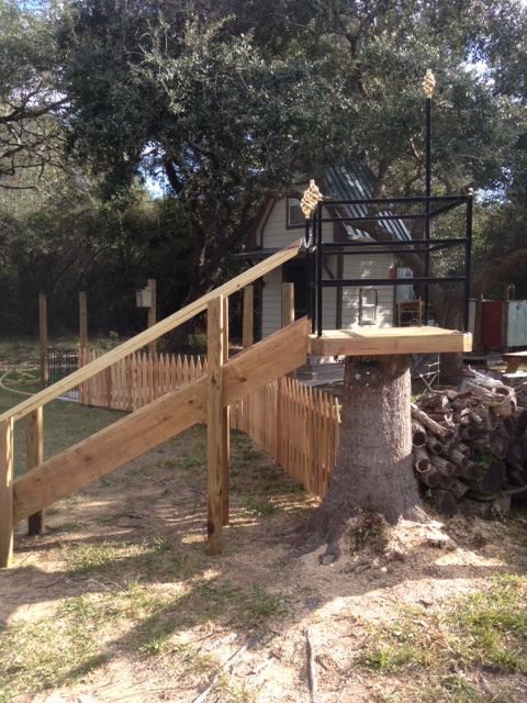

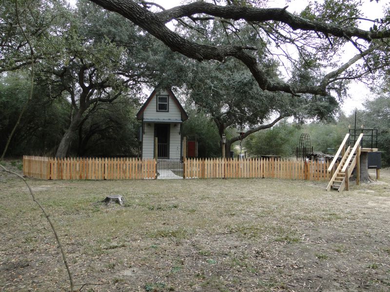

Just a recent photo, little fence for the little house.
eddienlinda
# Posted: 14 Feb 2014 12:39am
Reply Quote

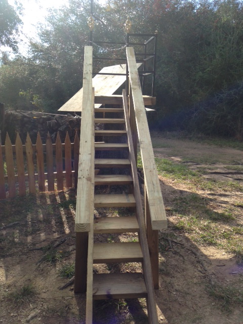

Very nice. What's the stairs to the right going to?
mgc
# Posted: 14 Feb 2014 04:45am
Reply Quote
Its a Princess' tower for our granddaughters (3 and 5), made from a stump and some scrap lumber and my first attempt at welding. They run up and down the steps and survey their kingdom from the tower It's a hoot watching them.
mgc
# Posted: 14 Feb 2014 05:53am - Edited by: mgc
Reply Quote
The girls and the new tower, bad shot of me.

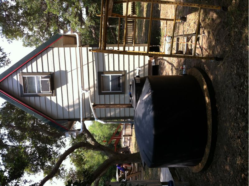

Updated our rain catchment, trimmed trees, bigger gutters, leaf guards and new holding tank. Still have to install a first flush device and reinstall water pump.
