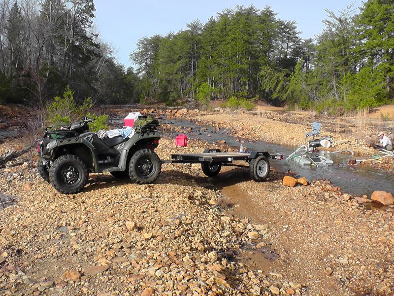

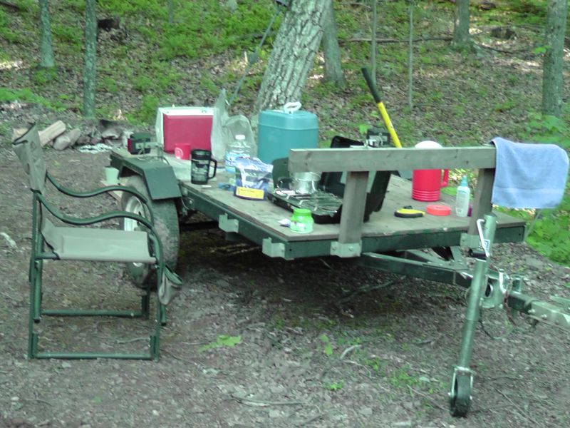

# Posted: 8 Nov 2015 11:40am
My brackets are exactly 2"x4". Someone forgot to tell the Chinese that a 2x4 is really 1 3/4 x 3 3/4. Don't know what to do about that other than mill my own. So my brackets have wiggly 2x4s.
You can see I remounted the tail lights on the fenders. I also home run the tail light ground.
And the recommended tongue jack is a POS. A friend told me to get a BullDog jack.
Soon as I get a round tuit.
I do like unloading the ATV and using the trailer as a camp table.

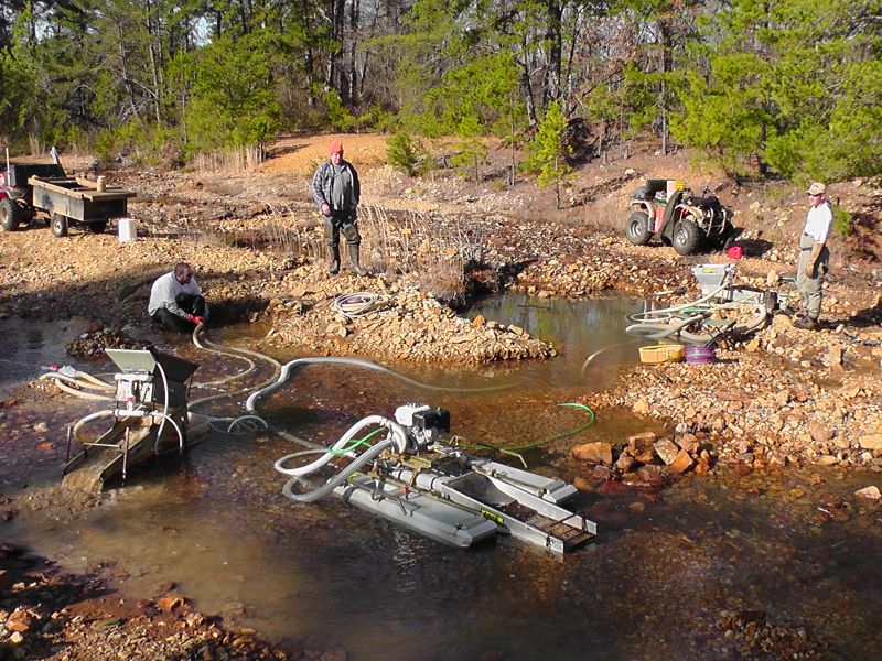

I had to change the tail light location because when I go gold panning with the trailer on the ATV toting my gold dredge, tree branches were tearing up the lights. But on the highway the fenders shake the lights so bad, I'm worried the lamp filaments will break more often. Now that I have figured out how to get the entire gold dredge on the ATV, I don't have to use the trailer on the gold creek. So I will probably move the lights back.
I guess the only real innovation was home run ground wires from the lights to the front. I'm looking at this painted framing and thinking, no way I'm going to trust painted frame to be a good circuit for ground.
"The tongue itself is finicky and resulted in a chain-drag incident! No damage apart from a snapped ground wire and frayed cables though."
There is a nut adjustment under the tongue to increase spring pressure. It's tricky to find the right balance of spring pressure on the ball. i think mine is a tad too tight because the tongue unscrews the ball a little. I also keep the truck ball and tongue greased.
You have your light wires between the frame and the plywood. That may not last. You might have assembled the side rails upside down, may have to change them right to left to get that hole on the bottom.
I used my trailer folding to keep it in my garage which tore the wiring up bad. I just park it in the back yard now.
