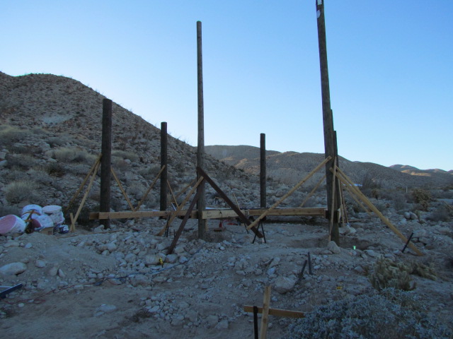

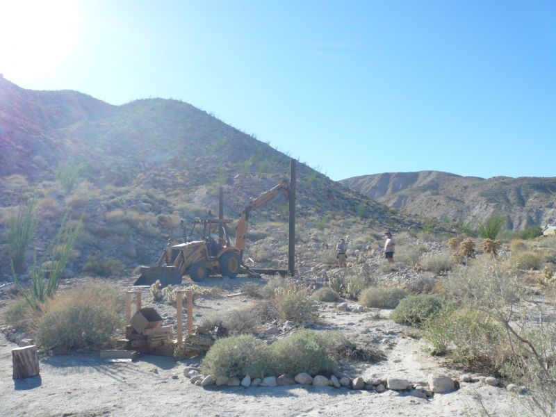

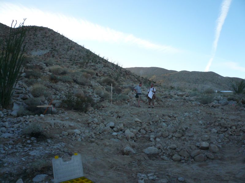

Here are some pics of my start on my pole house in the desert. It was about the hardest 3 days of work I've ever put in (and that's sayin' something)![Laying Out Laying Out](https://www.small-cabin.com/forum/shared_files/uploaded/645/5384_1.jpg) Laying Out
| ![Grading Grading](https://www.small-cabin.com/forum/shared_files/uploaded/645/5384_2.jpg) Grading
| ![Setting First Pole Setting First Pole](https://www.small-cabin.com/forum/shared_files/uploaded/645/5384_3.jpg) Setting First Pole
| ![Bracing Bracing](https://www.small-cabin.com/forum/shared_files/uploaded/645/5384_4.jpg) Bracing

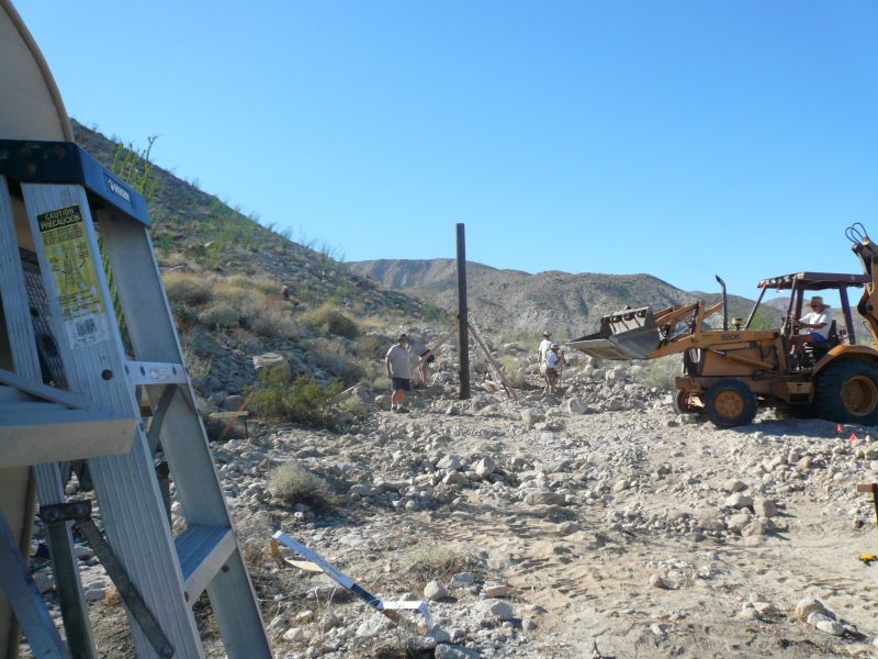

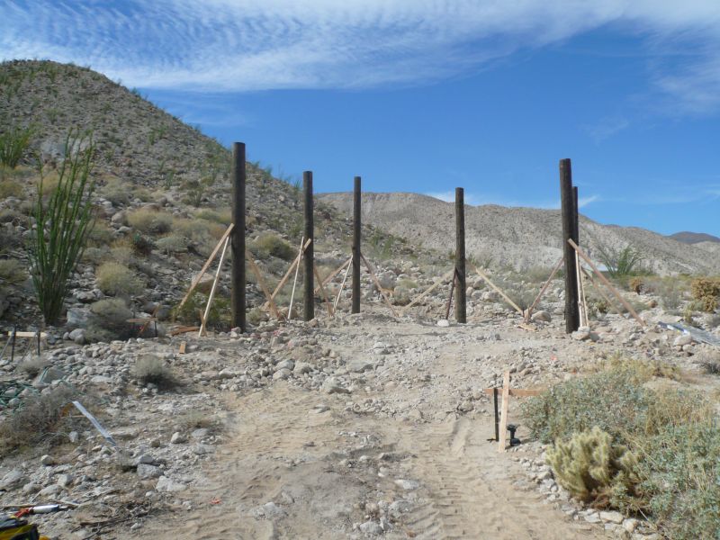

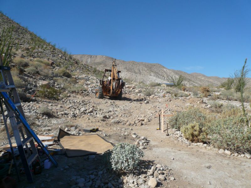

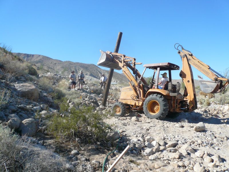

# Posted: 7 Nov 2010 13:38
And some more.... It was solid rocks and sand, tough digging even with a backhoe... 95 degrees..... lots of beer after work for sure!![2nd Pole, taking about an hour each. 2nd Pole, taking about an hour each.](https://www.small-cabin.com/forum/shared_files/uploaded/645/5385_1.jpg) 2nd Pole, taking about an hour each.
| ![3rd Pole! 3rd Pole!](https://www.small-cabin.com/forum/shared_files/uploaded/645/5385_2.jpg) 3rd Pole!
| ![Sunrise! Sunrise!](https://www.small-cabin.com/forum/shared_files/uploaded/645/5385_3.jpg) Sunrise!
| ![6 Poles in, more to come next weekend, gotta find some more poles :-) 6 Poles in, more to come next weekend, gotta find some more poles :-)](https://www.small-cabin.com/forum/shared_files/uploaded/645/5385_4.jpg) 6 Poles in, more to come next weekend, gotta find some more poles :-)

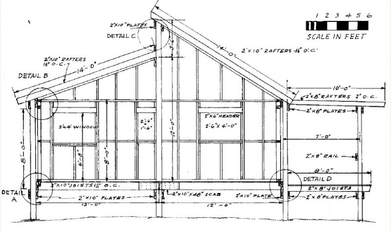

Off to a good start! do you have any plans your working from?
# Posted: 7 Nov 2010 22:05

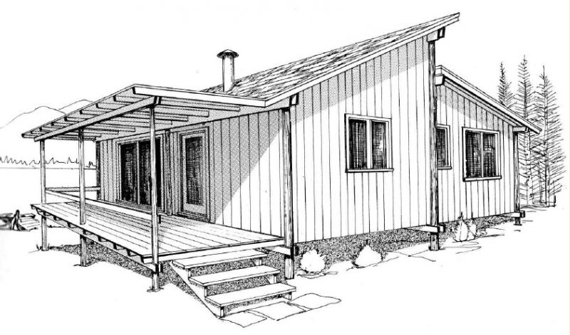

Yes, I picked up some ideas from an ebook online. I revised them to fit my site and needs. I have a full set of plans as I would in building a new house.![front view front view](https://www.small-cabin.com/forum/shared_files/uploaded/645/5391_1.jpg) front view
| ![I started with this and revised I started with this and revised](https://www.small-cabin.com/forum/shared_files/uploaded/645/5391_2.jpg) I started with this and revised

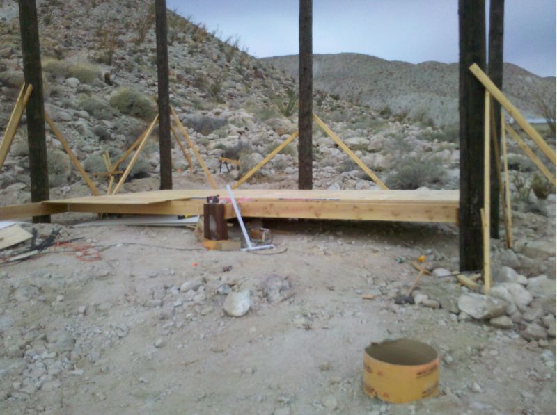

# Posted: 4 Dec 2010 22:01
Next Steps: Girders, Joists, Floor Insulation and Plywood![Putting down the bottom boards Putting down the bottom boards](https://www.small-cabin.com/forum/shared_files/uploaded/645/6097_1.jpg) Putting down the bottom boards
| ![Insulation Insulation](https://www.small-cabin.com/forum/shared_files/uploaded/645/6097_2.jpg) Insulation
| ![3/4" Ply Floor 3/4" Ply Floor](https://www.small-cabin.com/forum/shared_files/uploaded/645/6097_3.jpg) 3/4" Ply Floor

# Posted: 27 Feb 2011 13:15 - Edited by: Borrego

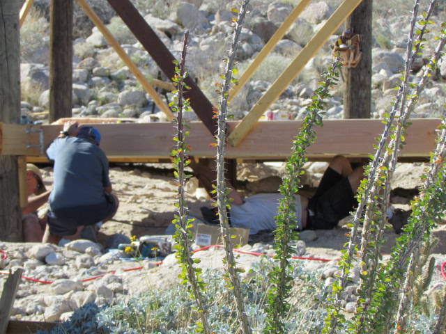

Well, it took me forever to find the last two poles, but finally got them in and got the bottom ledgers all in and bolted.

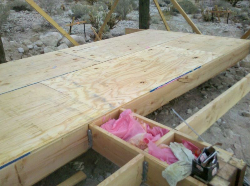

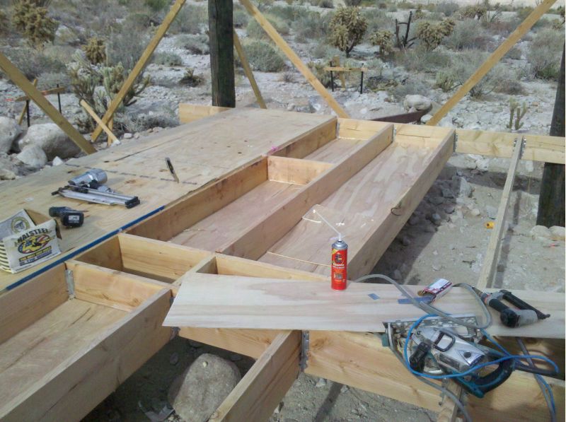

Next weekend I will finish the floor and install the upper ledgers.... hopefully...![All 8 poles in place All 8 poles in place](https://www.small-cabin.com/forum/shared_files/uploaded/645/8741_2.jpg) All 8 poles in place
| ![nailing in the ply for insulation nailing in the ply for insulation](https://www.small-cabin.com/forum/shared_files/uploaded/645/8741_3.jpg) nailing in the ply for insulation
| ![the crew discussing our neighbor's 3 wheel bike the crew discussing our neighbor's 3 wheel bike](https://www.small-cabin.com/forum/shared_files/uploaded/645/8741_4.jpg) the crew discussing our neighbor's 3 wheel bike

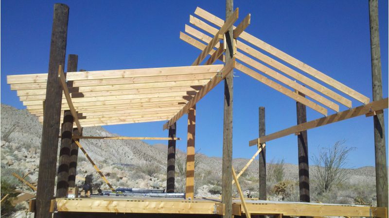

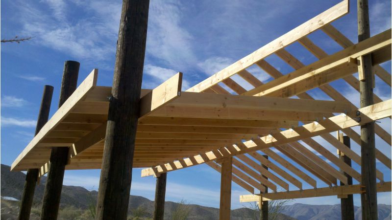

And the rafters go in... Roof sheathing next week!![024__Copy_4.jpg 024__Copy_4.jpg](https://www.small-cabin.com/forum/shared_files/uploaded/645/9484_1.jpg) 024__Copy_4.jpg
| ![025__Copy_4.jpg 025__Copy_4.jpg](https://www.small-cabin.com/forum/shared_files/uploaded/645/9484_2.jpg) 025__Copy_4.jpg

# Posted: 19 Mar 2011 19:33
Rafters finished, facshia on, ply goin' on roof

Quoting: larryh Why is it your finding it way harder than building a normal type home?
well, because the round shape and tapered shaft screw with the layout. Of course, I think that's mainly because the ground out there is all rock. So when you dig the holes, they do not end up where you started :-(. But it's all ending up ok...

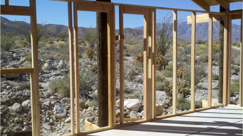

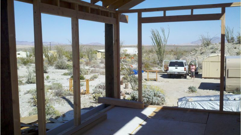

# Posted: 11 Apr 2011 22:29

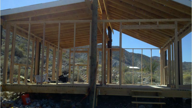

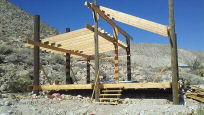

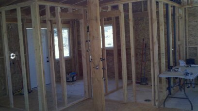

Here are some new pics from the framing startup...![20110410_154728_.jpg 20110410_154728_.jpg](https://www.small-cabin.com/forum/shared_files/uploaded/645/11150_1.jpg) 20110410_154728_.jpg
| ![20110410_154759_.jpg 20110410_154759_.jpg](https://www.small-cabin.com/forum/shared_files/uploaded/645/11150_2.jpg) 20110410_154759_.jpg
| ![20110410_154811_.jpg 20110410_154811_.jpg](https://www.small-cabin.com/forum/shared_files/uploaded/645/11150_3.jpg) 20110410_154811_.jpg

Are you planning on cutting the poles or leaving them tall? Looks like if you are cutting them off, you just cut along the last rafter with a chain saw right?

Quoting: smitty Are you planning on cutting the poles or leaving them tall? Looks like if you are cutting them off, you just cut along the last rafter with a chain saw right?
I left the front left one tall just for fun. And yep, I just cut em along the rafters with a chainsaw! Thanks for all the nice comments, Cabingal

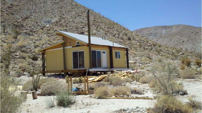

# Posted: 8 May 2011 22:32 - Edited by: Borrego

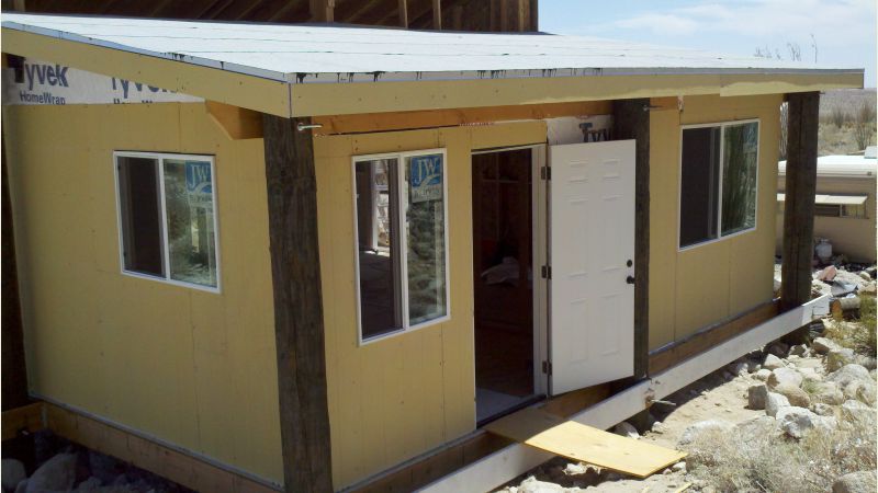

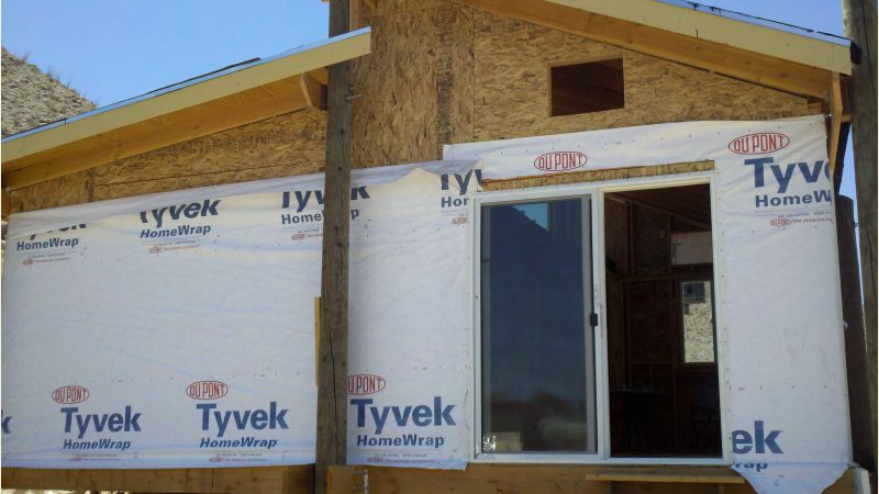

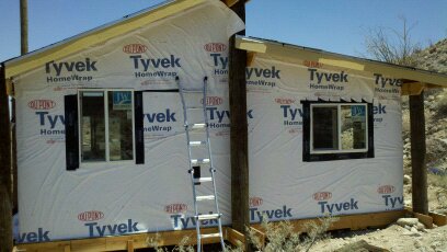

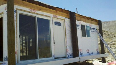

Got the roofing done and Tyvek started, put in most of the doors and windows. getting hot out there now, over 100 and probably much more up on that white roof !! I've got a couple more weekends to go before it gets too hot to work at all. I'm hoping to get the wrap done, windows in and siding on by then. Anyone wanna help, come on out :-)
Pictures to follow....

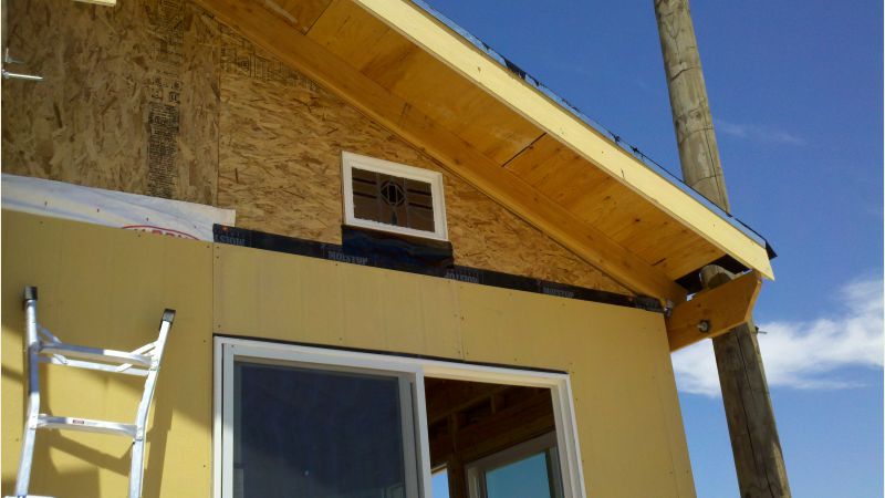

# Posted: 17 May 2011 22:40
Here are the pics finally. heading out this weekend to put up the siding!![May_2011_001.jpg May_2011_001.jpg](https://www.small-cabin.com/forum/shared_files/uploaded/645/12503_1.jpg) May_2011_001.jpg
| ![May_2011_003.jpg May_2011_003.jpg](https://www.small-cabin.com/forum/shared_files/uploaded/645/12503_2.jpg) May_2011_003.jpg
| ![May_2011_006.jpg May_2011_006.jpg](https://www.small-cabin.com/forum/shared_files/uploaded/645/12503_3.jpg) May_2011_006.jpg
| ![May_2011_011.jpg May_2011_011.jpg](https://www.small-cabin.com/forum/shared_files/uploaded/645/12503_4.jpg) May_2011_011.jpg
