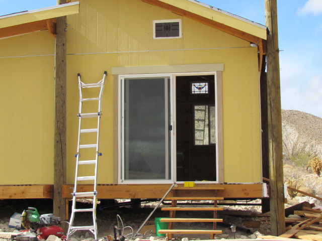

Well, we're back at it! didn't cool down this season until late October... So I'm finishing up the siding, putting up the trim, wiring the interior. Here are some pics:![current status current status](https://www.small-cabin.com/forum/shared_files/uploaded/645/19552_1.jpg) current status
| ![midday rainbow midday rainbow](https://www.small-cabin.com/forum/shared_files/uploaded/645/19552_2.jpg) midday rainbow
| ![another incredible sunrise! another incredible sunrise!](https://www.small-cabin.com/forum/shared_files/uploaded/645/19552_3.jpg) another incredible sunrise!
| ![me and the missus me and the missus](https://www.small-cabin.com/forum/shared_files/uploaded/645/19552_4.jpg) me and the missus

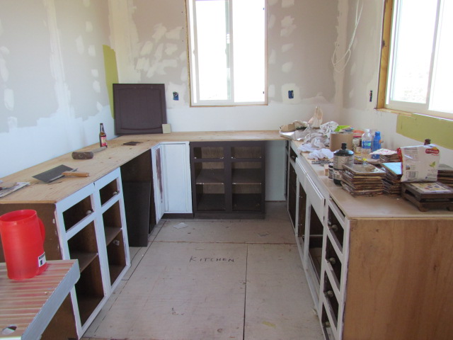

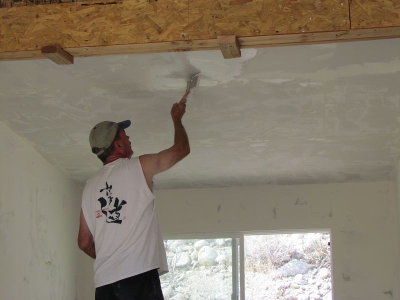

We're wrapping up our season and here's where we are: Exterior done (except porch and decks) Drywall all hung, mostly taped and finished Cabinets installed in kitchen (got 'em from a job I had) Areas that will be tiled are prepped Decided on paint colors (the missus that is - I stayed away from this one ![](http://www.small-cabin.com/forum/img/smilies/wink.gif) Found basically all of our furniture - leftovers, yard sales, etc... and refinished some of it, mostly early 1900's antiques! And 2 really nice area rugs from thrift stores
Next do do: Finish drywall Paint Tile in bathroom and exterior shower Butcher block counter tops Flooring (decided on 1x8 pine, cheapest and will look good, thanks to Montanan, got some ideas from their project)
So we will have 1 more quick trip out, just to make sure everything is 'summerized' and then it'll be wait until mid -September and get back at it..... frankly,I'm ready for a break, hanging drywall in the desert by oneself is a serious drag![](http://www.small-cabin.com/forum/img/smilies/nono.gif) ![015.jpg 015.jpg](https://www.small-cabin.com/forum/shared_files/uploaded/645/30524_1.jpg) 015.jpg
| ![127.jpg 127.jpg](https://www.small-cabin.com/forum/shared_files/uploaded/645/30524_2.jpg) 127.jpg
| ![skip troweling the ceiling skip troweling the ceiling](https://www.small-cabin.com/forum/shared_files/uploaded/645/30524_3.jpg) skip troweling the ceiling

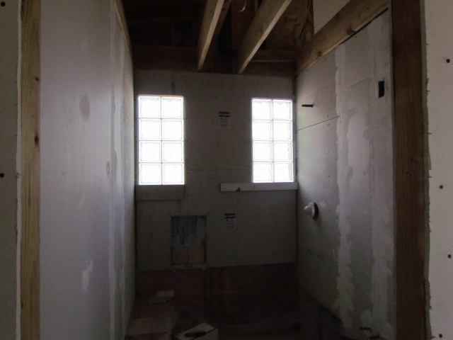

More pics![bathroom bathroom](https://www.small-cabin.com/forum/shared_files/uploaded/645/30525_1.jpg) bathroom
| ![relaxing on temporary front porch, me on right relaxing on temporary front porch, me on right](https://www.small-cabin.com/forum/shared_files/uploaded/645/30525_2.jpg) relaxing on temporary front porch, me on right
| ![Iguana Iguana](https://www.small-cabin.com/forum/shared_files/uploaded/645/30525_3.jpg) Iguana
| ![Sunrise Sunrise](https://www.small-cabin.com/forum/shared_files/uploaded/645/30525_4.jpg) Sunrise

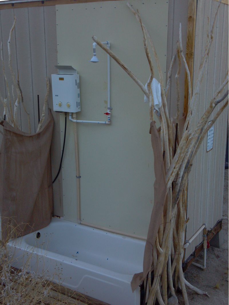

Haven't updated y'all on my progress lately so here ya go: Temperatures were unusually hot until mid October, so this weekend was only our 4th trip out this season.![](http://www.small-cabin.com/forum/img/smilies/sad.gif) Finally finished drywall! doing the whole cabin basically by myself went on forever. and ever... I was sure glad to put away the tools and return the scaffolds! We are now finished with paint as well, so starting on the floor will be next... Just got back and this weekend was spent running water from trailer (as far as I had it) to the cabin. So I will be able to install toilet and sinks pretty soon, wife is excited! Also installed door casing and caulked it, and added extra supports under the house to sturdy it up a bit.....![Let it flow! Let it flow!](https://www.small-cabin.com/forum/shared_files/uploaded/645/40817_1.jpg) Let it flow!
| ![Bedroom doorway Bedroom doorway](https://www.small-cabin.com/forum/shared_files/uploaded/645/40817_2.jpg) Bedroom doorway
| ![Outdoor shower Outdoor shower](https://www.small-cabin.com/forum/shared_files/uploaded/645/40817_3.jpg) Outdoor shower
| ![Ahhhhh...beautiful! Ahhhhh...beautiful!](https://www.small-cabin.com/forum/shared_files/uploaded/645/40817_4.jpg) Ahhhhh...beautiful!

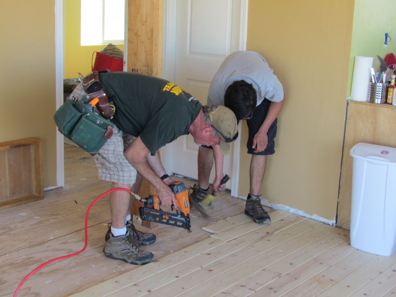

Got around to the floor at long last! 2 weekends and it's all down and half sealed. I ended up using basic T&G pine paneling from H Depot. Gotta be real careful when selecting the boards, some of the 'twisted sister' boards can cause a lot of pain...... I used Liquid nails subfloor adhesive and 1 3/4" finish nails. Since these boards are not T&G at their ends, I just toe-nailed and glued the ends to prevent them from raising away from each other. We used a Minwax stain conditioner to allow the pine to receive the stain a little better and it really works well! A Pecan color stain/polyurethane of was used and we like it... comments?![Canebrake_2222413.jpg Canebrake_2222413.jpg](https://www.small-cabin.com/forum/shared_files/uploaded/645/46624_1.jpg) Canebrake_2222413.jpg
| ![Canebrake_2222413.jpg Canebrake_2222413.jpg](https://www.small-cabin.com/forum/shared_files/uploaded/645/46624_2.jpg) Canebrake_2222413.jpg
| ![Canebrake_2222413.jpg Canebrake_2222413.jpg](https://www.small-cabin.com/forum/shared_files/uploaded/645/46624_3.jpg) Canebrake_2222413.jpg
