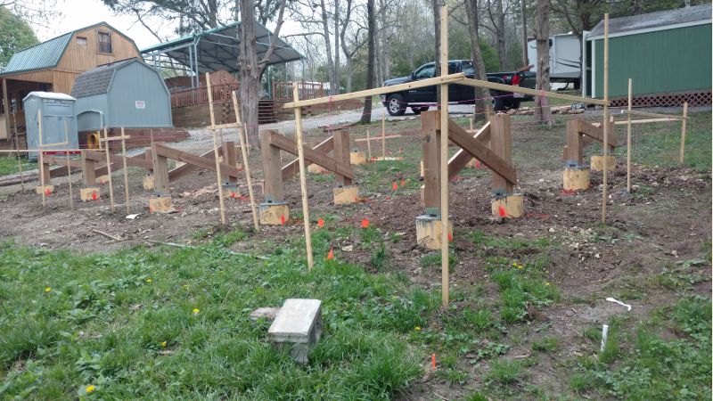

Your cabin sounds great. We had the same issue with our piers. We poured all of our piers about 6" to 8" above grade and back filled with packed 2" minus. By doing this, the driver was able to drive the cabin into place with his mule. Once the cabin was in place we raised it and I put the wooden structure under it. all of the 6x6 posts are attached to the piers and the skids using Simpson brackets. Then I tied all of the 6x6 posts together with 2x6 X bracing to provide lateral support. I avoided using blocks on top of the piers because it was going to be difficult to tie the cabin down. It took quite a bit of planning and loss of sleep, but it worked out perfect. You want to stay away from clean rock as fill because his tractor will not be able to get traction on it. Have fun with your project and feel free to ask questions.
James
jjr
# Posted: 10 Jun 2016 08:51am
Here is a picture of the start of my foundation. You can see some of the x bracing. Once the cabin was in place, I added more x bracing to tie the 6x6 posts together going the other direction.

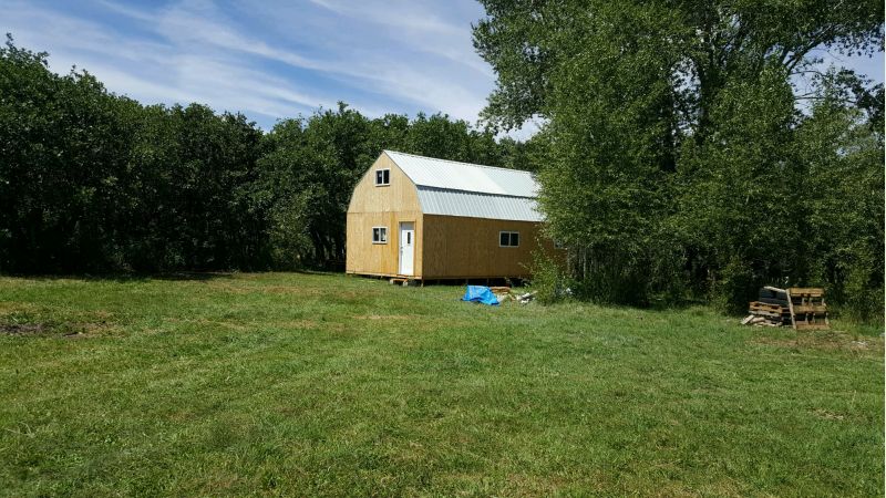

This is what it is looking like so far.
16x32 shed cabin
16x32 shed cabin

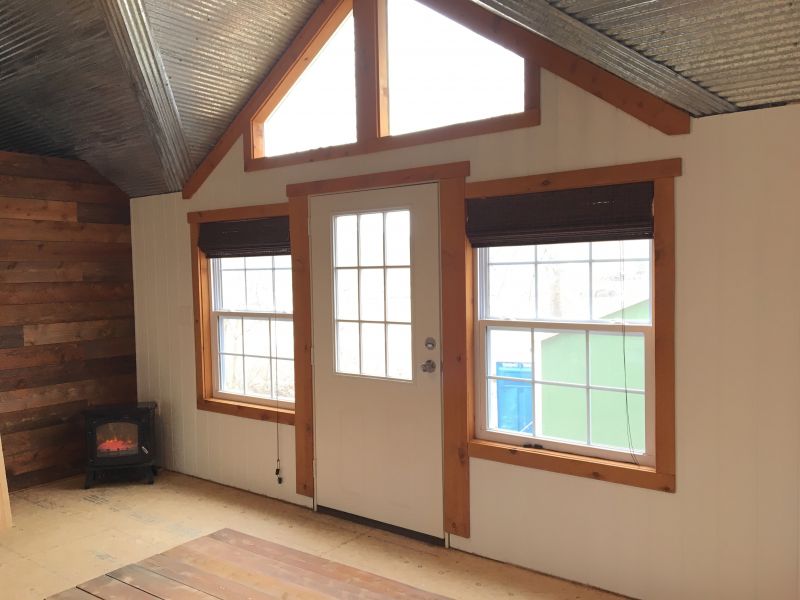

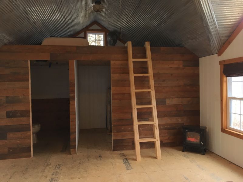

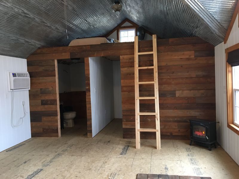

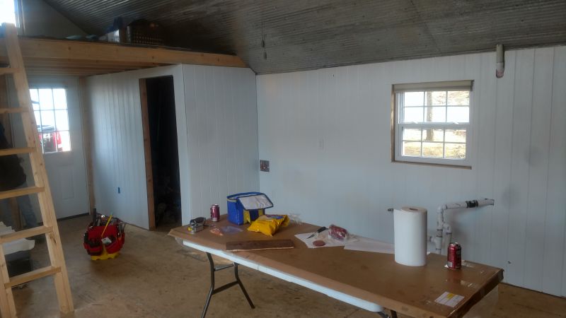

It has been quite a while since my last post. We are still pecking away at the cabin but it is slowly coming together. Our cabin funds are limited so it is a slow process. Here are a few pictures of the progress.
jjr
# Posted: 4 Feb 2017 02:44pm - Edited by: jjr
In order to save a little cash, I am using cedar fence pickets for all of the trim. So far so good. It's time consuming cutting and sanding but it gives the look we were going for.
I hope to have quite a bit more finished within the next couple of weeks then it's on to the flooring. We are still up in the air on what to use for the flooring. Since its unheated in the winter except when were down there, we are really concerned about vinyl click flooring separating. Not sure about laminate either but we definitely want to stay on the inexpensive side of things while still keeping the cabin look. Any experiences or suggestions?

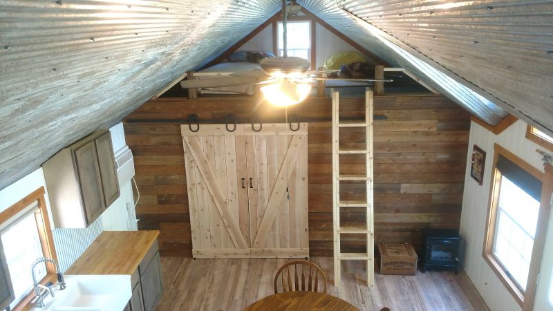

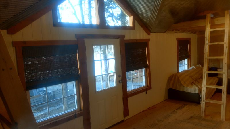

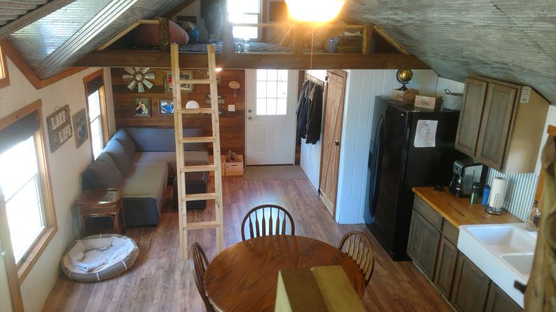

jjr
# Posted: 8 Feb 2017 04:51pm
Thing are moving along pretty good. We were able to put lap joints in all of our cedar fence pickets and stain them yesterday. Made it down to the cabin today to install them. Here's a few updated pictures.

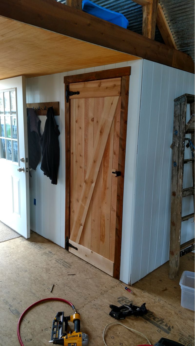

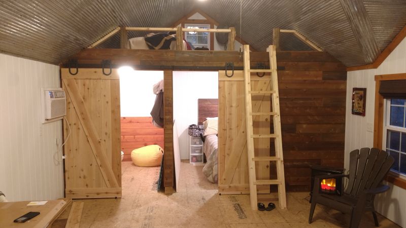

jjr

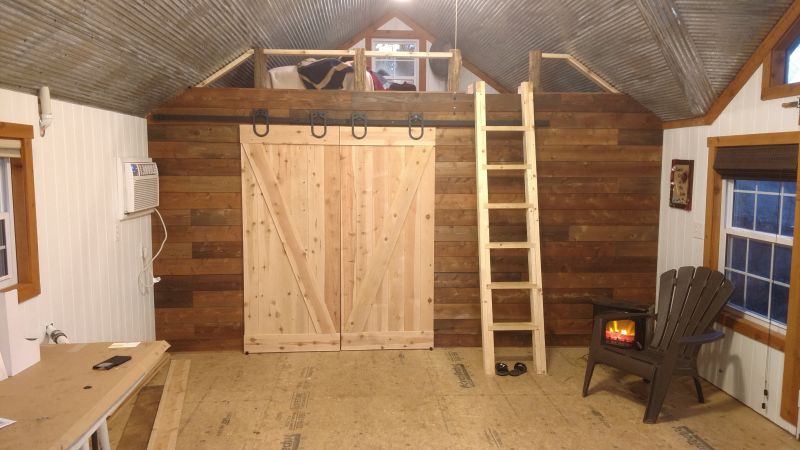

# Posted: 18 Feb 2017 11:20pm
Built some barn doors out of more fence pickets. Can't beat $27.50 per door!
Cowracer
# Posted: 22 Feb 2017 02:34pm
I see you got a little TV in the corner set to The Fire Channel.
LOL
The doors look AWESOME!

jjr
# Posted: 22 Feb 2017 09:56pm
Haha,. Never thought of it as a TV but if the shoe fits! We would love to have a real wood burner and hope to get one in the future when funds allow. We have so many other plans that need to come first though. Maybe even a new dock if mamma let me.
jjr
# Posted: 22 Feb 2017 11:10pm
For those that were thinking of using cedar fence pickets on the interior of their cabin, or anywhere for that matter, I had a conversation on another thread as to just but them or put a lap joint in them to make them like ship lap. I opted to put a lap joint on the sides of each picket. I think this makes for a better finish. When the boards shrink a bit, you will not see through the cracks. Just my two cents.
hct4all
# Posted: 24 Feb 2017 09:36pm - Edited by: hct4all
Looks great. .Where did you get your door hardware?
jjr
# Posted: 24 Feb 2017 10:50pm
Believe it or not, Walmart.com. I'm not a huge Walmart fan but I couldn't even get the parts and build it myself for the price they were selling it for. I had to cut down the bar the pulleys hang on to get it to fit where I wanted it but it was worth it.

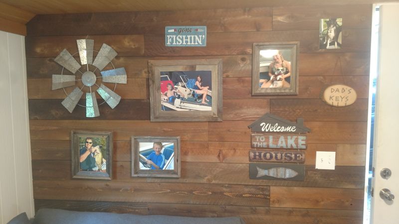

# Posted: 9 Mar 2017 04:14pm
We were able to get to the cabin today for a short while. Built the last door today! The cabin is definitely my happy place! All worries just seem to melt away.

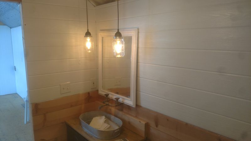

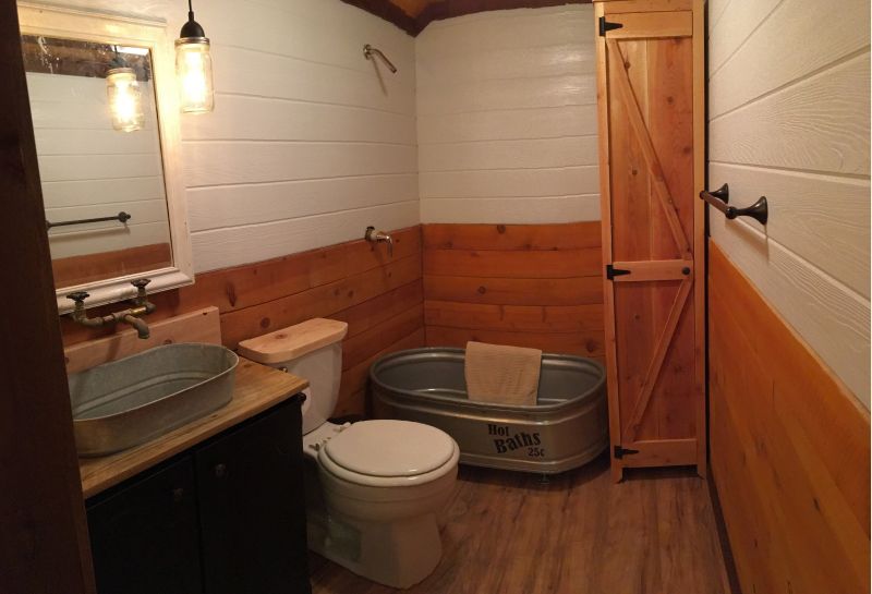

# Posted: 28 Apr 2017 08:53pm

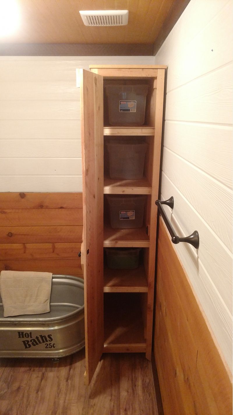

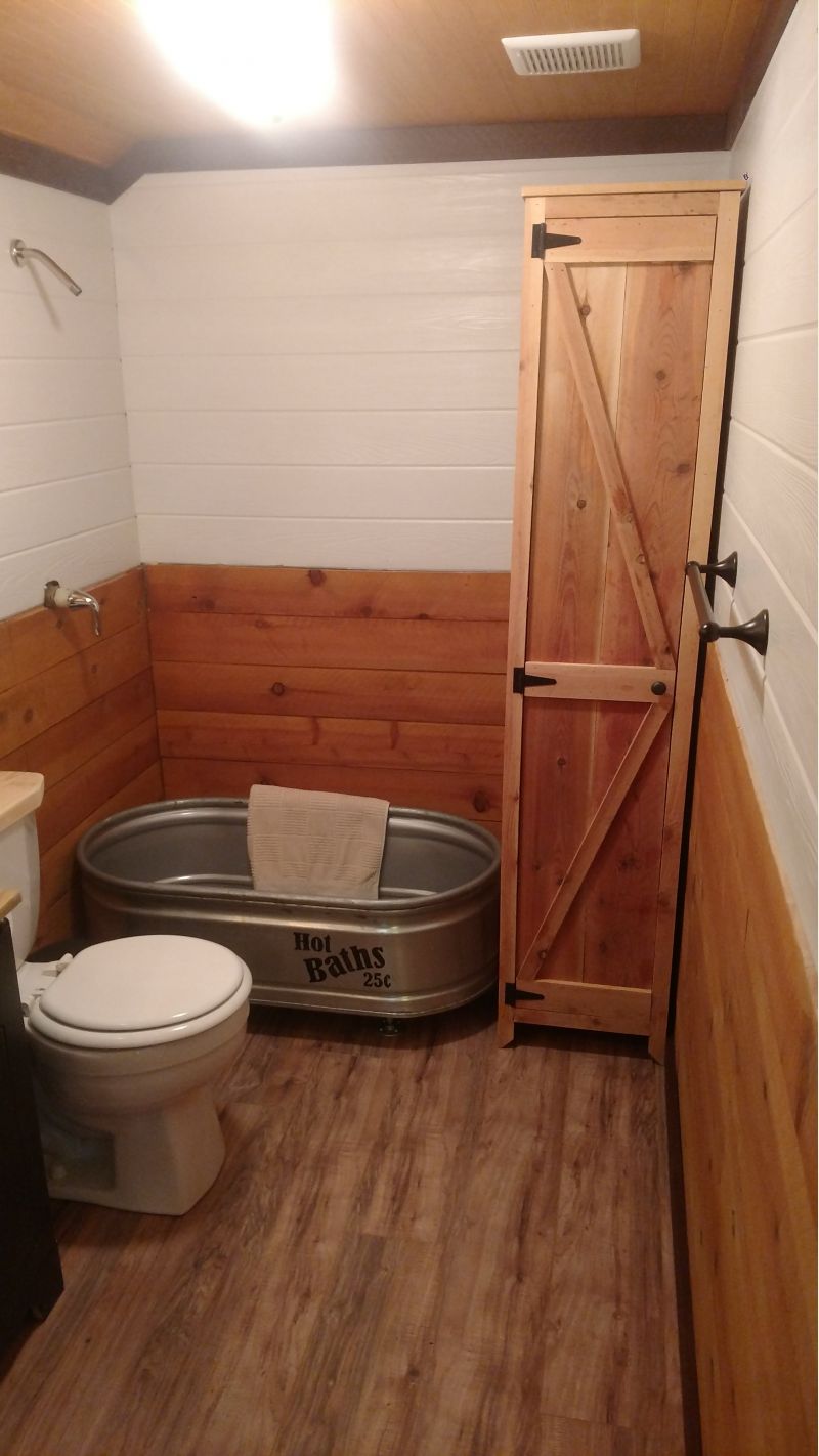

My fence picket project of the day. Fun day building at the cabin!
Cubbord
Cubbord
Cubbord
Cubbord
Cubbord
Cubbord
Bathroom
Bathroom
