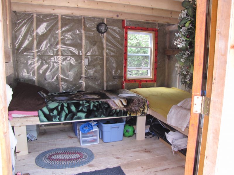

Hello,

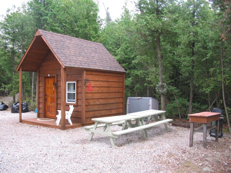

First of all...great website! It's funny how so many of us crave our own little piece of heaven in the bush. I've learned alot from the postings in the past (thank you all for sharing your projects and experiences!) and have finally joined in now that I have something to celebrate with the rest of the folks!

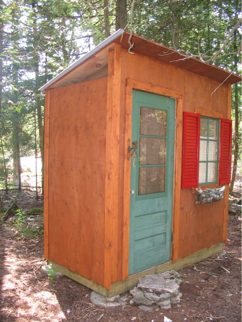

About a year ago we purchased two acres of bush near lake Huron and have since put up a bunkie, outhouse (luvable loo compost toilet) and had a well drilled this summer.

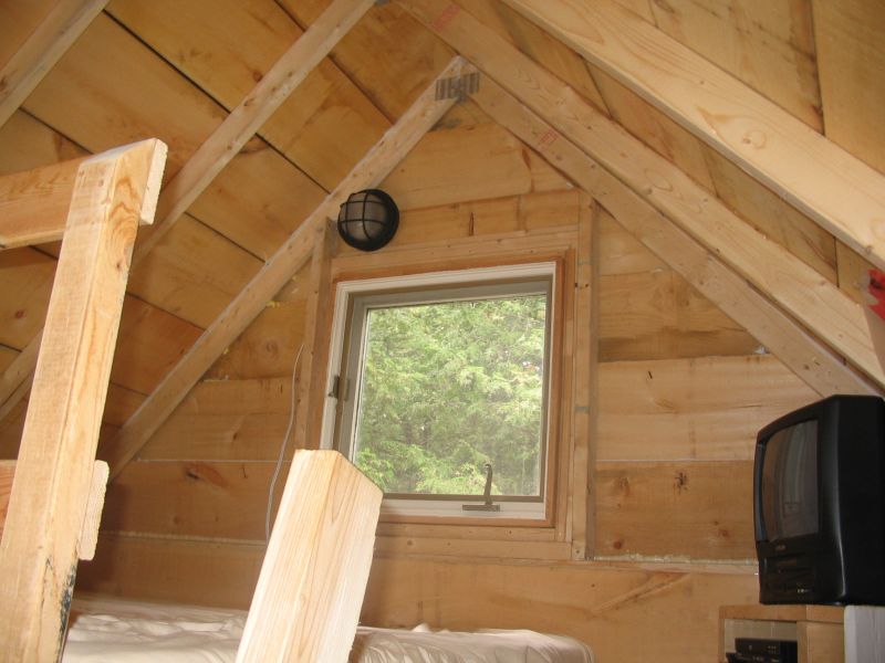

The bunkie sits about 13 - 14 ft high. Main floor is 6'5" under the loft area and the loft is 6' at the peak. It's 2 x 4 framing and made primarily of 1" - 1 1/4" barnboard planking.
It has an additional 4' overhang so my wife and I can sit in our mainfloor bunks , open the door and watch the rain when the weather's not great.
We're working on storage solutions for under the bunks and I've installed a few cabinets as well.
It is now insulated and wired with a 2000 watt generator. This is used only when needed, as we prefer the peace and quite of our surroundings. We picked up the door and three windows from a Habitat Re-store...the door, window and shutters for the outhouse are all "curbside treasures".
The bunkie looks out to the bush...but Lake Huron is a 5 minute walk at the end of our road.

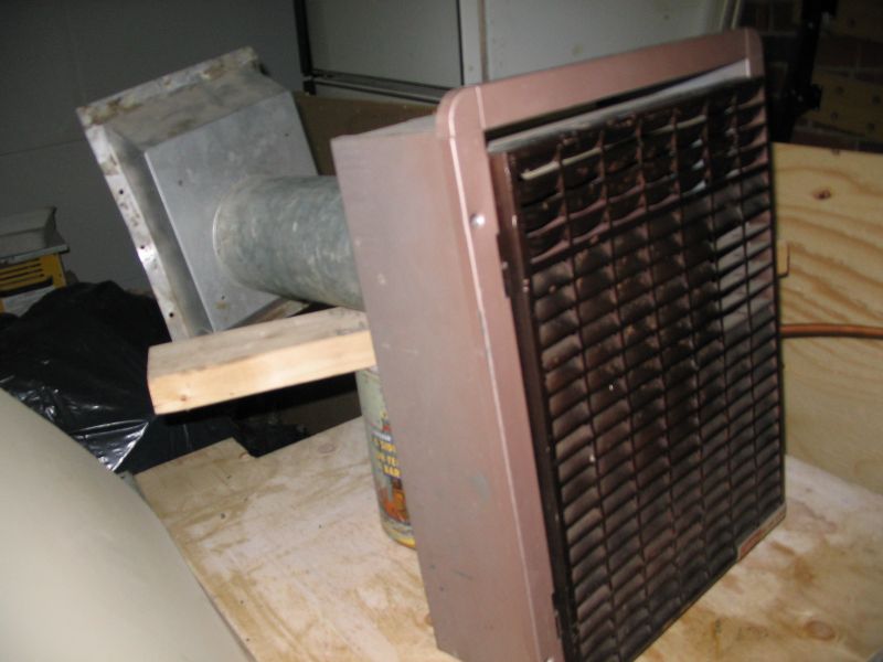

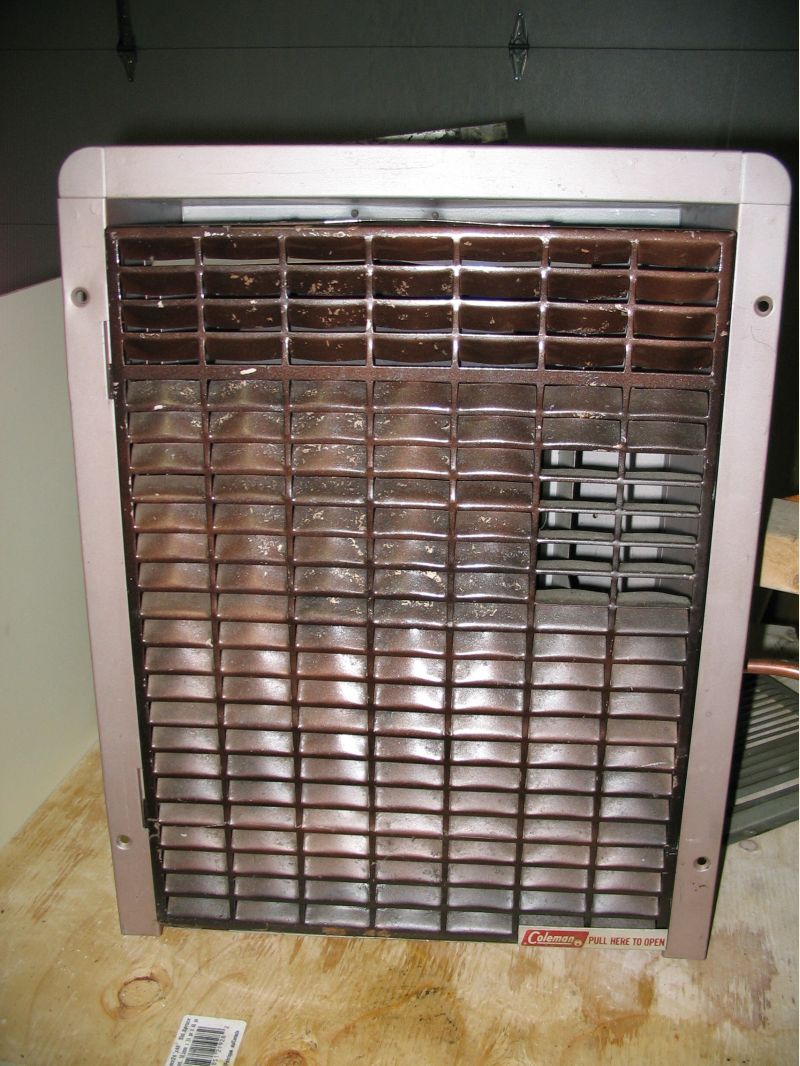

My next project is to heat the bunkie...I was able to pick up a reconditioned coleman gravity propane furnace that was salvaged from an older RV. These vent out of the bunkie through the the double pipe, while bringing in fresh air. It's about 10 - 15000 BTU, so I'm hoping it will do the job. Very few working parts, no blower, so no electricity required. Simply runs off a propane tank.
My other projects will be building an outdoor shower and an organized cooking area, where pots / pans can be stored, etc.
Any thoughts / ideas welcome.
Thanks.

nice camp you got there! any construction photos documenting the build you can share?

That is a super Outhouse!

What a great looking cabin and "loo". Hope you enjoy it.
The small cabin size does have its challenges for gear storage and cooking but we found they are not insurmountable.
Your heating suggestion sounds like it will work well. We found it helps to have some sort of air circulation or else you will end up with the loft reaching +40C and your feet will still be freezing. A simple dc oscillating car fan worked well in our situation to distribute the heat more evenly.
Please keep us posted on your progress.

Fabulous cabin! I love the little bell outside the outhouse door. *S* Keep us posted with updated pictures as you get them.

Thanks CabinBuilder! I build the projects....my wife is responsible for the aesthetics :)
She's on board with the cabin experience...as long as she has a nice outhouse!

The salvaged gravity vented furnace has been cleaned and is ready for the install.

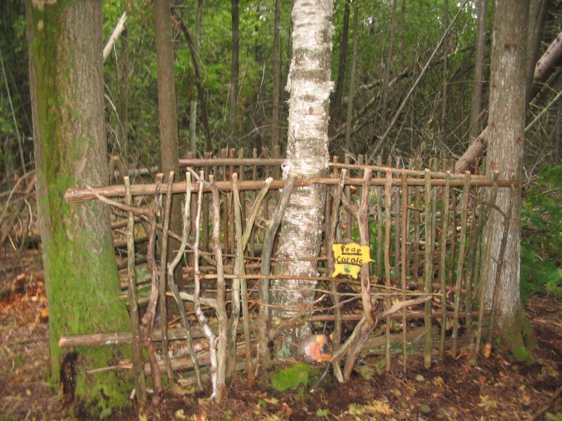

Our "poop coral" where we recycle our waste (humanure concept)

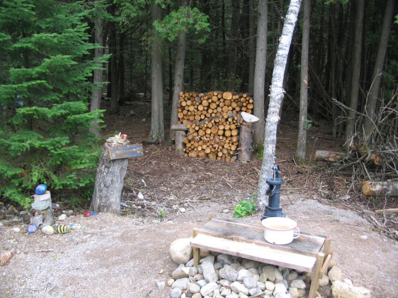

Our water supply with hand pump

Hope the heater works for you.

Interesting corral. So is it to keep things in or keep things out??? Hee hee

Where'd you get that well pump?
We will be shopping for one as soon as we test out our newly found well.

The ol "poop coral" seems to doing it's thing (named by my nine year old...he made the sign).
Hey Gary,
Thanks for the kind words...my wife's one condition for joining me on my cabin adventure was that she at least be able to "pee in comfort"....hence the nice loo. The shutters, windows, door were all curbside treasures...I put in a mini solar panel and light for the midnight visits...and of course a magazine rack!!! I can tell you that using peat moss and following the instructions from the "lovable loo human compost website" really does work...no odour and breaks down pretty quickly once it's been dumped in the compost coral.
Re. the pump.....Not sure where you're located, but in Ontario we have TSC stores.....Farmer Hardware store...everything you can think of.
They carry the hand pumps for about a 100 bucks.
Ours works slick.....little labour, but great water.
The website : Survival Unlimited seems to carry a selection as well...just google.

Do you make a "deposit" into the pooh corral by the pail full and then cover the deposit with a mulch material? We dump each pail full into large garbage cans with leaf mulch/mold. After two years or so we are going to dump the can contents into an open air composter like your corral. Or at least that is the plan.

Hi Bugs,
We deposit each five gallon bucket into the corral.
The fresh bucket starts with a 3" layer of peat moss and every subsequent "deposit " gets covered in a 2" layer of peat moss.
I just buy a large bag of peat moss from the Nursery and it lasts most the summer...the peat moss also makes it flow out of the bucket much easier and cleaner.
Once dumped in the corral, I throw another few shovels of peat moss over it.
We've only been doing it for a year, but I'm surprised at how quickly it breaks down...and no smell.
At some point we will recycle it into a wildflower garden...my wife's idea.

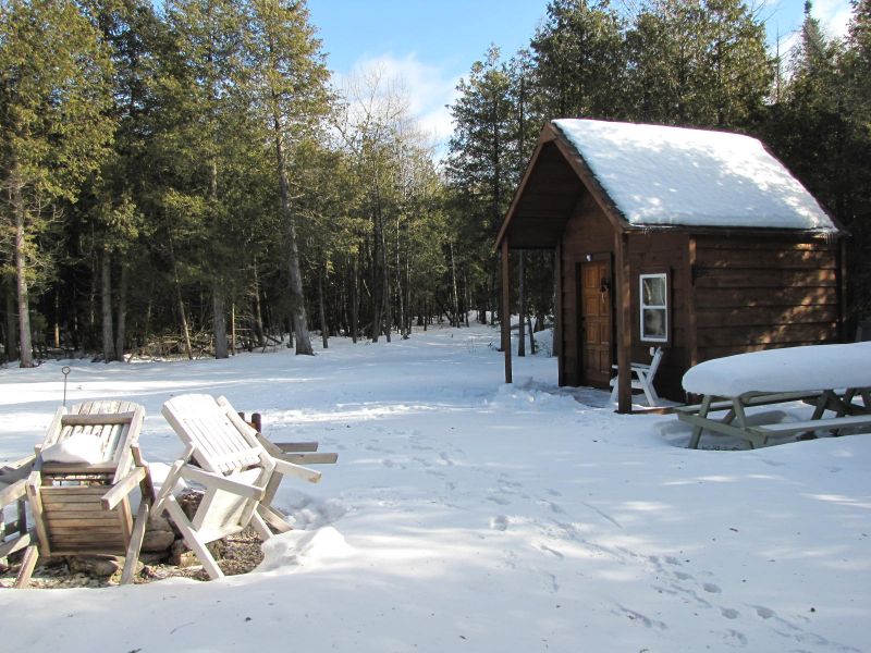

Bunkie in February
Bunkie in February

Quoting: bushbunkie
Bunkie in February
Nice winter picture of the cabin/bunkie - makes me wanna drive to my cabin now and spend some time there...
