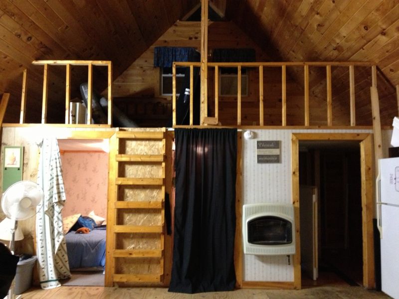

I have a ladder on the wall. 12x25 with no room to spare. One thing that helps is having a small shelf next to the ladder just below the loft to set things on while you climb down, then grab it from ground level. Or just chuck the stuff onto the bed.
My loft is just storage, stairs would be a waste of space. If I slept there it might get old.

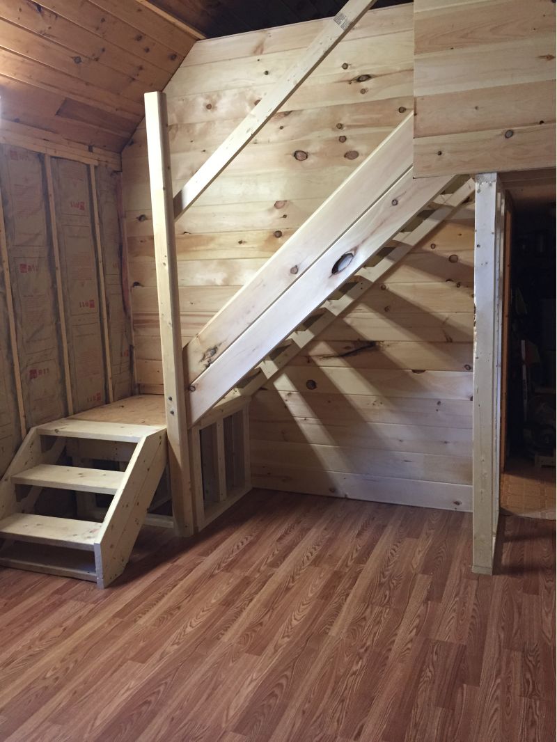

# Posted: 30 Jul 2017 01:31pm

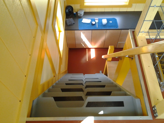

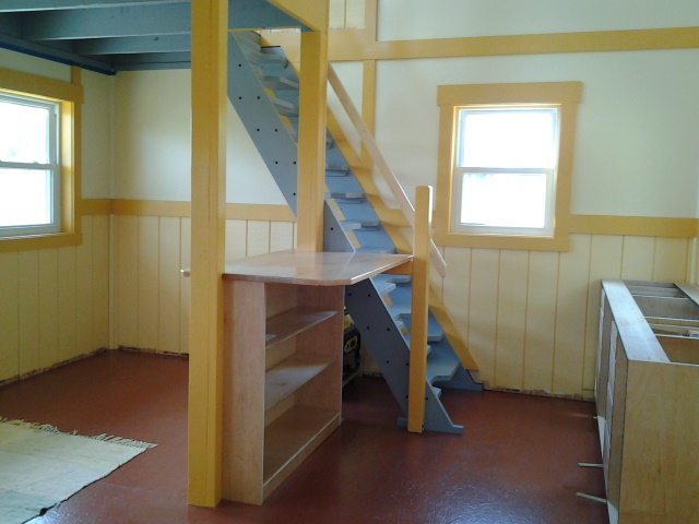

How about "ship stairs' or alternate tread stairs?
I made some for our cabin and while that can take some getting used to, they are so much better in all ways then a ladder.
I've included some pictures. The cabin is 16x20
Bret
Ship stairs
Ship stairs
Ship stairs
Ship stairs
Ship stairs
Ship stairs

You can put them on a much steeper "slope" than a normal set of stairs, close to the angle a ladder has. They take up much less floor space because of that.
I have regular stairs, very close to standard rise, but I gave up valuable floor space on the bottom floor to get them. To me it was worth it, but I looked long and hard at the alternating "Ship stairs"

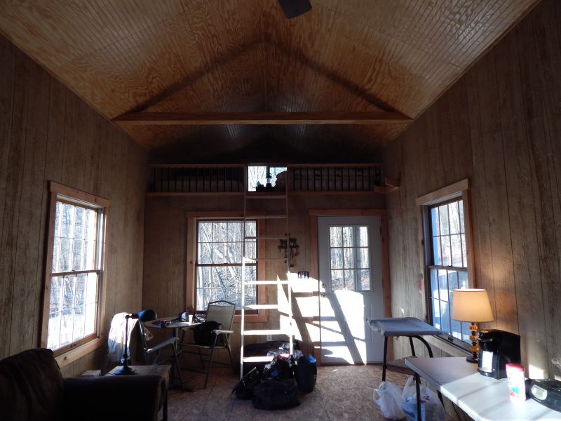

Thelar
# Posted: 31 Jul 2017 03:01pm - Edited by: Thelar
We bought our camp almost ten years ago. It is 20x36. It had a loft ladder. I pretty much used it for storage the first couple years. I finally added 30' extra to one side of the loft and added stairs. Ever since they are used every time we go to camp. It did take up some space, but I ended up with storage space under the stairs. One of the best improvements we have made.

Bret
# Posted: 31 Jul 2017 04:01pm
Using the ship stairs allows you to walk up and down naturally as you would any regular set of stairs.
Coming down would be extremely hard if the treads were full depth all the way across. You would have a very small landing space and would have to turn your foot sideways to land. Dangerous!
Going up wouldn't be as bad, but you wouldn't be able to lift your leg naturally. You would have to swing it out to avoid the step above.
The stairs have worked great with many using them.
Yes, they are steeper, but save on space and much easier to use than a ladder.

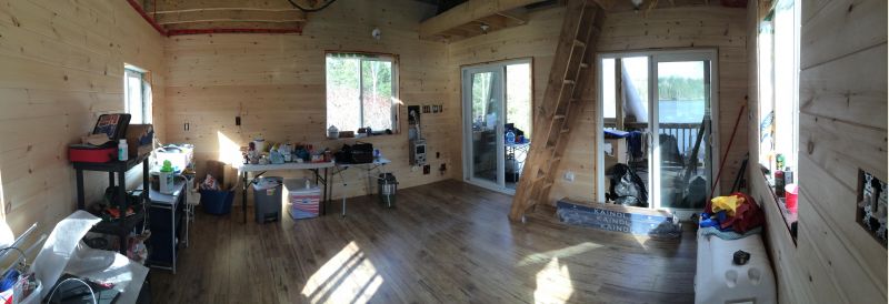

This is my situation. My ladder can be removed and hung on the wall. Hope you can see it.

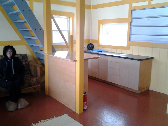

# Posted: 4 Aug 2017 10:14am - Edited by: razmichael
Very happy with our alternating tread ladder. Different design than Bret's but same space saving advantages. No one has yet had any issues getting used to it and we go down facing either way. Couple of photos (one early in the build, the second with railings added).

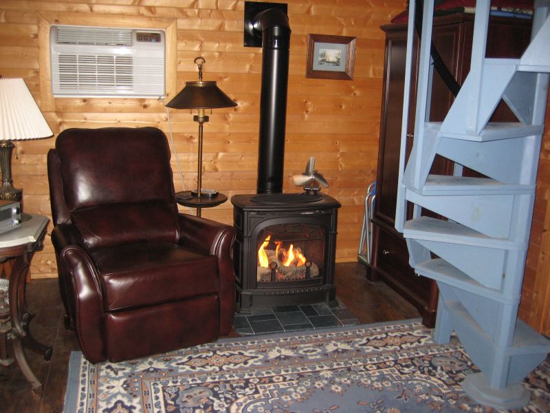

drb777
# Posted: 8 Nov 2017 07:46pm - Edited by: drb777

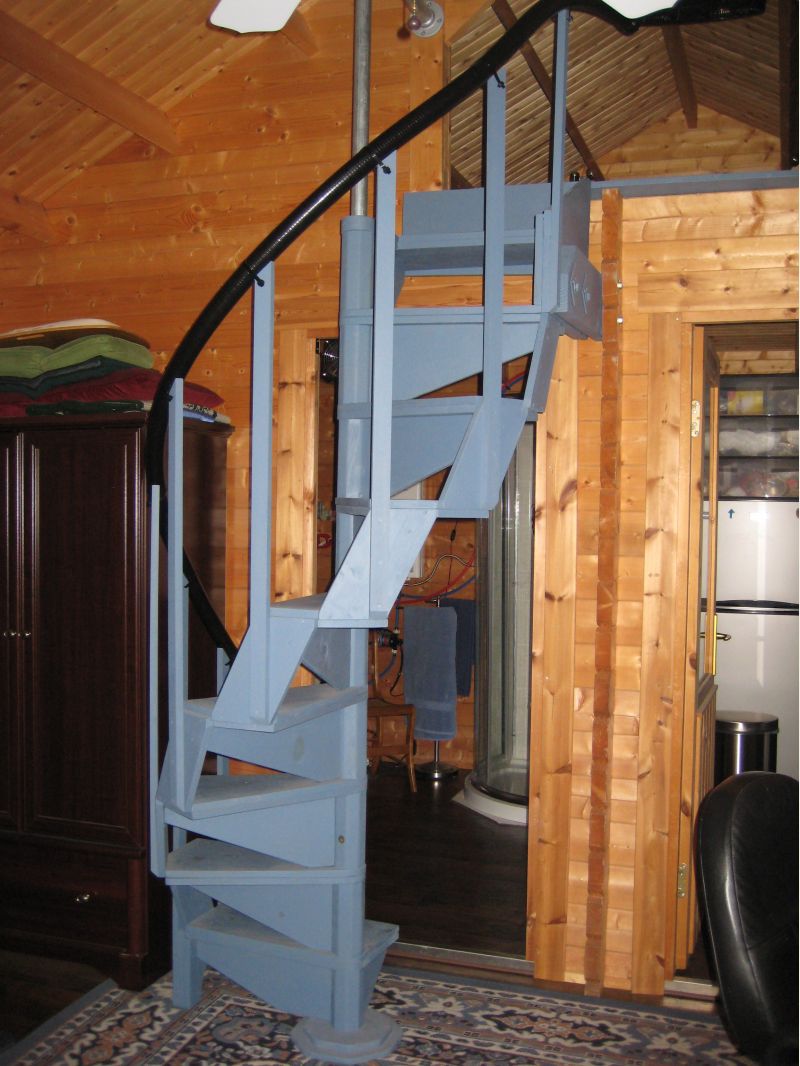

I went the "cheaper spiral staircase" route. 'Purchased some plans and built my own.
Even compact design spiral's tend to feel a bit obtrusive in a small cabin.
Also available as a DIY assembly kit.
compact spiral stairs
spiral setting
spiral setting

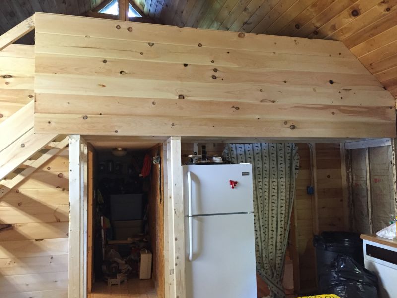

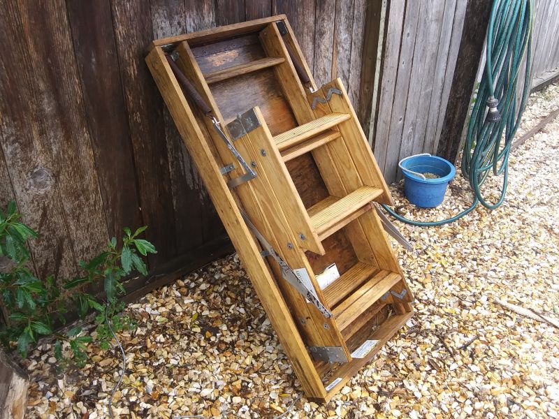

So last night I was perusing Craigslist looking at staircases and came across this, which I bought on the way home today for $20. Never been installed but unfortunately stored outside. Everything but the top plywood is solid though. I have no idea how I could incorporate them into my situation but for 20 bucks it's worth checking. Think I'd still prefer my stair/ladder idea, since it really wouldn't be in the way when vertical.
I don't need to carry anything with me when I go up or down, it's low enough that I have been tossing things up and down for the last 5 years. Our bed is directly in front down below, makes a perfect landing pad for items I pitch down.

My wife, who is wheelchair bound as you probably know, has been itching to get up in the loft since I 'remodeled' (finally used all the insulation and building materials that were up there) and put up some bamboo deck furniture from the storage shed.
Out king size bed takes up a lot of room in a 12x25 cabin, sleeping up in the loft would free up that space but she would need a large platform, not just a standing lift. No room for that, and no quick way out in a emergency. For a standing lift I can visualize a simple winch and a track with a foot platform. Let us know what you come up with.

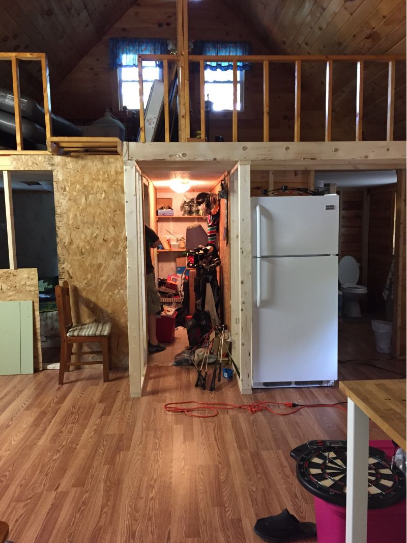

Here's my loft as of yesterday. I did put a dresser filled with linen and some coats up there so will need to get to those occasionally.

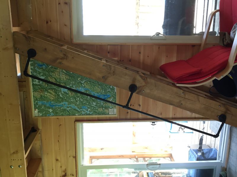

# Posted: 2 May 2021 07:48am
Paulz. My thoughts on a lift. Basically a chair lift because my beautiful wife also has foot issues. For a track, I would use 1" black steel pipe. Fastened in place with a flange at bottom go 10' up 90 degree angle 3" nipple to flange. 2 ea. 2' apart or so .
Weld up a frame using 1-1/2" angle iron . Like a L with a support gusset angled to make a triangle. Make a seat so she could back into it on to the platform/ seat. Use 1-1/4" pipe 4ea on each corner on back of platform frame to slide up n down over the 1" pipe. Use a 12v winch mounted up top to go up n down. Should only take up a 2'x3' floor space or so.
I could draw it up if needed hopefully you can picture it . Maybe someone else can. If I explained it clearly.
