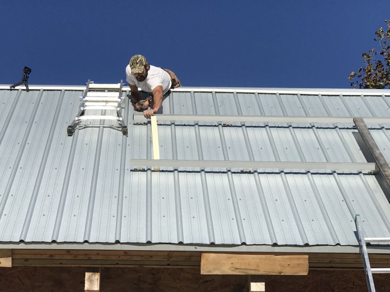

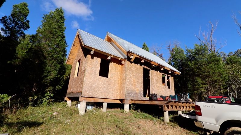

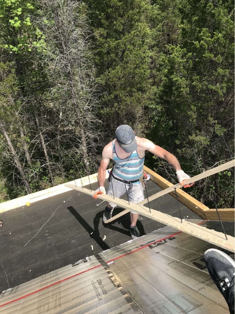

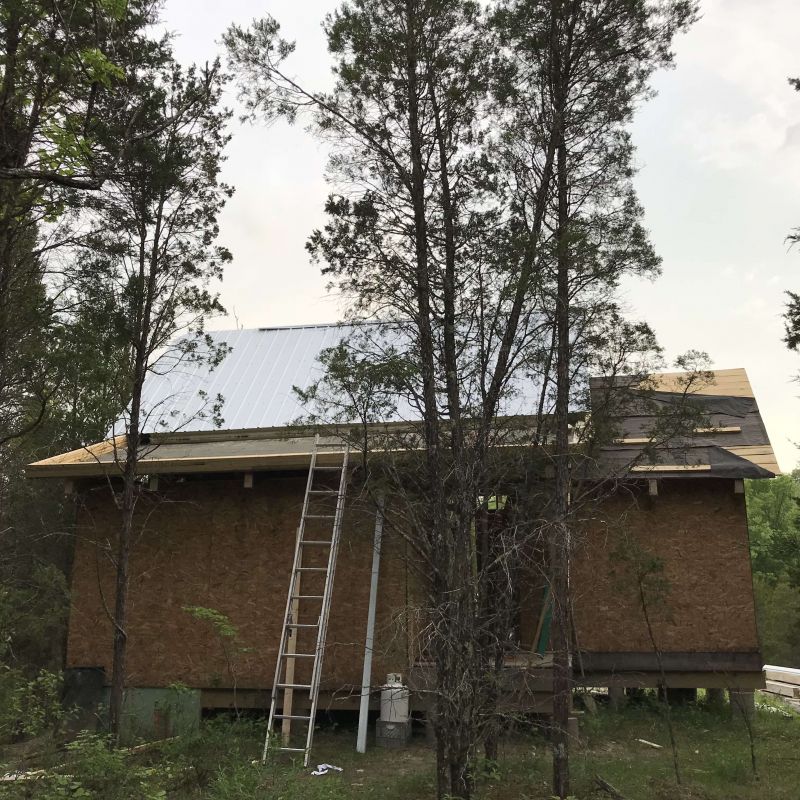

We got the North side of the main roof insulated and roofed. This was really tough work, the angle of the sun was such that the sun was reflecting up off the foil faced insulation and back at us. It was like working in a solar oven. We could do about 15 minutes of work before needing a break.
Mostly time lapse video of how we are insulating and roofing. https://youtu.be/viabiXnrcjs IMG_0996.jpg

I just watched your roof insulation video. It was very informative! We'll be eventually building a timber frame cabin, and I was curious about this step. Great job on the pictures and videos!

Thanks Whiskey Jack, glad it helped you. I have one more tip, that I forgot to mention. I'd add a half inch or so to my screw length. My screws were 8 inches, and in theory they needed to go through 6.75 inches of material, but everything doesn't lie perfectly flat, so another half inch of screw length would have helped torque everything down. I kinda had to treat the screws like a tire nut, and torque them all bit by bit or risk stripping out the wood. It did eventually work out where everything got real solid, but longer screws would have meant I didn't need to be so careful. Good luck with your build and we'd love to follow along once you get started.

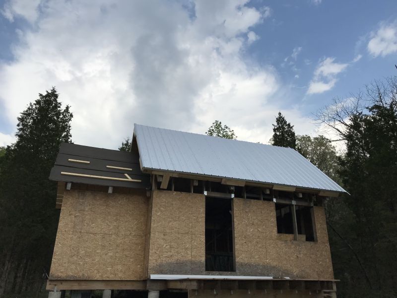

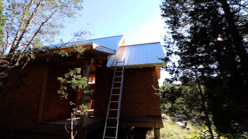

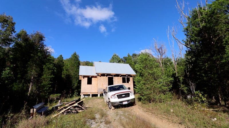

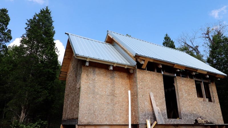

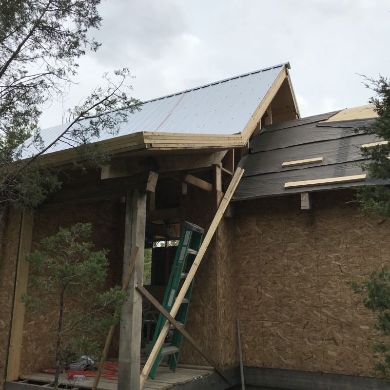

Did a bit more roofing yesterday. Really trying to get it dried in before this deer season. Probably going to order windows this week. I still have to do the back side of that little roof, finish up some sheathing and flashing and then house wrap it. Still_Roofing.jpg

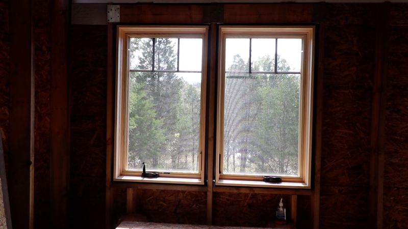

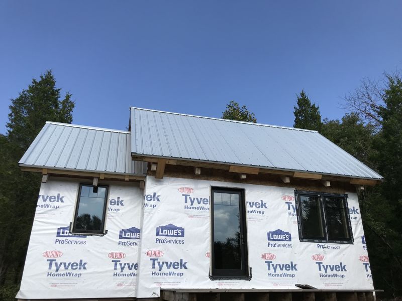

We got our doors and windows in. Excited, didn't think we'd ever get this far. I'm excited to be able to make winter trips, build a fire in the wood stove and get snowed in. https://youtu.be/RKb0X8bI6K8 IMG_1226.JPG

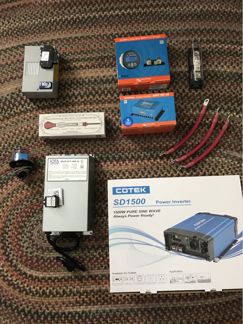

Got a bit more building done, not almost dried in except for this bit in the picture... Also got some solar stuff in the mail today. Almost have everything I need to complete my install. Made another video chronicling the latest progress.

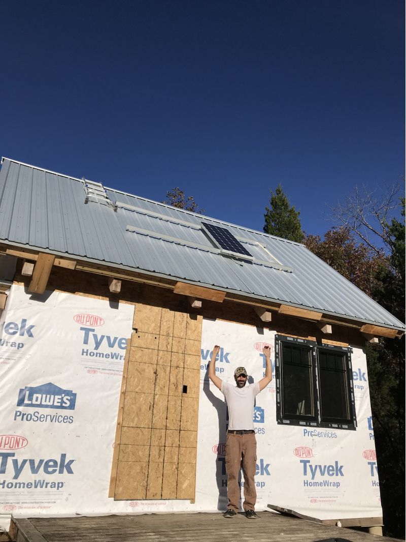

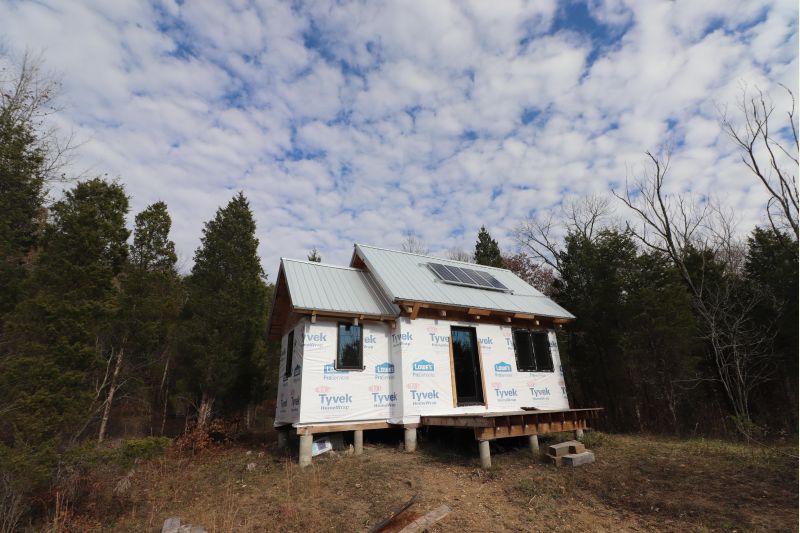

We started installing the solar panels today!

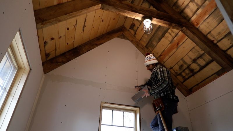

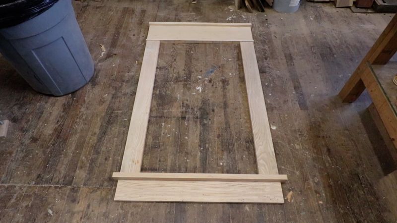

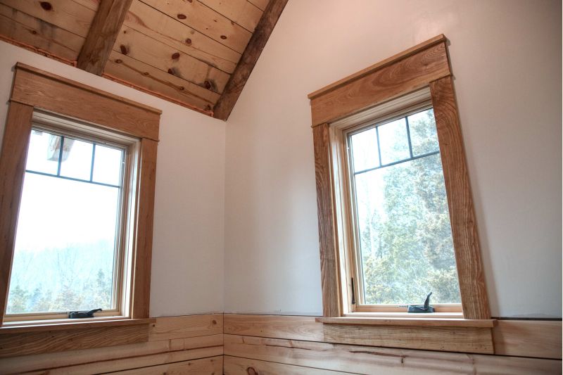

I've been working on Drywall and finishing out the bedroom so I have a clean warm place to stay during my work trips. It's nice to keep one room clutter free and almost livable... I also made the window casing for the bedroom. I'll install that in the next video that I'm currently editing for next week.
https://youtu.be/UNxDau_KAZM Off_Grid_Cabin_Build.jpg

Got my window trim installed:
Video of the process here. https://youtu.be/JQgjvgiQkUc

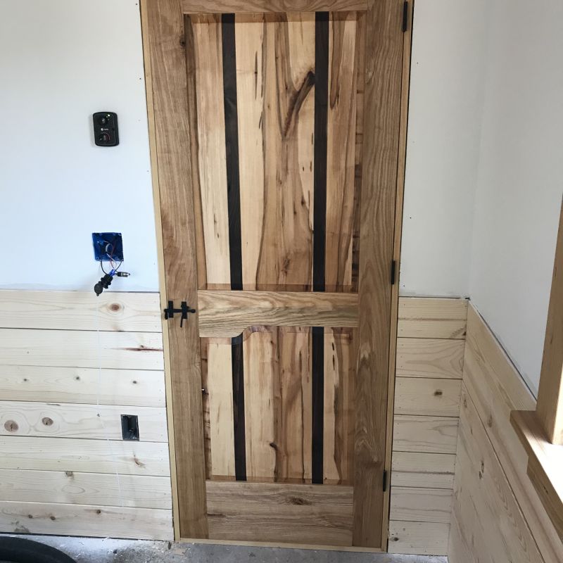

I built a door for the bedroom...
https://youtu.be/gFkc-1HApMQ

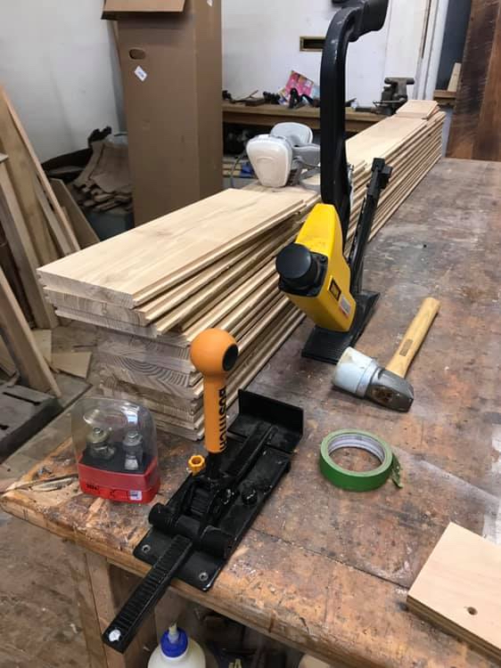

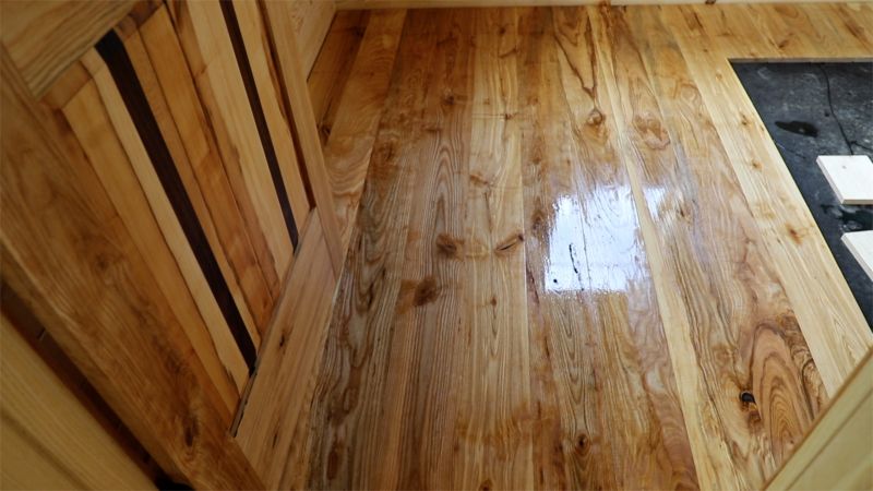

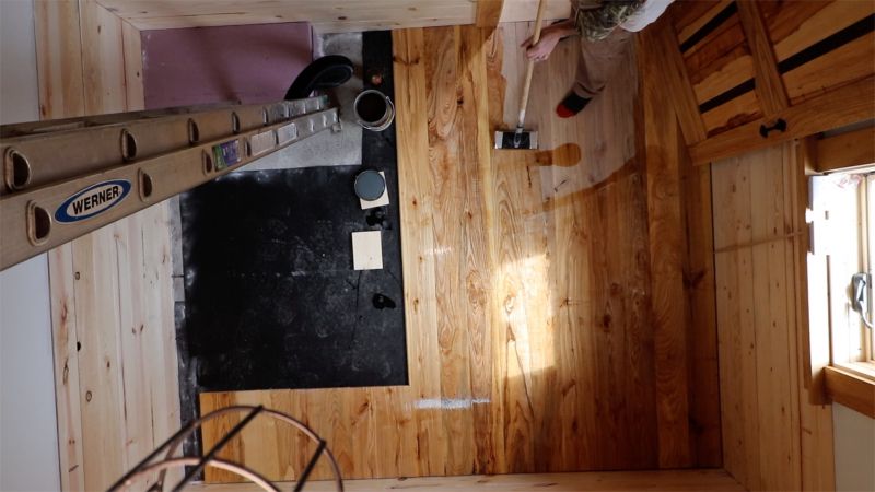

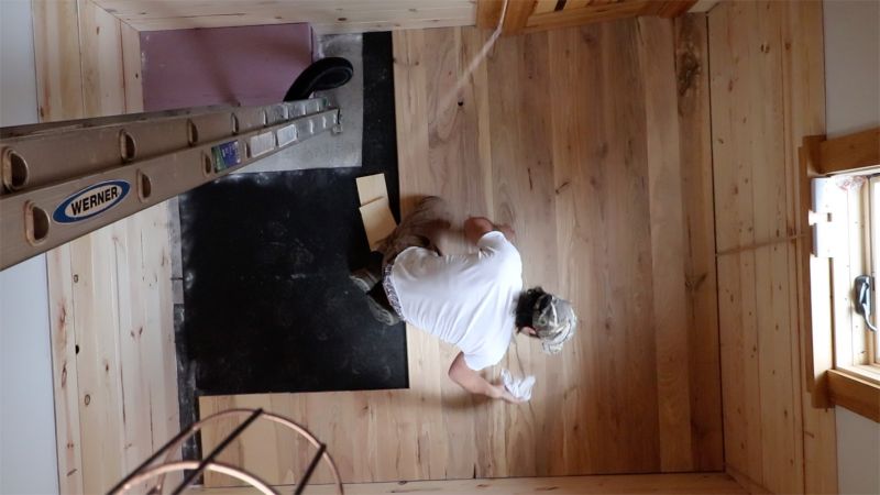

I made some flooring from rough Ash and got it installed and also did some other odd's and ends. Pretty soon we'll transition to outside work, looking forward to that. overhead.jpg

We are also going to be making our own Ash for flooring. I cut my beatle killed ash this past winter and am milling them now. I plan on useing a ship lap joint.
Do you know the moisture content of the ash? Did you let it stabilize in the cabin? Can you keep us updated on the gap?
Mike 870
# Posted: 2 Apr 2019 07:43am
Hi Brett, this site is great isn't it? Congrats on your new property.
After that video my Dad told me he used a ship lap joint on all the wide plank pine flooring he did in our house growing up. At the same time a couple commenters mentioned that the tongue plays an important role in keeping the floor flat... So who knows.
I don't know the moisture content it was kiln dried at Ohio Outdoor Living Group (the place I get most of the wood). I didn't let it acclimate, I figured a bit of expansion that I am expecting will help tighten some of the joints. The cabin isn't climate controlled so it's definitely going to be doing a lot of movement over its lifetime. As long as it doesn't buckle, I'm ok with seasonal gaps...
