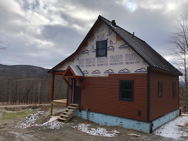

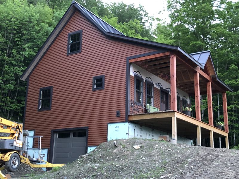

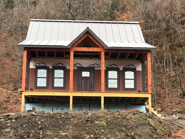

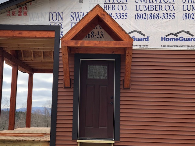

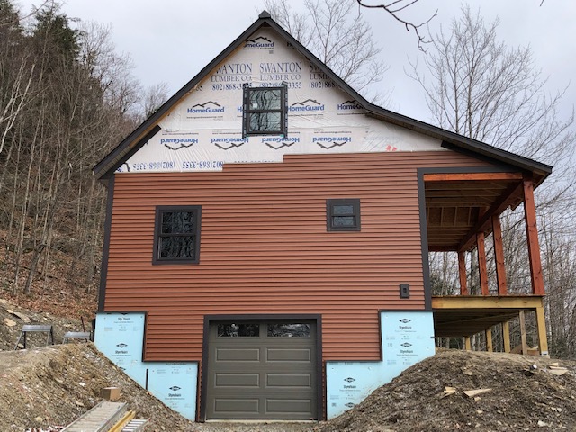

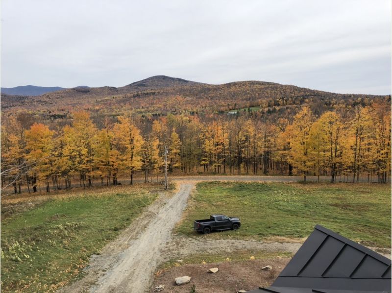

So it's been quite some time since I last posted any updates. I haven't done any work on the outside since the weather turned to crap in November. I have been plucking away at running the plumbing venting above the ceiling and insulating it as well as doing a little wiring. Here is the where the outside stands as of now. I am still waiting for the roofer to come and install the standing seam roof on the entrance overhang. IMG_2016.jpg
Great Outdoors
# Posted: 15 Jan 2019 03:45pm
Here are a few more of the exterior.

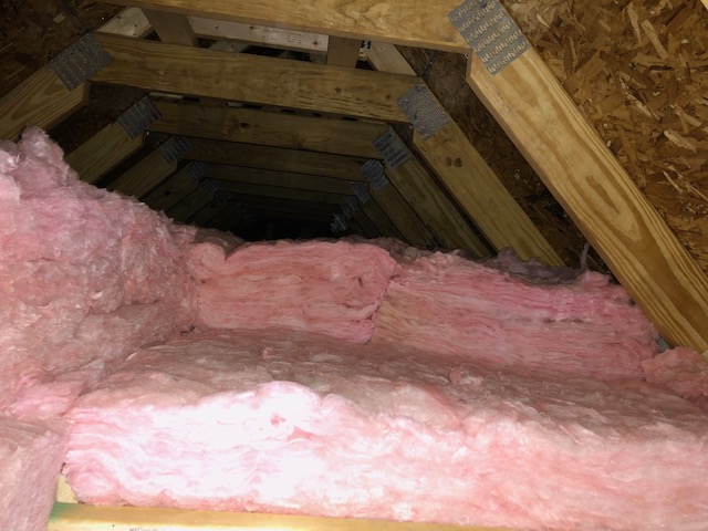

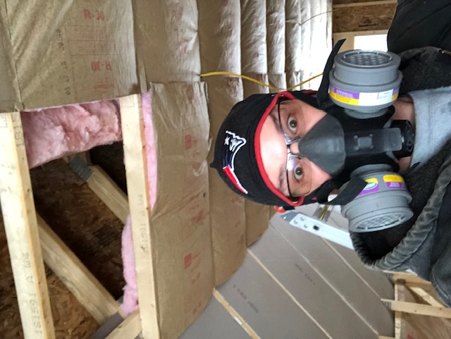

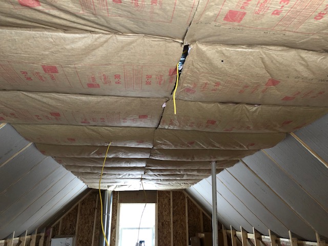

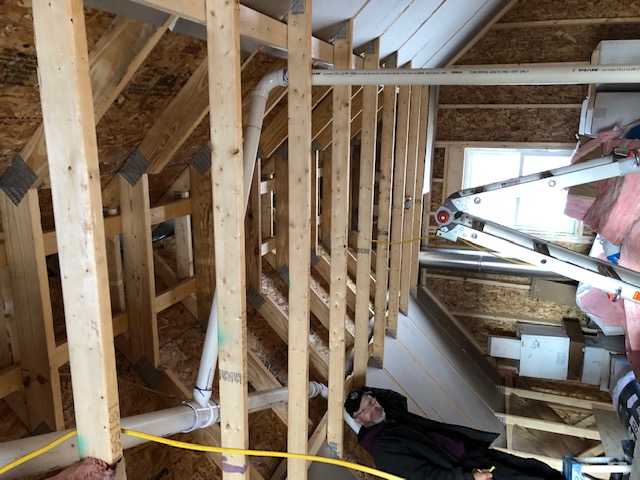

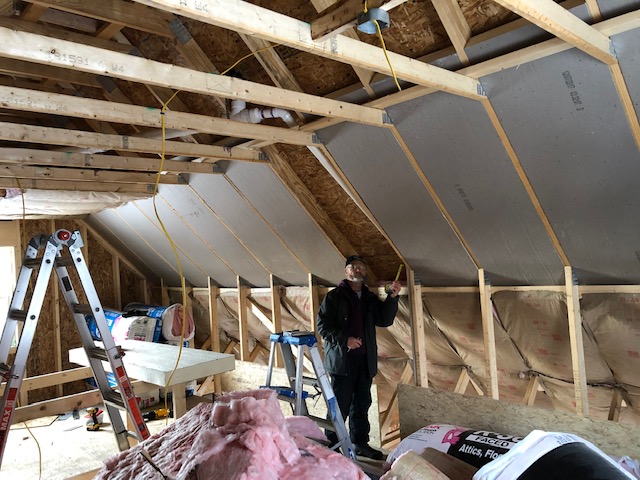

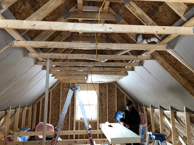

Here are a few of the venting and ceiling insulation. It starts out with R-30 at the bottom, R-27 polyiso on the slant, and finally two layers of R-30 in the actual ceiling. I used Owens Corning Raft-R-Mate baffle vents for between the Kraft faced insulation and the roof decking and then 1 1/2 in spacers under the polyiso insulation to allow for proper venting up to the ridge vent. IMG_2234.jpg
Great Outdoors
# Posted: 15 Jan 2019 04:09pm
couple more... My dad helped me cut and place the polyiso insulation... what a messy and dusty material to work with. I purchased a special 6 inch jigsaw blade made for cutting insulation but this stuff was too dense and thick so the blade wandered.. I ended up using a skill saw on one side which made a huge mess and the jigsaw with foam blade to finish from the other which seemed to work ok.

Finally finished up insulating the cabin the other day. I have been plucking away at it whenever I got the chance. I will work on the wiring when I get a chance but not until after we return from vacation. Sugaring will be starting soon as well and I owe my brother some time for his help and the use of his excavator so it might be awhile before I can get any more serious work done at the cabin.

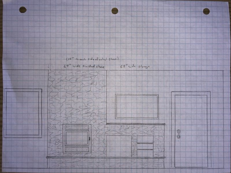

What program did you use to make the drawings in your first post?
Great Outdoors
# Posted: 12 Mar 2019 11:24pm
Thanks Brettny.. I didn't use any program, those are all just hand drawings I came up with on graph paper. It took several hours and revisions before I came up with my final design. Lots of tweaking and shifting things around in order to make everything fit and function. It was a fun process.
# Posted: 13 Mar 2019 10:50am
Damn your good
Great Outdoors
# Posted: 15 Mar 2019 02:34am
LOL, thanks Brettny. I actually enjoyed the process. Working with graph paper makes the drawing and planning much easier. I used to draw a lot when I was a kid but haven't really since then. This gave me an opportunity to do it again! I am working on the future kitchen cabinet sketch right now. I had one done but have since added a couple of feet to the wall they will go on as well as a 70" L section so I will have to redo it. All first floor partitions are up now so I will be plucking away at the wiring when time allows.

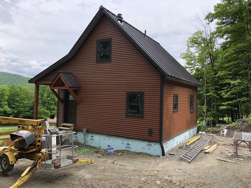

Well I haven't posted on here for quite sometime but that is because I haven't really worked on the cabin until recently. I rented a lift for two days and with my Dad's help and some from my brothers I was able to complete the trim, soffit, and siding on the two ends. I also worked on some of the landscaping and leveled and compacted an area for my kids to play basketball. I have the base for the hoop cemented now I just need to assemble and mount it to the base. The next thing I will be working on will be the porch ceiling but I am still unsure of how I want it finished.

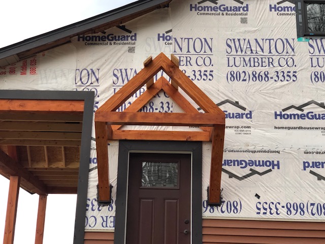

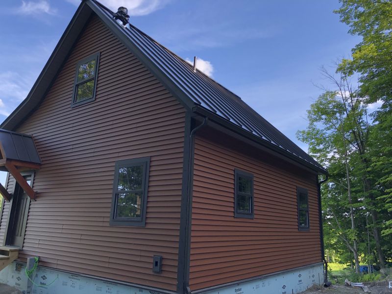

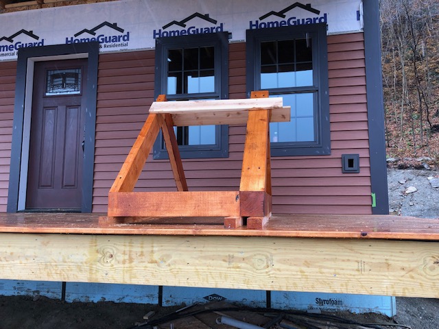

Here are a couple pictures of the finished ends. I haven’t done much up there since. I have been trying to get caught up on my firewood and other projects. I did get a gutter installed on the back which came out nice. C351CD198E794CB8A.jpeg

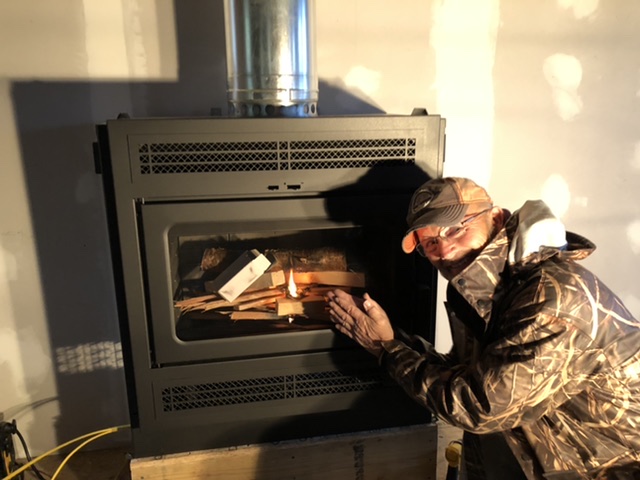

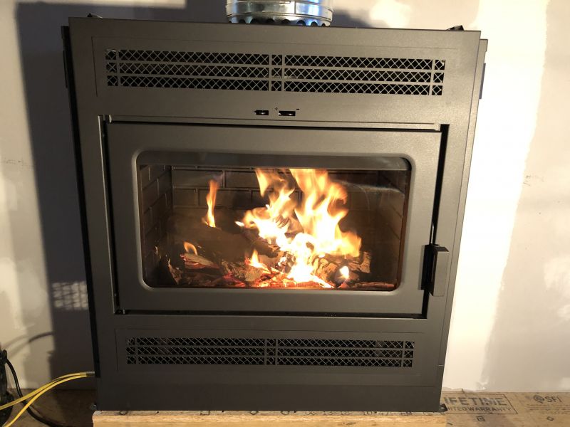

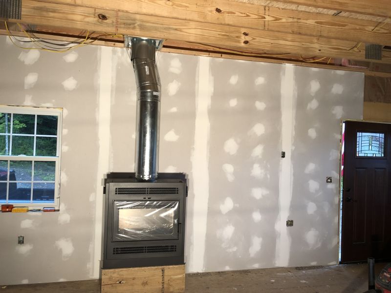

My Dad and I put up some sheet rock where the stove would go then I did a little taping and mudding ( I am far from being a professional lol). We got the stove in place the other day and put up some of the stove pipe. I plan on renting a lift in a couple weeks to put the last sections up through the roof as well as the cap. 42C445F3750847AFB.jpeg

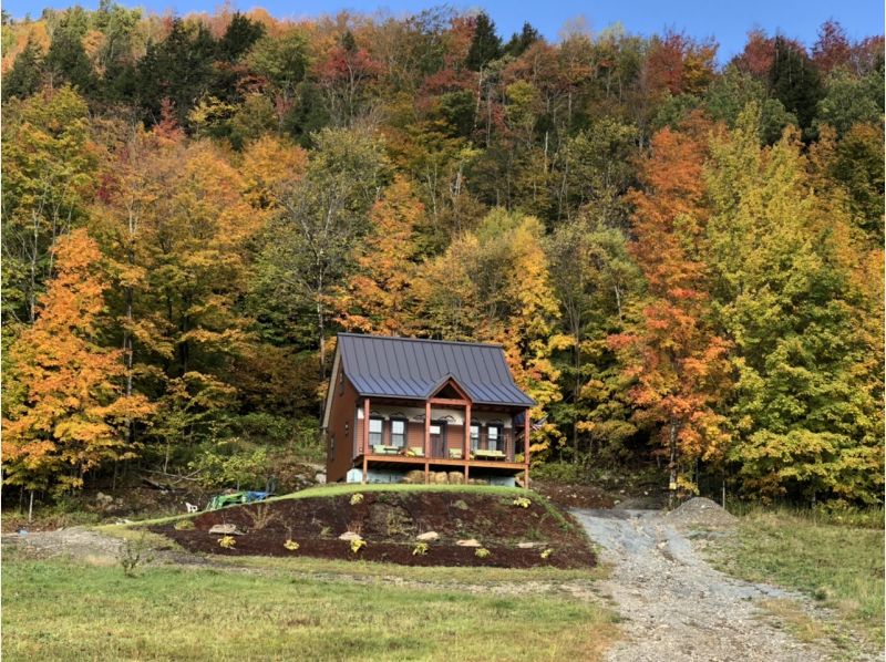

wow, looking great! I bet your view is even more incredible when the leaves turn color.

Is that a wood burning stove? If so, should there be a fireproof material like cement board all around the stove (at least 18" on either side and completely above it)?
Also, did you space any wood framing in the wall away from the stove or provide fireproof materials between the stove and framing?
I was reading this article about fireplace inserts.
https://downloads.hearthnhome.com/installManuals/30491.PDF
On page 9 it talks about framing and the types of surfaces you can use and where you have to use non-combustible sealants.

Rockies, it is a Supreme Astra high efficiency, zero clearance wood burning fireplace. https://www.supremem.com/astra_24TD.php It can be placed up against combustible materials and has one inch spacers attached to it on all sides to allow for a small air gap. The stove pipe is Simpson Duraplus which is an insulated triple wall pipe which only requires a two inch clearance from combustible materials. The stove/fireplace will have a hot air distribution system complete with a separate fan and thermostat to provide heat to the basement (the fireplace allows for up to 3 such systems). There are not a lot of reviews available for this brand of stove and it wasn't cheap so hopefully it turns out to be a good unit. The link you provided contains good information and thanks for providing it.

I rented a lift the other day and we finished putting the stove pipe through the roof. It went pretty well and since I had the lift I put another coat of paint on the trim boards on one side. Today we wired up the blower for the stove and had a little test fire. I was just going to go home after we got it wired but he wasn’t going to go until he got to see the fruits of our labor, lol. 34694BA6915142B28.jpeg
Great Outdoors
# Posted: 18 Oct 2019 03:36pm - Edited by: Great Outdoors
Short video, it puts off some nice heat and should serve me well.

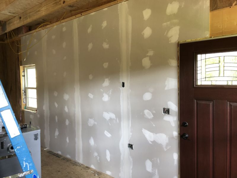

I haven't been on the site for awhile.. need to drop in more often! I didn't do too much on the camp this past winter. I have slept several times up there, usually a couple times a week. I have a little more wiring done and that is really it for the most part. Most of it is done in the kitchen/living room area and once it is I will finish the sheet rock there and then the tongue and groove ceiling hopefully.
