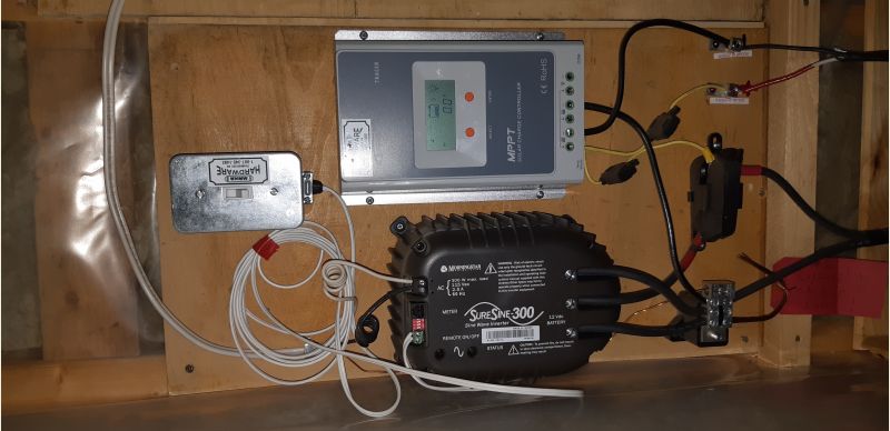

Took a picture of the solar setup since I'm out for the weekend. ![](http://www.small-cabin.com/forum/img/smilies/grin.gif)

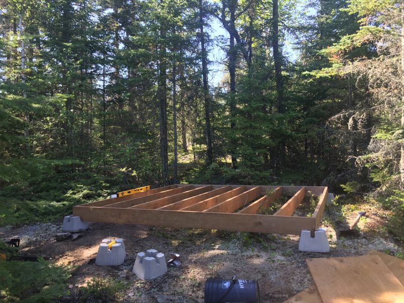

Well the wait is finally over. Was finally able to take the new boat out to the property with a load of supplies and got the floor finished. Decided to go with a simple 10x10 after changing the plans a million times through the winter wait. Excited to finally get out there and get some work done.![3A2DA46CDA8F41389.jpeg 3A2DA46CDA8F41389.jpeg](https://www.small-cabin.com/forum/shared_files/uploaded/8853/126132_1.jpg) 3A2DA46CDA8F41389.jpeg

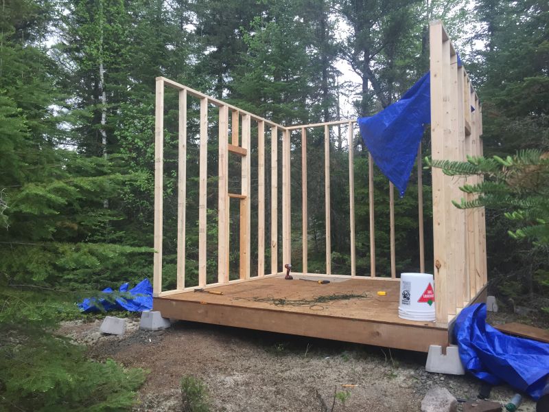

3 walls up today hoping to finish It off tomorrow.![8A2DF1E76EE34790A.jpeg 8A2DF1E76EE34790A.jpeg](https://www.small-cabin.com/forum/shared_files/uploaded/8853/126165_1.jpg) 8A2DF1E76EE34790A.jpeg

# Posted: 9 Jun 2019 21:50
What a great building sight and nature’s best foundation!

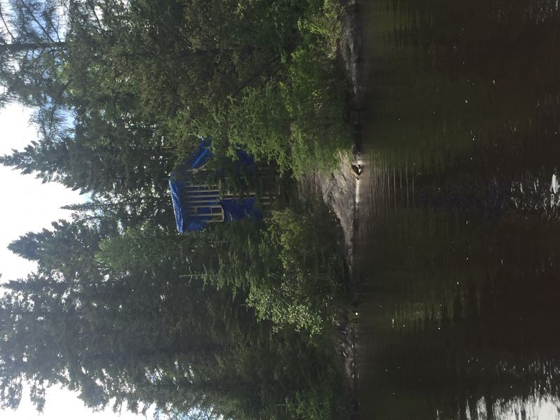

# Posted: 11 Jun 2019 21:31

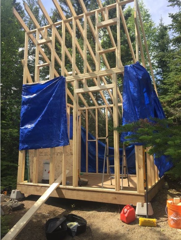

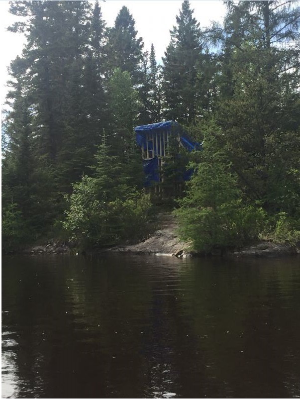

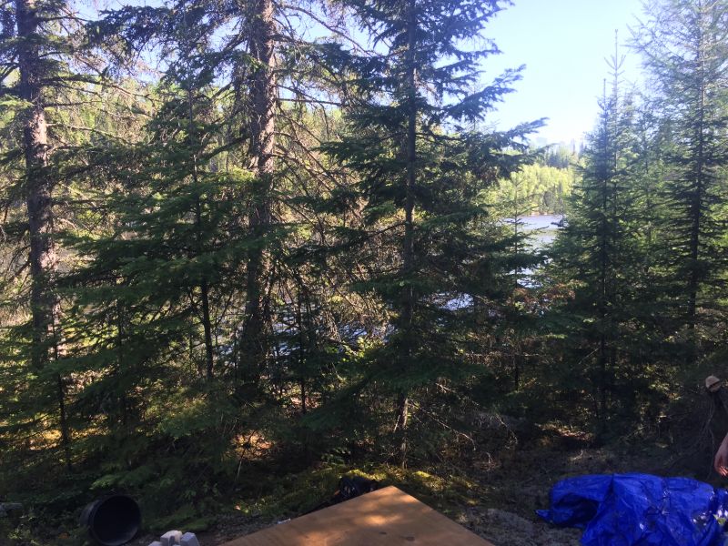

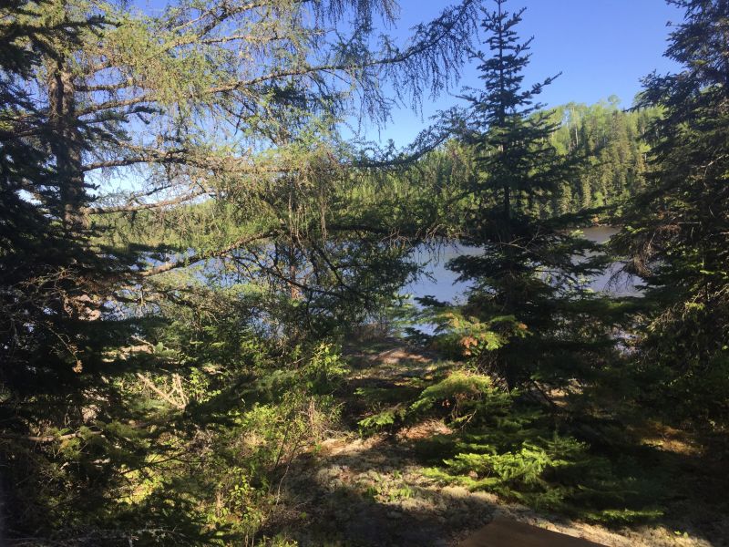

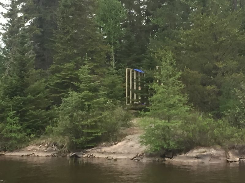

Ya it’s got a pretty nice view in both directions I’m really happy with how the location turned out. I ended up picking up a cheap 12 ft boat and hauling everything in with that. It’s had it’s scary moments especially today with the rafters coming in but so far it’s worked out great. Got caught out in the rain today but still managed to get some progress. Its starting to come together nicely.![484DAE933BD344E1A.jpeg 484DAE933BD344E1A.jpeg](https://www.small-cabin.com/forum/shared_files/uploaded/8853/126210_1.jpg) 484DAE933BD344E1A.jpeg
| ![CFC7430152E24B988.jpeg CFC7430152E24B988.jpeg](https://www.small-cabin.com/forum/shared_files/uploaded/8853/126210_2.jpg) CFC7430152E24B988.jpeg

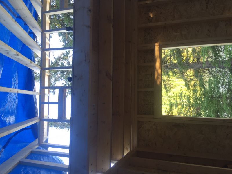

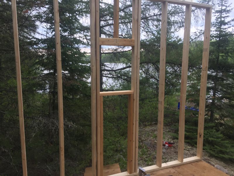

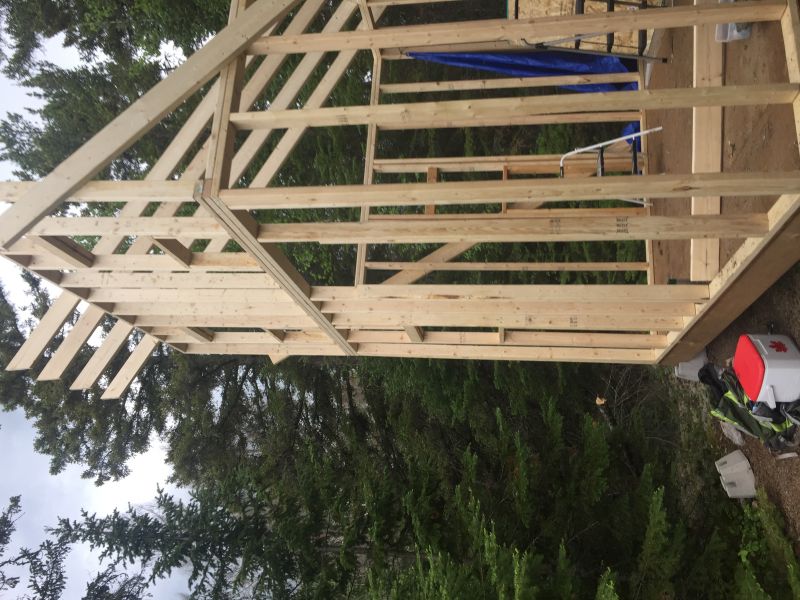

# Posted: 15 Jun 2019 19:11

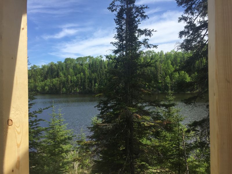

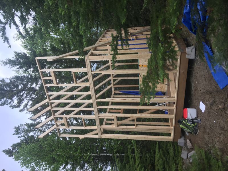

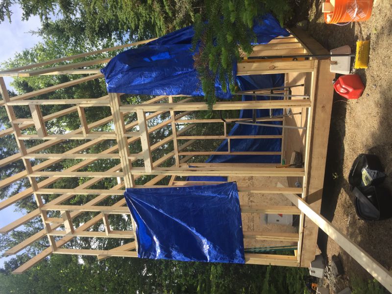

Finished off the roof rafters today and added in some more bracing between wall studs for more support. I’m having a little to much wiggle in the building side to side I’m hoping It will go away once the sheeting is put on. If anyone has any suggestions on improving stability I’d love to hear them. Also got my first glimpse of the view from the sleeping loft and I’m looking forward to that view first thing in the morning![6560D9628FFF4BA4B.jpeg 6560D9628FFF4BA4B.jpeg](https://www.small-cabin.com/forum/shared_files/uploaded/8853/126300_1.jpg) 6560D9628FFF4BA4B.jpeg
| ![9CADA772D4C94A14A.jpeg 9CADA772D4C94A14A.jpeg](https://www.small-cabin.com/forum/shared_files/uploaded/8853/126300_2.jpg) 9CADA772D4C94A14A.jpeg
| ![86374ADC886D4151B.jpeg 86374ADC886D4151B.jpeg](https://www.small-cabin.com/forum/shared_files/uploaded/8853/126300_3.jpg) 86374ADC886D4151B.jpeg
# Posted: 15 Jun 2019 19:50
I would put 1 sheet of siding on each side as soon as you can .
Rory
# Posted: 15 Jun 2019 21:09
You think that will be enough to stabilize It? T only wobbles when I give It a good shake but it’s still more than I’d like

Whiskey Jack
# Posted: 15 Jun 2019 22:21
I was pretty concerned with our bunkie as well. One sheet of siding stopped the wobble completely.

# Posted: 16 Jun 2019 08:43
When I build them I put the siding on before I raise the walls. But if you are alone they are heavy.
Rory
# Posted: 16 Jun 2019 15:47
Okay great job that makes me feel better haha. I would have preferred to sheet It first but I was alone unfortunately and It would have been difficult. But I’ll grt out there soon and get some sheeting on It should be fine until then. We’ve had a lot of water here to this year the river is definitely higher then I’ve seen It. I should be safe from the water though It still has a ways to go before It gets up that high

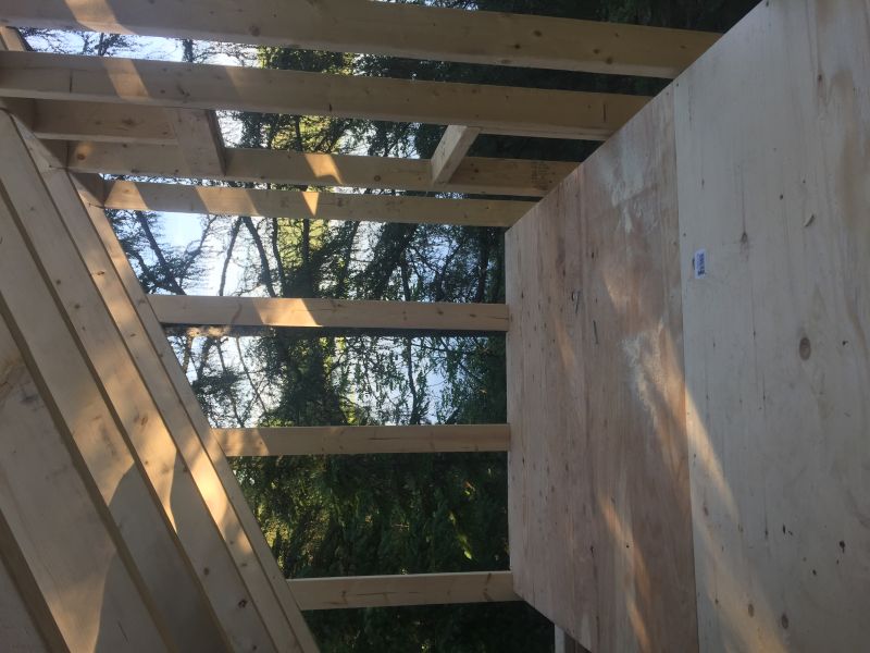

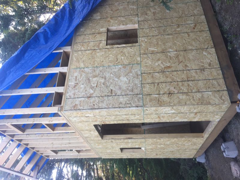

# Posted: 29 Jun 2019 22:19

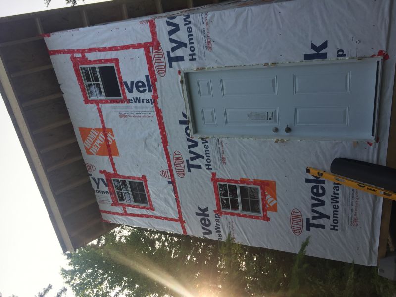

Finally made It out again and made some progress. The sleeping loft is built it’s a little small but It will do just fine. Got some sheeting on the walls and the structures feeling a lot more solid.![F11B7A201A334EFB8.jpeg F11B7A201A334EFB8.jpeg](https://www.small-cabin.com/forum/shared_files/uploaded/8853/126831_2.jpg) F11B7A201A334EFB8.jpeg
| ![FE367CBC28A74232A.jpeg FE367CBC28A74232A.jpeg](https://www.small-cabin.com/forum/shared_files/uploaded/8853/126831_3.jpg) FE367CBC28A74232A.jpeg

Ya I’ve never done a metal roof but as long as i can splice It along the middle i should be able to get It out there. It’s 16 ft long roof so that’s a bit to big for my little boat haha. Got out there today and mad some more progress though. All sealed up and ready for some roofing now.
