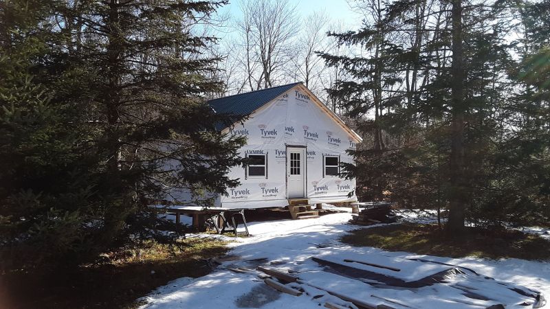

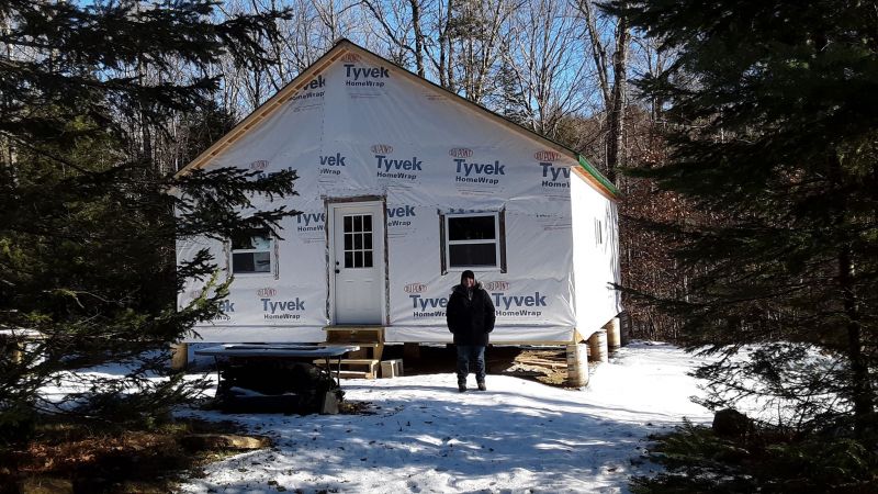

Okay... Thanks for all the information. So this weekend went pretty good. Walls went up and all the trusses! It is really looking like a cabin now. It was all squared and braced and level/plumb. Now I think my next step will be to put on the sheathing. Walls first then the roof. After that I will shingle the roof and wrap the cabin. Those will be the next steps for the upcoming weeks. QUESTION... I have a friend that said, "I should not of used 2x4 trusses." The Cabin is 24x24 and the trusses where designed and made by a company contracted through HD. It meets the snow load for my area. Should I have any concerns? The scissor trusses are 2' apart and it looks good to me. lol I will try to post a picture when I get home. I will be working on a video for my you tube channel.
Thanks again for all your help!

Nickels
# Posted: 5 Dec 2019 09:31pm - Edited by: Nickels
Well I did get the roof on!!! Did it right before the snow started to fly. It was challenging but I got it done. The cabin is ready for the Vermont winter. Thanks again for all the help! I am taking a break from the build because it has already snowed a lot and I can not gain access to the drive way. I need to get a plow. Also with the Holidays the weekends are busy! I did start working on the inside and built a ships ladder for the loft. Come take look at my 6 month build on youtube/facebook and how fast it came together. I can't believe I have a standing 24 x 24 cabin in six months with just building on weekends.
