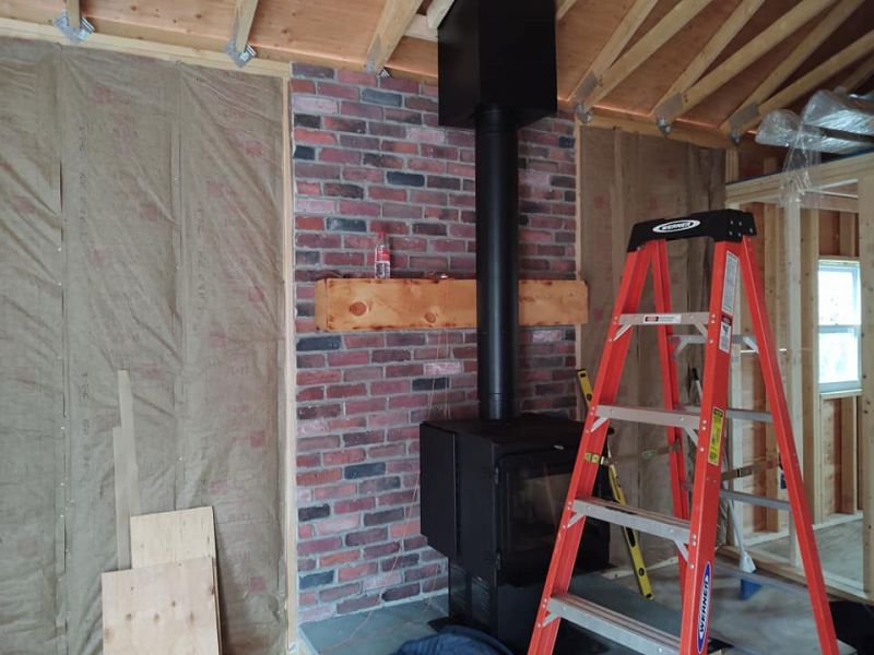

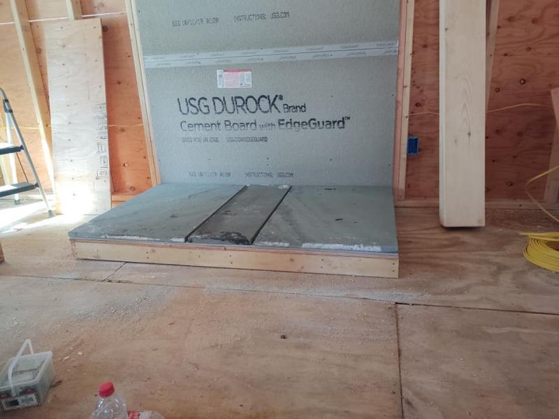

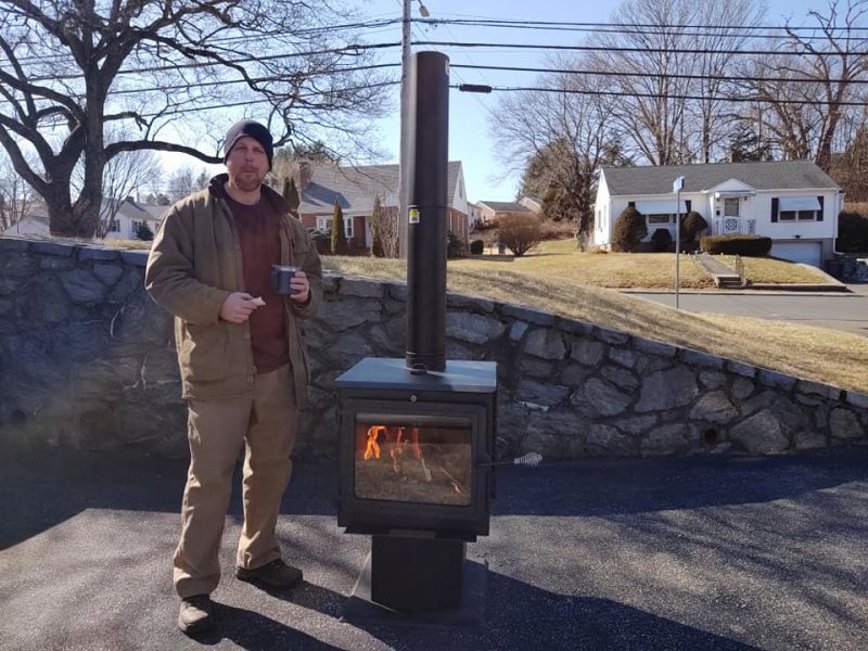

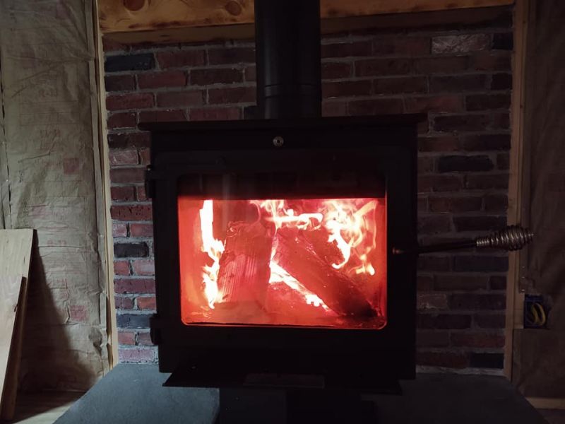

 Started the build back up for this year. I got the wood burning stove in and started the electrical. I have to make the hearth a little larger. I thought the snow was done, I thought wrong. ...sigh...
