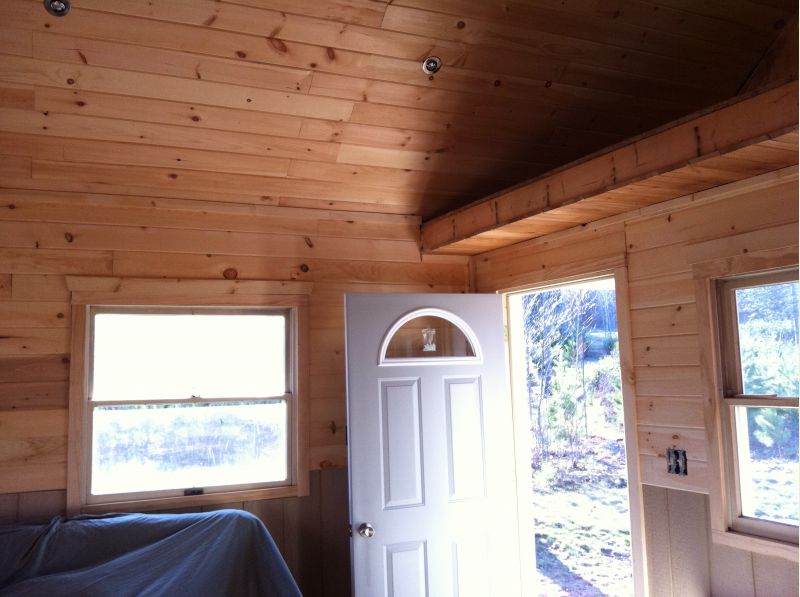

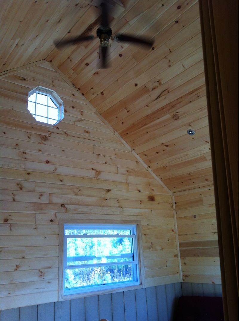

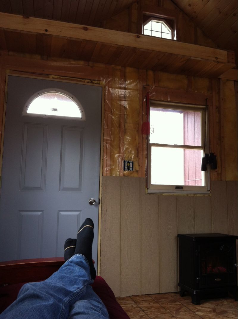

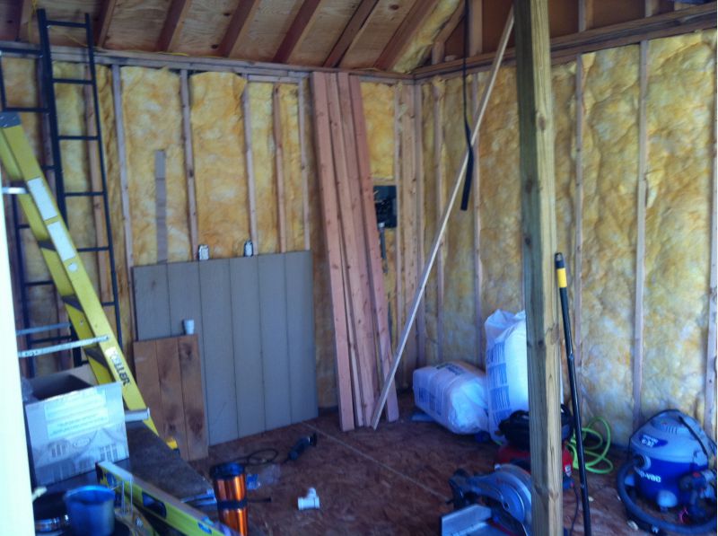

Electrical: Ran 4 #6 insulated wires from my existing electrical post through buried 1" conduit to a sub-panel in the cabin. Used a 50a breaker in the main and ran another ground post from the sub-panel. Did a couple outlets per wall, outdoor light, 4 halogen ceiling lights on dimmers, couple gfci on the "kitchen" wall and above the future bathroom sink. Theres a outlet for a ceiling fan that I'll be putting in soon.
Insulation: Kept it simple and used r-11 un faced for the entire job. This allowed me some room in the 2x6 cavities of the rafters for air flow. I used 4mil plastic sheeting (not finished with that everywhere yet) on the walls I was done working in. This cabin will be used generally up until Nov 25th and then locked up so I'm not worried that I didn't insulate it enough.
Plumbing: Tied into an existing septic with 3" dvw and ran 1-1/2" for the rest. The kitchen sink will have a AAV, the toilet and bathroom sink will vent out the roof (in the spring). Didn't hook up the water (getting too cold) but it wont take long as I'm using pex for the job.

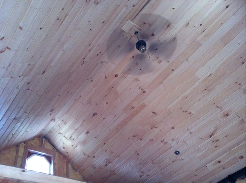

Ceiling: Menards had a great deal on 6" pine t&g .47 a lin foot. One half of the ceiling 50-8' sticks. Had a helper for once and they cut while I did the ladder work. Quick and satisfying job.
Hope you like it, more to come.

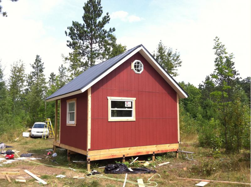

just used a t1-11 pre primed and then used a pittsburgh paint, duration, exterior. Two coats. Colonial Red.

I am up in the same area. Just a word to the wise, the porkys love to eat T-111. You may want to take steps toward guard against that. That is a beautiful place. Congrats.

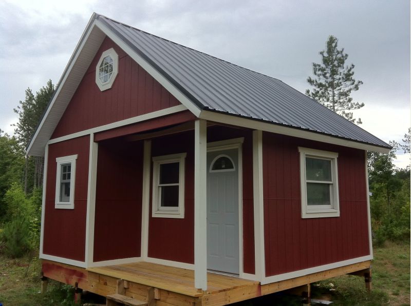

I am curious about the little blocks I see on the ridgepoll next to the roof rafters. Are those to keep the rafters from rotating?
kbvalley
# Posted: 27 Nov 2011 08:17am
Kind of. They serve multiple uses. Since I did it by myself I had a nailer in on hand and a rafter in the other while standing on a narrow catwalk. I measured out the spacing at the ridge and put in a block of 2x4 on one side of the future rafter. I did this on both sides. Next I laid the rafters against my catwalk and pulled them up to the ridge board and used the 2x4 as a location mark and nailed the rafter to that2x4 as well as to the ridge board. Holding the 16' board in the wind by yourself is difficult and being able to not think about it and just slap it in place and nail was a huge time saver and added another place to nail to. This method plus the steel strapping over the top each 2x6 at the peak ensured me that there will be no movement in the years to come.

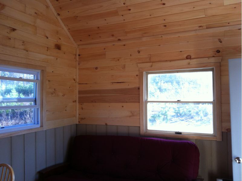

# Posted: 22 Apr 2012 12:21pm
I really love the wood on the interior! Great work!!!
