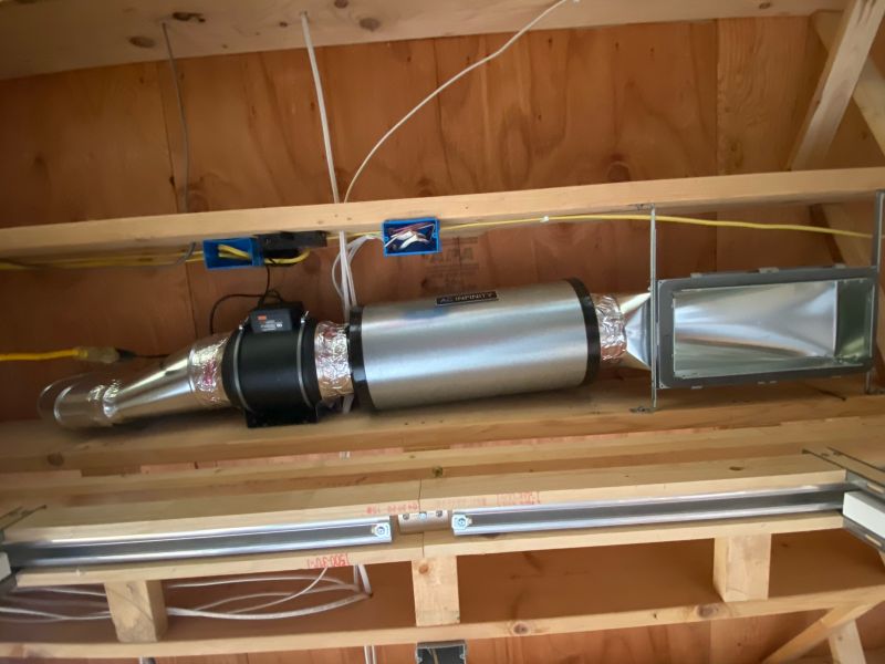

One other project that I completed this summer was an air circulation system. We plan to use a combination of a wood stove for primary heat and a direct vent counterflow propane furnace as a secondary heat source. I felt there was a need to be able to circulate the air between the main level and the upstairs. The solution that I implemented was to install a 6” inline duct fan capable of more than 400 cfm along with a duct silencer and in wall duct work linking vent registers on the main and second floor ceilings. The fan that I selected uses a DC motor and is very energy efficient, using about half of the watts of a similar size AC fan. It has a temperature probe so I can program it to automatically turn on when the air upstairs gets above a preset temperature. The fan motor also has 10 speeds and a remote control. On high the system moves A LOT of air. Speed settings below 6 are nearly silent. Preliminary trials suggest it’s going to make a significant difference with equalizing the temperature difference between the upstairs and downstairs. The complete system was about $325.

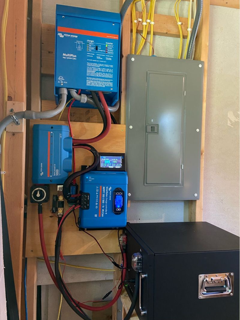

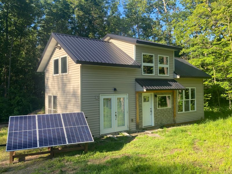

We now have a functional solar powered electrical system in our cabin. Currently we have 1065 Watts of solar on a temporary ground mount, a 3000W Victron inverter and single 280 amp 24 volt battery. A second identical battery has already been ordered. These batteries are from the same vendor and are very similar to the ones that Steve_S uses in his system.
We also purchased a small refrigerator with an inverter compressor. I was surprised at how efficient it is. When it’s running it consumes about 58 watts. Perhaps I should start another thread to talk about it.
We have plans to build a carport for our travel trailer sometime in the next year. Permitting delays with the county prevented the start of construction earlier this summer. I have now obtained the building permit, but my contractors are booked out. I’m still hoping I can get started on it before winter. I have designed asymmetrical roof trusses for the carport with the intention of maximizing South facing areas for solar panels. We may not ever need it, but it will have the ability to hold as many as 24 panels. Approximately 8500 watts. Our future plans include having a second inverter.
