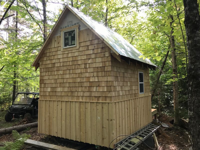

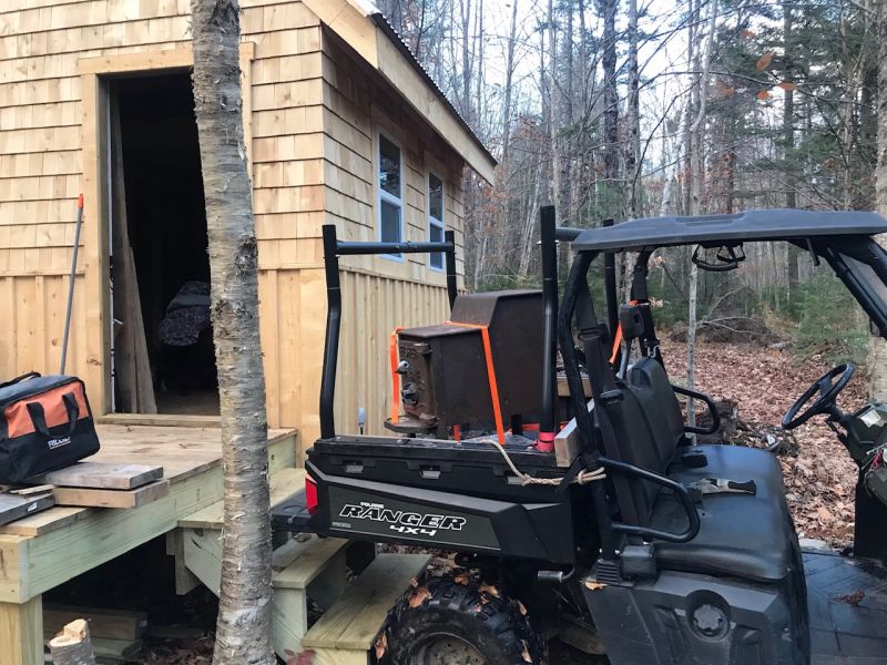

Shabin is looking great , I along with the others really like the combination siding. Is that a trimmed down ladder rack on your SxS ? I love the idea . I am in the very early stages of my build and will have similar access challenges making it necessary to bring all materials in by SxS.

# Posted: 24 Sep 2020 08:03am
Quoting: Ol Slim
It's a universal ladder rack (no cutting involved) and currently on sale from Northern Tool for $105!

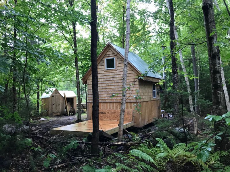

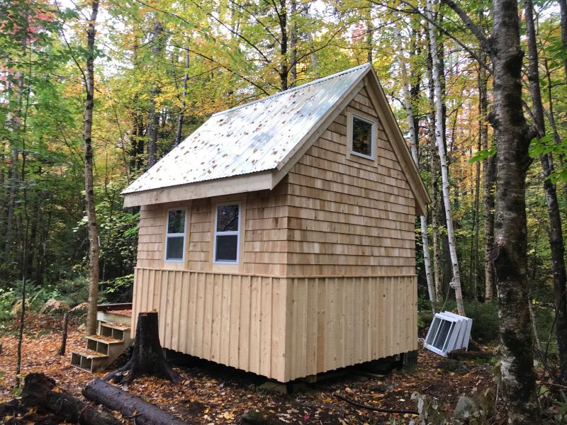

Another weekend trip on the anniversary of starting this dream as noted by my beautiful bride. Siding almost complete (So close!...). Going up again this weekend to finish. As many have said, it always takes longer than you think...
The beginning, September 2019
A year later - So close...
Added an awning window for the loft

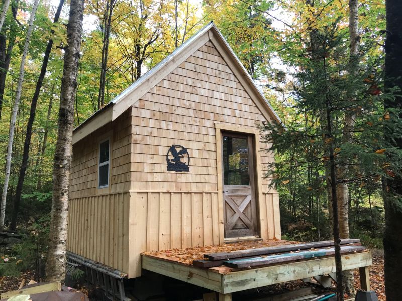

Made it up last weekend, exterior -- Done!

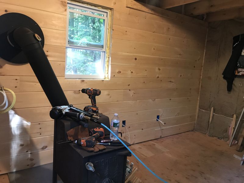

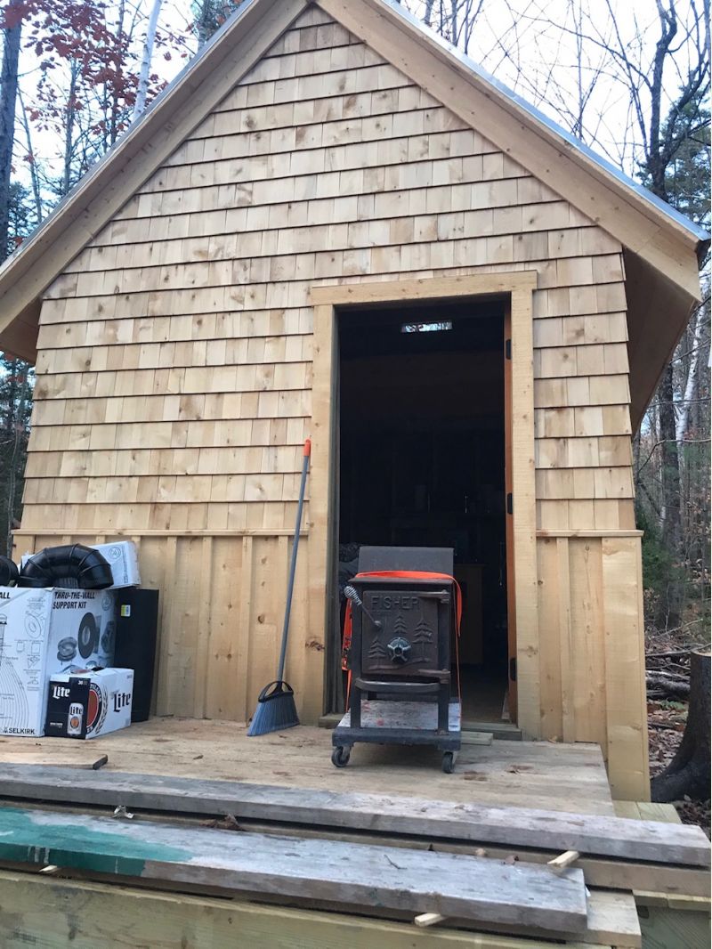

# Posted: 29 Oct 2020 11:28am

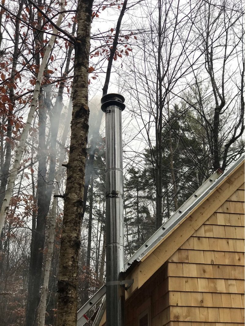

Another trip this past weekend 11/24-27. Insulated the floor, installed wood stove, through the wall kit, flue pipe etc (in the rain).
Moving in...
Moving in...
Made the hurdle!
Made the hurdle!
Success!
Success!
Rigid foam and plywood sandwich!

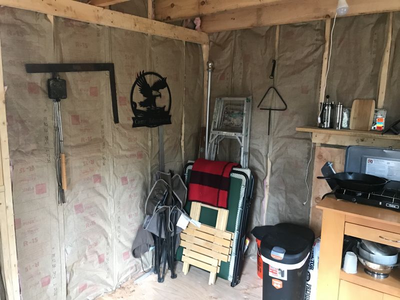

# Posted: 3 Jan 2021 03:43pm - Edited by: gwindhurst
Updates and relaxing weekend with the family...
*Edit on previous post 10/29: Incorrect dates of 11/24-27 should have been 10/24-27
Walls insulated 11-17-2020

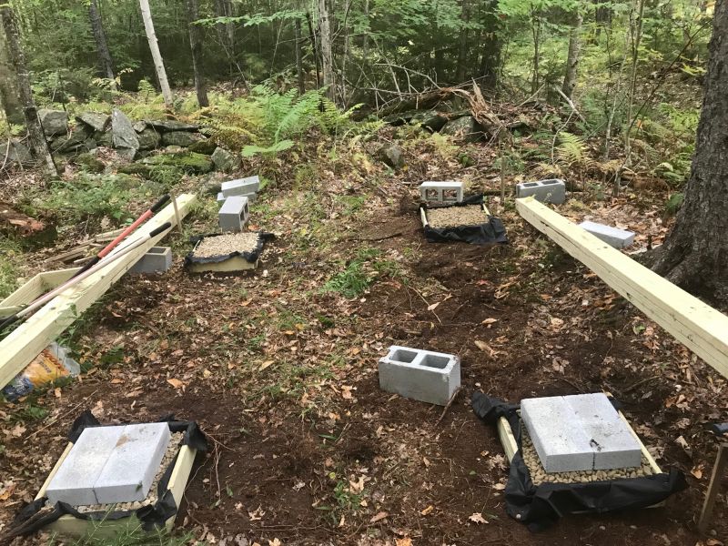

Is there a name for that style of footings/pads you used with the gravel box with blocks on top?

Not that I’m aware of. It’s just an addition to contain the crushed stone above grade without having to spread a stone base under the entire cabin. I removed organic material below grade, laid geo-textile fabric into hole, filled with crushed stone and compacted, placed alternating 4x4x16” blocks over that. No change in PLS (plumb, level, square) through first winter, we shall see this spring if I remain lucky...

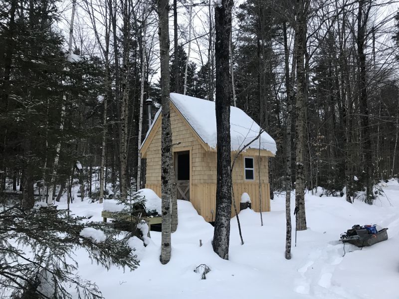

Power/Wood shed. More to come...

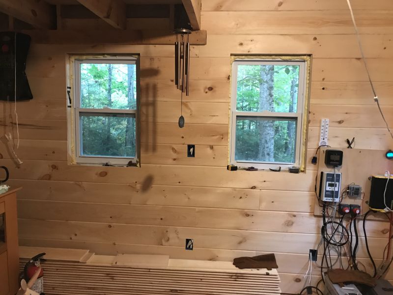

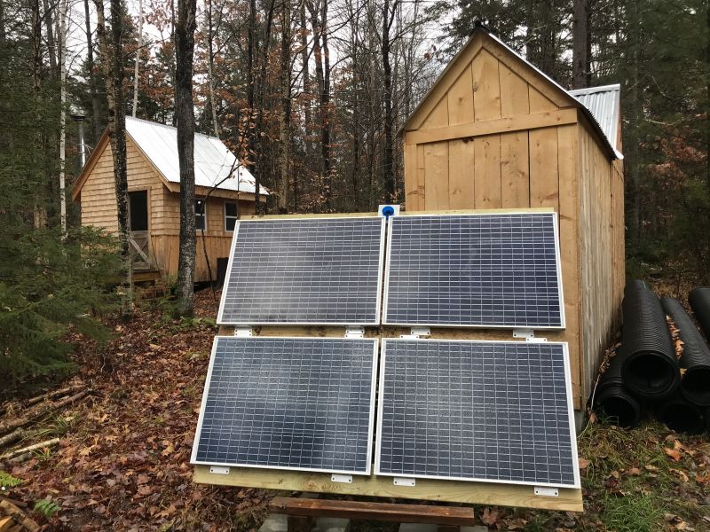

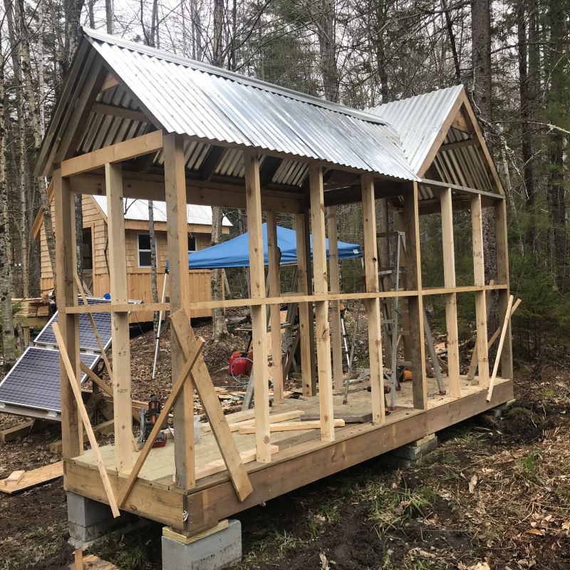

# Posted: 30 Sep 2021 05:56pm

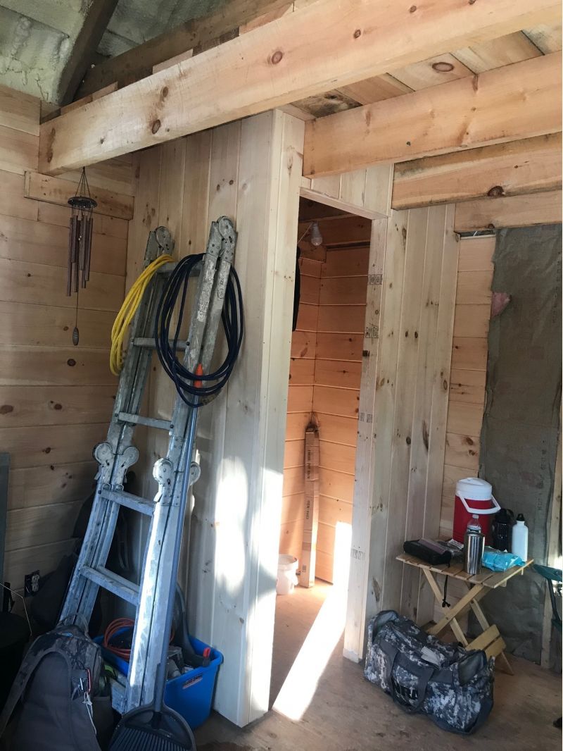

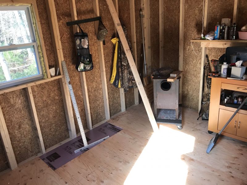

Completed power/wood shed back in early June. A few weekend trips this summer mostly play. Back at it this past weekend September 9/25-28 working on interior walls (almost completed)...
Power/Wood shed
Power/Wood shed
East wall (with temp solar)
South wall
South wall
West wall
West wall

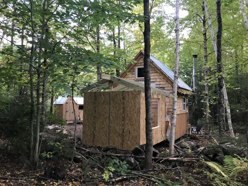

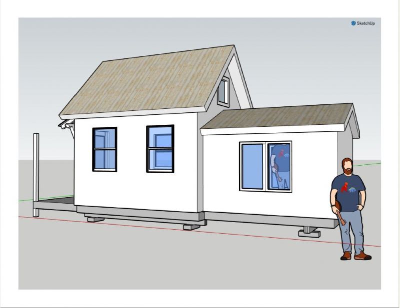

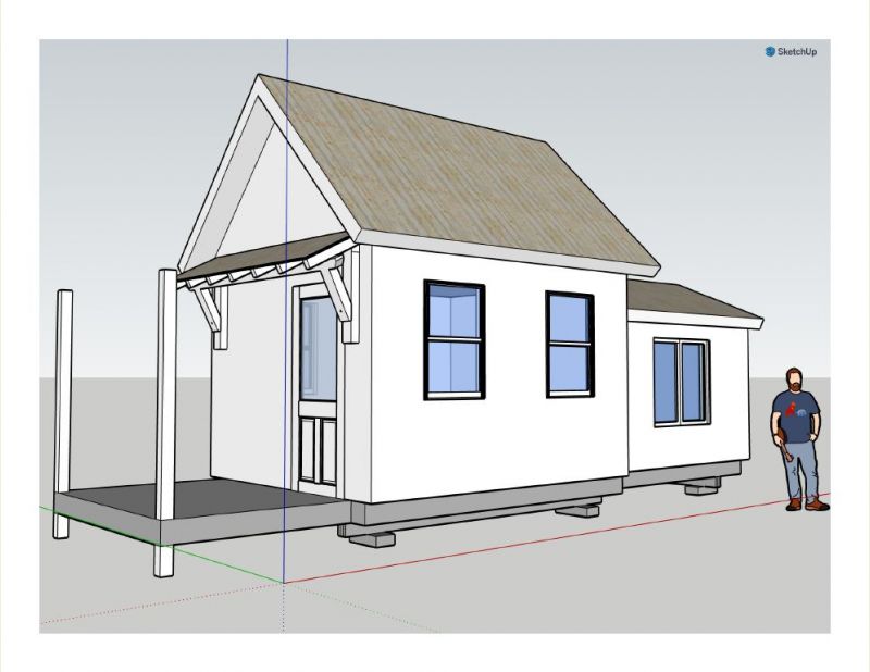

Thank you gcrank! It's been fun building and seeing how it continues to evolve as I go... Pics below of a small project completed, another just beginning and some renderings of where my thoughts are going... The unfinished exposed wall to the right of the composting closet will be the doorway into the new bedroom addition off the back of the cabin (in progress). And some Sketchup renderings I've been playing around with.

Rendering view 1
Rendering view 1
Rendering view 2
Rendering view 2

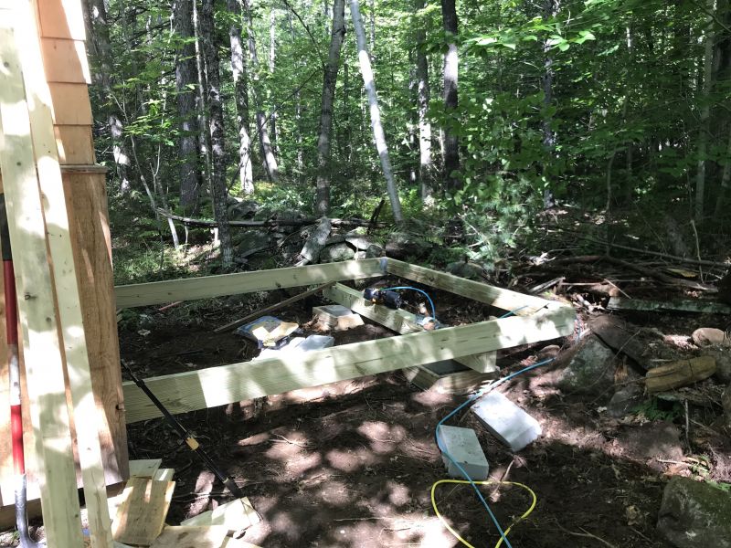

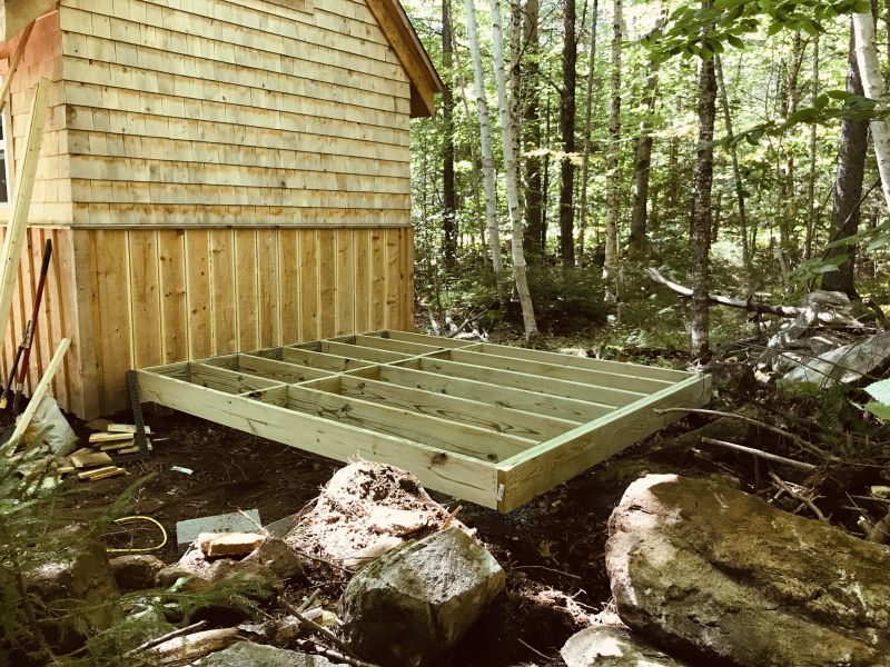

Overdue updates: September 10-13, 2022
Excavating, footings, floor joists and subfloor
Footings and rim joists
Floor joists
Floor joists
Dance floor...
Dance floor...

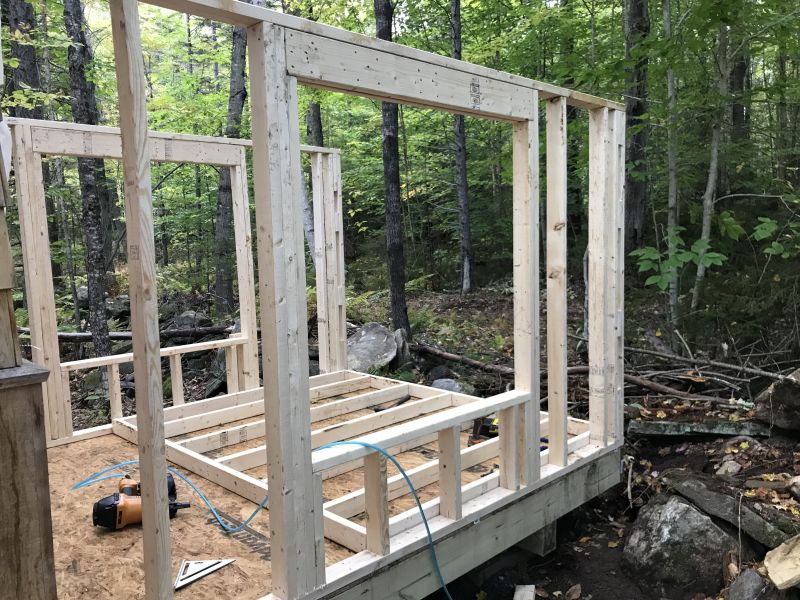

September 25-27: Walls up, sheathed and roof rafters
Walls going up
Walls going up
Sheathed and roof rafters
