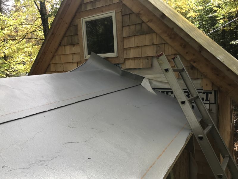

October 2-4: Shiplap ceiling, insulation and metal roofing
Shiplap ceiling
Shiplap ceiling
Roof insulation
Roof insulation
Ice and water barrier
Metal roofing
Metal roofing

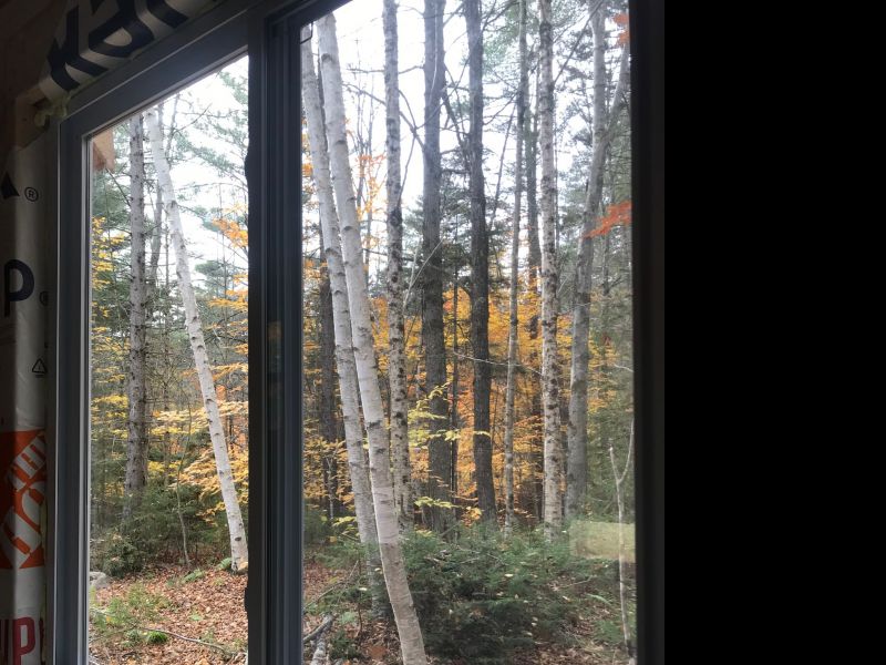

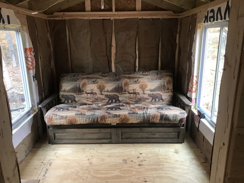

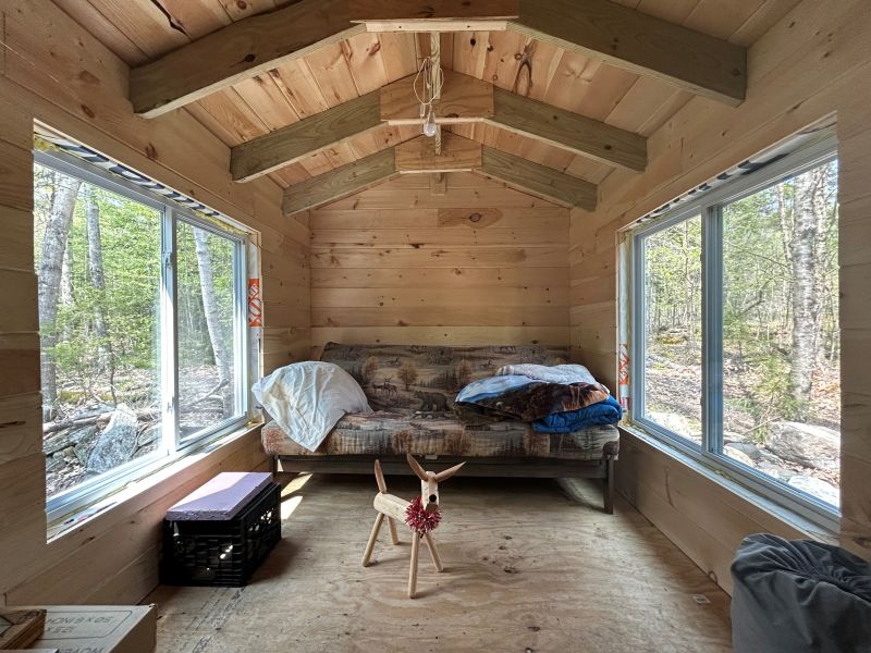

October 22-23: Windows, cut wall opening/connection, and assembled Futon. Also insulated the floor and walls however, in the interest of progress I did not get pictures.
4'x4' Windows
4'x4' Windows
Ahh- Autumn...
Ahh- Autumn...
Break on through...
Break on through...
Comfortable and functional!

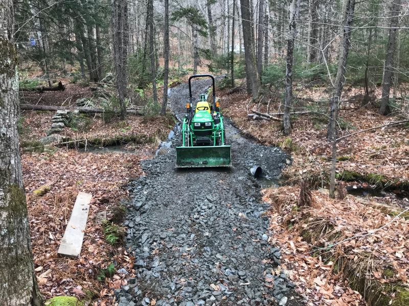

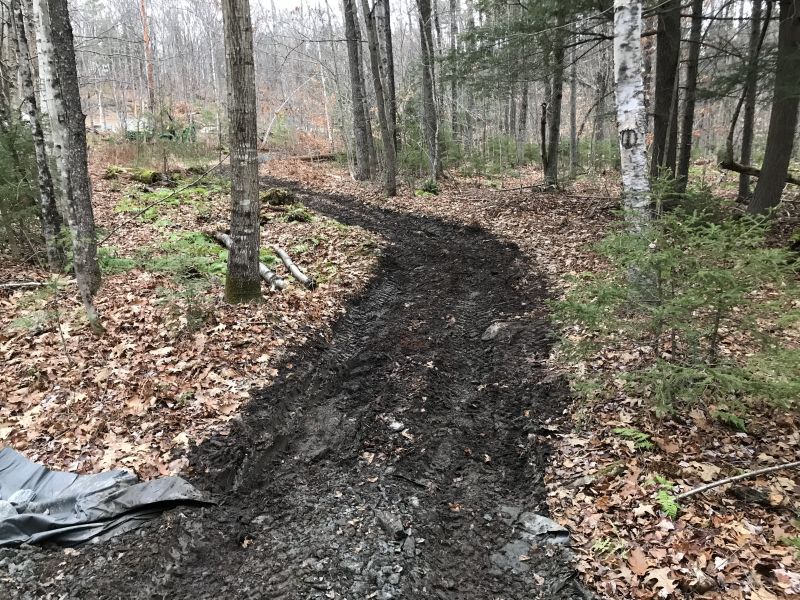

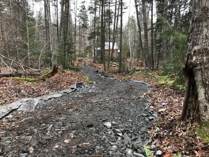

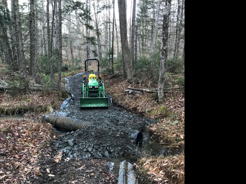

November 12-15: Roadwork, culvert
Roadwork begins
Roadwork begins
Ongoing
Ongoing

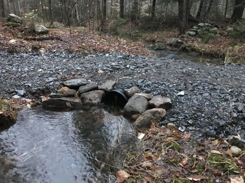

Culvert
Culvert
Getting there
Getting there

December 3-4: Stone work around culvert (will need more stone and 4 minus road-base), installed rolling loft ladder and snowshoe gate.

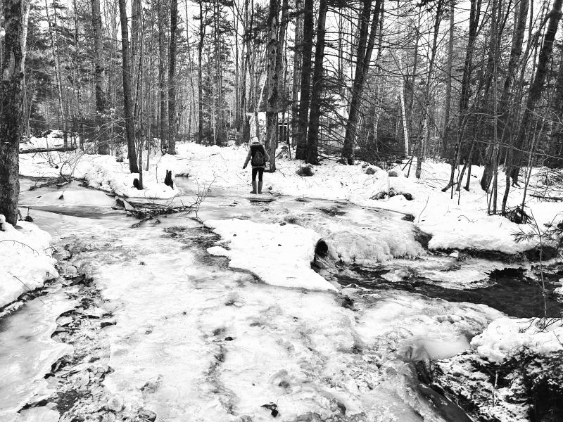

December 26-27: Merry Christmas! Not much snow, but a lot of ice! So I was worried that the culvert wasn't large enough but I got it for free. Nothing ventured, nothing gained. I'll have to replace it with a larger pipe later this summer during the dry season.

Culvert runneth over!
# Posted: 3 Feb 2023 03:03pm
Looking good. Before you add any more to your driveway I would add a second culvert. You dont want to come back one spring and find it all washed away.
gwindhurst
# Posted: 3 Feb 2023 03:28pm
Thanks Brett. If I may, your thoughts on adding a second or even a third culvert of the same diameter versus replacing the one existing (I think it's 15") with say a 24-30" diameter?
# Posted: 4 Feb 2023 07:53am
you can add any size you want. I wouldnt put in anything small though.
# Posted: 4 Feb 2023 11:00am
I'd probably do another culvert. Backup is always good. Is there another low spot near.
Eh, never know what free or reduced culverts are around.
Your cabin looks great man.
gwindhurst
# Posted: 5 Feb 2023 10:45am - Edited by: gwindhurst
Thanks Brett— Definitely nothing smaller. This spring that situation will only get worse with all the snow melt!
gwindhurst
# Posted: 5 Feb 2023 10:50am
Quoting: Aklogcabin
That’s another option as I do have more pipe however it’s smaller. I could add a 12” on both sides of the one in place. But my concern with that is clogging with sticks and leaves.
And thanks for the compliment on the cabin. It just continues to evolve…
# Posted: 6 Feb 2023 06:11am
Pipe flow isnt linear with the pipe diameter. You would have to look up the specifics but a 15in pipe will flow quite a bit more than a 12in.
jsahara24
# Posted: 6 Feb 2023 06:58am
Stormwater design is what I do for a living, so if you want some help determining the actual culvert size needed to pass the 100 year storm I can give you a rough idea pretty easily. I will need the lat/long for the culvert, or the drainage area size going to the culvert and I can make some assumptions.
And you always should prefer a larger diameter culvert in lieu of multiple smaller pipes, but smaller pipes will require more maintenance and can get the job done.
Definitely want to get 99% of the water going thru the pipes or the road will eventually disappear.

jsahara24, Thank you so much for that very valuable information. Wow! The 100 year flood event… although I was not in the area at the time of hurricane Irene, I do remember (as I live in the Northeast), the devastating impact it had on Vermont and the area where my camp is now.

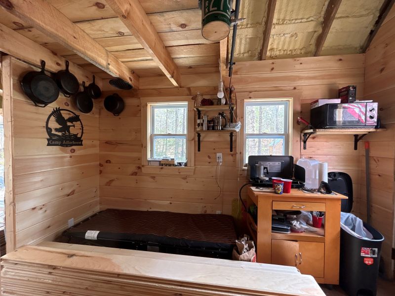

May 8-10: Still slowly coming together...
Kitchen wall
Kitchen wall
Bedroom/Sitting area

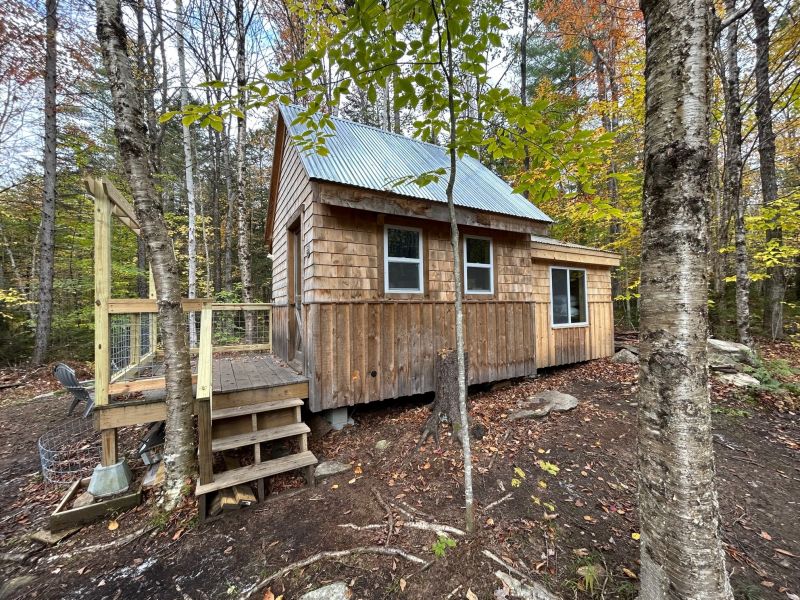

# Posted: 27 Oct 2023 12:53pm

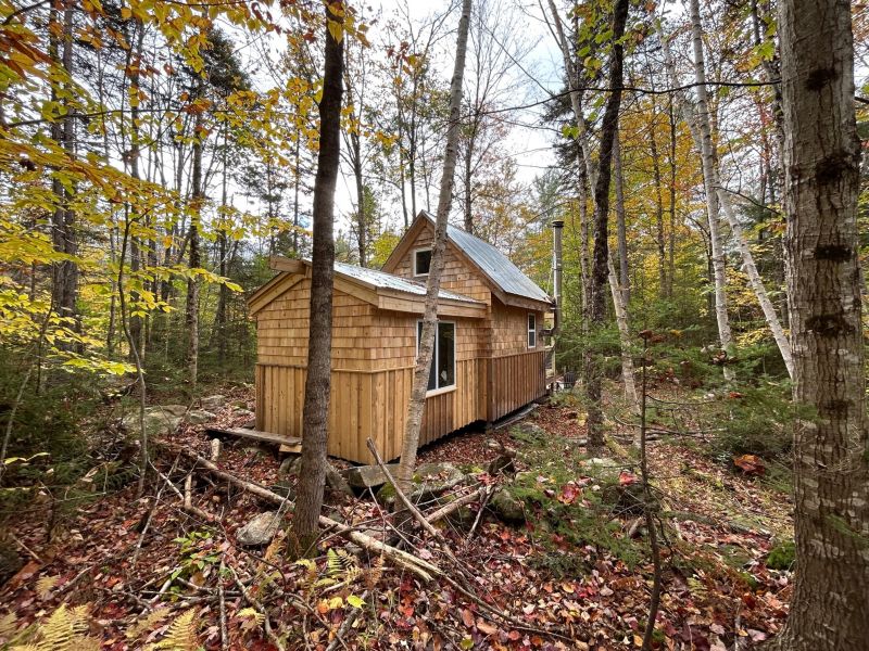

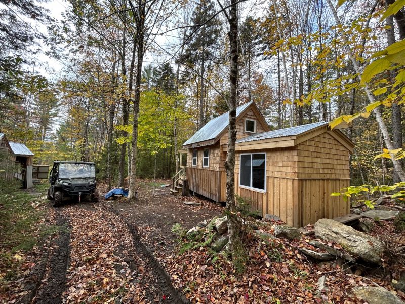

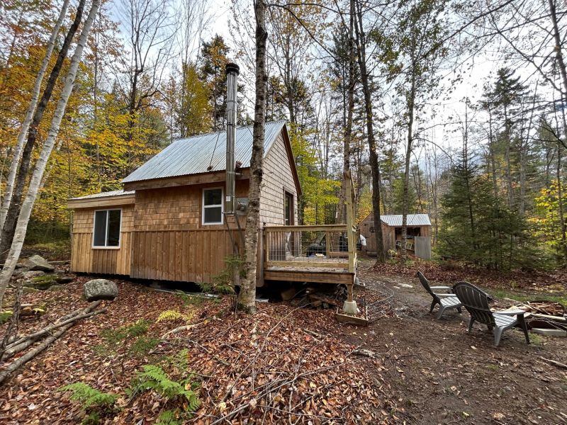

Over due update photos... Exterior complete!

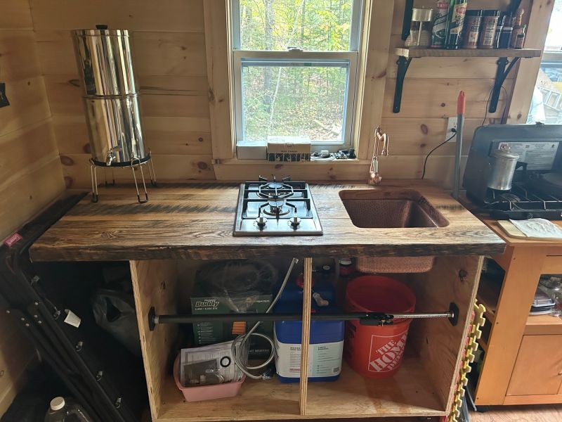

Kitchen countertop (pre-fab'd at home), with LP stove and hand hammered copper sink...

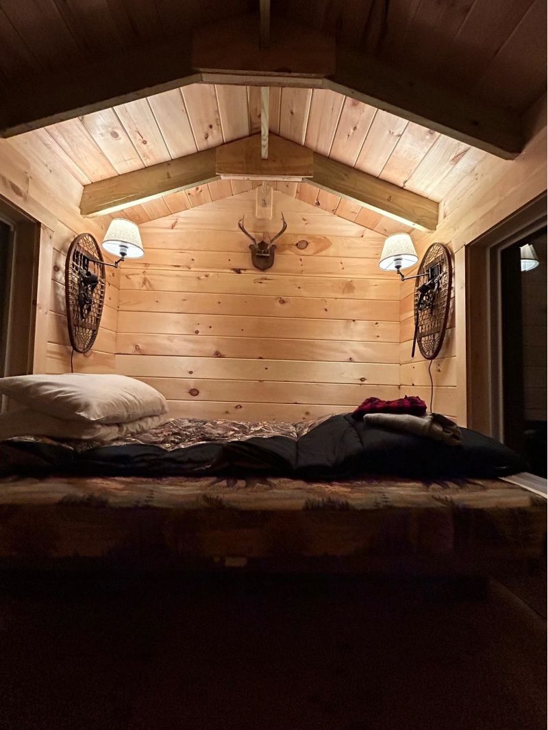

# Posted: 27 Oct 2023 12:56pm
Time for bed...

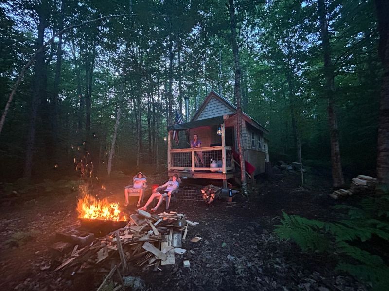

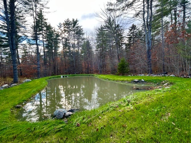

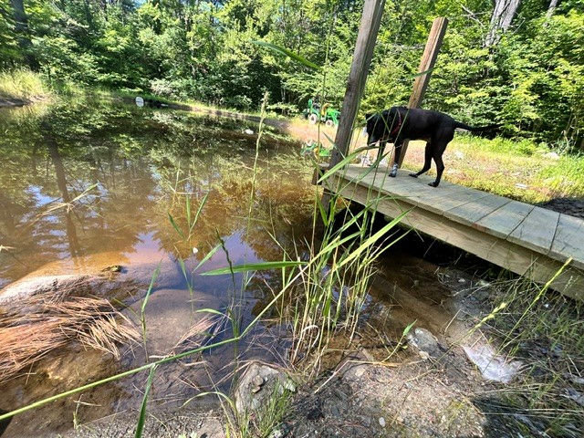

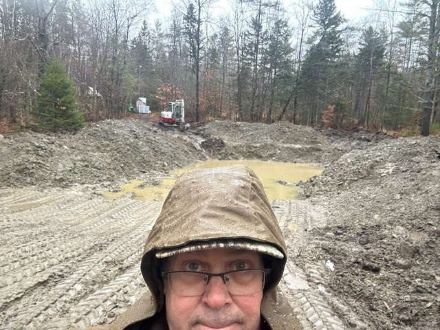

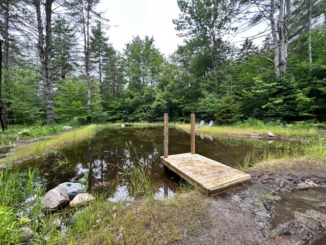

# Posted: 7 Aug 2026 01:01pm

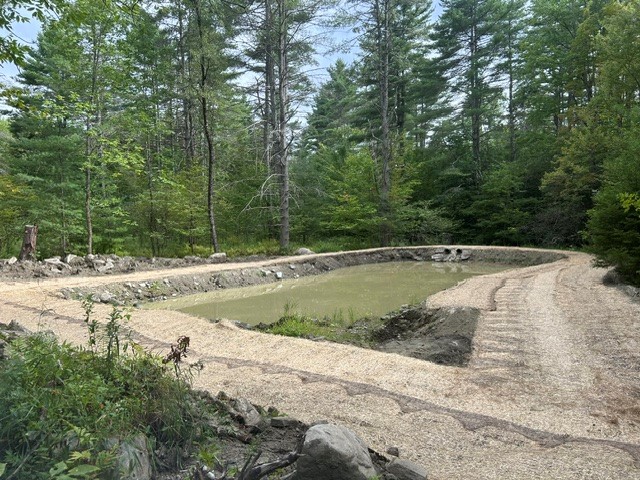

It's been a while. I started my pond project mid November '24. It's slowly been evolving with grading, seeding, re-grading, re-seeding, building a dock, resetting overflow pipes, emergency spillway... Next up-- I plan on building a sauna near the dock!
gwindhurst
# Posted: 7 Aug 2026 01:02pm
More pics...
