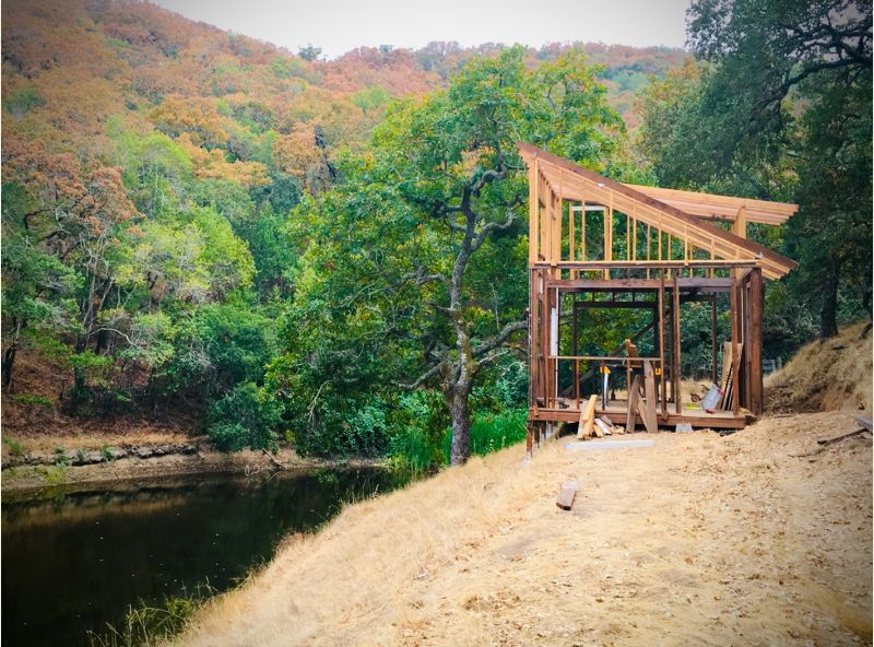

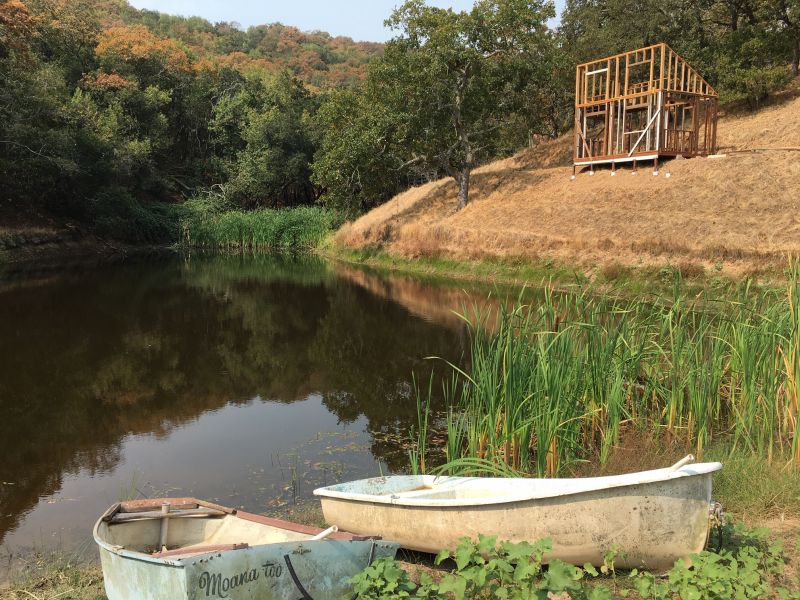

Hi everyone, just joined the forum to share my small cabin build. I am very fortunate to have 10 acres in the Bay Area in Marin County. Decided to build a cabin overlooking my small pond as a weekend (or more) place to stay. I've always camped on the land prior but think I can get my wife and kids to want to spend more time out there with the cabin.
I am trying to build as much as possible with salvaged materials and have done pretty well so far. With no real freezes and a mild climate, the build has been pretty straightforward. Here are some pictures of the progress so far. Love to hear feedback.

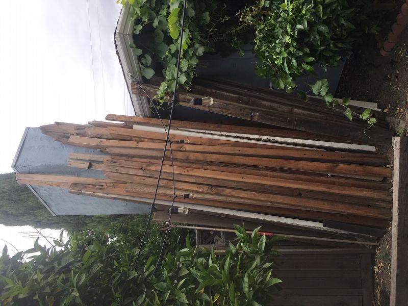

Lumber collection - everyone laughed at me

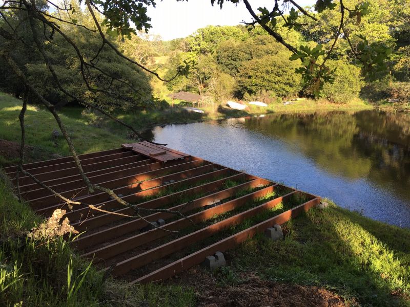

foundation
foundation

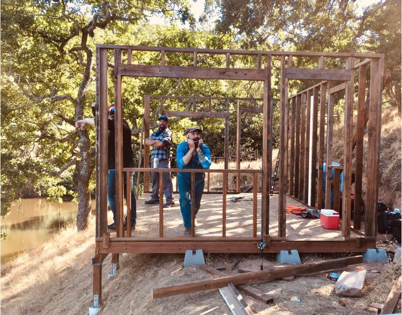

Pleasant framing day

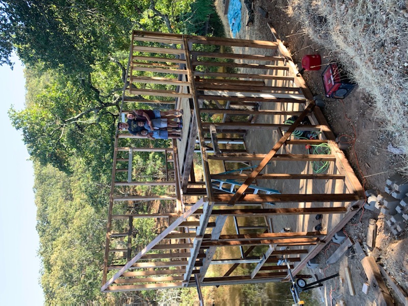

first time standing on the loft

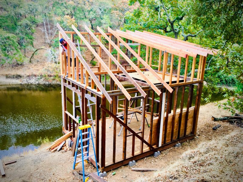

rafters up
rafters up

What size 12x16? How high from front to back 12ft to 8ft? working on something similar trying to get an idea of how it will look.
sambelletto
# Posted: 24 Aug 2020 11:32pm
Hi, yes it is 12x16. The back wall is 8 feet and the front is 14. I chose that so that I could put the loft at 8 feet and have enough room up there to at least stand up straight at the front wall (I'm only about 5'8" - in the morning). Turns out that since I think I will leave the rafters open, I'll get that additional 5.5inches which is nice. I put the 4 foot back wall on the loft to put in a little headroom for stairs. I chose stairs instead of a ladder because I will be putting a toilet in under the stairs.

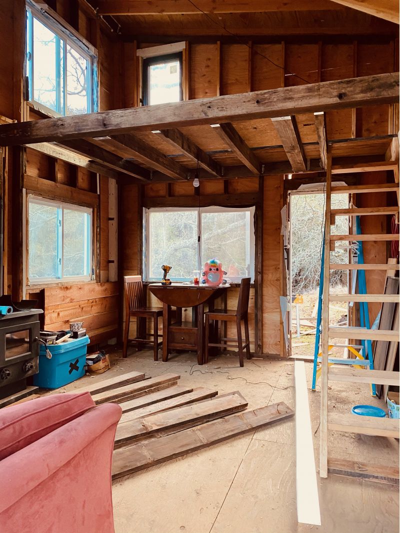

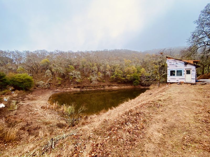

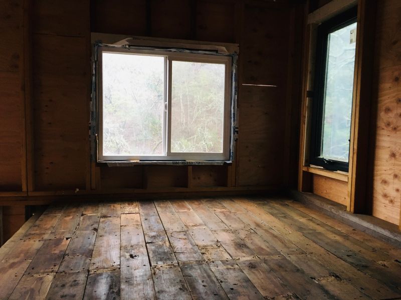

Thought I'd share a few update photos. Getting so close to finishing.
loft flooring - old redwood

Lookin Good

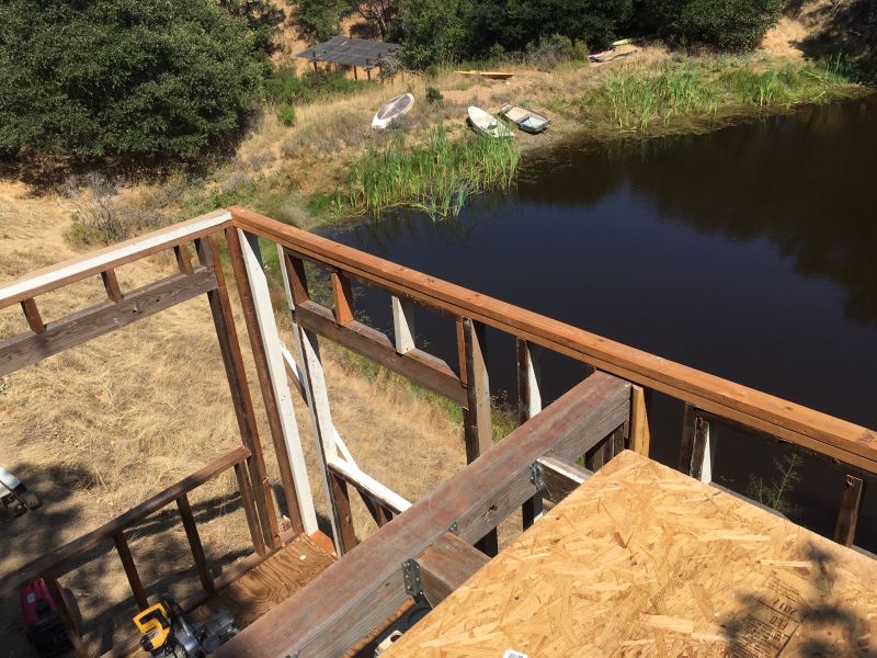

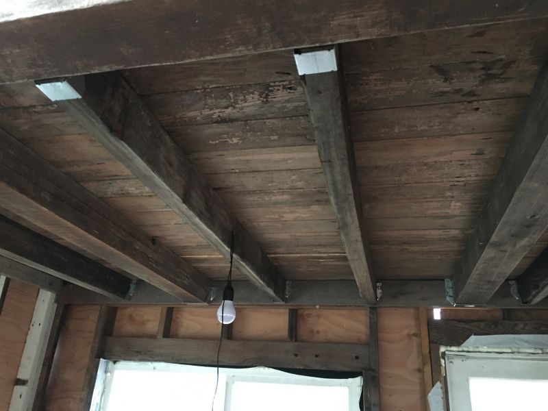

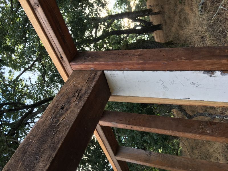

So your platform is hanging on joist hangers on the center beam...i see joist hangers on the exterior wall but how is the framing on that end? Is it just a ledger board hanging on the vertical wall studs? Or is that a beam sitting on top of the wall?

From pic standing in the loft. Looks like that beam is sitting on top of 4/5 2x4's?

Loft flooring looks amazing too !

Hi WILL1E, I put in a 2x6 ledger board across the wall and hung the joist hangers on that. I built in 4x6 supports for the crossbeam.

Thanks Ol Slim, the pond in the picture is VERY low. We've had almost no rain in this part of the state, one good drenching and it will refill. I can see fish from the loft!

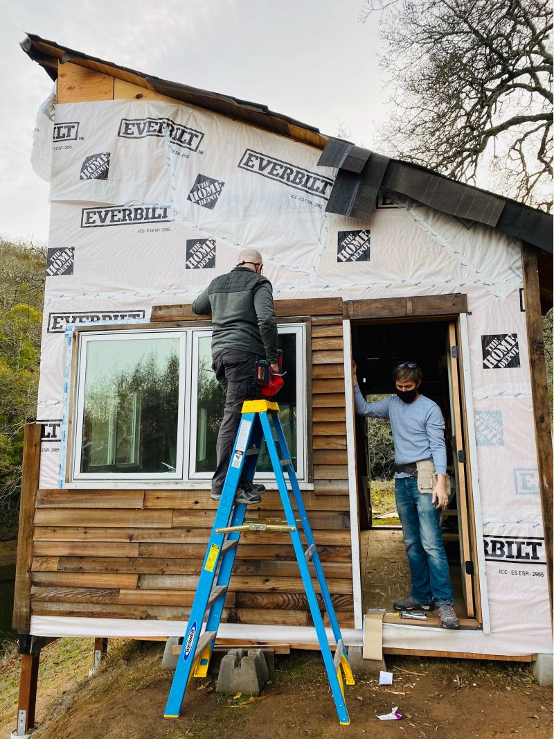

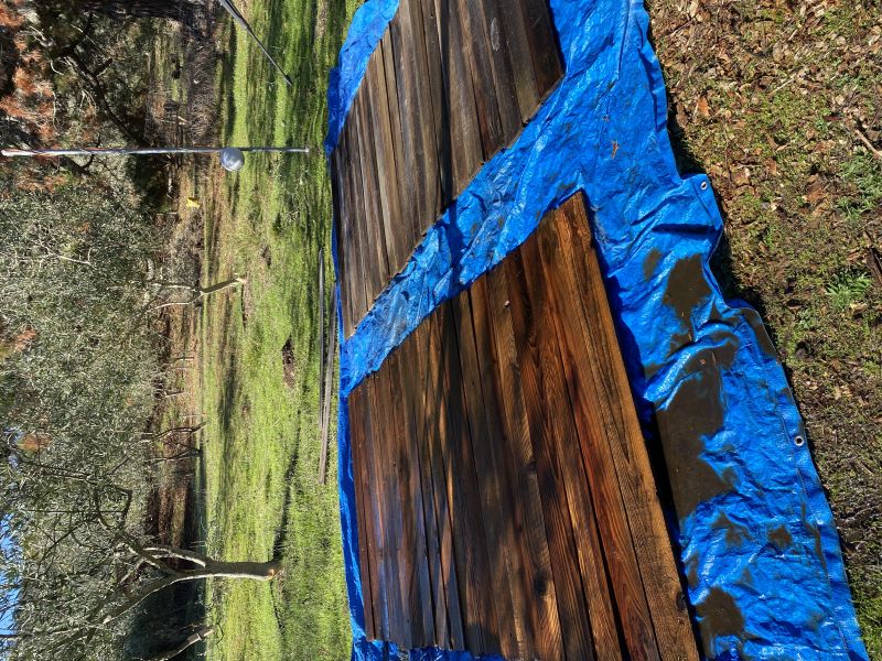

So I started putting up siding. I chose to do a clapboard style with old redwood fence boards I gathered by stopping anytime I saw someone putting in a new fence. We pressure washed them to get a cleaner look. Has anyone tried this before? I don't see much for or against online and it seems reasonable enough. Plus, I like the look.

Curious, if you are leaving the rafters open, how do you plan to insulate?

That said, I used/recycled old growth fir for my exterior siding. The biggest downsides of using used wood are: (1) nail holes and other gaps that water can enter through. Be sure to stuff extra stain in these holes to prevent water damage. I also have a drain wrap behind my boards for better drainage, and be extra sure to caulk around your windows. (2) potential for mold/critters. I treated my wood with borax. this kills off existing critters, and works as a preventative for a couple years. you could easily apply to the front of your boards before you stain. Warning, it darkens the wood a little.

I would advise that it's worth considering a drainable housewrap and/or rainscreen setup behind siding like this.

I may hold off on insulation to see how great the need is. Summer days rarely go over 90 with basically no humidity and my proximity to the Pacific brings cool nights all summer long. Winters are typically 50s daytime to upper 30s at night. I'm hoping the wood stove will be enough. That said, I will insulate if my family is not comfortable.

Thanks Nate, I have to plead ignorance here, is that something different than that housewrap I put on?

You can definitely wait on insulation, though I'd be more concerned about summer than winter based on your set-up. Perhaps you already know this, but when you do go to install, the ceiling insulation will be the most important, followed by wall, followed by flooring (or so they say). Waiting on insulation means you can probably find some for cheap too, folks often have a leftover bag after a build. Heads up that if you have ceiling insulation, you generally want to drill ventilation holes at the base of your rafters to ensure airflow through your rafters to keep mold out of your insulation.
