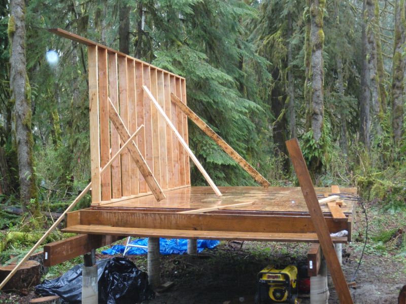

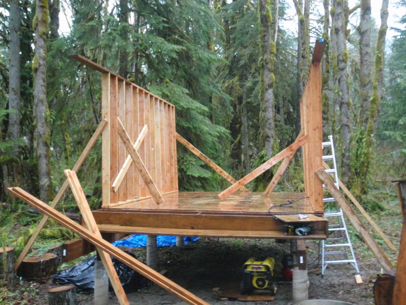

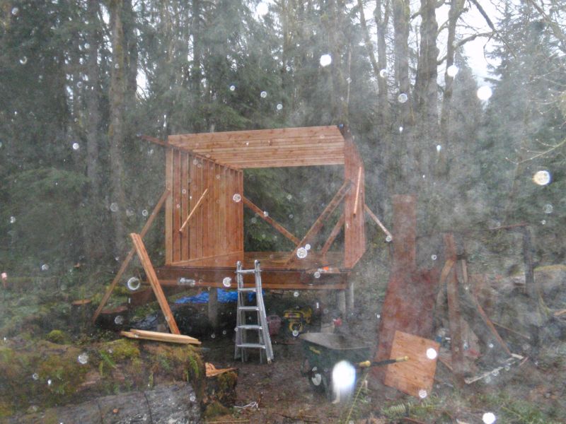

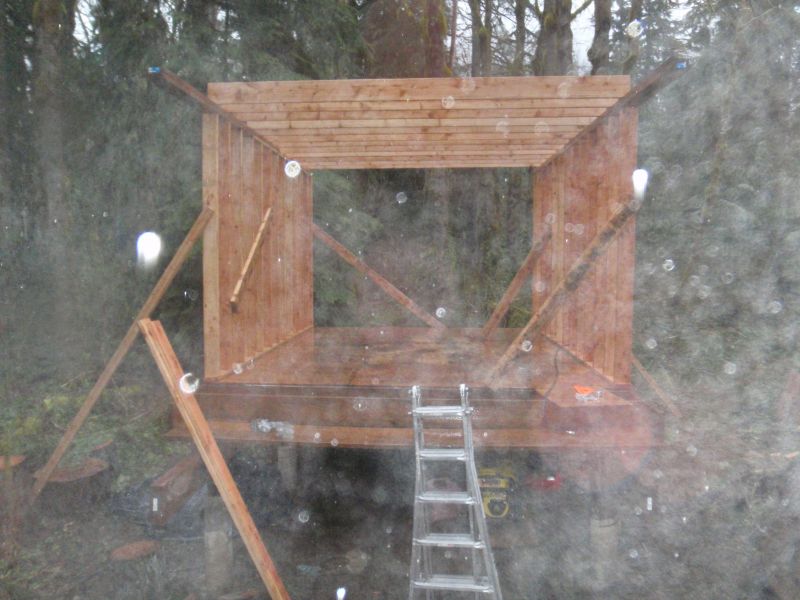

 Walls!
 Worked a halfday on a nearby bathroom project Sunday before some family events, so I was able to sneak to my cabin Monday.  One of the most miserable working days I've had in awhile.  It rained all day, and hard.  Soaked through to my shorts, changed all my clothes during lunch...
 But I got walls!!!  I'll make a more detailed post tonight if I can.
 Tilting those 8 ft tall, 16 ft long, 2x6 walls up all by my lonesome was quite a feat if I do say so myself.  Also, this is the first time I've headed to the site and got everything done on my list for that day that I wanted to knock off.  I drove home very satisfied and got myself a DQ blizzard - oreo.  Did you know for $.50 extra they do double stuff and give you twice the topping?!?  A great discovery!
 Btw the top plate overhang is going to be supported by posts and will be the covered portion of my deck.
 Also, now that I look at the pictures I think maybe I could have put some windows into those pony walls.  But I'm going to have an extremely long overhang with a steep roof, so most of that will be covered. Oh well.
 Jeremy

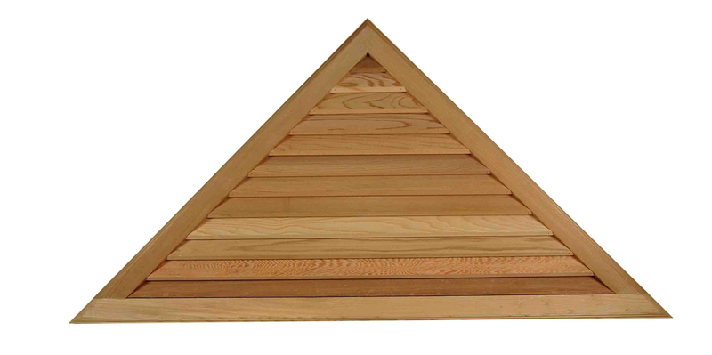

 "I would not want to have a ridge vent and also do not need soffit vents. Is that correct?"
 Well, since your camp is in rain country, and probably will experience some pretty extreme fluctuating temps thru the seasons, it sure wouldn't hurt to put a vent in each peak, and I'd put some in the soffits too.
 Since it's for 'occasional use', all the more reason, give it a chance to breathe in and out.
 I'd do something aesthetically pleasing for the gable, as pictured.
 But with your custom pitch, might need to alter the angles, or make them yourself.
 Got good saws?
 Just my opine
 GO'

 I like the look of that triangle gable vent but I don't think that will work for me.
 I will have windows that I can open and close but its not like I have an unheated traditional attic.  That space is my sleeping loft.  With a gable vent as you pictured I wouldn't be able to close out the cold air.
 My thinking is, with a sleeping loft you have no normal attic where you would insulate above the top floor ceiling and leave the roof uninsulated.  In my cabin, the roof will have to be insulated.  I have 2x6 rafters, so I plan on filling with insulation for 2x4s and leaving an air channel.  Would I want a ridge vent or just open the windows as needed?
 Also, in traditional homes the soffit vents are to allow air into the unheated attic.  That is the supply air.  And then the warmer air vents out the ridge vent.  In my case, with 5' long rafter tail overhangs, I don't think I will enclose my soffits.
 It seems weird to have no soffit vents or bird blocks or anything but this would let cold air right into my heated space.   I think I'm confusing myself.  Any clarification?  Thanks

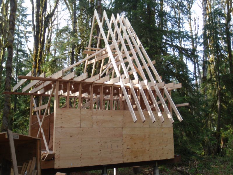

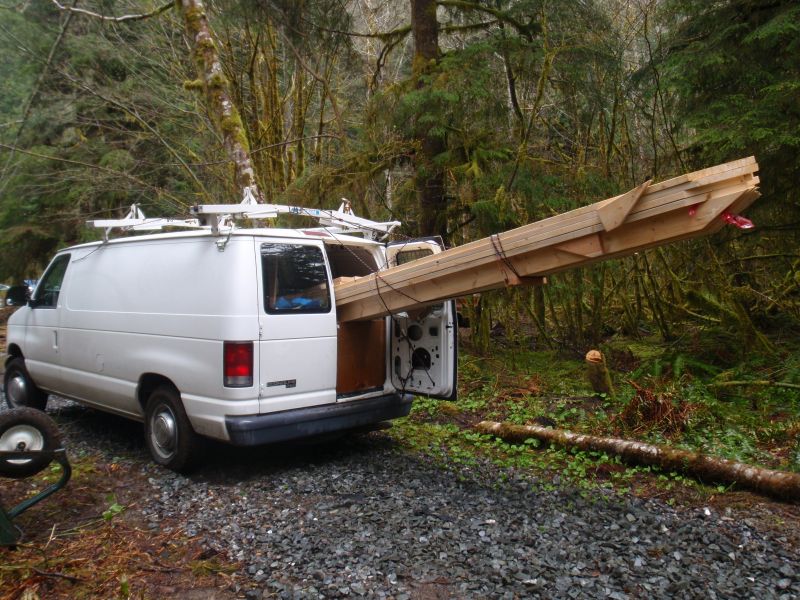

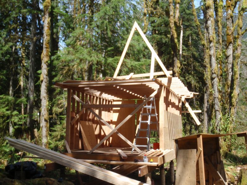

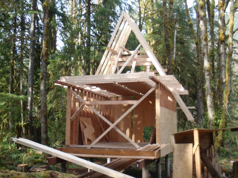

 I snuck away for my first overnight of the year.
 Loaded up the van with lumber.  The guys at the lumber yard thought I was crazy, see the picture.  They measured and said I had about 12" to spare legally.  I precut the ridge/plumb cut for my rafters at home and headed out.
 First day I did stuff you can't really see in the pictures.  Fasteners, hurricane ties, through bolts I skipped earlier, and some wall sheathing.  I'll finish the wall sheathing once the rafters are in their final position.  I wanted to leave a wide piece of sheathing for the top so my top plate is tied into everything well.
 I packed up my tools as it got dark in case it rained overnight.  I made a big fire cooked some cans of soup and had a few brews, enjoying the quiet.  I really enjoy it up there.
 I swept the cabin floor, setup my tent and climbed into my sleeping bag.  It was a little cold when I woke up in the morning and it had rained a little overnight but the plywood loft deck above my head kept my tent dry.

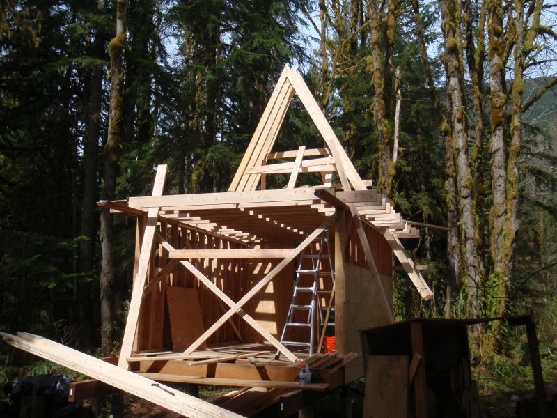

 Day two I started loading my compressor and nail gun and tools and 20 ft 2x6s onto the loft deck.  Quite the chore.  I lined up two rafters, did some measurements to make sure the triangles were right, shot in my gusset plate and a temporay crossbeam and started tilting up my A-frame trusses.  This task wasn't as difficult physically as tilting up my 2x6 walls was, but more mentally challenging.  Make sure the momentum doesn't knock the truss off my wall, with me holding on...
 I ended up getting 6 trusses up before starting to run out of space on the loft deck.  I finally can see what the final shape of the cabin will be and I'm really excited.
 Bad news was I really came to a standstill as I can't do much more work without a helper.  The first trusses are tacked in place temporarily but I just need another set of hands so I can make measurements and get those trusses lined up straight before permanently setting them and thrubolting the rafters to my loft joists.  As you can see in the pic, the trusses aren't perfectly lined up.  The neighbor said he could help me next weekend but I have a office painting job going on over the weekend.  My buddy said he could help, but he would want me to throw him some cash, and this is a low budget project.  I'll figure something out.  This really will be the last time I'll need a helper as I think I can do all the roofing myself and I'm not going to do much interior work this year.

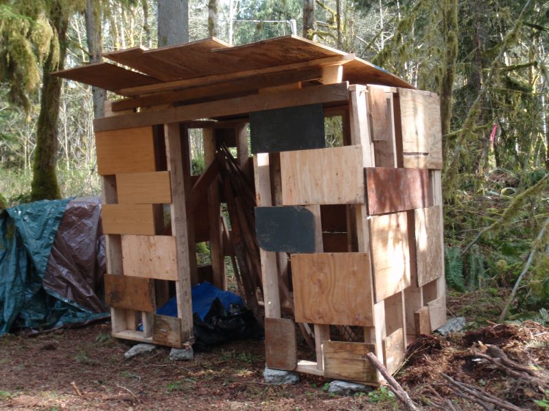

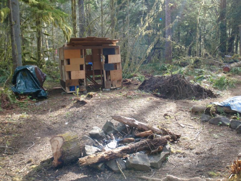

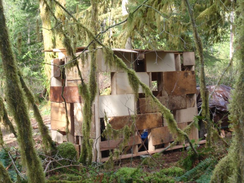

 I had some spare time so I decided to sheath/side my wood shed with all the scrap pieces of plywood/osb/shelving I collected over the winter.  I tried to do something different and fun, maybe a little artsy.  You need good airflow through you're firewood right?
 I'll have to remove the roof during the winter as it will for sure collapse in.  The rest of the structure is actually fairly sturdy though despite the limited shear improvement from my siding.  I won't get around to chopping all the rounds into firewood for awhile so it'll just be my random storage until then.

 What bolt pattern did you decide on?
| Jeremy165 Member
 | # Posted: 8 May 2011 09:52pm Reply
 I haven't bolted them yet.  Its just temporarily tacked in place until I get everything lined up perfectly, all plumb, vertical, spaced correctly... I'll need a helping hand to do that.  I was thinking, I can work on the deck in the mean time though.
 I'm going to bolt similar to what you drew out.  Seems like a good plan.  I'm thinking 3x  3/4" bolts.

 Maybe I'm missing out on some important details, but I am having trouble with the thought that you will "have to remove the roof during the winter as it will for sure collapse in."  It's not like it's anywhere near flat.
 12 ft wide means the rafter span is 6 feet. 2x6 Hem-Fir rafters on 24" centers can span up to 6'1" using 20 lb per sq ft dead load and 80 lb snow load. There are not many places with a snow load that high. Do you know yours?
 Using 16" centers the snow load can go to 120 lbs with the dead load still at 20 lbs.  Go to 12" and you can park a truck up there. Well, maybe.
 10 lbs dead load is what is normally used, but with the extra length of the steep rafters and the likelihood of boards or paneling on the interior side 20 lb is better used for the dead load value.
 And who wants to pull a roof off for each winter? And then what keeps the snow out of the interior?  Like I said, I must be missing something.

 Quoting: MtnDon And who wants to pull a roof off for each winterI was puzzled a bit too, at first, but if I may, I think Jeremy is referring to his (ahem) 'wood shed'.......

 Well there ya' go!!!  I knew I was missing something.
 So....  never mind!
| Jeremy165 Member
 | # Posted: 9 May 2011 10:09pm Reply
 I guess I wasn't very clear.  The cabin roof will stay once its on there.  For the woodshed I'll either tear the roof off or build something a little more solid than plywood with no rafters.

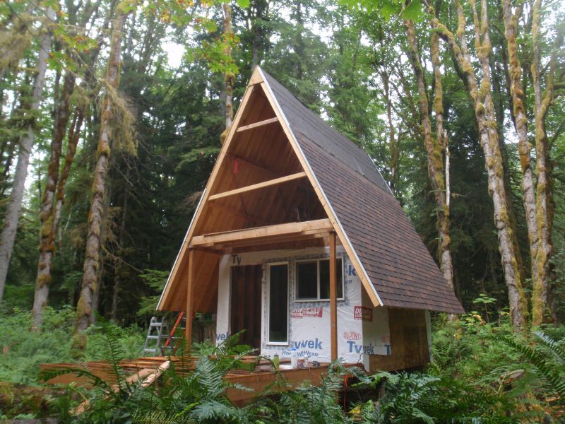

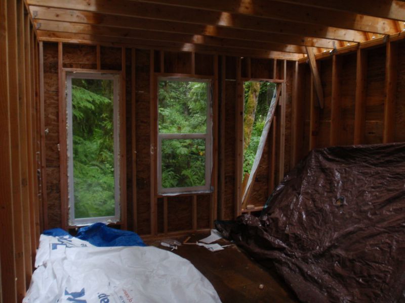

 Well its been a busy summer.  Business has been moving and I've landed several big commercial TI jobs.  On the personal side, I went to Europe with my girlfriend and she's now my fiance, as I proposed to her.  Yay! Lots of fun.
 I have been out to the A-frame a few times and its coming along well.  I think one more overnight (to finish sheathing the front, housewrap it all, install some windows, cutoff the ends of my loft joists) and then I'll be starting the roof - sheathing, paper, arch shingles...
 I love it out there, but man with the 4 hour roundtrip drive and the unloading materials... just can't get enough done in one day.  At least its a nice place to work!
 Jeremy

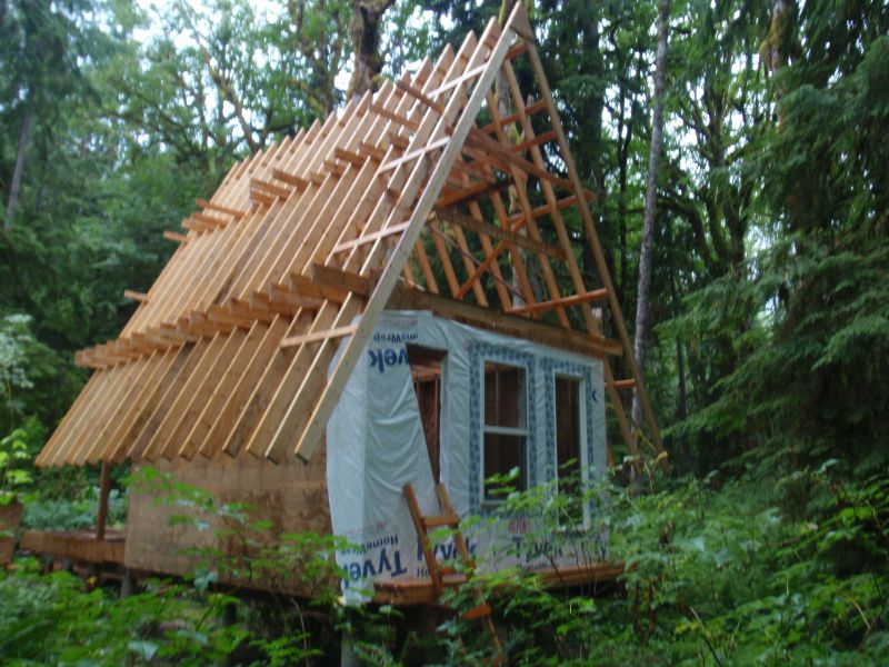

 | # Posted: 18 Sep 2011 09:44pm Reply

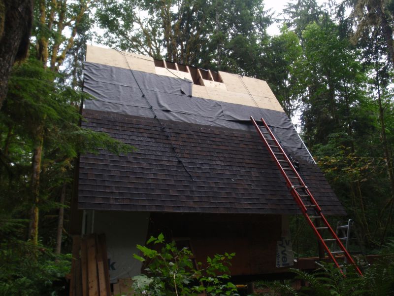

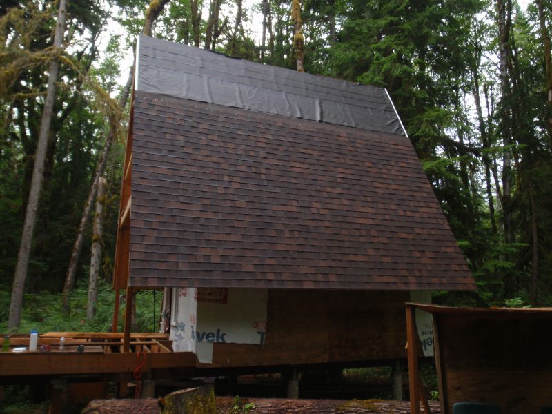

 Roofing in the rain isn't fun.  Especially when you're in the 21:12 slope range.  But its gotta be done before winter hits!  Last year I got shut out around November.  Once I have a roof over my head and the cabin is dried in then I can keep working if I want.  Honestly, I don't know if I will.  I love it up there and I know it will be worth it for all the years I'll spend up there, but I'm getting a little burnt out.  I know its going to be a long time until the number of days I've spent relaxing and enjoying the cabin equal the number of days I've labored out there.  Alas...
 I am 2/3 of the way done with 1 side (I stopped on this side since I was getting to the top of rung of my 24 ft ladder.  I'll continue with my climbing harness on until I can't reach any more, then maybe install some roof jacks near the top) and 1/2 way done on back.  I still have a hole in the sheathing and tarpaper on the top of the backside because thats how I get in and out on top.
 My goal for this year is finish the roof, frame and sheath the gable ends, finish installing the windows (every one I bought cheaply second hand or traded for), install the door, then invite a bunch of friends over to knock back a few brews and burn all the scrap wood.
 Do you think my plywood sheathing will be okay over the winter if I tyvek wrap it or do I really need to get some sort of siding on?
 The good news about the stage I'm at is that it started pouring in the middle of the night.  It was raining pretty loud and woke me up but now that I have a plywood and tarpaper over my head, my tent didn't get wet at all.  I greatly look forward to a few weeks from now when I move a bedframe and mattress into the cabin and ditch the tent.  I almost never thought that stage would come.
 Its going well though.  Going slowly but well.

 | # Posted: 18 Sep 2011 09:59pm Reply
 I really like the shape of your cabin.  I thought really hard about doing one like that.  You have done a great job and keep us posted.  thanks
