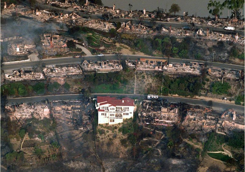

A few years ago I watched a documentary about the fire fighters working to put out a massive southern California wildfire. The fire chief was asked how they determine which houses to fight to save and which to let burn and he said "If we pull into the driveway and see a wood shingle roof, we turn around and leave. It's too hard to save."
I also recall seeing an image of a southern California hillside from another fire season. A road wove its way back and forth across the hillside in an "S" pattern, and all the way up the hill there were dozens of burned out houses on each side of the road with only the concrete basements left. In the center of all those burnt out homes was one house standing untouched. The news crew went up there and knocked on the door and found the homeowner still there. They asked him how his house had survived the fire storm when all his neighbors houses had been destroyed.
He said, "I built my house with a metal roof and stucco walls. All my neighbors used wood."
While insurance, fire extinguishers, escape routes and emergency water supplies are all great to have (and you should have them) the first question to ask yourself about how to survive a wild fire is "What should I build my cabin out of?"
# Posted: 19 Aug 2015 02:06pm
Rockies, I remember that pic. Along a ridgeline in Cali. One of those canyon fires, Santa Anna winds. I should have saved a copy. There wasn't anything flammable on the house or in yard. I thought he should get a break on his insurance.
# Posted: 19 Aug 2015 02:21pm - Edited by: DaveBell
Not sure this is it.
1993 Laguna Hills Fire
http://www.finehomebuilding.com/how-to/articles/fire-resistant-details.aspx

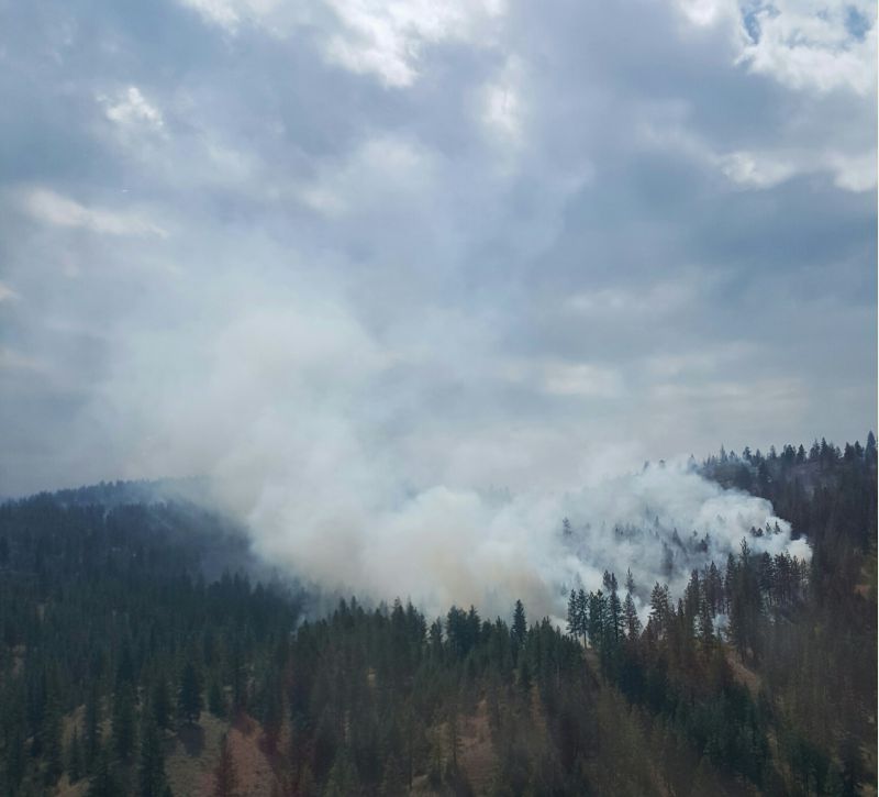

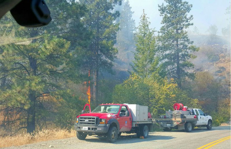

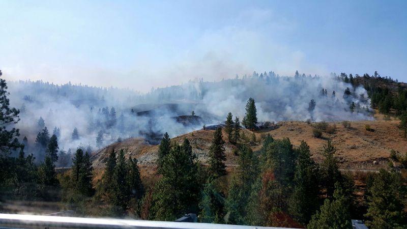

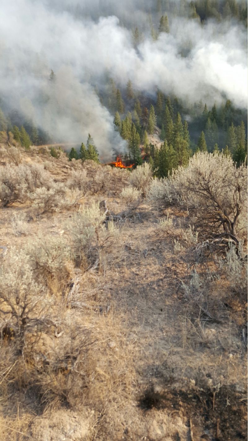

I just came back from my cabin, my state on the east side is on fire (Washington) and I was diverted around Chelan for an 8 hour trip tot he cabin. I fire started in the lower draw near my cabin, my cabin was still a good 8 miles away but at night, run to the county road, I could see the glowing hillsides. Only wind direction saved the place. It was smoky most of the time. Town below (18 mile drive) was evacuated, embers crossed the valley and fires approached the town from 2 fronts. I lost all cell service, a fiber optic line was damaged by fire. It was burning all the time i was there. I was worried about going to bed only to wake up to a fast approaching fire. I fared well. I changed some of my plans and spent all day Tuesday taking fire prevention measures around the cabin with a good buddy of mine. We both worked solid for 10 hours each. I trimmed all branches on tall trees to the 20+ foot mark, cut down smaller trees, raked all needles etc away from cabin, cabin is already surrounded by gravel. It was so much more open when I left.
A few pictures of the fire.
I suspect all will be fine, but it wont be over till the fire is out. I am home now. Left early this AM. Drove past blocked road to get out, fires right on the side of the road.
The drive back, smoke was so bad, the fire damage on the sides of the roads for 100 miles or so. It was hell on earth. Its like nothing i have ever seen before.

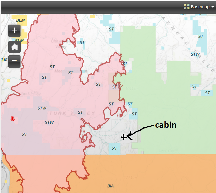

Well, fire is now about less than a mile from my cabin, other than the fact the wind changed for now, it doesn't look good otherwise. I will either have a cabin or an ash pile in 24 hours. I am literally getting sick to my stomach right now.
If you guys could say a prayer, I'd appreciate it.

Thanks upndown. I just checked the latest fire map and it was updated last night, and the map shows the fire was still stalled at the same place. Just below the timberline in the grasslands. I can only suspect its out at that front. The map shows my entire area spared. I am not out of the woods yet, it has a southern front that could go south and come back up, we are in a draw, downhill which makes it slower. And there is another large fire east but its not moving my direction, just north. Estimates this fire will be fully contained on Sept 8th. So a lot can happen until then. I hope we get some heavy rain over that way.
But for now, unless I hear otherwise, I am assuming all is in place.
