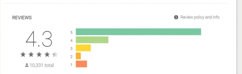

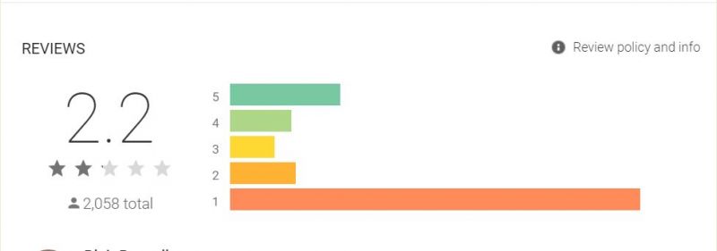

Man, the app is so refreshing after dealing with Moultrie's app. The reviews on Google Play tell the story, guess which is which.. Too bad because the Moultrie camera has been dead nuts reliable.
I'm now juggling around the 3 cameras for location. Probably have one at my house, even though I have wifi there always and could use a cheaper wifi link camera. Other two at the cabin.

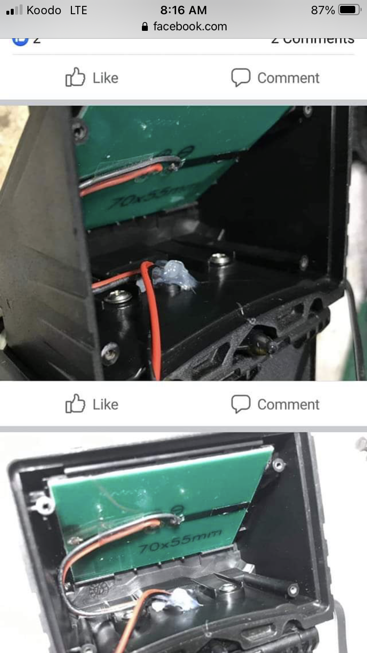

I believe an update on my Spypoint LINK-MICRO-S-LTE is warranted now -
After 2 months of flawless performance, it stopped working. It looks like water got into the battery compartment and the battery itself. They were good about replacing the entire thing without hassle. My concern is that water shouldn't have gotten into it to begin with, so I'm expecting the problem to POSSIBLY recur on the replacement. Or maybe I just got a dud with the first one.....
# Posted: 31 Mar 2021 07:43am
there have been a number of Link micro S's that had water penetration apparently around the solar panel or under it. Seems to be an ongoing issue.
Apparently the seals they have around the panel aren't good enough or have been installed improperly. Guy's have been using a few dabs of silicone in the prone areas to solve the issue. Spypoint has been good with returns, but who wants that hassle.
I'm sure a quick google of where to seal your camera would solve your issues.

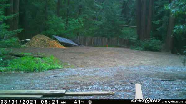

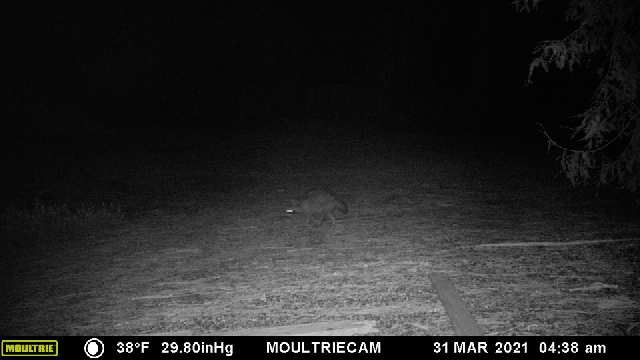

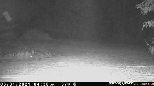

I've had the Moutrie and Spypoint cameras side by side in my yard testing. Last night at 4:38 both triggered for a critter, here are the two photos. downloaded6375277255.jpg
jhp
# Posted: 31 Mar 2021 02:39pm - Edited by: jhp
At first glance the Moultrie looks like the better shot.
Looking at it a little more I think I prefer the Spypoint as it's putting out way, way more light. It looks worse because it's washing out the up close image but I can see everything way in the backround.
The Moultrie doesn't even pick up the dirt pile or the trees.
Good comparison shot.
# Posted: 31 Mar 2021 03:12pm
I guess it depends. If it were a person, which is my real focus, the Moutrie might show more detail, at that distance, but back further might pick up noting. The Spypoint goes all the way to my fence and gate. Car headlights they both pick up equally all the way at the gate. Here's what a day shot looks like.
There may be adjustments, don't know.
# Posted: 31 Mar 2021 04:06pm
I assume those are the low definition pics that they send to your phone. You can still get the high def version by request or off your camera if you really need better detail.

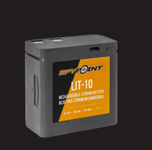

I'm starting to wonder how sensitive the Link Micro is to voltage, specifically over 12v. The 12v li-on battery I have is of course near 14v charged. I got on a chat with 'Jaskaran' at Spypoint and asked. He (or she) said "lithium is not 12v". Thanks for asking..
Spypoint does sell a lithium battery that replaces the 8 AA battery pack inside the camera, but it says it's 3.7v?
https://www.spypoint.com/en/products/rechargeable-lithium-battery-pack/product-lit-10 .html
# Posted: 18 May 2021 11:39am
Quoting: paulz Spypoint does sell a lithium battery that replaces the 8 AA battery pack inside the camera, but it says it's 3.7v? Your Valence battery uses LFP cells, parallel/series configuration to supply a nominal 12 volts. An individual cell has a nominal voltage of 3.2 volts. Some of the cells being in series is why a BMS is required for use.
The cells used in that Spypoint battery would be a lithium-ion type. Those have nominal voltages of 3.6 to 3.7 depending on the manufacturer. The same cell could be rated at 3.6 volts by one seller and another seller at 3.7 volts. It would appear the li-ion cells in that battery are all connected in parallel. That way they avoid the need for a BMS.
Without having my hands on a Spypoint or looking through literature I do not know for certain how the AA cells are connected when inserted into the Spypoint. It could be all in series or a series/parallel combination. Because the AA are not rechaarged in the unit a BMS is not required at all.
The Spypoint can also be powered with an external 12 VDC supply according to the specs.
I am guessing the Spypoint devices are internally equipped with circuitry that sorts it all out depending what is connected where. Inserting their li-ion battery could activate a switch or something. (I have devices that can sense when a rechargable pack is inserted and enables the built in charger for example. That prevents inadvertent charging of batteries that are not rechargable.) And the 12 VDC could be internally converted to some lesser voltage.

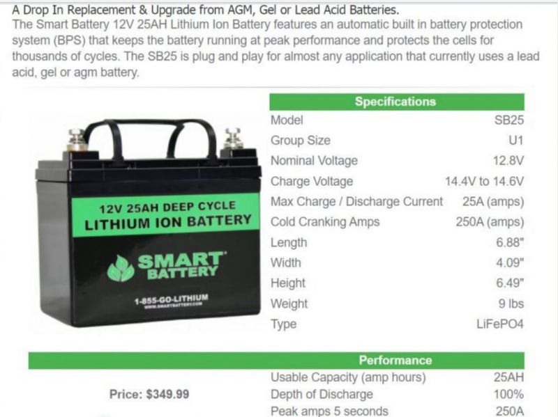

Thanks ICC. Actually I haven't hooked it to my Valence batteries yet, I've been testing various location on my land using a 12v universal li-ion battery.
Interesting about the cell voltage differences, How do the 3.6-7 cells add up to a 12v pack?

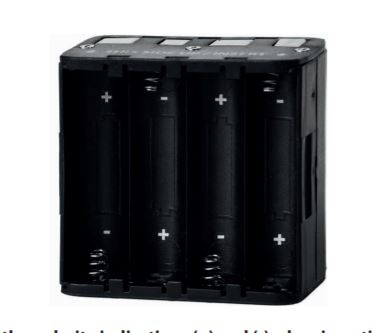

The AA battery rack that the Spypoint 3.7 battery replaces has, strangely, 4 terminals compared to only 2 on the 3.7. I have measured them, each pair hooks to 4 of the 8 AAs, for somewhere around 6v. Capture.JPG

# Posted: 18 May 2021 01:17pm
Quoting: paulz Interesting about the cell voltage differences, How do the 3.6-7 cells add up to a 12v pack?
They don't. I don't think they can without some internal voltage control circuitry. I believe any of the manufactured batteries that are sold as 12-volt batteries or multiples of 12 will be found to be using LFP based cells.
The image (capture.jpg) of the battery spec sheet is an LFP battery. An LFP (3.2 volt) cell is technically a lithium ion type but many people prefer to just call an LFP an LFP, skipping the lithium-ion, or li-ion nomenclature, reserving li-ion for the other lithium chemistries that are rated at 3.6 or 3.7 volts.
I probably should not use the term li-ion to mean the chemistries with 3.6 or 3.7 volts per cell.

Quoting: paulz I never noticed the Lifepo4 in the spec sheet. Well I guess that's good news for me, safer battery. It's been a handy little carry around battery, lighter than a comparative LA and no need to worry about corrosion or deep discharge.
I had meant to add a comment to this and forgot.
The "deep discharge" comment could be worrisome, depending on what is being considered to be deep discharge. Lithium cells should not be discharged below 2.5 volts. That is way beyond where most folks will go. If the assembled battery has a good BMS that should not allow the voltage to be dropped to such a low level. But, if there is no protection a lithium cell or battery can be ruined by such really deep discharges. Just some FYI.

I don't know where to silicone the camera in order to prevent water intrusion. Anybody know?
# Posted: 20 May 2021 08:20am
Take out the 4 screws on the back of the solar panel and seal where the wires enter the camera

Quoting: ICC The "deep discharge" comment could be worrisome, depending on what is being considered to be deep discharge. Lithium cells should not be discharged below 2.5 volts.
Point taken thanks. This particular battery does have BMS but no idea at what voltage it would shut itself down. So I guess cell phones and laptop have similar protection, when they say they are at 0% they are still above damage potential.

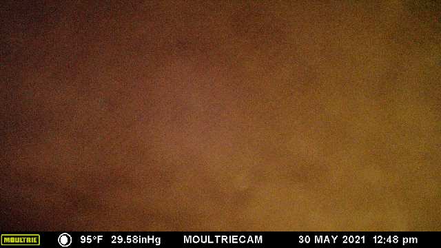

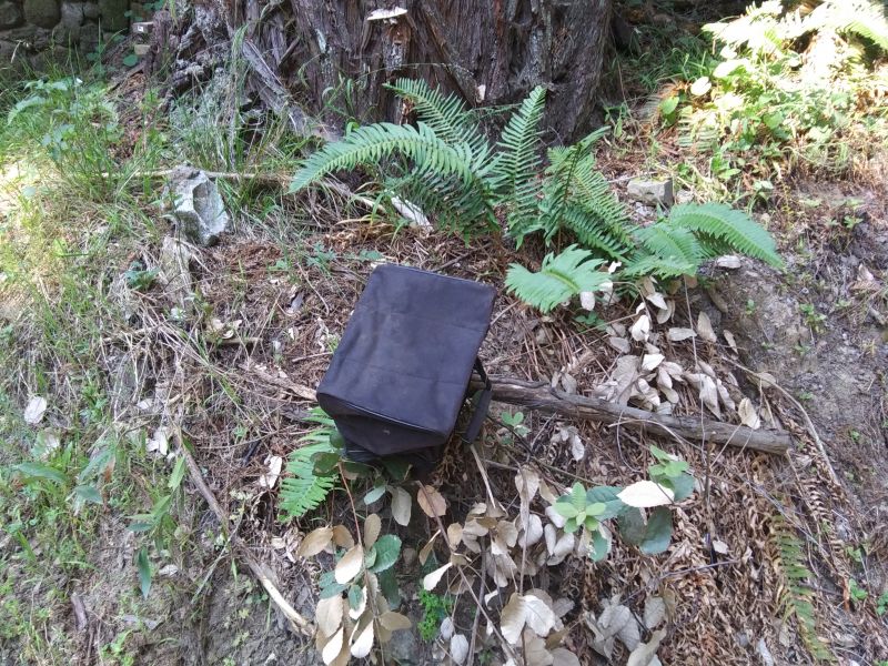

# Posted: 16 Jun 2021 06:32pm
So the other day I got the bright idea that, instead of popping open and turning off the Moultrie every time I'm around and getting my picture taken, I'd just cover it with a black bag. Guess what I got? 50 pictures of the inside of a black blag.

# Posted: 16 Jun 2021 06:47pm
too see though and the light changing triggered pics still. Something more opaque should work for that.
