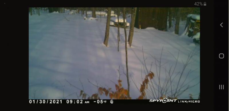

What percent service do you have? Mine is working with 25%. When I moved the camera I removed and reinstalled the SD card. I believe my antenna is 90* out from the tree right now. It's in the crotch of two trees and I'm sure the tree is blocking some service. Also use lithium batteries if your not there for over a month.
This pic was from today.

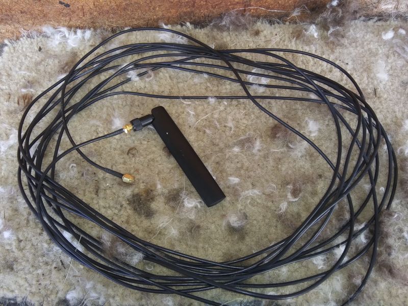

apparently some guys in limited service areas have had good luck with these https://www.amazon.com/gp/product/B07MJFTKQB/ref=ox_sc_act_title_2?smid=A64JRSYTRERAS &psc=1
I haven't tried it so I have no first hand experience.
# Posted: 30 Jan 2021 07:31pm
Thanks Fish. I didnt even think to add an external antenna. Spy point does sell one but it's expensive. Fishes link even has the connector name you will need for a cheap aftermarket one. I may try an external one.

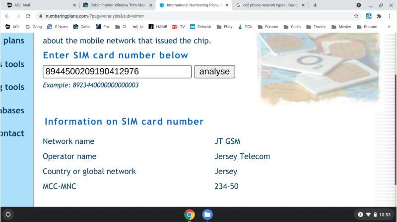

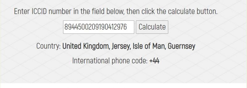

I just did a chat with Verizon, as they have an online SIM card checker. It wouldn't take the number that is on both my camera sticker and the SIM card itself, so they gave up..
Did a little checking on my own, turns out the number (the only number on there, 8944500209190412976, is an ICCID number, different thing I guess. I entered that in an online checker and got this. The 44 at the beginning is the country code for England. Weird.
If someone has theirs handy maybe you could look at it, it's right behind the battery holder. Might also be on the app.
The web site I used to look it up: https://www.imei.info/iccid
# Posted: 10 Feb 2021 08:39am
Still no reception at my cabin. I was able to decode the ICCID number to reveal the carrier as Vodafone, out of UK, which I have never heard of. Apparently they have some connection with Verizon but all the info I'm seeing is years old.
