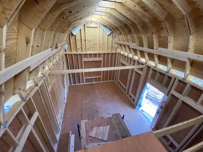

# Posted: 20 Oct 2021 07:59am - Edited by: WILL1E
See in my picture where the top plate is and how you can see through to the outside. My sheathing stops at the top of the top plate, so i need to fill that space in. Don't you typically put a board in here?

# Posted: 20 Oct 2021 09:37am

# Posted: 20 Oct 2021 10:47am - Edited by: Nate R
Depends. Heard it just called blocking, or bird blocks, etc.
I extended my sheathing about 3-4" above the top plates. (I had about 8" of space there.)
No boards for me. Then I cut 2" foam to go against the sheathing, and support my soffit baffles. I made soffit baffles out of 1" XPS foam, and cut 1 1/2" spacers/supports. Sealed it all in with spray foam, so cold soffit air doesn't short circuit the insulation, and the baffles themselves are R5, so they add to the insulation value.
Here's some pics of how I did mine:

So if i use these vent chutes with baffles, i don't need to add any blocking or sheathing right? My vented soffit will keep the critters out and allow the air to pass into those chutes.
My rafters are 2x8. So i need to chase those chutes all the way to the ridge. They are probably what, 1-2" thick? So i would assume i would just use insulation for a 2x6 wall...so R-23 is the most i can get up there?

# Posted: 20 Oct 2021 11:57am
Quoting: WILL1E
Correct on all accounts. However, if you price out those chutes you will see that they cost more than using foam. Plus foam will give you an extra R3. Of course foam is more work as you have to custom cut it (or buy 14.5" pieces for slightly more money).
NateR's install is pretty much perfect (even sealed with spray foam).

# Posted: 20 Oct 2021 12:03pm
Maybe someone with code experience can jump in… but I thought all rafters need to blocked…. Could be mistaken though. And gambrel may be different.
Also regarding blocking-what is going to keep the walls together? Are you putting rafter ties on? If so I would want to do that before any blocking. It looks like there’s one board right now doing the job for now in the open area.
I will also just add that in my experience blocking really strengthens and tightens the entire roof. I see you’ve sheeted already so not sure if it matters now but the roofs I have built have all gained a lot of structural integrity from blocking… the minute the blocking is done there’s no longer any wobble. Those have been simple gable roofs though.
Just my .02

# Posted: 20 Oct 2021 01:15pm
Quoting: Grizzlyman
Gambrel is a bit strange on code as it seems some places don't allow it for human habitation.
Much of the reading and plans studying I have done, show no blocking at all. The Gambrel relies on the staggered sheathing to get its strength. I can attest to that as once the sheathing was on, all wobble was gone on my roof.
However, I am considering adding 2 2x4 perlins along the ridge. You loose a tiny bit of height, but it should add a ton of strength. They will be under the drywall, so who cares.
WILL1E
# Posted: 20 Oct 2021 01:19pm
Quoting: travellerw
So I would need 3 chutes to do the space between between a set of rafters on 1 side of the roof. $9. A 4x8 sheet of 1.5" pink foam is $22 and i would need 2/3rds of sheet to do the same space, so $14. I realize i get extra insulation value from the foam route, but if i do like NateR and I have a 1.5" spacer for the air void plus the 1.5" sheet on top of those spacers, i loose 3" of rafter depth leaving only 4.25" for batt insulation since i have 2x8 rafters. Pink foam is R7 and i would have to use 2x4 insulation which is R-15, so i would be at R-22 vs chute trays and R23.
Am i missing something?
Quoting: Grizzlyman
I would have to do this after i installed the trays and probably use 2x6's. Wouldn't tie to the sheathing but would connect the rafters.
Quoting: Grizzlyman
The loft is 10' deep and full width, so i assumed the loft floor joist would tie that end together. That board you see going across is nailed just below the top plate...that's about halfway for the non-lofted area. So from the last loft joist to that board is about 11' and that board to the wall is another 11'. Think i need more or i need rafter ties?
Nate R
# Posted: 20 Oct 2021 01:36pm
I think Grizz was saying you could use 1/2" foam.
I used 1" foam, and cut the spacers 1.5" wide.
Most chutes are set up for 1".
Also, last I looked, Menards was short on R23 mineral wool insulation.... I bought up some of the last stock a couple weeks ago, and R30 wool in a 23" width was out of stock for 12 weeks...... I'm using R38 fiberglass in the ceiling now with R19 batts on top of the R38 where they fit. Also doing R21 fiberglass in most of the walls, using the R23 mineral wool in some key areas.
Don't forget, you CAN compress fiberglass insulation, it just reduces R value, but better than leaving extra space, usually.
See here: https://dcpd6wotaa0mb.cloudfront.net/mdms/dms/Residential%20Insulation/10017857/10017 857-Building-Insul-Compressed-R-Value-Chart-Tech-Bulletin.pdf
So, if I were you, I'd just use 1" foam, and 1" spacers.
You have 7 1/4", right?
So, 2 inches gone for the air space and foam, and you're at R5, leaving you 5 1/4" for fiberglass. Throw some R21 batts in there, probably R19 or 20 with the slight compression, and you're at R24 or 25 total.
Or, use 1/2" foam, and the 6 1/4" R19 batts (Cheaper batts....), and you're at R21 or so total, but for less cost, too.

travellerw
# Posted: 20 Oct 2021 01:45pm
Quoting: WILL1E
I used 3/4 EPS @ $13/sheet. Then used 1" spaces for a total of 1.75" of space, leaving 5.5" of space for batt!
Quoting: WILL1E
Definitely.. You have 22 feet of wall supported by a single rafter tie. Plus your top plate is only doubled up. I don't think that is strong enough to withstand pushout.
To give you an idea, on mine. Our loft is 16ft of a total 28ft building. That leaves 12ft of unsupported wall. I have a triple top plate that is glued and nailed, but I don't think that is enough. I will be installing 2 stainless steel cables spaced evenly to act as ties in that area.
