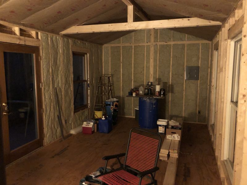

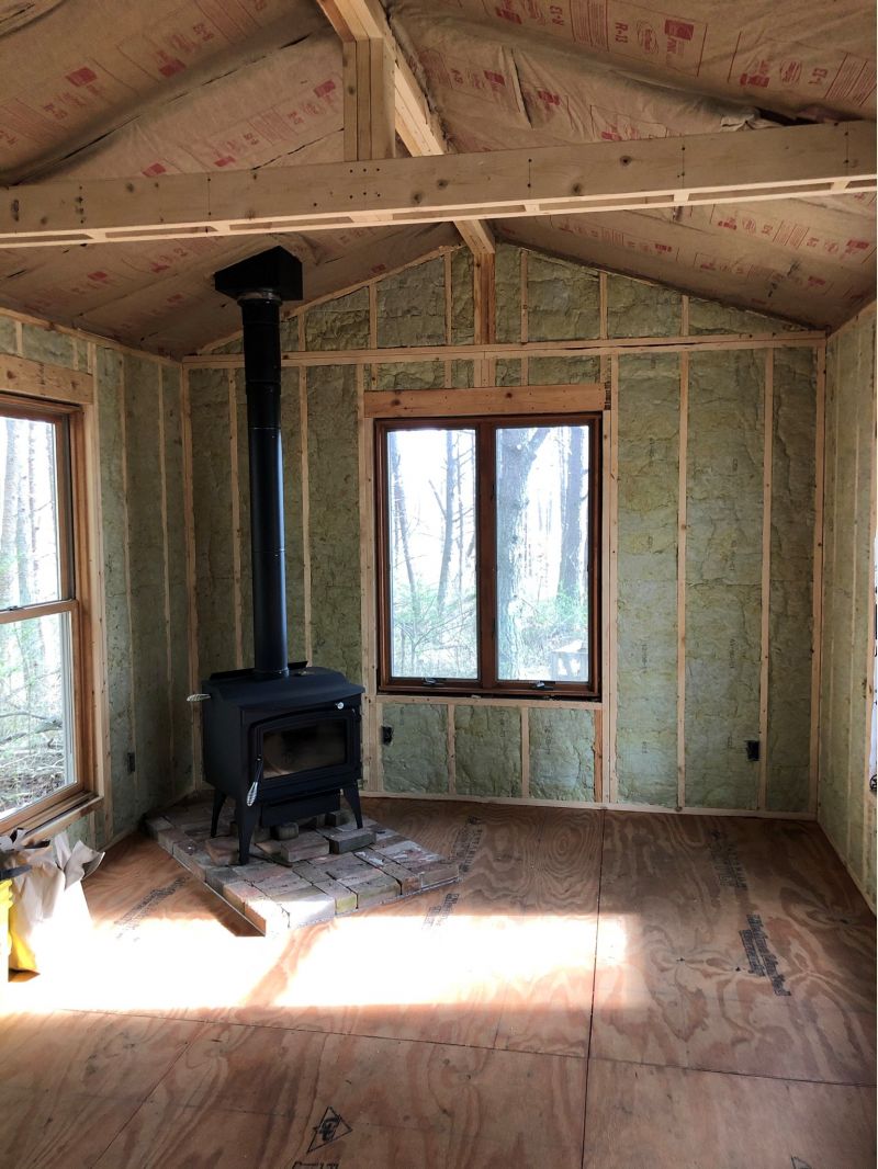

My two cents worth:
I did drywall on the inside over rock wool/mineral wool insulation in the walls with no vapor barrier and on the ceiling with fiberglass under a paper vapor barrier. I read both ways about using a vapor barrier over the mineral wool. I hate insulation installation and wanted it done as fast as possible. So, I chose no vapor barrier and just covered it up fast with drywall. A friend had a drywall lift and it was a wonderful thing to have when putting the drywall on the ceiling. The mineral wool cut easily with a bread knife. I also used it in the floor. It's said to be resistant to rodents and moisture so it was a good choice in a cabin. If it had come with a vapor barrier attached, I'd have put it in the ceiling. I couldn't find it like that. As for the drywall, using it
might be mundane in a cabin, but it is cheap and gave me a sense of security for fire issues, since the cabin is located far away from any help.
insulation
insulation
insulation 2
insulation 2
