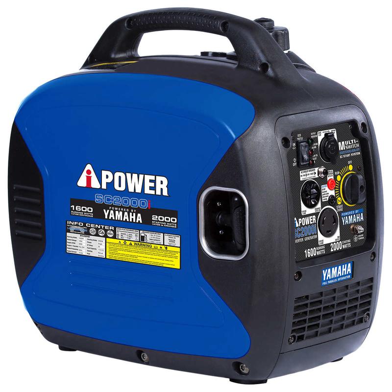

I was given a nice Yamaha powered 2000 watt inverter generator sold by Costco, nice unit, had all the phone numbers for service, email etc. I could never get a hold of a single person on phone or online.
I needed carb parts. Thankfully, the Yamaha engine was the saving grace. I search far and wide to locate the model of the Yamaha engine and went to a Yamaha website and bought the parts I needed to fix it. It was called A-I Power 2000, and for under $50, fixed it, but it was given to me. So its Honda, followed by Yamaha or none at all.
