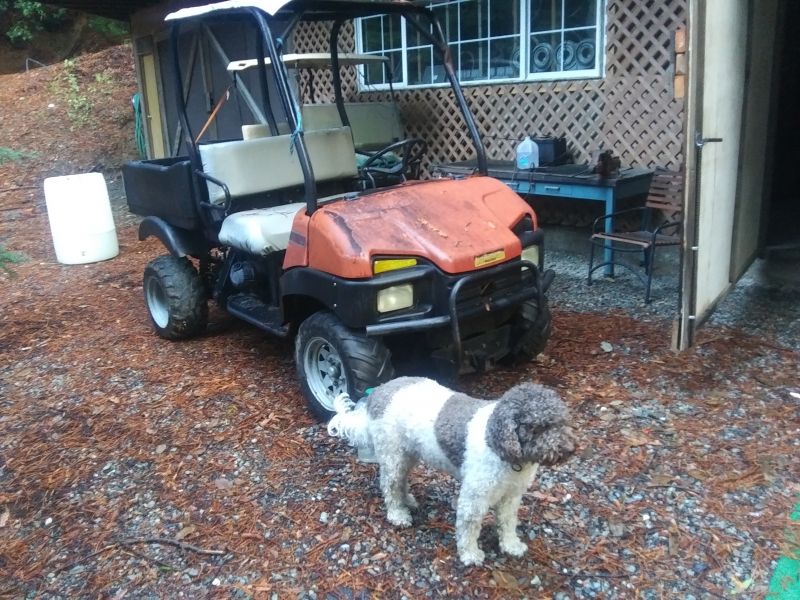

Speaking of carburetor electronics, boy did I get stung yesterday. I got some time to play with an old dead Bush Hog UTV I've been given. Started with electrical since It wouldn't turn over, which I got it to do with a hot wire to the starter solenoid, but would only run on a prime. Figuring the jet was plugged, I pulled the carb, no easy task, buried between the 20hp Honda cylinders. When I finally pulled it up there is was, one of those fuel cutoff solenoids in the float bowl, unpowered by my hot wire job. I went ahead and pulled the float bowl and jet out anyway, clear. Slapped it back together, hot wire to the fuel solenoid, off and running.
I've seen these things before on lawn tractors. Pull start generators probably don't have them since you need juice to power them, but some of the snowmobiles and UTVs you guys have might have them.
I guess it takes the place of a manual petcock, so if the needle and seat are faulty it won't leak fuel, if the tank is above the carb.
# Posted: 12 Nov 2021 10:30am
That is exactly why. Far too many people forgetting to manually turn a shut-off and a leaking float needle & seat and there is a crankcase full of gas on your engine oil. The elec valve is a simple solenoid, basically works until it doesnt. On any so equipped rig I install a manual shut-off asap! If/when the elec valve fails just removing the wire doesnt help, it needs power to open the valve (and a functional solenoid).
If you have to make that valve flow gas the tip inside can be snipped off so with the manual shut off you are all set up like a reliable 'old' rig.
# Posted: 12 Nov 2021 10:46am - Edited by: paulz
Ha, I should have snipped the tip of that solenoid off yesterday, I was wondering about a way to hold it open. There is an o-ring around the main jet holder that fits into the bowl, creating the separate chamber for the solenoid. I removed that o-ring, thinking fuel could run past it and get to the jet but it still didn't allow fuel to pass. The gas tank is at about the same level as the carb. I haven't looked yet to see if it pulls fuel out the top, like a car, or the bottom of the tank. I'll fill it up today, pull the hose off at the carb and see if it comes out on it's own. The carb has an overflow line, so if the needle does leak it should just go on the ground.
But at this point I'll just run power to it like it's supposed to have rather than dig that carb out of there again.
Not even sure I can drive this thing, it has some kind of electric clutch and variable transmission. Bush Hog only marketed these things for a couple years, they were all recalled (cept this one..). Dunno who actually made them. Good chance I'm wasting my time. Nice Honda V-twin though.
# Posted: 12 Nov 2021 11:05am - Edited by: gcrank1
As long as the float bowl needle/seat is good so it stops the gravity gas flow that would be Ok, BUT, you wont know when that (and old ones arent to be trusted) fails until you have diluted your engine oil with whatever gas passes through; BTDT!
If it is not gravity fed the tank most likely would be below the carb level and there will be a small fuel pump.
I suspect, without researching the rig, that it is based on a gas engine golf car. We have a Toro Workman based on that, 20ish yrs old, B&S c-twin, pre UTV I think. It is our cabin mini-truck and works just Ok and was far cheaper than any used UTV I could find around here.

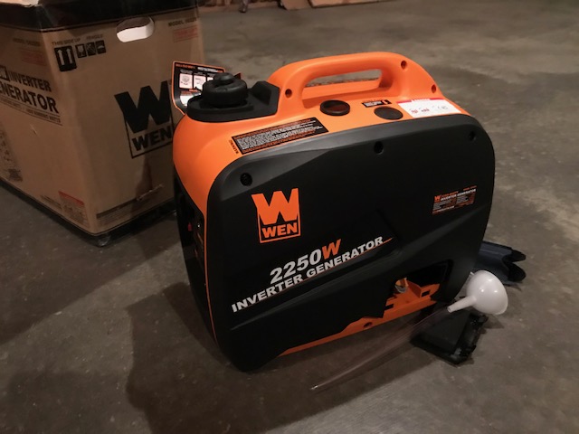

# Posted: 23 Feb 2022 07:45pm - Edited by: neb
I haven't posted much in the last years but the site was a great source of info when I built my cabin on the ranch.
I never had a generator at the time and used all hand tools and chainsaw for construction. All material had to be sledded and packed on foot.
Any way I got a Gen for Christmas, and it has been a pleasure when I'm at the cabin. I also bought more land and there was an old 100 plus year-old ranch shop and old house.
The gen has been come in very handy while I was rescuing the old shop.

I cant imagine not having an inv/gen in that class as long as Im able to 'do cabin life'. Ours became a true game changer; its my go-to.
Ive got an older (25yr?) low hour Kawasaki 'construction' type with a rotted out gas tank I got free. Im thinking about getting the LP universal kit for it. It would certainly solve my continual rust in the petcock, sed-bowl and carb. It would run real big stuff like radial arm or table saw, etc. that the little one cant surge enough for.
# Posted: 24 Feb 2022 11:38am
Absolutely has been a time saver and less physical work tool for me.
