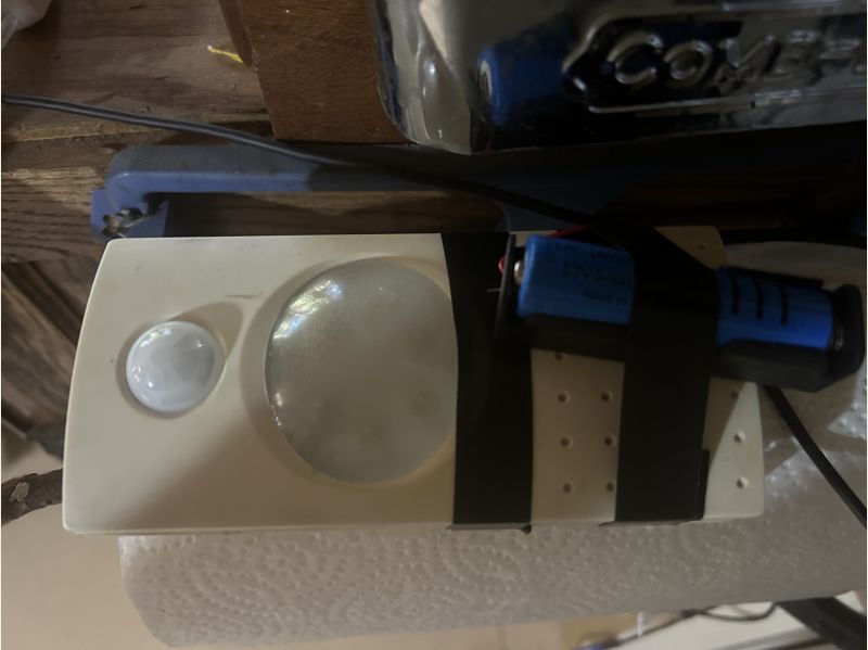

Today was another sun baker out here so I fooled around in the cabin which stayed 10-15 cooler all day. I grabbed this dead light, the 4 AA batteries had rusted out the connections. I cut those out and cobbled on a lithium battery, as well as a usb cable. Excuse the tape job, still in test mode. It does still work in the motion detection mode, so that’s a win. I can just run it off the battery (18650) or will run without it and usb plugged in. My question is can I leave it plugged in with the 18650 or is that too much charge voltage?
# Posted: 7 Jul 2024 12:33am - Edited by: ICC
I assume there is a charger board in there someplace? Or is the usb input and 18650 cell in parallel? In parallel would not be good. The usb voltage would be higher than the maximum voltage for a li-ion cell. With a charger circuit in there it could be good. Depends on the charger circuit. Lithium chargers are supposed to cut off the charging completely when the voltage reaches "full", usually 4.2 volts for the usual 18650 chemistry. Then it should stay off until the voltage drops some, when it would charge and cutoff again. Li-ion have very low self discharge so if un-used that should take a long time.
Then there is the question of the quality and condition of the 18650 cell? If something goes wrong with the charger or the cell, the li-ion cell can burn intensely.
That said, I do have a few li-ion lamps I have made with integral charger circuits. Good quality components with known high quality cells. I don't worry about them.
# Posted: 7 Jul 2024 01:07am - Edited by: paulz

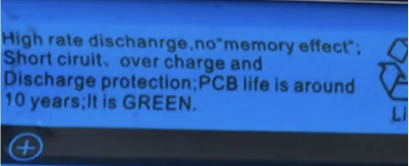

Thanks ICC. No charger, just the batt and usb cable in parallel replacing the AA batts. Yeah I figured it was too much charge, though the 18650 does say overcharge protection.
Don’t need both, not sure where I’ll use it, either plugged in sans batt or with batt only.

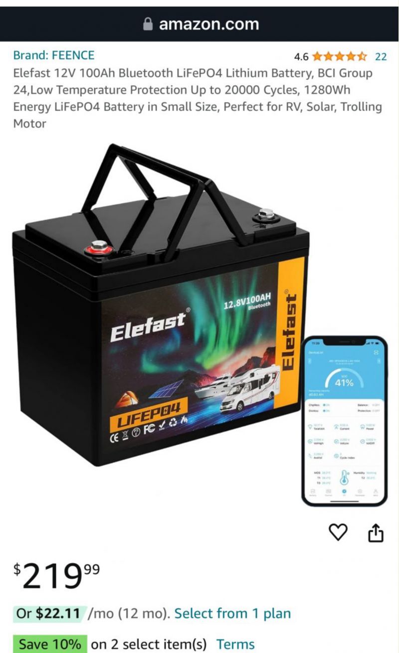

Well he ended up buying 3 of these. 644$ out the door
My friends got his new LFPs. Also a proper charger. Was over there yesterday, he was checking their SOC with his phone! Got an app., Bluetooth..Nice.
