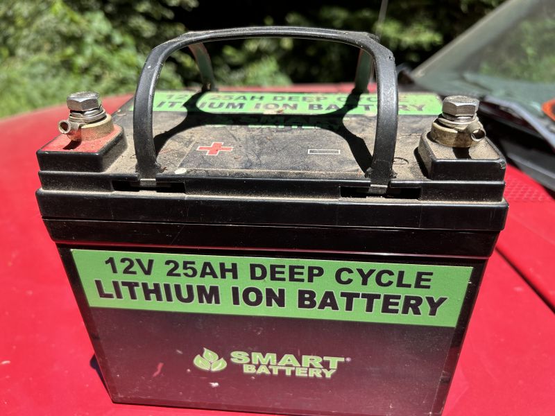

I run my yard cam of this, doesn’t say what it is but weighs nothing. To charge I just jump it to my Valence bank overnight. Those, I figure, are about as safe as they get being medical. Other than that, just chainsaw/tool bats, typical stuff with matching chargers.

Gee wiz, no specs or anything on all that labeling ? That's precious /s
Those Valence batteries really are good from all that I have seen. Sure few have issues but .. used etc... Darn shame that company doesn't go retail with various sized batteries - similar quality etc...

Quoting: Steve_S
A reverse image search with Google found this.....
https://www.small-cabin.com/forum/1_8145_10.html
And this... (40 ah version...)
http://dkdhitech.com/12v-40ah-lithium-ion-battery-p477481.html

Thanks Izzy. Guess I looked it up when I got it, new but from a private party. This one is blank on the back side, not even that 800 number.

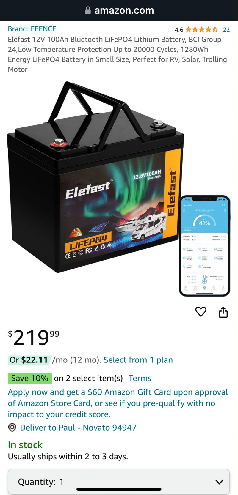

He found these batts on Amazon. Anyone familiar? I advised him on a Victron CC based on what you guys have said.
https://www.amazon.com/Solorage-LiFePO4-Lithium-Lifetime-Trolling/dp/B0CL4TH1FM/ref=s r_1_5?crid=3577UFHMH18WQ&dib=eyJ2IjoiMSJ9.F0ehGdID0_0hGz3R-C-8ylI0nU0GcErSPKjEfXFVSb2 ESSkIGn_s2RnWxIDYt7AVZe3TuKqhCX0cNbKstFjdEPh7zb03d77JxoLtc7_K6Ac5ZK8utyFQJxGhNFGm3_c2 D68N1Rakky7tfFXbJdl77iMTxEbgXRd679vX2hxGh2fwlsZhOqCwEZzDF90g3MFICvTtO7HJqyPTHrL8eZewM N8BORXLLX4LlNOzjMGzw7M.1LrnoB6tx7xn5jZumJaA1DQnD6xuDkYH4S6ae_EntfY&dib_tag=smacab-20&keyword s=lifep04%2Bbattery%2B100ah%2B12v&qid=1719331858&sprefix=lifep04%2Bbattery%2B100ah%2B 12v%2Caps%2C210&sr=8-5&th=1

I looked at the Amazon offerings and decided it was a crapshoot. Many good reviews and some bad. Many different brand names, most unheard of, especially in the lower $ ranges. I believe you cannot go wrong with a name like SOK which has received excellent praise from Will Prowse / DIY solar. That was why I chose an SOK. Their customer service has been great for me the one time I had questions soon after buying it. https://www.us.sokbattery.com/
Definitely Victron for a new CC.

Well he ended up buying 3 of these. 644$ out the door.
# Posted: 29 Jun 2024 10:47pm
Never heard of them. Just searched Amazon upside down for "Feence" " Elefast" and various combos with LiFePo4 etc etc ... nothing... I'd say I hear dice rolling in a cup.

Could be, we”ll see. He must have gotten a recommendation, they’re not the cheapies he found earlier.

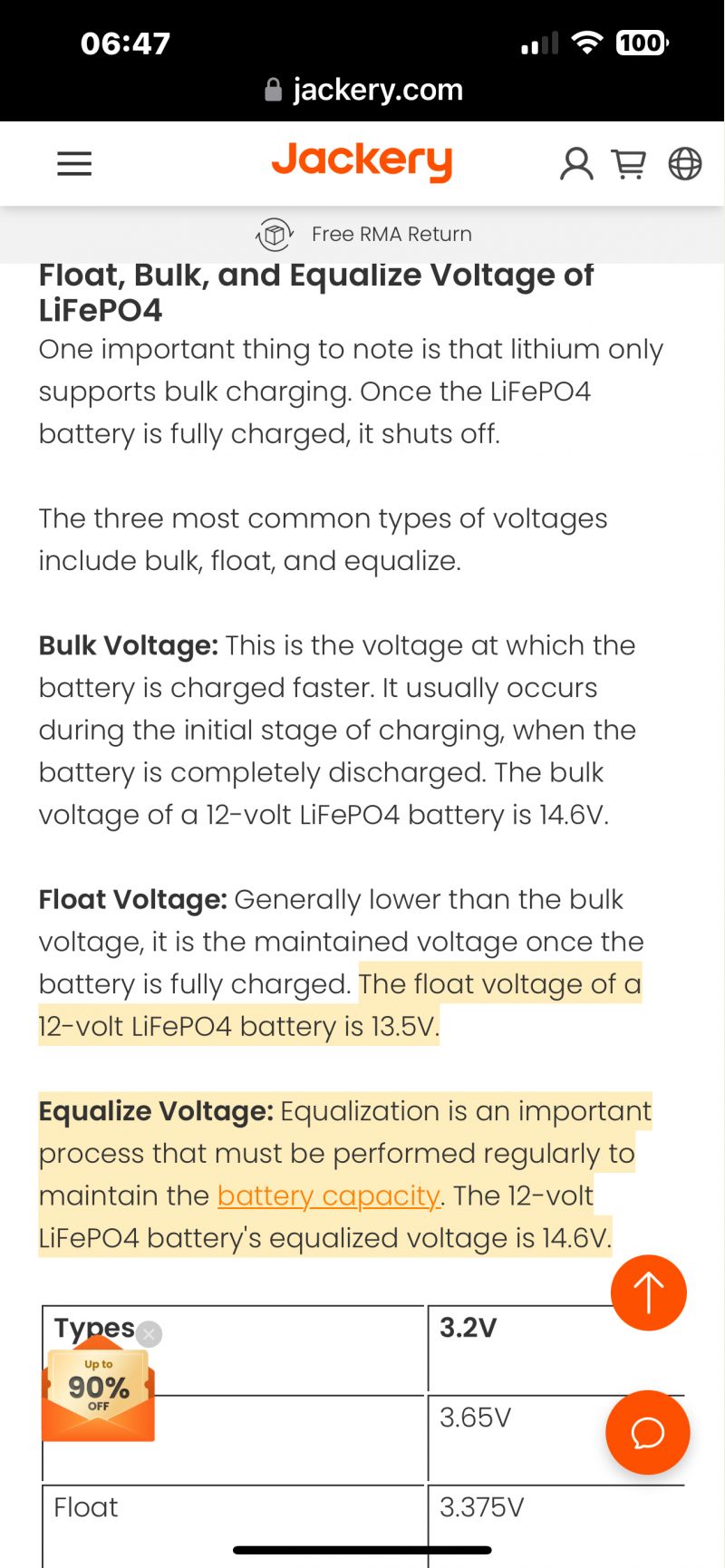

That rings a bell, and I just checked my CC, an old Epever with no Lfp settings (have to use ‘User’ setting and enter your own parameters). I have equalization set to zero.
But with a bit of online ‘learning’ this came up.
https://www.jackery.com/blogs/knowledge/ultimate-guide-to-lifepo4-voltage-chart#:~:te xt=The%20float%20voltage%20of%20a,equalized%20voltage%20is%2014.6V.
# Posted: 30 Jun 2024 02:51pm - Edited by: ICC
I believe the article should explicitly point out that LFP batteries do not need equalization at all. BUT, if the charger one is using does not have the ability to disable or turn off equalization then the equalization voltage should be set to NO HIGHER than the bulk charge voltage and perhaps as low as the float voltage. Plus the EQ time should be set as short as possible. With those settings if an EQ does start, no harm will be done.
The LFP setting on a good charger, like the present Victron chargers, totally disables EQ. There are others that do that too. Read spec sheets.

I agree Izzy, and would opt for the 'float' voltage setting (if you can set it) And if the EQ can't be disabled totally.
Something I wonder about with relatively inexpensive charge controllers is if they do a power reset (or flake out) do they default back to having EQ enabled? I suspect they do and I don't like that.
I disagree with the 14.6v for bulk but for rare occasions or when you really Need a fast charge; ie, that seems to be a commonly mentioned 'max' charge rate for LFP and imo too high. As Ive mentioned before I have my charge unit set at 14.0 for normal recharges
and run the bats to 13.6-13.8. They still settle out at 13.3 or if a bit more they quickly go to 13.3, which is the high end of the 'working voltage' of 12v LFP.

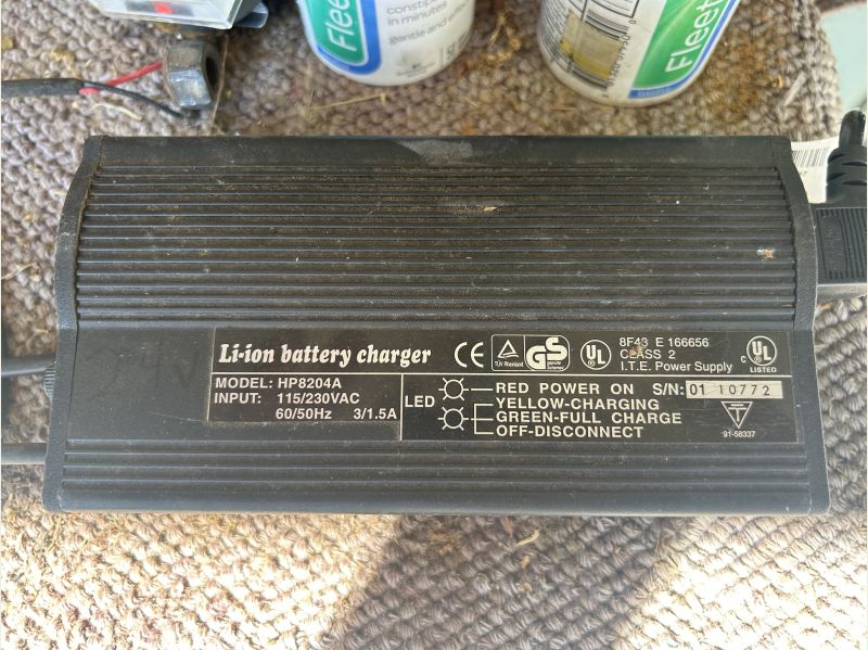

Yep sounds right. Well I found this charger in my pile, never use it, should work.
# Posted: 30 Jun 2024 07:44pm
You had better check the voltages before attaching that charger to anything. It says "Lithium" but many chemistries & voltages apply to the generic term. "OOpsie Avoidance".

It measures a bit over 30vdc. Don’t know where it came from, been around since before my hospitalization last year. Searching the numbers don’t say much, from a mobility scooter maybe?
Anyway looks like an anchor weight now. Was going to give it to my friend but I better not
Thanks for the heads up.

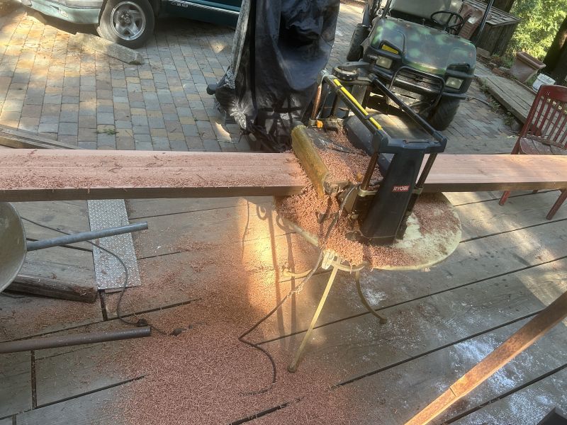

My pal who’s waiting for his new lifepo4s says to me “they can’t be used for starter motors”. Well yeah, that’s why cars don’t have them.. Got me wondering, what happens with excessive CCAs? I don’t have any big DC stuff to try and run, but the other morning I hooked my planer up to my bank, through the inverter. Stuck a board in there and it quit, wife said there was a load beep inside. Inverter powered itself back up but by then I had it hooked to the generator instead. Bank seems ok now, thank goodness.
So what happened. Did the inverter draw too much from the LFPs? It worked fine off the genny.

Two possibilties.
1) The Battery BMS cutoff. Will happen if too many Amps are demanded
2) Inverter could have read a Low Volt (when big surge hits there is a short voltage sag) and cut off.
Also if Battery was low to start with and major surge demand hits it and drops the voltage too low the BMS can also cutoff. There is usually a built in delay in the BMS to handle such cases. All depends on the BMS.
A Planer is a good tool to see what happens.
- It starts (without a load) but still has a "reasonable" start surge (like any motor) but nothing drastic.
- Stick a piece of lumber in it & load it and watch the Amps Drawn go up & batt voltage go down (there is always some sag & is normal)
- The harder the planer has to work the more noticeable... Compare with a piece of nice soft Pine and then a piece of nice hard maple. Oh Boi ! what a difference.
Same situation applies to any Heavy Motor devices like a Well Pump or Air Compressor. Starting an Air Compressor with 0 pressure is easy peasy and no stress and minimal surge demand. But once you have say 75PSI (load to push against) and want to push it to 125PSI watch the Amps Drawn climb and the voltage sag on the batteries. Harder the work = more sag (to a point)
Sorry I know it is obvious but who knows, who is reading this and what they know or don't.
Assuming the Planer is a "regular" 120VAC shop tool, it's likely rated at 15A or 1800W and likely takes a 17.5A +/- (2100W) momentary Surge (not unusual).
LFP is not ideal for replacing a "Car Starter battery". There are "some" Lithium Starter Batteries out there but from what I have been they are NCA/NCM Chemistry. Dunno much about them, other than I would not put one in my truck. (-35C to +40C Temp Zone)
