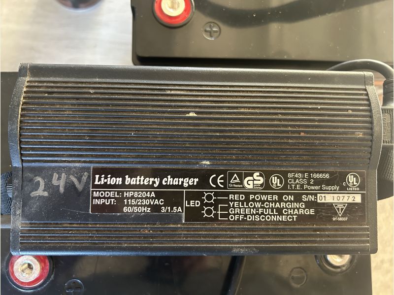

 Ok back at the house. Here it is on a battery for sizing.  I wrote the 24v on it a long time ago so I’d never put it on 12v.  Just measured again, 30.01.

  Oh yeah....I see your brick is:
 115vac (120)/3amps
 230vac (240)/1.5 amps
 Do you have a selector switch for the input voltage or does it auto-select?

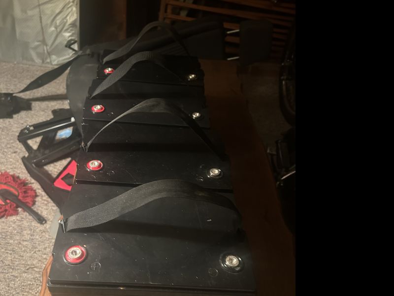

 My new bats are sitting here at the house this morning after a couple hours each on the Meanwell last night. Sitting at 13.3-4 each so I guess a bit of charge did them well.  I never went past 13.6.
 Last week I used plumbers tape to hook them together in parallel!  Worked fine but I need to come with something better.

 Quoting: paulz Ok back at the house. Here it is on a battery for sizing. I wrote the 24v on it a long time ago so I’d never put it on 12v. Just measured again, 30.01. I brought the new 100ahs home too, and a Meanwell. I have one on it now, up to about 13.6. Do you let yours run up to 14.6 before unplugging? IMG_4252.jpeg
 You have me confused. The image posted is a Li-ion battery charger; not a charger for LFP.  The label states Li-ion.
 Are you using it to charge an LFP?  The charge parameters are different.    Is that why you are watching the voltages and disconnecting at 13.6 volts?
 Why not just use a proper LFP charger and charge to the 14.6 volts? (3.65volts is the rated full charge voltage for all the LFP I have seen,  x 4 cells = 14.6 volts)

 Quoting: paulz I think it ight have been for an e-bike or wheelchair. Measures about 29 volts, for two 12v bats I guess. But probably not lifepo4s, whatever lithiums those things use. I’d like to use it at the grid to charge 2 of my 100amp LFPs in series. No photo hear, it’s back at home. Hmm.
 Sorry for the confusion.  I have not used that charger, was waiting to hear back.  Now that I have, I won’t, I guess the different lithiums charge differently.  I had thought maybe just no equalization like LA chargers. Would have been nice with the lights to tell you charge was complete.

 Quoting: paulz Last week I used plumbers tape to hook them together in parallel! Worked fine but I need to come with something better.
 I think "old school" busbars can be made by flattening copper tubing and drilling holes as needed.  Surely you have some copper tubing around your shop. Way better than plumber's tape!
