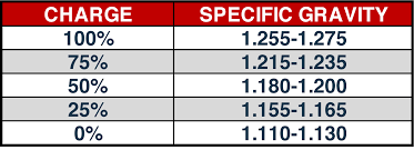

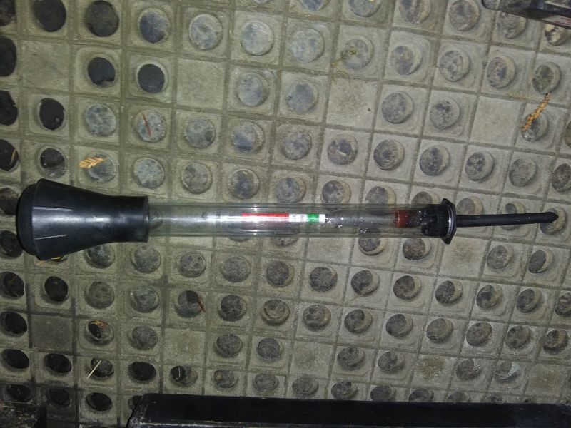

I just bought a hydrometer at Auto Zone. If I ever knew how to read one, I've forgotten. I charged the 4 bats in my shop bank a couple hours ago, they are reading 12.6v now. The hydrometer shows in the white band, which I take it is marginal. About 1235 on the scale, whatever that means. They are old 5-6 years, and die out pretty quickly with the lights on.
# Posted: 2 Dec 2021 08:15pm
Do all the cells read the same/ish?
If not. You may need to equalize them. That's why I asked gcrank about his charger. The one I have is the FoxSur. It's not that expensive. And it really does help out. I am sure others can elaborate more. But it sorta boils down to.... Volts really don't tell much by itself. But with knowing what's going on inside the battery + volts gives you a better idea of battery health.
I know you probably have a load tester. Charge the batts up good. Then hit them with the load meter. No good load results usually means no bueno. Or you might have to recondition your batteries.

I only measured 2 cells, I"ll see in the morning. I do have a load tester. They probably could use more charging.

Top bats with distilled water, some 'sealed' fla have a segmented top rather than caps that looks like you cant get in, but....
Charge fully, check voltage, let rest then give another charge cycle.
Do a load test, any that fail right off are done, discard.
Let other(s) rest, check voltage, you might not have lost too much. If you wonder just charge up, then rest.
Check voltage then do hydrometer. You want the cells to be close more than the 'reading', not that the read is not important. There are charts online of what the read should be (no instructions with the h-meter?) but it needs to be adjusted for temp.

Checked all 24 cells yesterday. There was some variance, most were at the divider between the white and red on the scale (around 75% according to this chart), but some were off quite a bit either way. I did notice the end cells of each battery seemed to be lower than the middle four. Voltage was at 12.55 after sitting overnight with no load. I ran the genny/charger for almost an hour, voltage at 12.85 when I shut it off but still no hydrometer readings in the green.

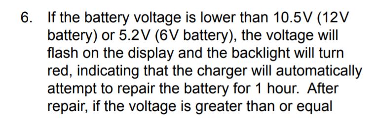

This smart charger is on sale this weekend, locally, about 30 bucks. Says it has "High frequency current pulse can be used to recondition car batteries that are weak, sulfated or deeply drained."
But, according to the instructions, the repair mode only kicks in below 10.5 volts, so no reconditioning or balancing for better bats.
I looked at the Solar Pro and Foxsur you guys have, don't see any documentation if they do anything different.
# Posted: 4 Dec 2021 10:27am
Check and see if you can manually change the charge modes. That is how mine works.
That one might automatically kick into the repair mode at that voltage.

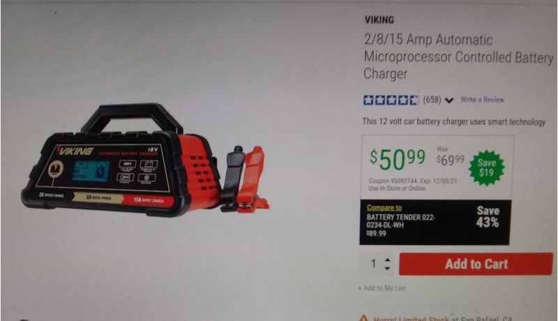

I dug a little deeper and HF has a little more expensive one with a manual recondition button. Sale ends today, my local store was out of stock and wrote me a rain check.

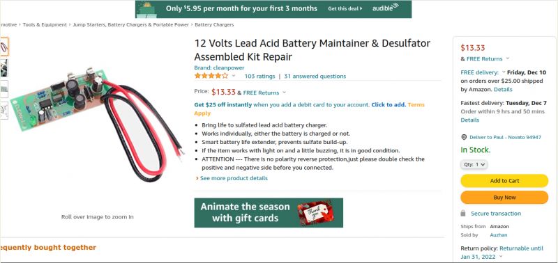

In the mean time I'm going to get one of these little gizmos. It's a pulse desulfator that runs off the battery itself so you provide the charging. I can use it at my cabin with the solar chargers I have and not need grid power or inverter. Reviews are pretty goo but it takes a long time, weeks, which is OK for my tractor bats that just sit there.
# Posted: 5 Dec 2021 07:15pm
My system that came with the cabin had 4, one for each big UPS battery. The info online said one can be used up to 3 bats, iirc, for sure 2. So when my 10ish yr old bats started dying Im down to 1 orig and a used marine bat in parallel sharing one pulser.
I dont know if they work, lots of conflicting info online, but mine 'came with' so Im using.
Seems the military uses them, fwiw.
Maybe not magic but if they help a little thats a little more than nothing at all.

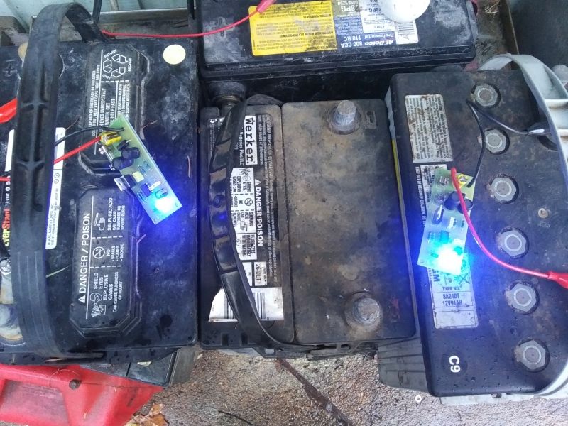

My two little $13 desulfaters (pictured above) arrived in the mail, got 'em going now but they say it could take weeks, or months.
Holding off on the charger. At the local city college where I take auto body class I asked one of the electronics teachers about it. He says he has several desulfating chargers. He's not a fan, says they may help a slightly sulfated battery but won't resurrect from the dead. Pretty much the same as you see with online reviews, 50/50.
These two batteries fall into the 'will turn an engine over for about 5 seconds' category, but will charge fully. We'll see.
# Posted: 13 Dec 2021 01:13pm
Lol, I keep hooking my de-sul pack up too, might as well.
