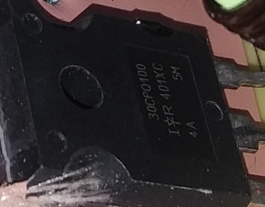

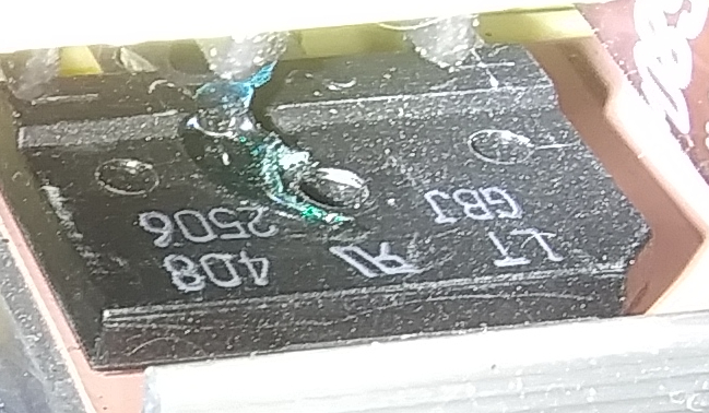

# Posted: 5 Feb 2022 10:37am - Edited by: paulz
Quoting: travellerw
Because of the danger factor, I usually start by testing the Mosfets and Bridge rectifiers (the devices bolted to that big heat sink). These can be checked with the supply powered down. Get the number off the device and find out if its a FET or BR, then there are good videos on Youtube how to test those devices in situ. 7 times out of 10 I find one of the devices has gone dead short.
Danger is my business (I forget who said that..).
Yesterday I pulled the board out of the chassis to see the back side. No evidence of overheating or corrosion. I did power it up again, the fan works so I know the board is getting power. Put a DVM on the two big white wires (pic on page 2), DC I assume, got nothing. Got the numbers off the gizmos on the heat sink. All but one are the small rectangle, google search says they are Schottkey rectifiers. Didn't find anything on the one bigger rectangular one at one end.
So I guess I need to figure out how to test these..
Thanks travellerw.
