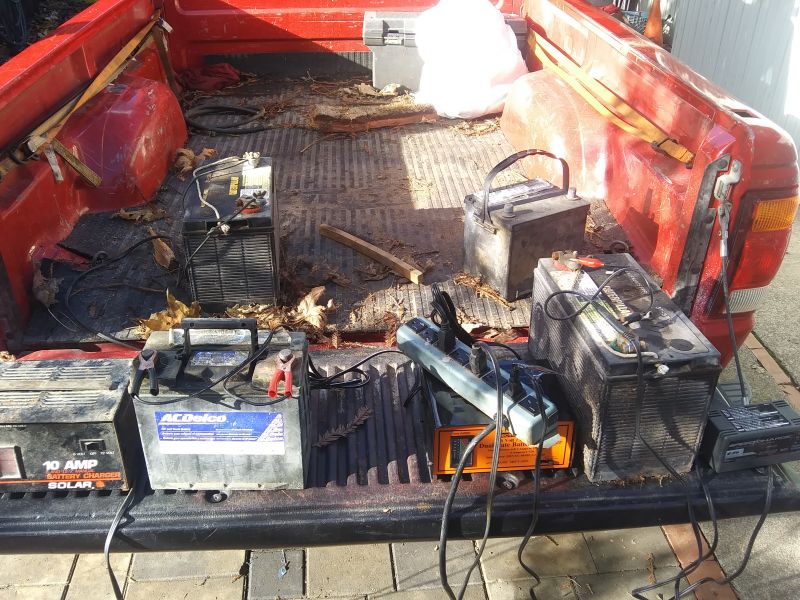

I hauled batteries back to the grid today. Finally got smart and instead of hauling the batteries, especially the huge Caterpillar batts, to the battery bench I just brought the chargers out to the truck.
I asked this before but still don't get the reasoning why I can't jumper a 12v FLA to my 12v LFP bank when it's sitting at 13.2v and charging from the solar. Wouldn't it be just another draw until it reached 13.2?

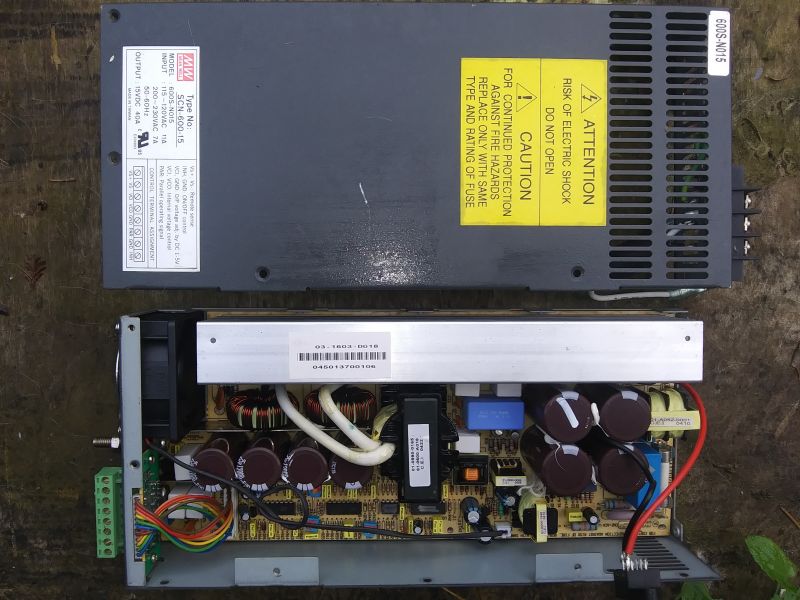

Speaking of the Meanwells, I think I mentioned my spare died, I may have had the 120/240 switch in the wrong place. Took the cover off and performed my usual electronics troubleshooting: the fuse is OK.
I'd sure like to fix it, probably something simple. Hoping someone, I know @travellerw knows caps and stuff, can point me to where the problem could be and how to test.

After that fuse check Id start looking the board/components over close for over-heated signs, wouldnt be surprised to find a nickel resistor or such blew. Thats as far as my 'complicated electronics knowledge' goes.....
Do you have a local tech-school with an electronics course? If so, go talk to the instructor, might be your unit could be a 'project' for one of the ace students.
I don't work on this stuff all the time.. but I can't see how setting the switch to 240V and then plugging into 120V would hurt the supply.... but I could be missing something. What is the supply doing.. Is there absolutely no output?
Unfortunately if there are no obvious signs (burn marks, bulging caps, ect) then a power supply can be a tough thing to troubleshoot if you aren't used to working with them (and dangerous).
Most technicians would begin by powering up the supply and then measuring voltages at different points. So at the very least, you are dealing with live 120V while you are sticking your multimeter pokey bits in there. However, many power factor corrected supplies will actually step the voltage up (as high as 500-600V) before bringing it back down.
Because of the danger factor, I usually start by testing the Mosfets and Bridge rectifiers (the devices bolted to that big heat sink). These can be checked with the supply powered down. Get the number off the device and find out if its a FET or BR, then there are good videos on Youtube how to test those devices in situ. 7 times out of 10 I find one of the devices has gone dead short.
