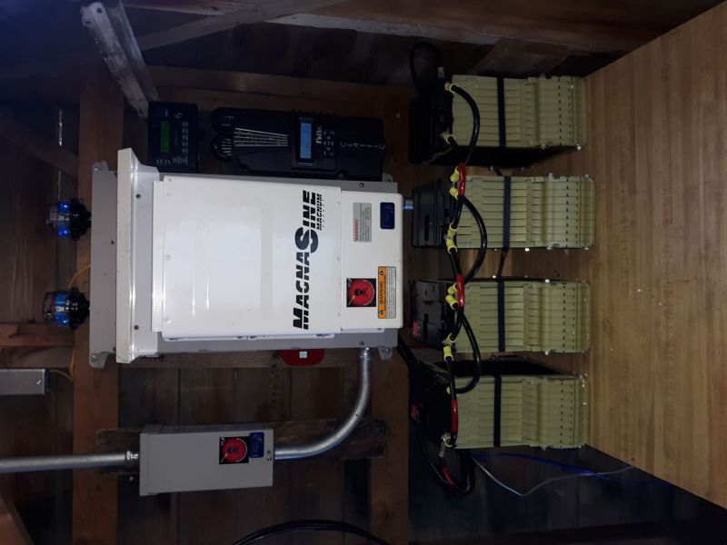

It was me who had the issue last year Replaced the 4 x 24 volt Chevy batteries with another set and all seemed fine last season. I posted pictures on May 31, 2021 of the incident.
Last fall instead of just turning everything off, (inverter, CCI), I disconnected the negative and positive leads. I can't be 100% sure but I may have left the inverter on by mistake when my batteries puffed up 2 years ago.
So...why timely? I just purchased two more cells to add to the array. The first set and my current set were not all the same year. I believe there are only 2 24 volt packs in each car.
So should I scrap the idea of adding the two more?
# Posted: 4 May 2022 09:12am
Rach.... talk to Creeky he kind of thinks it's larger systems that have had issues, after adding modules. With only 4 you are probably OK. I would do like you did last fall and physically unhook them though.
It is pretty unclear what happened to yours or mine I think. When I brought the Tracker back up after taking my wife and the cats to the pickup... I remembered I hadn't shut off the inverter so opened the cabin and shut it off. The only thing left on were the breakers between the modules and the inverter. Since my inverter was "hard off" it does not draw any power. I poured over the manual and could find nothing to indicate a parasitic draw when off.
The best guess by anyone is the reaction may have started in one of the new cells... many coincidence but the ends were blown completely off those two modules.... and because of being connected through the busbar started the reaction in the rest. Who knows
The good thing is they were never hot, cool infact. I took them outside and set them on bare dirt. There has been no further reactions. They look the same now as they looked when I removed then from their boxes. Whatever reaction occurred is was not a fire causing "runaway" at least once they were disconnected from each other.
Practice "safe module" and I bet you will be fine.
That said in a way I'm kind of glad to get them out of the cabin and replace them with LiFePo, much safer and charging parameters that I can set my invert/charger to. The Schneider inverter/charger cutoff could not be set low enough to accommodate the Volt modules, I had to watch it and manually shut off the charging.
Luckily my CC can accommodate the settings, as confirmed by the manufacturer. I will however start planning ahead.
Steve_S makes a ton of sense. My computer is 4 years old and is square wheel technology in comparison...just like my 8 year old batteries.

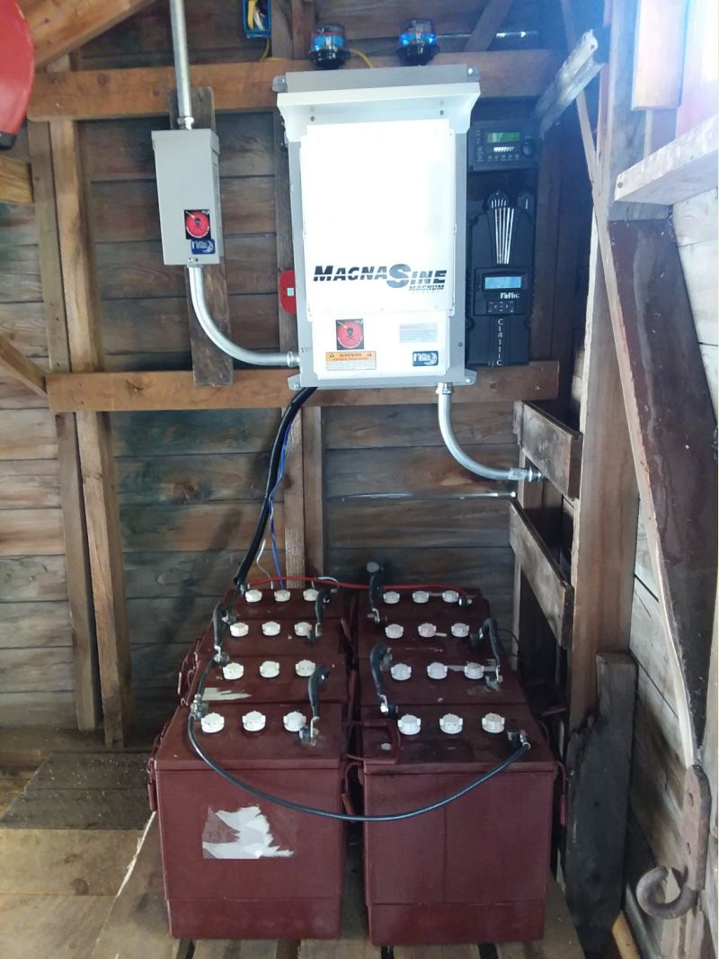

But in all fairness I went from this:
rachelsdad
# Posted: 4 May 2022 12:51pm - Edited by: rachelsdad
To this
rachelsdad
# Posted: 4 May 2022 12:55pm
drat...can't get the picture to stay vertical
