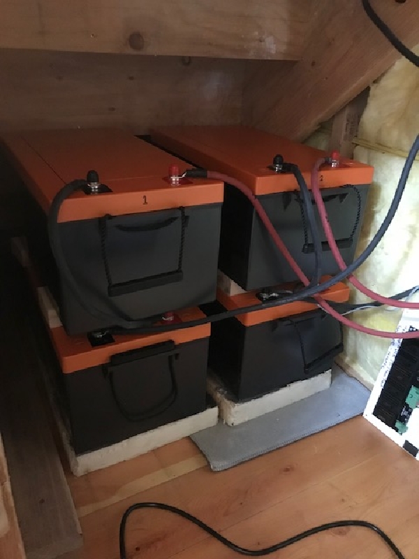

Well, the Chin's batteries arrived well packed and in great shape. All 4 registered 26.3v so I was happy they were balanced. Had some help getting them in the cabin and in place under the stairway. I have lots of cables left over! There were 8 x 48v modules each wired to a dedicated breaker... now just 2 @ 2s2p.

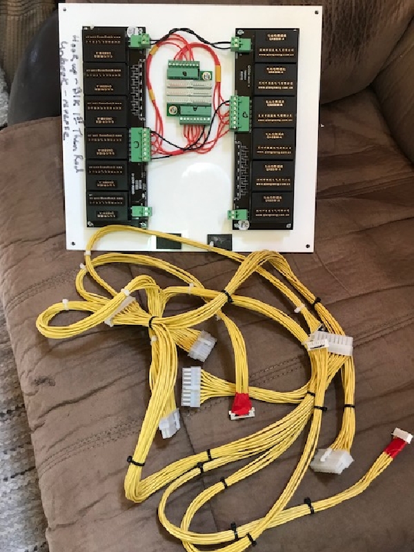

On another note, rachlsdad... do you need a balancer for your modules? I have better than $600 in the balancer and cables. I would sell them for $.50 on the dollar. You can contact me at my handle @Yahoo... be careful of the spelling.

I bought the balancer and associated cabling from Creeky but the modules were from a couple of different sources..
I'm really happy with the Chins 24v/200ah pre-builts I bought. I have yet to dip very deeply into them, only use the top 30%. The curve on them seems much flatter than the Chevy Volt modules. Might be my imagination!

Yes I believe it would. The "BMS" I have isn't an actual BMS, what it does is balance the individual cells. From what I gather from Creeky and Steve it does that quite well. The connectors are the same on all the Chevy Volt modules, I don't think the balancer cares if there are 6 cells or 12 cells in a module, it just balances what is there. There is no voltage indication anywhere on the balancer. From what I have seen in pictures... yours, and on Creeky's site the harnesses and balancer look the same 24v or 48v. I would love to see someone use this.

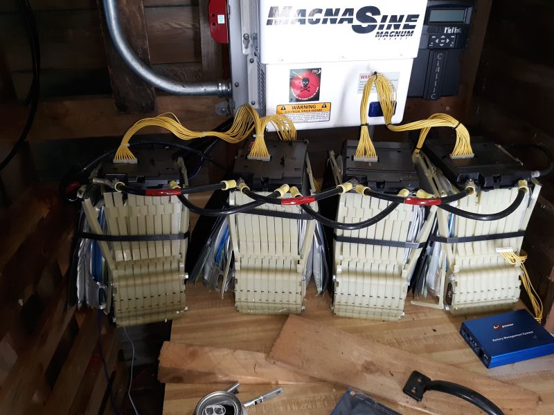

# Posted: 11 Jan 2023 10:07am
I did it, I ruined my Chevy Volt modules!
We shut down the cabin yesterday for the annual "thaw" in AZ and I learned why my Chevy Volt modules died.
I have a shut-down sequence that I do as I turn the solar off. As I was powering everything down my "ears" were astounded to note that a -hard shut down- inverter turned off at the inverter on/off button, DOES NOT turn it off! There is still apparently still something powered up in the inverter!
A little background...I have breakers for all my batteries, this way (especially when I had 8 Chevy Volt modules) I can turn them off/on individually so if I want to take one out... or as I've done in the past charge/discharge to balance to the other batteries its an easy task. I HAD NOT TURNED THE BATTERY BREAKERS OFF WHEN I SHUT DOWN LAST YEAR... I FORGOT, MY BAD. But the Schneider Conext 4048 is not supposed to have a parasitic draw when hard off.
This year, I'm shutting down.... push the on/off button on the inverter, it shuts down. I reach up and turn the battery breakers off and I hear a contactor break in the inverter! WHAT! So I turn the batteries back on... yep I can hear the contactor pull in! I'm not positive it is a contactor but it sounds like one.... whatever it is, if the batteries are on, it is powered up...it's doing something, EVEN THOUGH THE INVERTER IS OFF.... there is definitely a parasitic draw in a Schneider Conext 4048.
I've read under charge is one of the things that will cause the Chevy Volt modules to swell, mine were at 21v each, that is ~1.75v per cell, the "knee" for these cells is 3.5v, after that they drop rapidly with 3.1v being the absolute lower limit... below that they will be damaged!
I killed my batteries! Hope this helps!
# Posted: 11 Jan 2023 10:37am
Wha-Hoo, sounds like you tracked it down! All good info, at a cost, but maybe your experience will save somebody else.
# Posted: 11 Jan 2023 10:40am
Sorry this really sucks for ya man, I feel the grr (insert blue air here) for you as well.
The inverter when "hard off" should have no draw at all, you are quite right and Schneider is a Tier-1 product and I can't see them doing that. Now I don't own their products but it's the first I hear of this and believe me, where I hang around this would be talked about. I can only conclude that the inverter is defective. My Samlex and even the Yiyen Inverter fully power off when "hard off" no draw at all. Now if an inverter is left in a Stand-By eco mode, it will have a small draw and send pulses through the AC to determine if there is a demand for it to power up. Most advanced Inverter/chargers have this capability which can be either programmed and/or activated by the power switch (like a quick press for PwrSave, or long press for Full Off), it varies by brand & model. Is it possible that this may have led to this situation ?
This is one of the reasons that the majority of system designs have a master cutoff between the battery bus & devices, being either a switch or DC Breaker sized for max load potential.

# Posted: 11 Jan 2023 01:46pm
My thoughts exactly Steve.... I could/can find no where in my Conext 4048 manual that speaks of a parasitic draw, even when turned off.
It was quite noticeable when I flipped the breakers on the batteries, a definite "click" in the inverter. Something in there was still on until the batteries were disconnected. I had always turned off those breakers in the past, I had just forgotten last year.... actually when I went to power on the inverter last year I remember opening the breaker box first and was surprised they were on. When I hit the button to turn on the inverter, nothing happened, that's when I looked at the modules and discovered they were expanding.
What's done is done. I just hope others that use this type of modules will read this and take note! ACTUALLY, anyone! Make sure the batteries are disconnected from the inverter when shutting down... breaker or physically.
And, I hope "rachelsdad" will breathe easier knowing why mine did what they did (I suspect something similar happened to his first set as well).

Kamn... I do have the balancer and enough harnesses to do 8-10 modules. Unfortunately we just came down to AZ for the rest of the winter.... will return to Colorado around the end of April. I could ship them to you then if that would work.
I'm open to a price, they aren't doing me any good and if someone else can use them that would be great! I have over $500.00 in the balancer and harnesses.... shoot me an offer, it's HIGHLY UNLIKELY I'll refuse it! You pay actual shipping costs.
Dang sure will be cheaper than Creeky would have to sell them for!
If you want that balancer and harnesses let me know. My email is my username at yahoo. Careful... 1 "d" in Nobadays!
