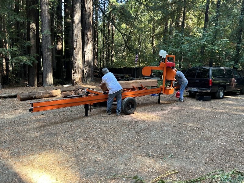

Projects never ending, fortunately now it’s mostly upkeep. A friend brought over his mill last week and cut some logs that were down. More work for me, as I had to clean up, get my log splitter running and buck up the leftovers.

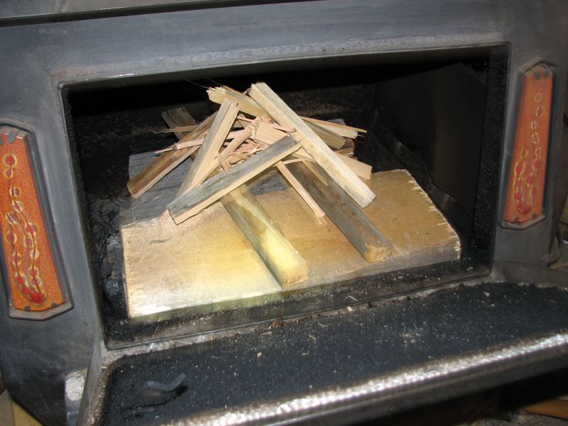

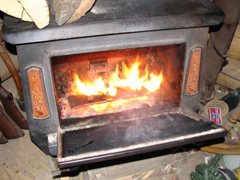

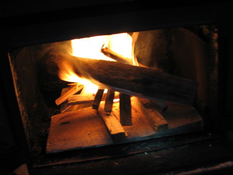

# Posted: 29 Sep 2023 09:32pm - Edited by: Malamute
Controlling your air intake and your stovepipe out both can help with maintaining your fire longer and controlling it better. My area has some fairly frisky winds (up to 130-ish mph now and then, 60-80 isnt unusual), so I have two dampers in the pipe to help tame it down when needed.
My stove is an airtight, by Blaze King, it has a thermostatic controlled intake damper so it can shut down if it gets warmer than needed then open up for more air as it cools. It makes a huge difference in how long fires last and regulating the heat output in the range you want.
One thing you can do with any stove is build the fire upside down, at least by common reckoning. When I heard of it it totally changed my firebuilding and firewood supply picture. The basic premise is lay most of the wood on the bottom, tightly stacked togther, then build a starter fire on top letting it burn down into the wood. I was using 2x6 construction scraps and log siding scraps, Id get about 4 hours of burn. I also used mill slabs (the first cuts from a log to square them up) from a small mill i got rough cut lumber from, it shared the same basic shortcomings. I of course needed quite a lot more wood and larger pieces to get through the night or colder periods, the scraps and slabs were just not enough to get through the night. My wood is all pine, fir, spruce. Its all thats easily available in the area.
Boy Scouts used to call them Council Fires, they required no feeding and upkeep for long councils.
Enter the upside down fire. When I started it, it was a complete change. The same wood that burned out in 4 hrs had coals left by morning. I no longer needed lots of larger logs and split logs to make longer fires, and what wood I had went much farther. I started the starter fire, left the door propped open on the latches a little bit, once it was going well, I added a few medium splits then shut the door and turned the thermometer damper down. Done.
One other factor in keeping fire longer, dont clean all the ashes out, when I got about 3-7 inches of ash my fires also lasted longer than when just cleaned out, so I stopped cleaning all of it out, just down to about 2 or 3 inches.

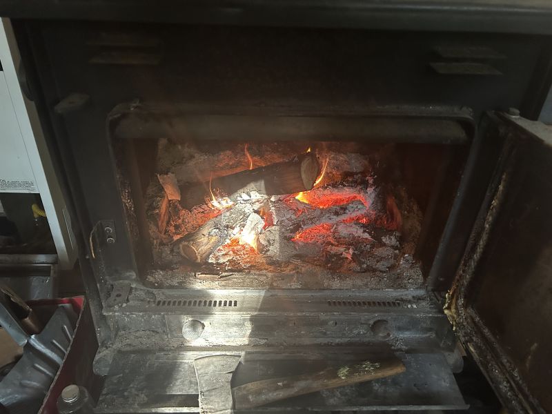

The fire pics. Taken the same day, fire layed with mills slabs tightly together below, and lit at about 9:15 AM, last pics are the same fire 11 hours later. he remaining wood sprung into flames after opening the door and getting the camera.
Fire lay
Fire lay
started
started
Going and ready to close door
11 hours later
11 hours later

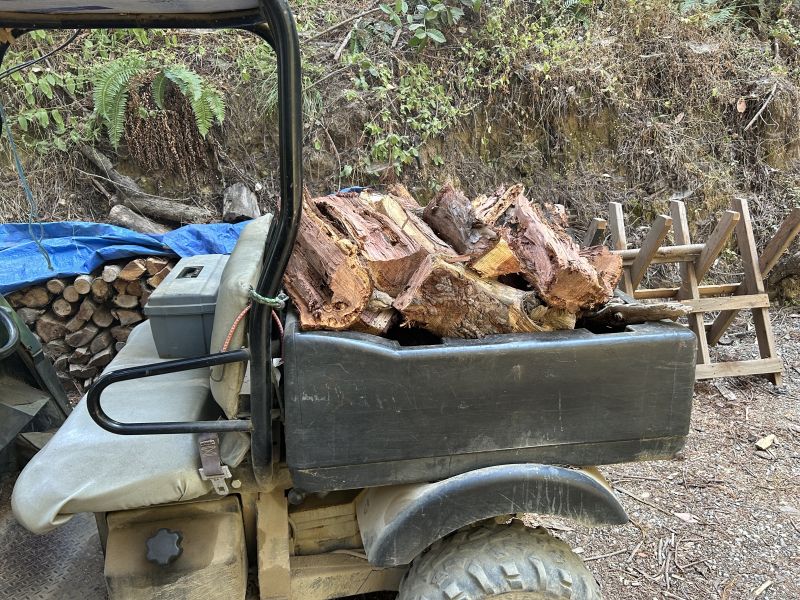

I have two woods on my property, redwoods and bay laurel. The redwood is soft, burns quickly and hot, great for warmups but if filled for the night it will overheat the cabin and burn up way before morning. The bay on the other hand is hard any heavy, twice the redwood. So if I put a big chunk of that on before bed, the cabin will stay comfortable all night.

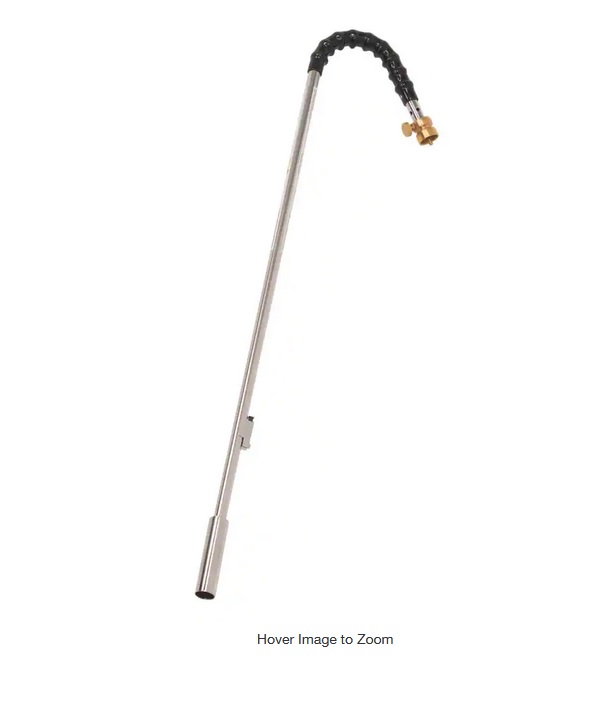

# Posted: 30 Jan 2024 03:33pm

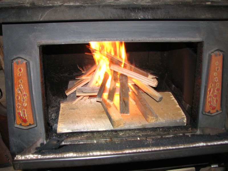

My lazy way of starting a fire. I don't always use it, but when I need to get it going fast and I don't want to build a proper bed I pull this baby out!
