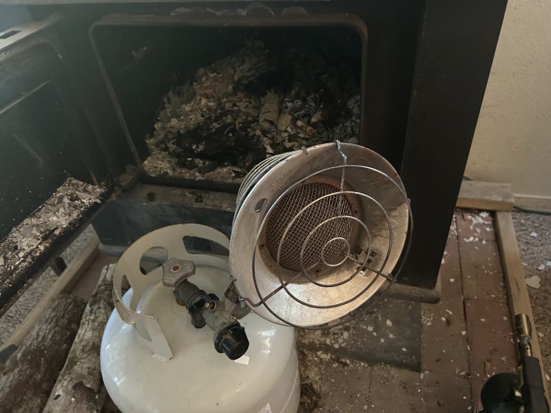

Another one of my probably dumb ideas: for a quick warm up can I bring this lp heater inside for a bit? I know ventilation is an issue (although my Mr. Heater etc. run indoors without external venting) but can I run this with the wood stove door open for half an hour?

I've used similar & Big Buddy heaters during construction ... it's OK if you just heat to take the chill off for 10-15 minutes and still have fresh air incoming but not for long because you'll gas yourself in no time. CO2 poisoning does not take long - by the time you start seeing "halo's" you're already headed to deep trouble.
Honestly, best thing to do, is get in there and start a "softwood fire" to get the woodstove up to temp fast & give you heat, then switch to the hardwoods once warm.
# Posted: 27 Sep 2023 02:57pm
Folks around here have been doing it for a long time, Just Be Sure to Have a CO Alarm and Do It Sensibly.

Yes, with precautions as stated above. And be careful not to knock it over!

Thanks guys, good points. I need to check my detector batts..
I’m thinking for mornings when I don’t plan to stay, takes the chill off and no leftover burn when I’m gone.

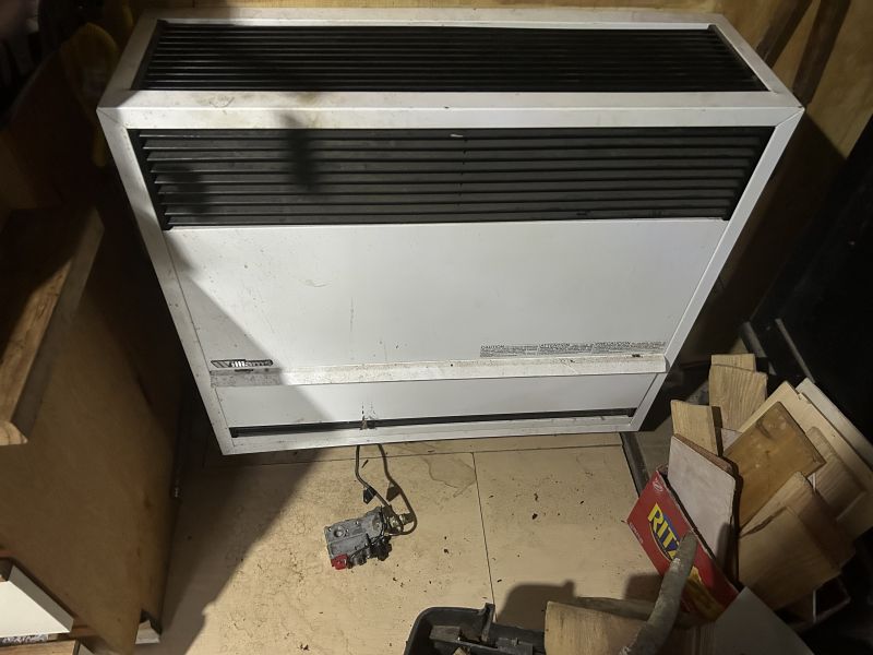

That is a nice looking unit. Maybe too small for my 12x24x15 plus bathroom. I currently have a direct vent Williams 30k btu. I haven’t been using it because it takes about as long as the wood stove to do any good. Plus this year the control valve quit working so now I have direct LP to the burner. Works fine since I don’t use the thermostat or leave it on at night.

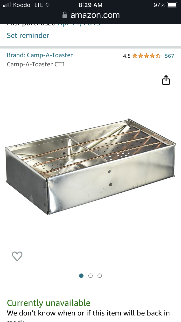

But these ones are awesome null
# Posted: 6 Oct 2023 09:28am
Currently unavailable

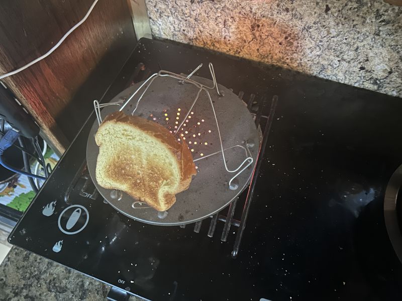

Kinda seems like me n you ,Paul,like to buy the same stuff. I have one of those toasters at our cabin for toast. Here's how I make toast. I put an ember from the woodstove on the tin plate and it sets on the top of the woodstove. This is chaga bread. I made fresh bread at the cabin and use chaga tea.
Won't let me load the picture. But you get the idea
