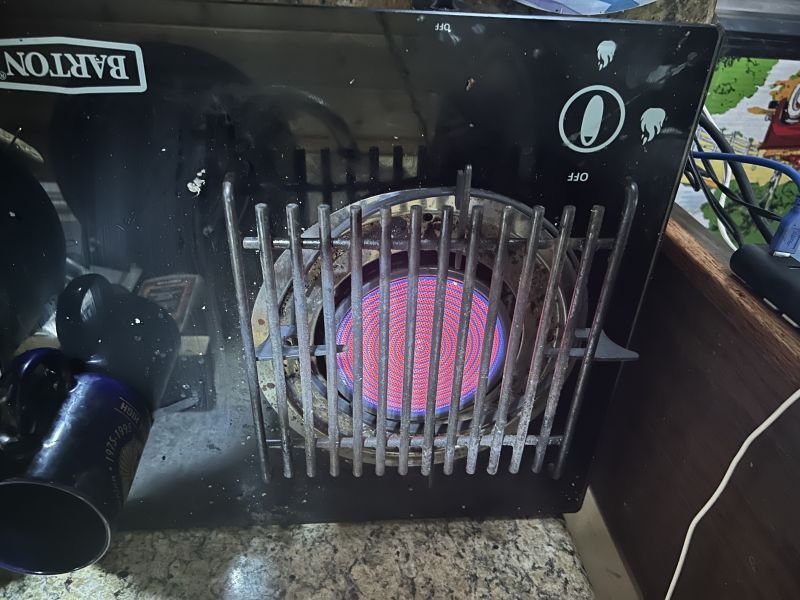

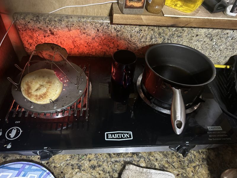

I’ve been toasting bagels on the lp toaster, they have been wonderful. A few years ago I replaced the open burner stove with this ‘ceramic’ one that has no open flame. No idea how it works, other than good. I also added a grill above the burner to keep the toast heat down.

if you put a foil cover over toaster ... comes out just like the 1300 watter at home....

A picture of our toaster in action using an ember

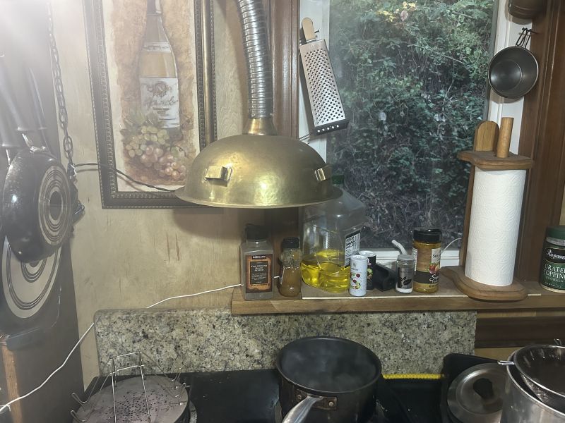

Good tip on the foil, also the real world experience on indoor lp use. My lp cooktop says “for outdoor use only” (naturally). A few years ago I put in this vent made of free stuff, an old brass sink, piece of muffler tubing and an old usb computer fan inside. Oh well, it works. I don’t use it often, do all the heavy cooking outside. It vents through the roof, no idea why I put that vent in when I built the place (pre kitchen area, bathroom..) but glad I did. Guess it vents even with the fan off.

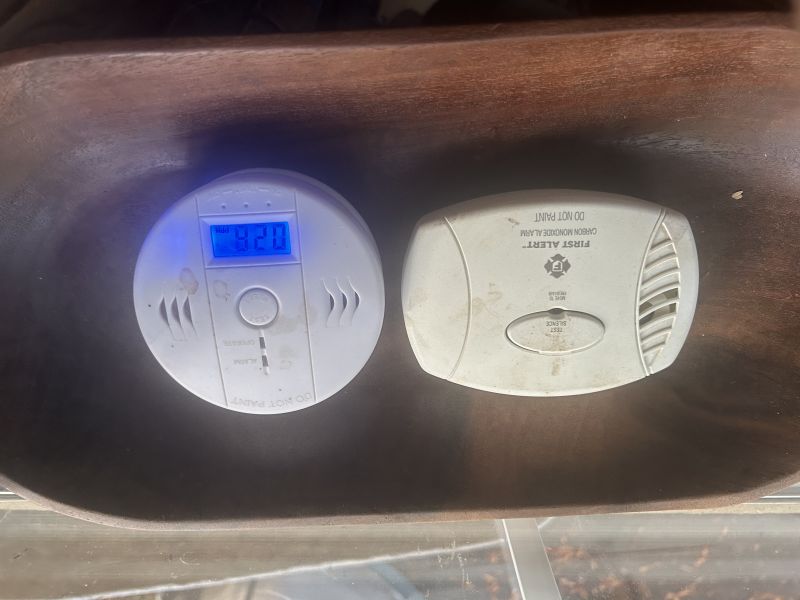

Been going through that a bit lately too. I have 2 CO alarms. One, that has no display but goes off at 400 ppm, has gone off a couple times. The other has not gone off, the display reads in the 300s.
I suspected the wood stove or the LP cooktop (which says ‘outdooor use only right on it. So today, after being gone a day, I have the wood stove going but no cooktop use. No alarms, 000s on the other. Tomorrow morning I’ll fire up the cooktop and check.

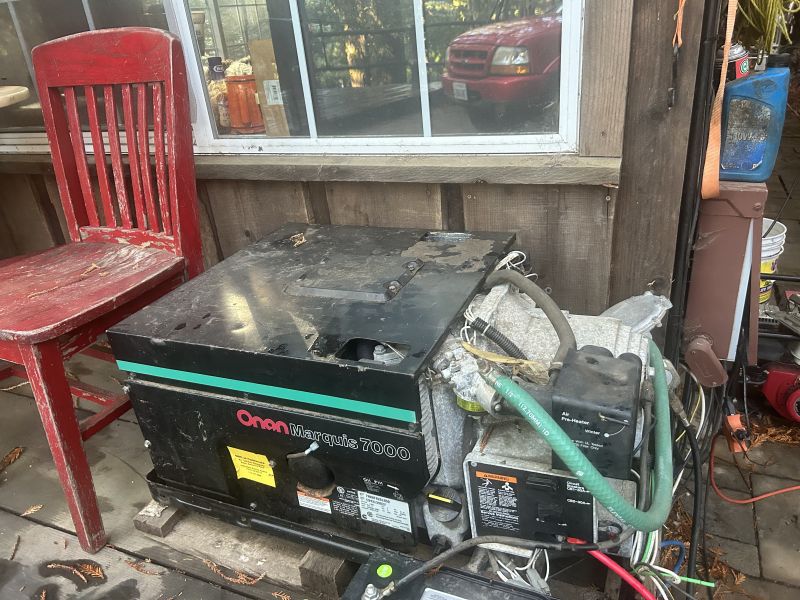

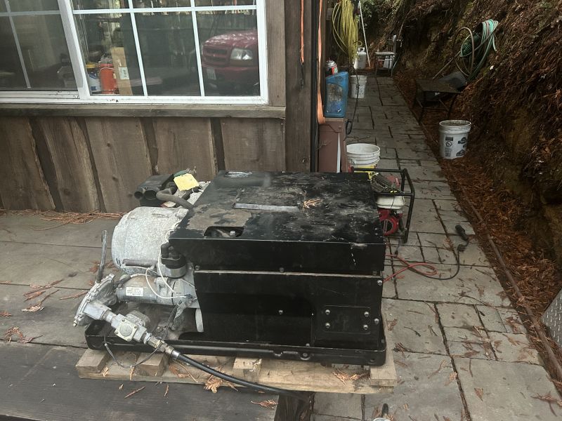

This morning I made breakfast. All 000s, no CO alarm. Fired up the wood stove, still nothing. Hmm. Then my wife reiterated something I mentioned a couple days ago: the generator! So I ran it for a bit and sure enough, got a reading. It’s outside though, of course, but the exhaust goes down underneath the front deck, maybe it’s finding its way up through the cabin floor. Or maybe through that window.. Guess it’s time for a new home for that. I had recently moved it there from a nearby shed just to be handy to use. It’s 300 dang pounds, no wheels.

No fresh air intake. Bit of progress though. Finally found where the exhaust comes out on this Onan 7000. It was given to me a few years ago when the school disassembled its ‘disaster recovery’ shed for some reason (I’m known as the guy who will take anything around here). It’s new, still on the pallet, albeit a little beat up on top. Anyway the exhaust comes out underneath pointing straight down, no wonder it was getting under the cabin.
So I spun it around so the exhaust came out off of the deck, ran it this morning, no CO inside! Now I just have to jockey it around some more, maybe find a pipe extension.
Behind that in the photo you can see the old genny I was using, a gas powered Honda, but it only could muster 40 amps to the charger. The Onan (LP) gives me almost 90. I was told it was an expensive unit.

What a gen!
So glad yer gettin it sorted

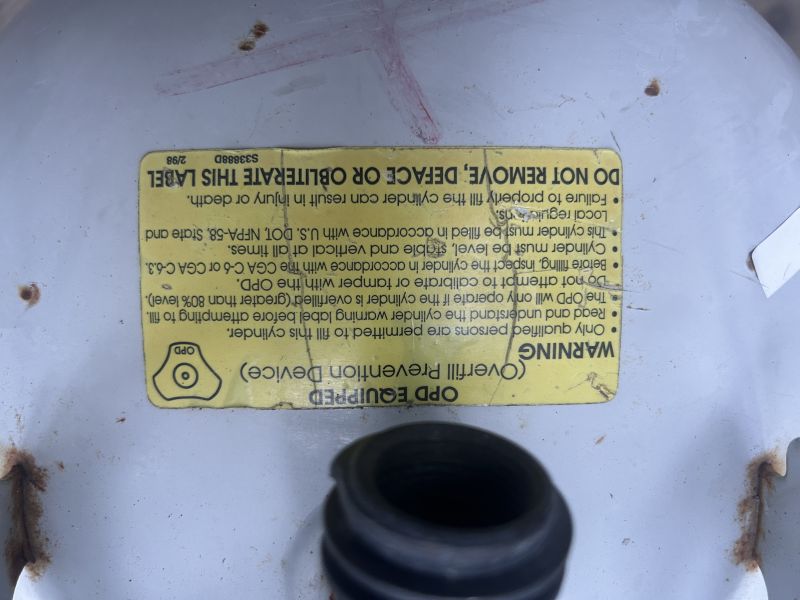

Speaking of LP, yesterday in town I had four 5 gallon tanks refilled at the gas station on the way out. Been trying to start my generator with two so far, won’t fire. I then took the 1/2 full tank off my BBQ, fired right up.
What is it with freshly filled tanks? I loosened the bleed screw at the top for 10 seconds, no help.

Are the the 'new' style safety valves?
There is a proper way to open them to avoid, or at least min. the no flow issue. They are made to shut off if they 'sense' there is a leak, lots online about it.
Iirc any valve with the big external thread EZ mount is the safety valve.
# Posted: 28 Oct 2023 08:03pm - Edited by: paulz
Yes they have the external threads as do all my tanks. I got one to light the bbq. I took it back to the genny, still no pop. Tried all 4 at the genny, nothing. Had one more spare tank here, it ran the genny then the bbq, so I’m good for the night. The one refill that did run the bbq would not then run the genny, nor the bbq again, so maybe I’m opening too fast? Never had that happen before. The guy that filled them opened the bleeder screw while filling each one.
# Posted: 28 Oct 2023 08:57pm - Edited by: paulz
Well I got one to run the genny. Guess it’s that OPD valve.
